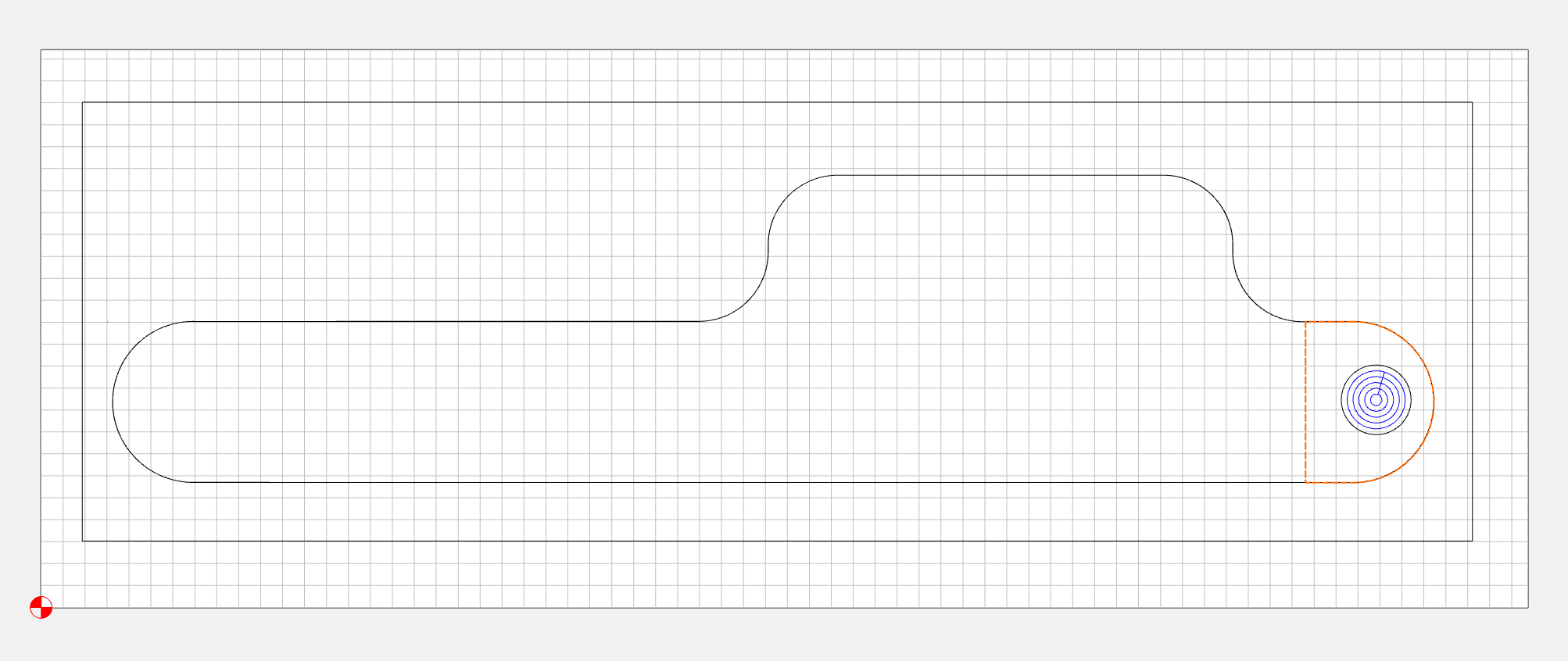

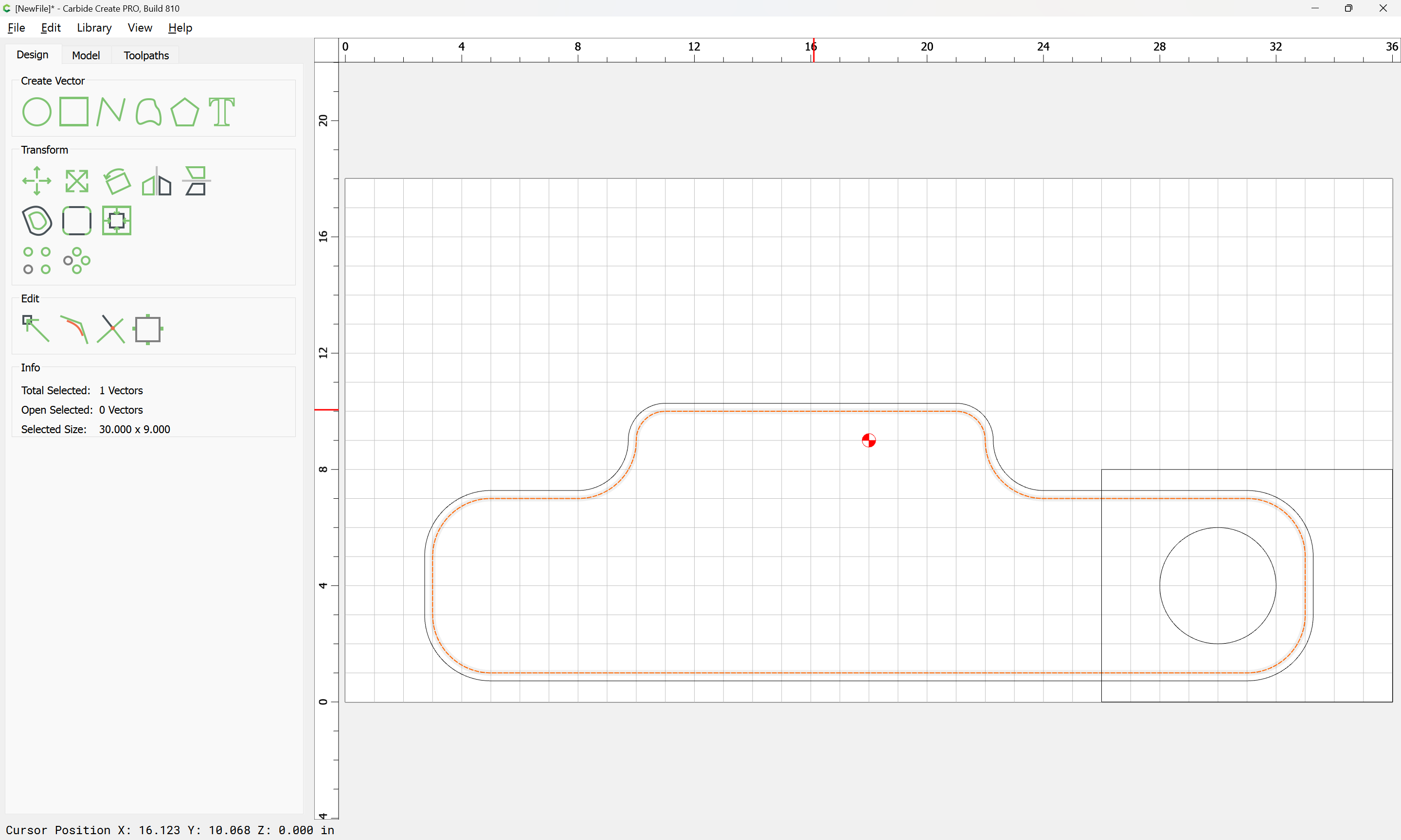

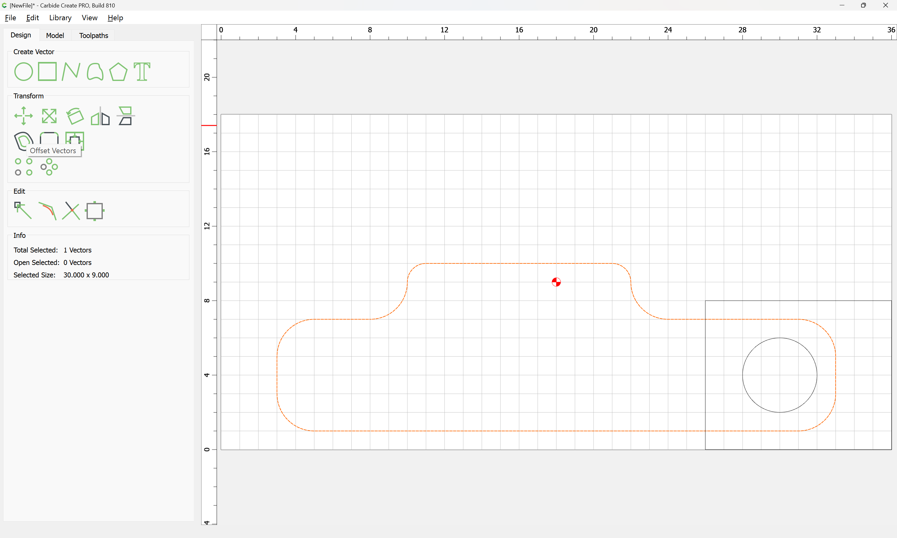

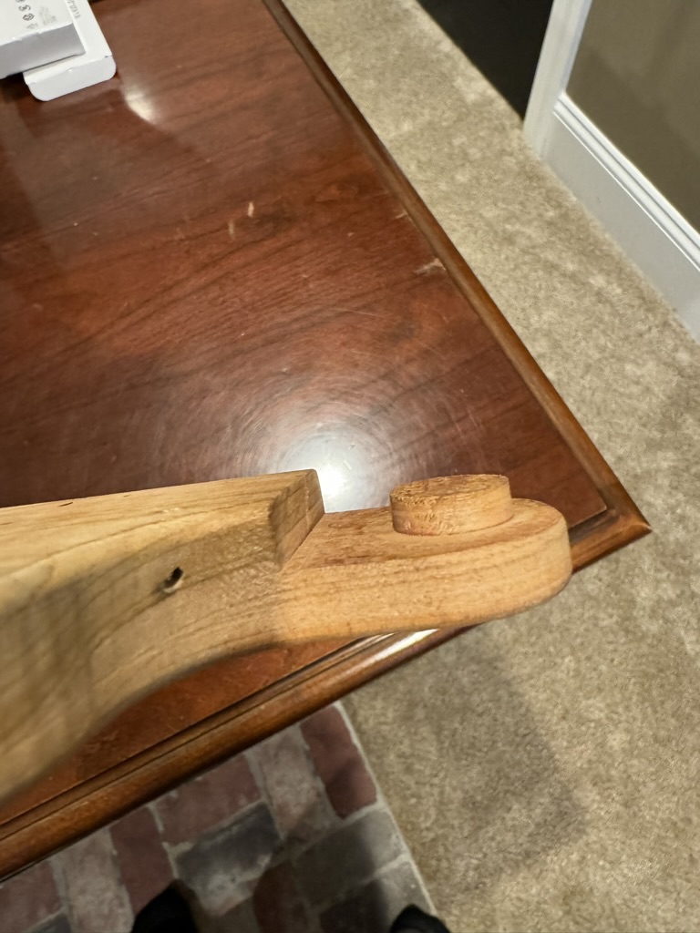

On the bottom side, there is a male connector. I am trying to figure out how to create the toolpaths to retain the cylinder instead of the pocket cut erasing it. I created a pocket cut 6mm from the top of the cut.
I created a circle for the cylinder and want that to be cut about 1mm from the top of the cut so I have a slight clearance within the connector hole. But b/c the pocket cut is 6mm deep, the cylinder is eliminated.
How do I tell the toolpath not to cut in the circle/cylinder area?
Thank you!

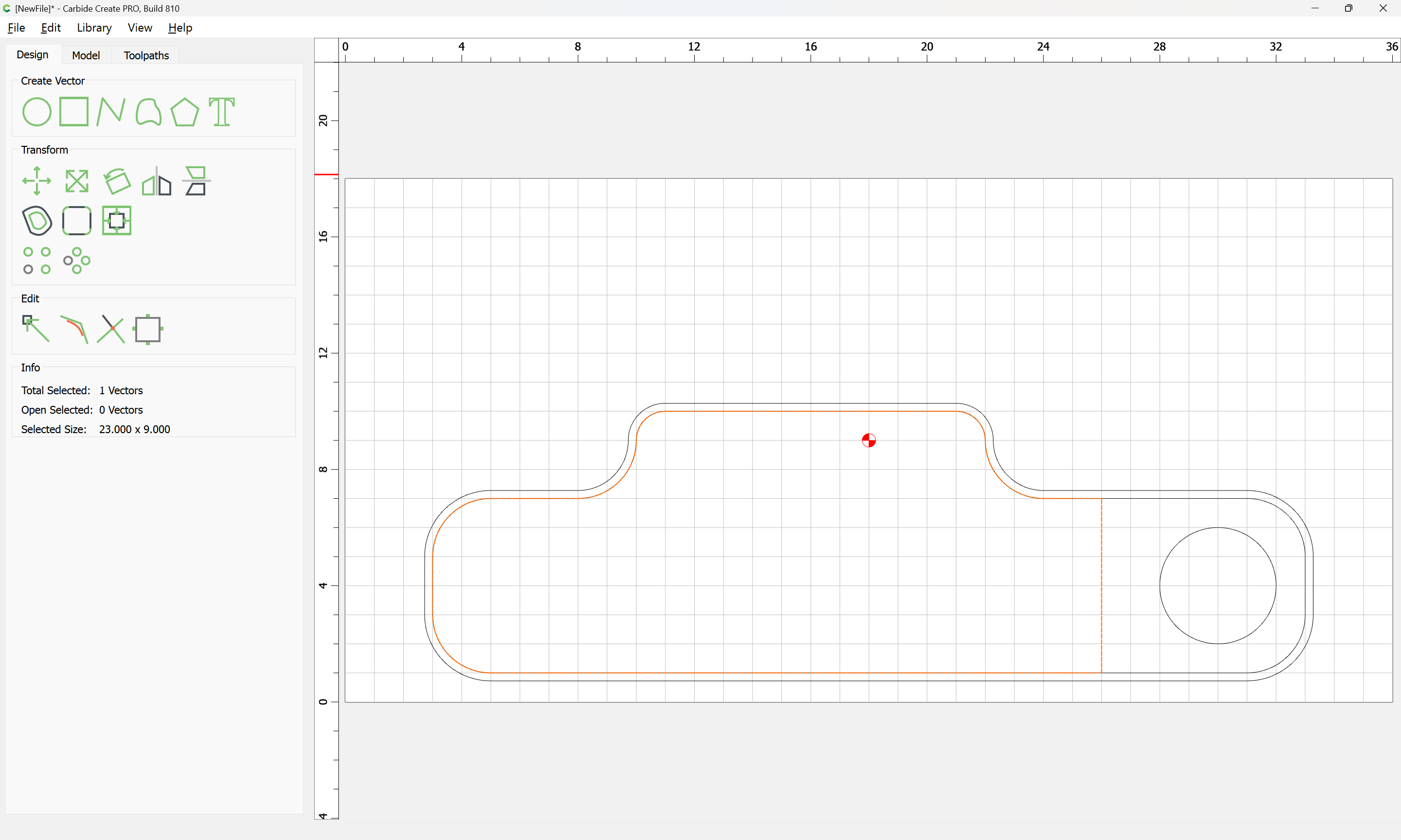

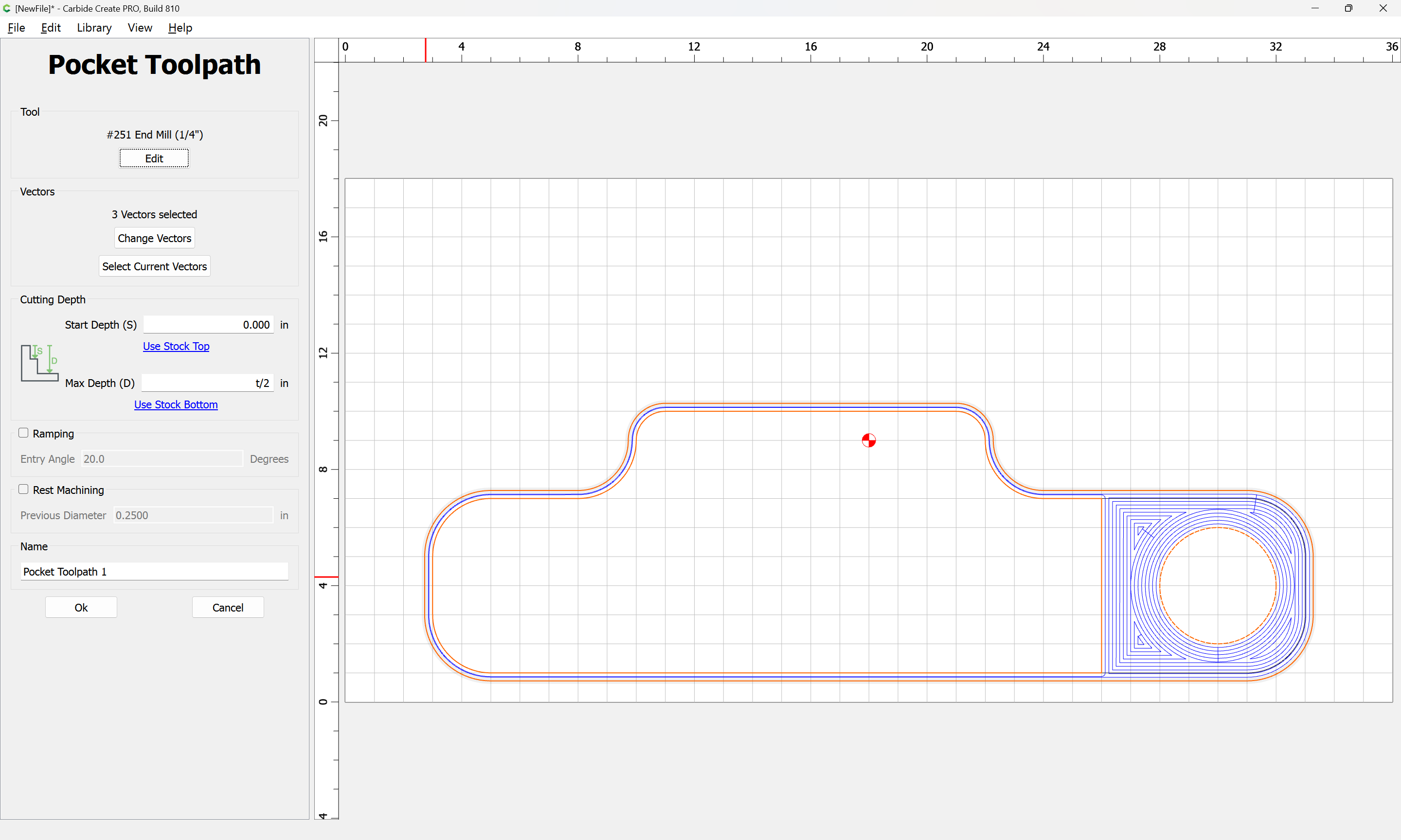

Select the surrounding area and the area which you want as an island.

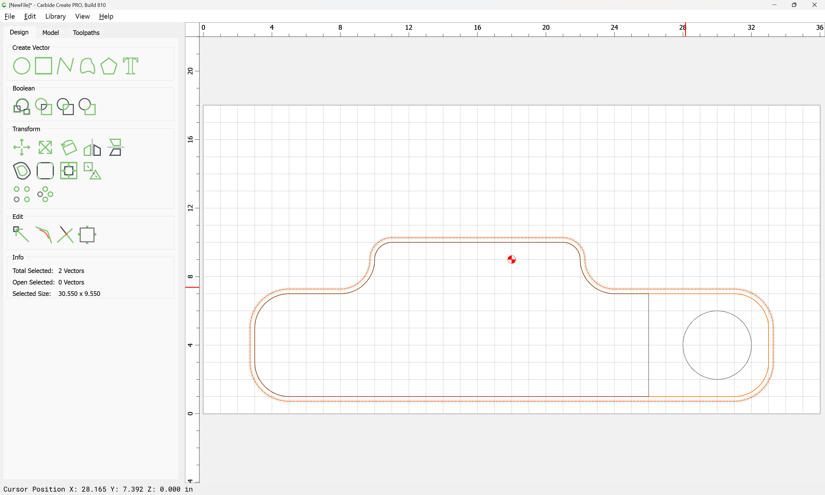

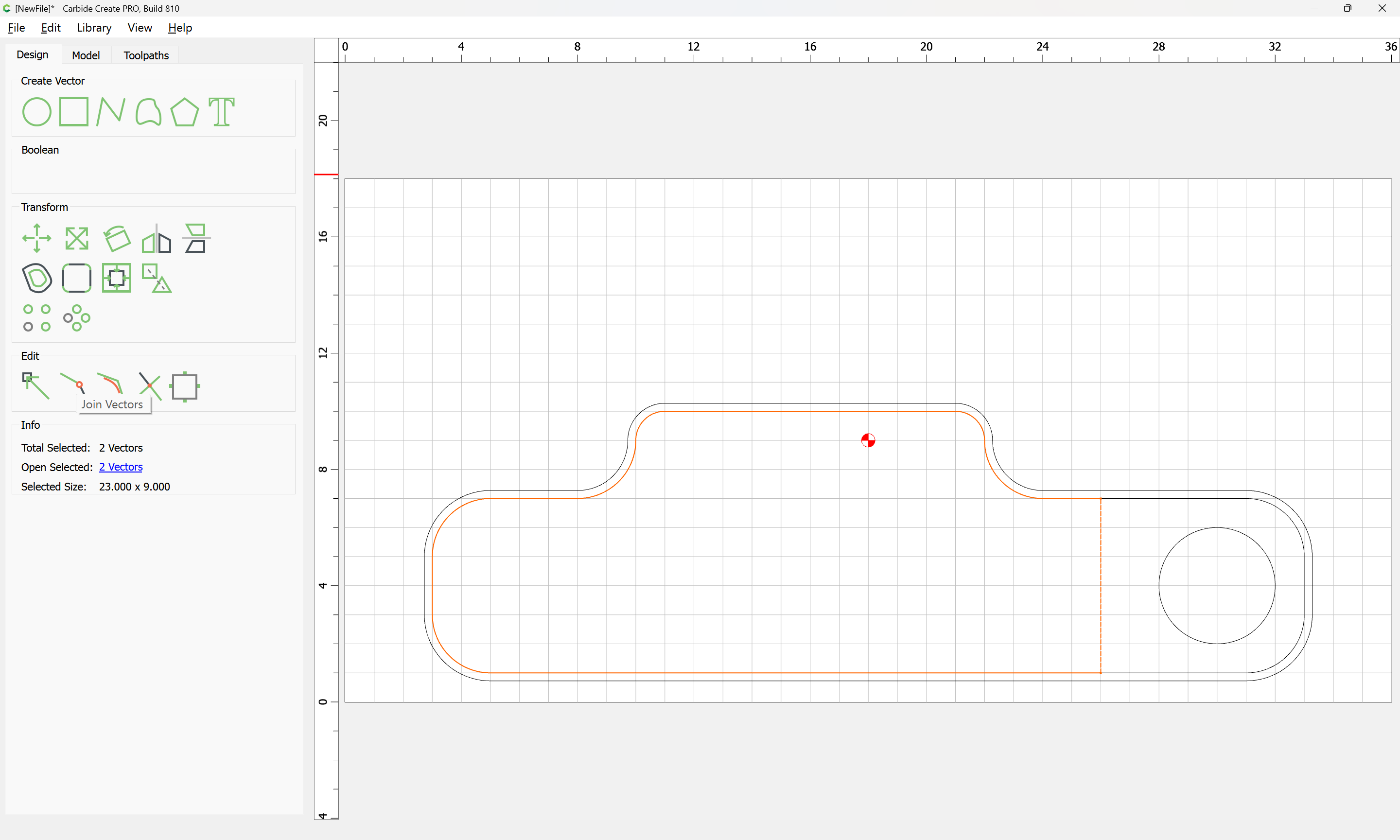

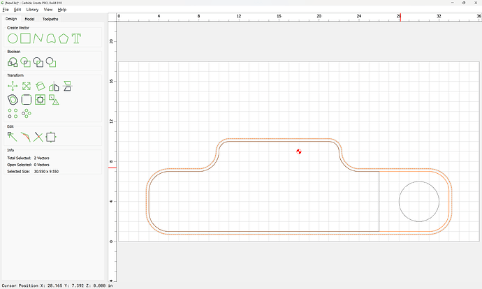

Probably you’ll want to add a partial offset and do this in multiple toolpaths for efficiencies sake:

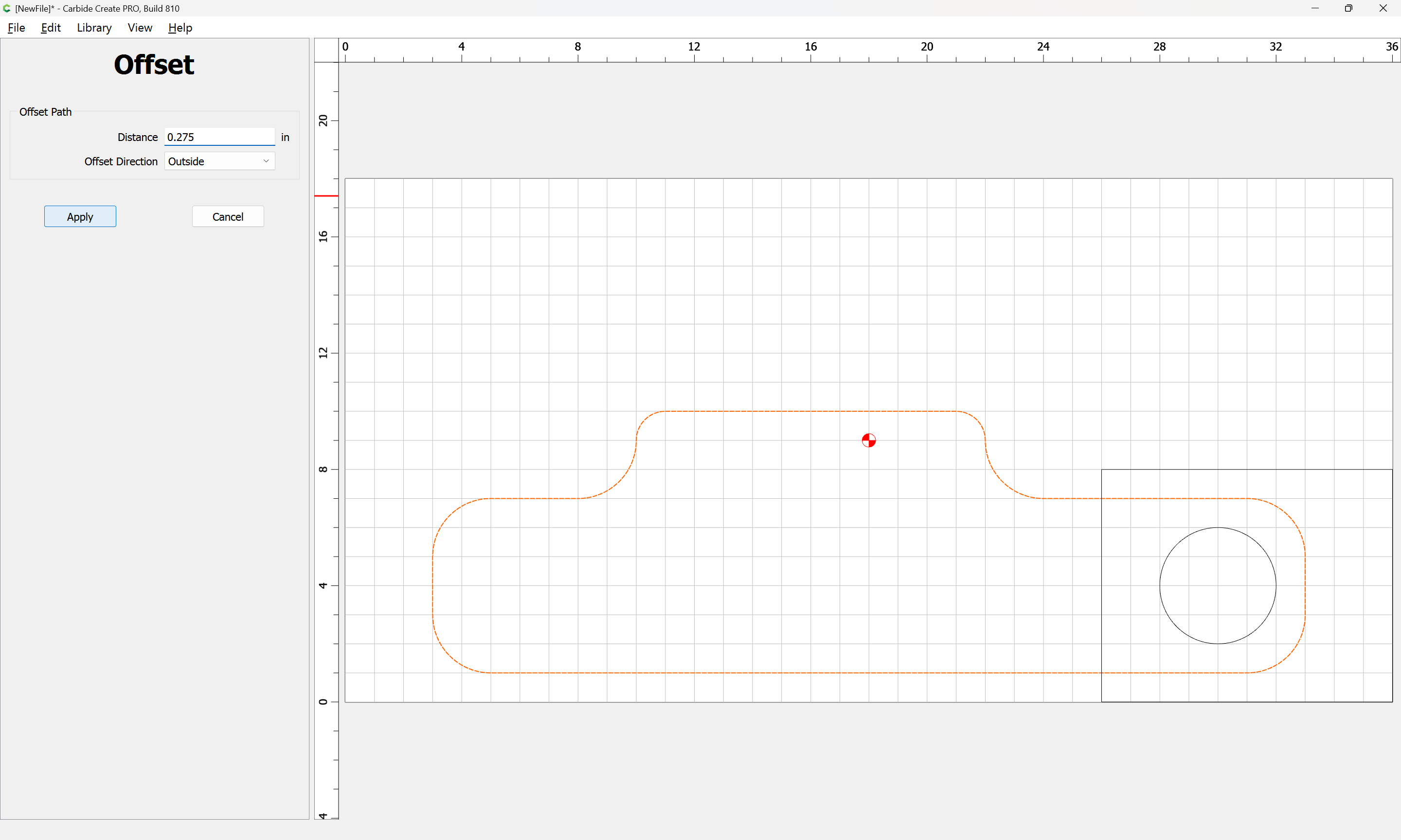

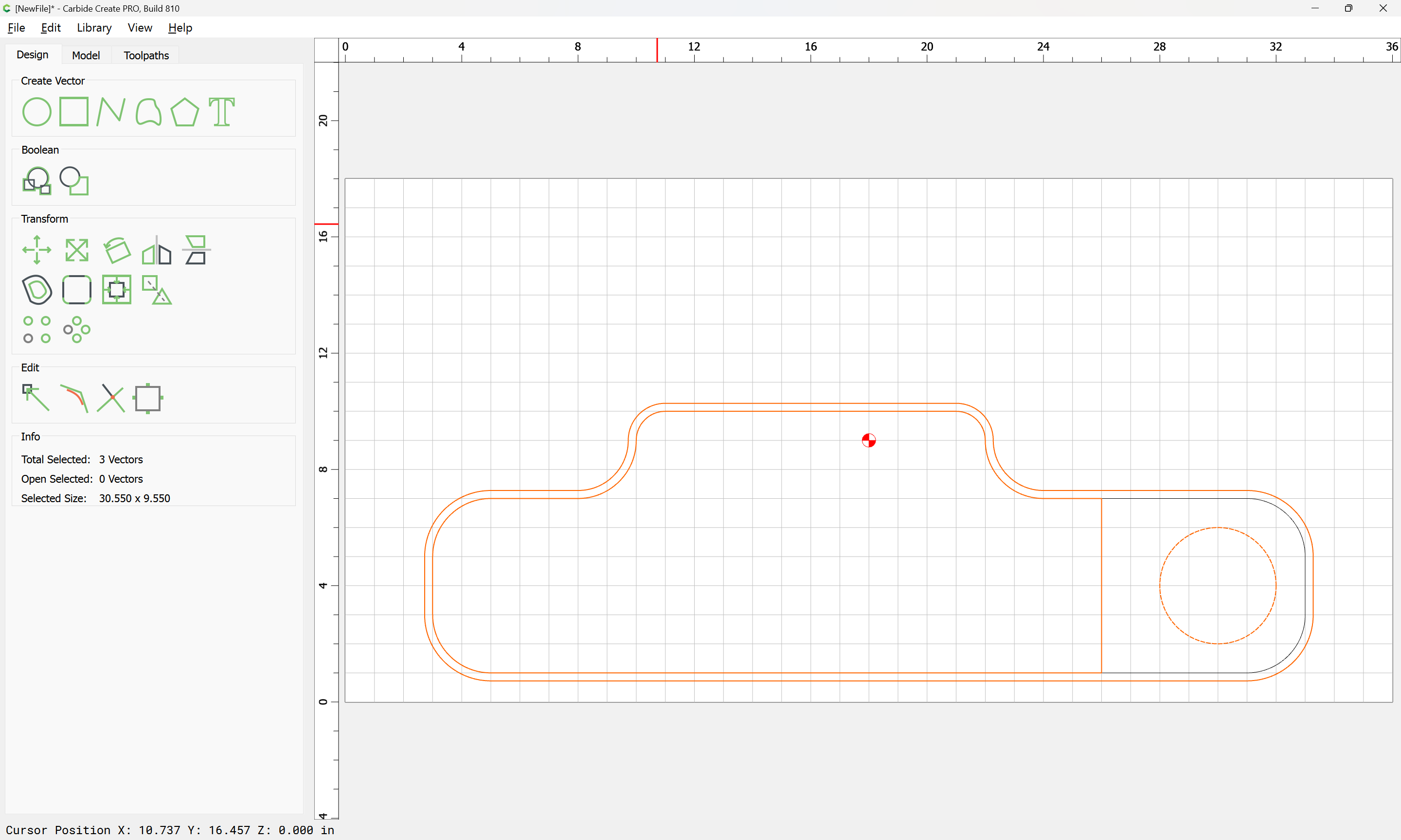

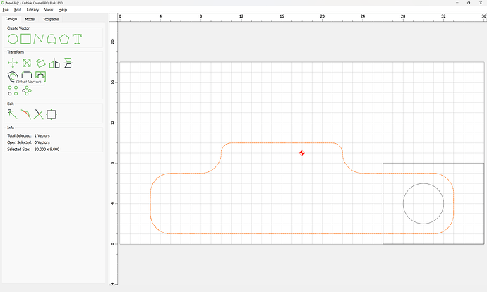

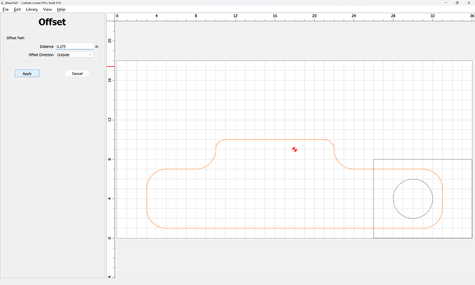

Offset the part geometry by endmill diameter plus 10%:
Apply

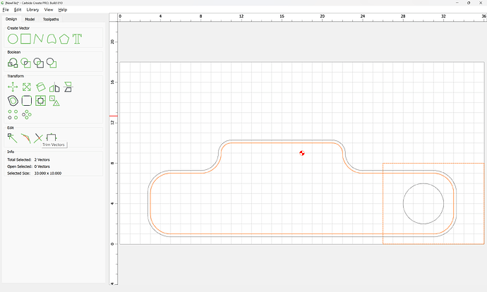

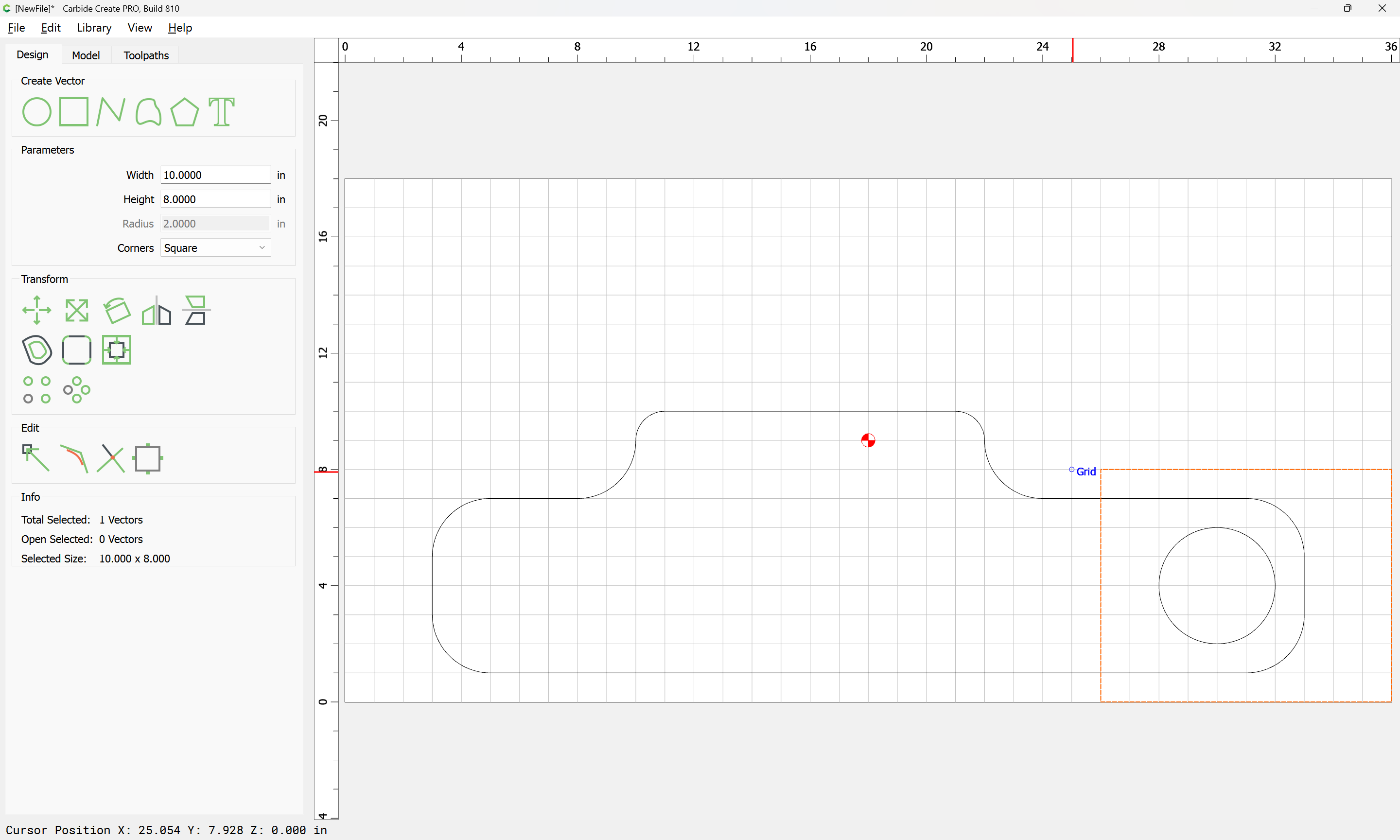

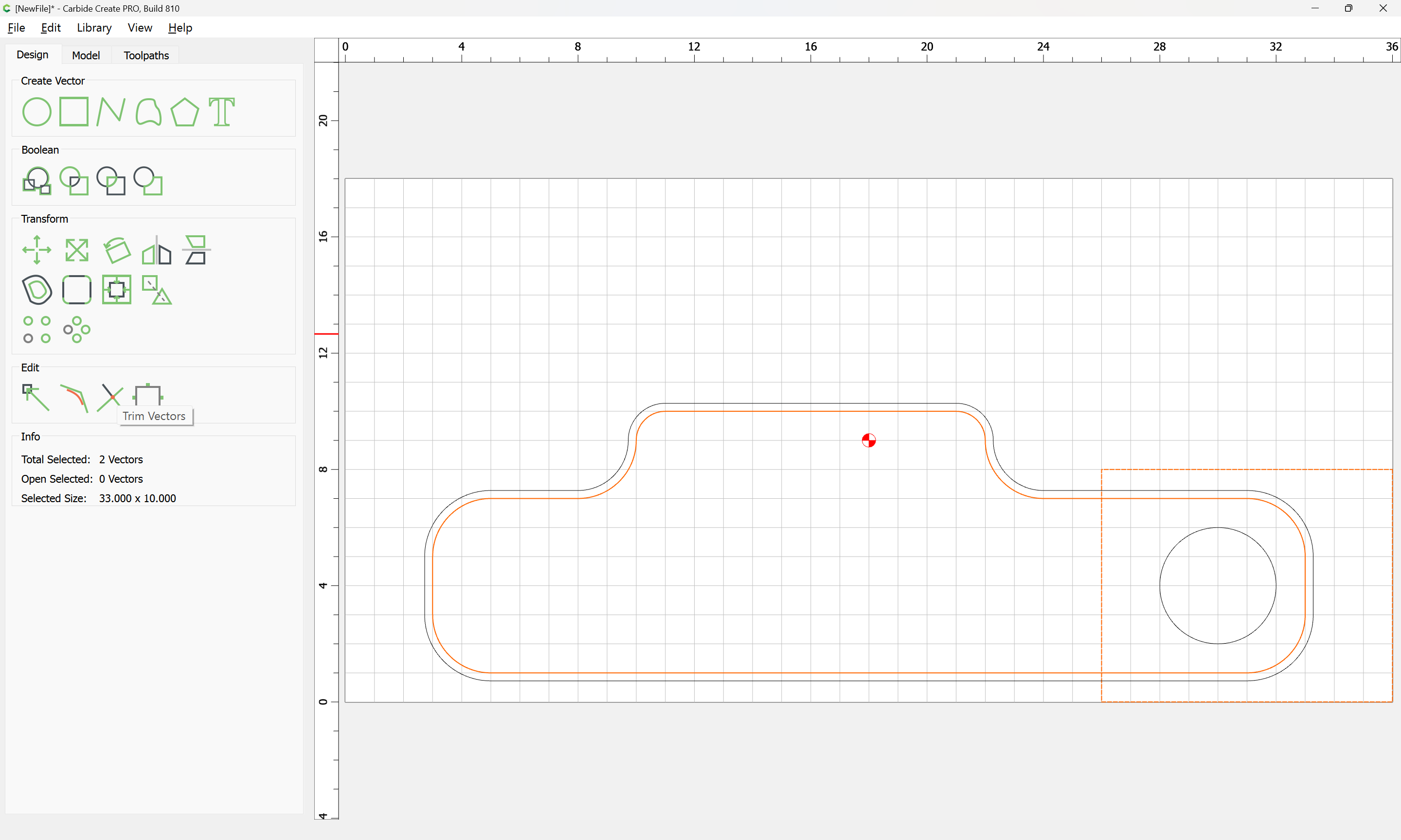

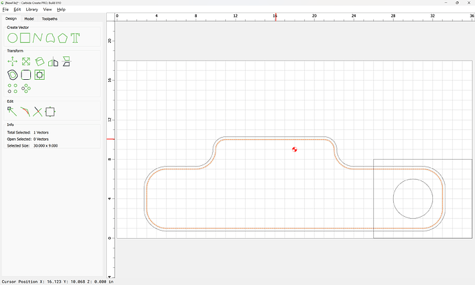

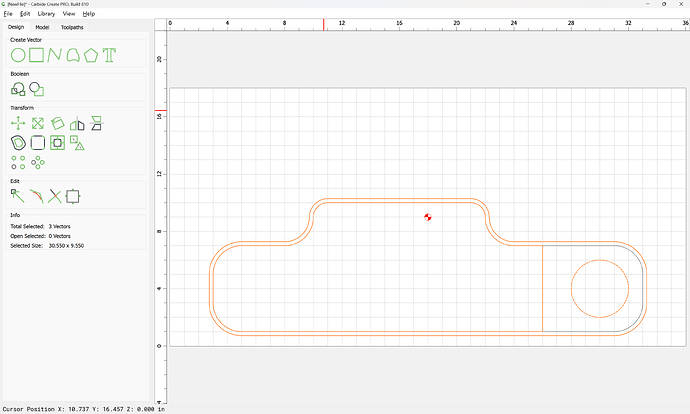

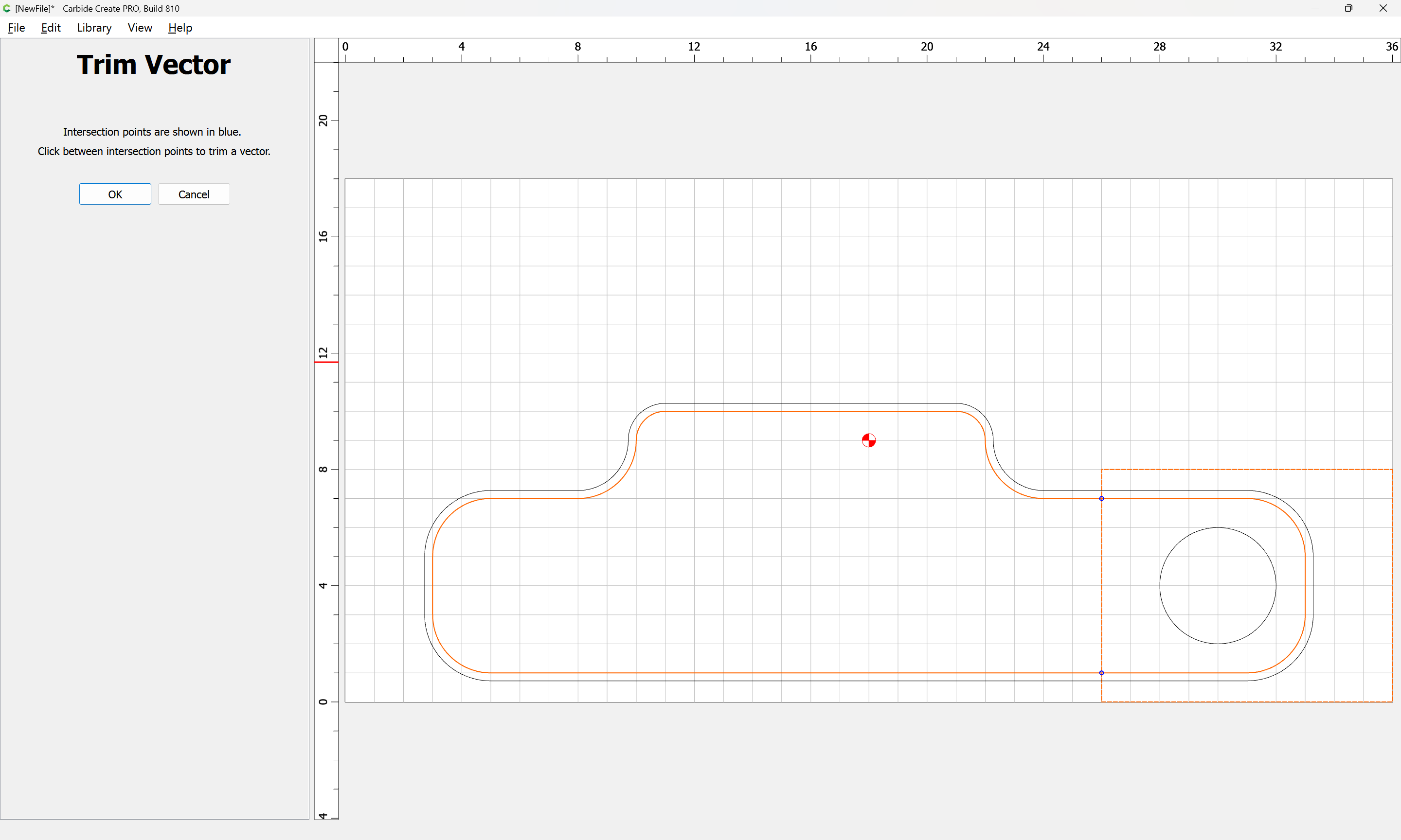

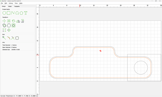

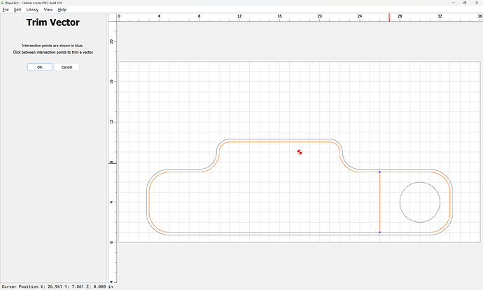

Duplicate the original geometry in place:
shift-click on the rectangle to add it to the selection:

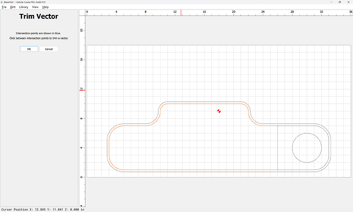

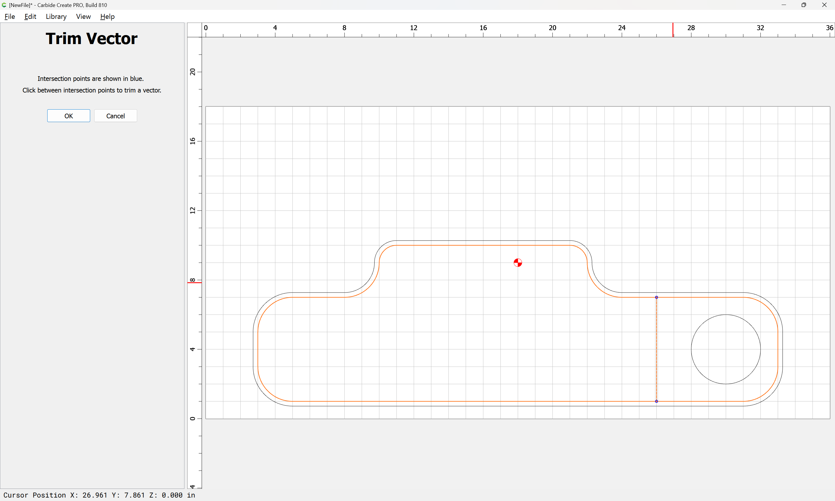

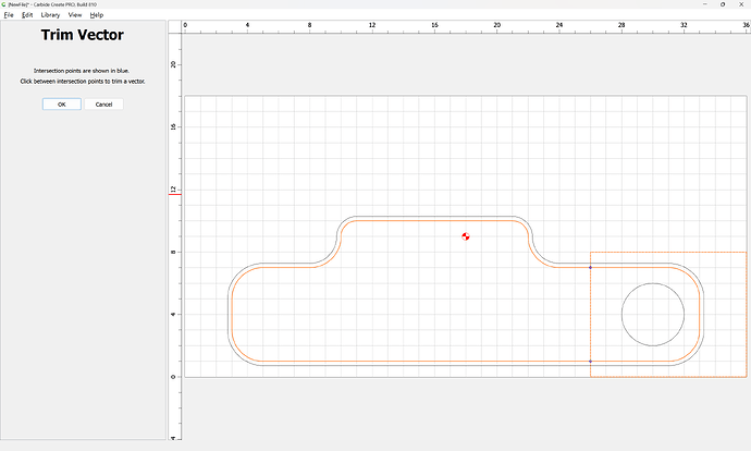

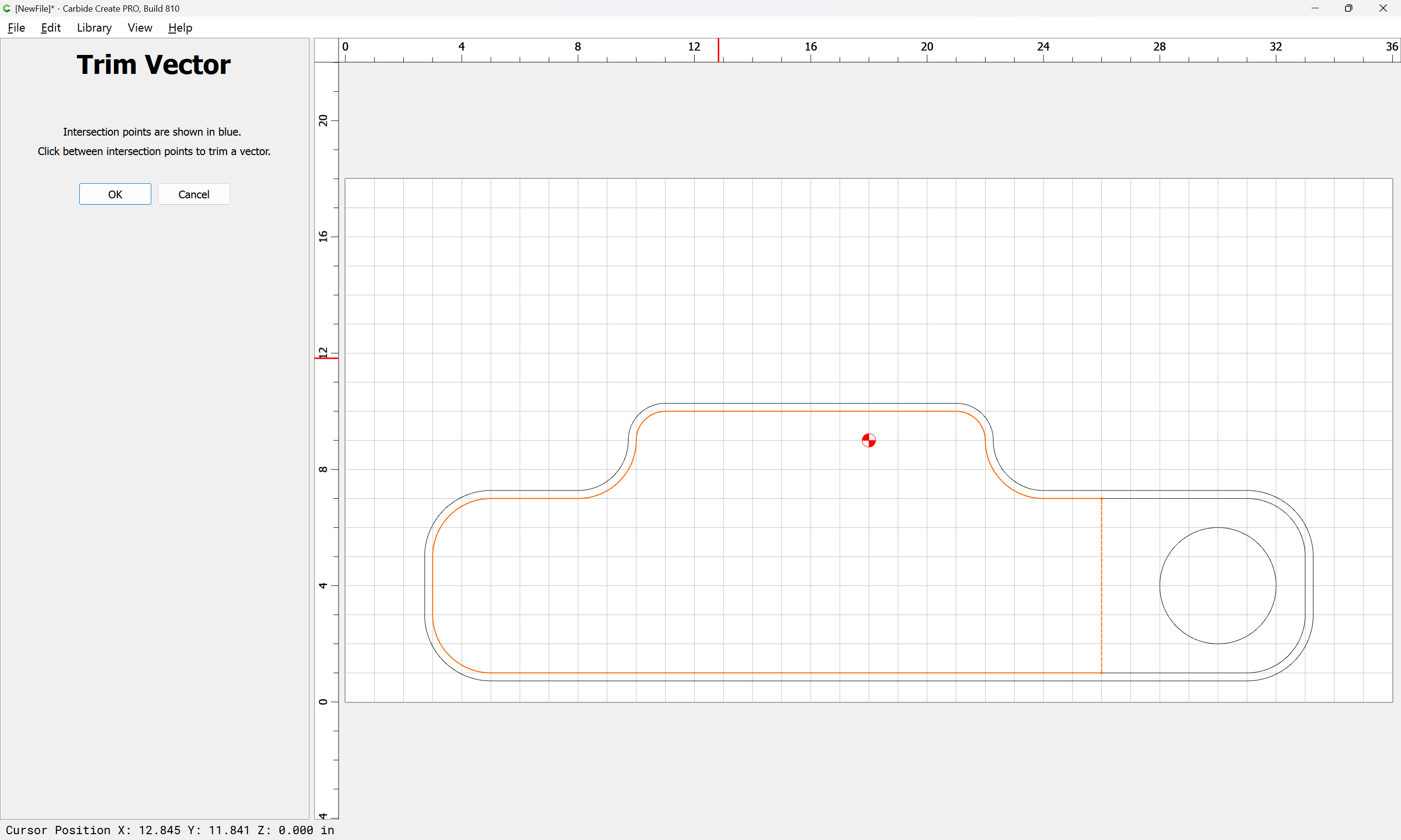

Use Trim Vectors to remove what is not wanted:
until one arrives at:
OK
OK

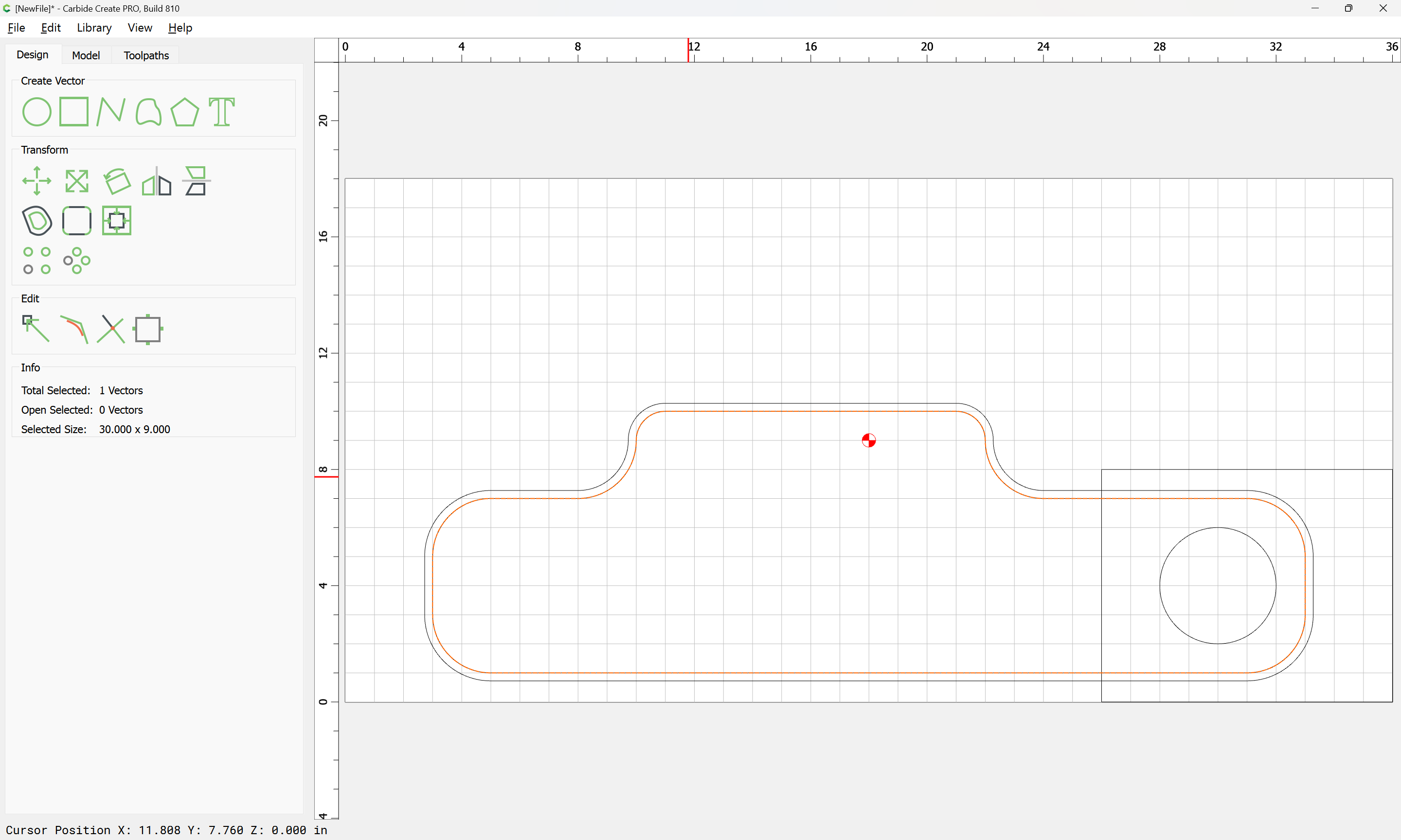

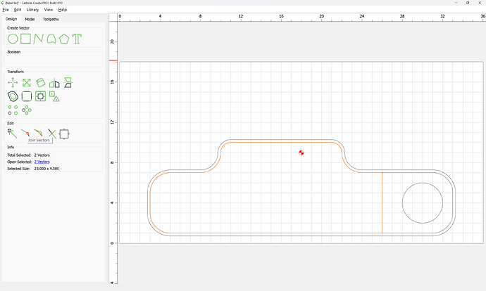

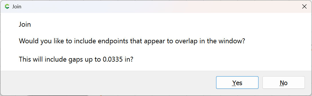

Join Vectors:
Yes
add the offset geometry and the desired island to the selection:

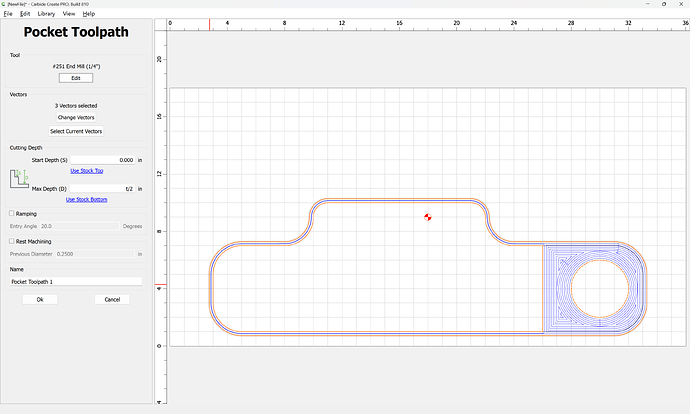

Assign a Pocket Toolpath to the desired depth:

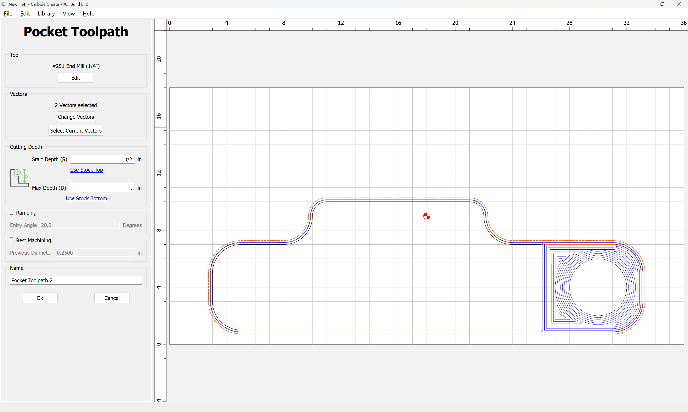

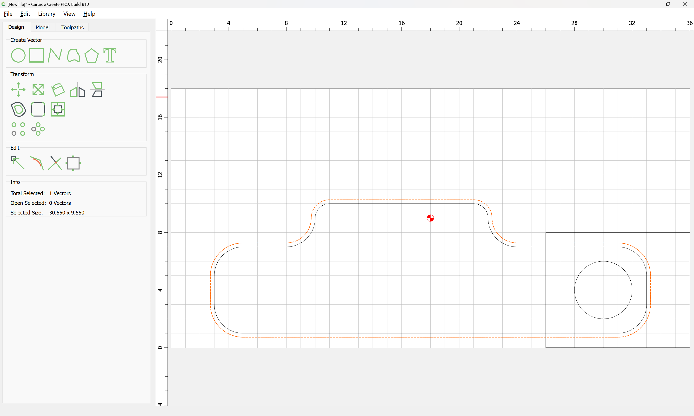

Then select the original part geometry and the offset geometry:

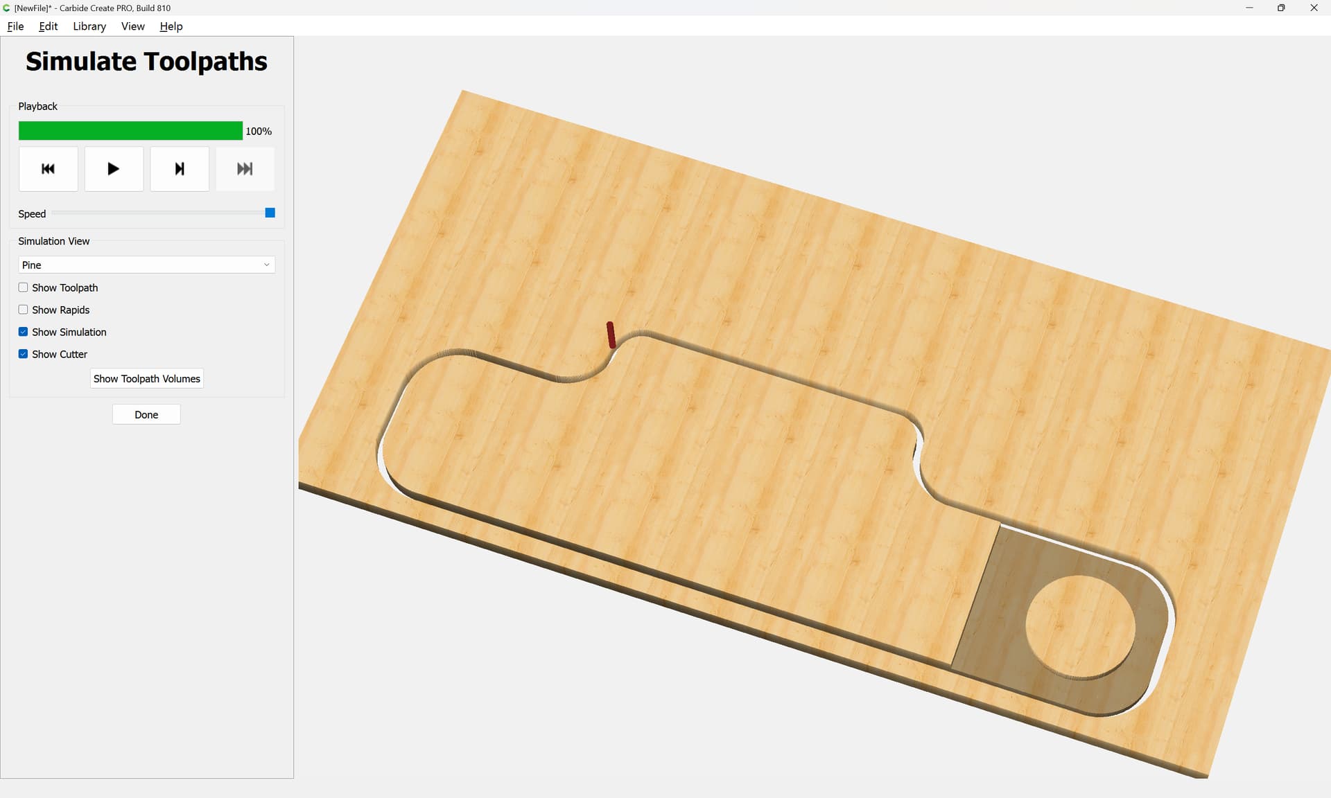

and assign a Pocket Toolpath which starts at the bottom of the previous pocket and cuts to the desired depth:
(probably Stock Thickness less tab height, then finish with a Contour toolpath which respects tabs)
which previews as:
