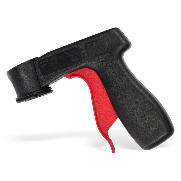

I have an air brush. You have to have the right paint for it to work well. Plus it takes longer to clean the air brush than it does to paint your work. It is handy to have an airbrush but there are times where it is more of a pain than other methods. Rattle cans work but it is easy to spray too much. If I use a rattle can use a spray can handle.
It helps keep my finger from getting tired and also helps point at the project better.
