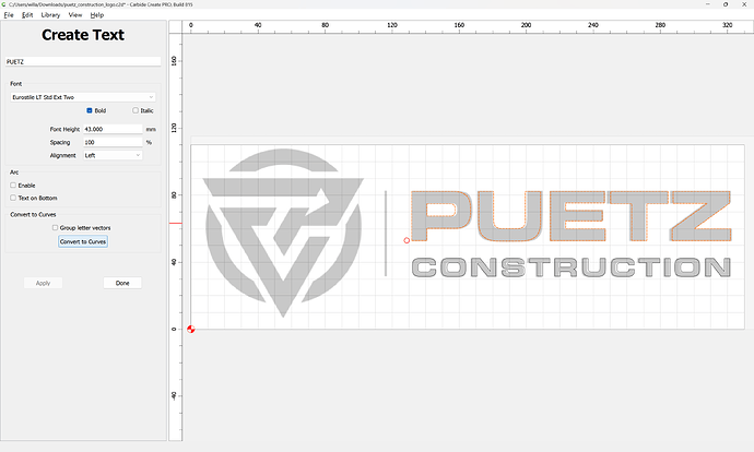

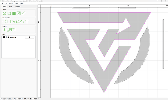

as requested on support…

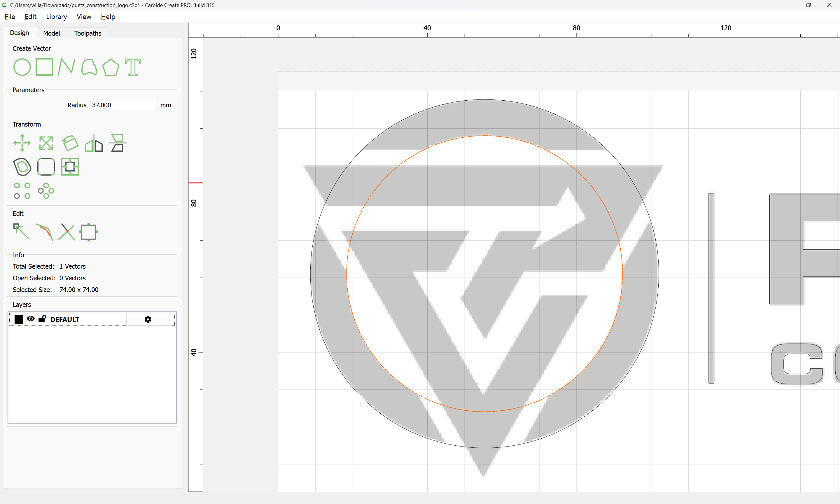

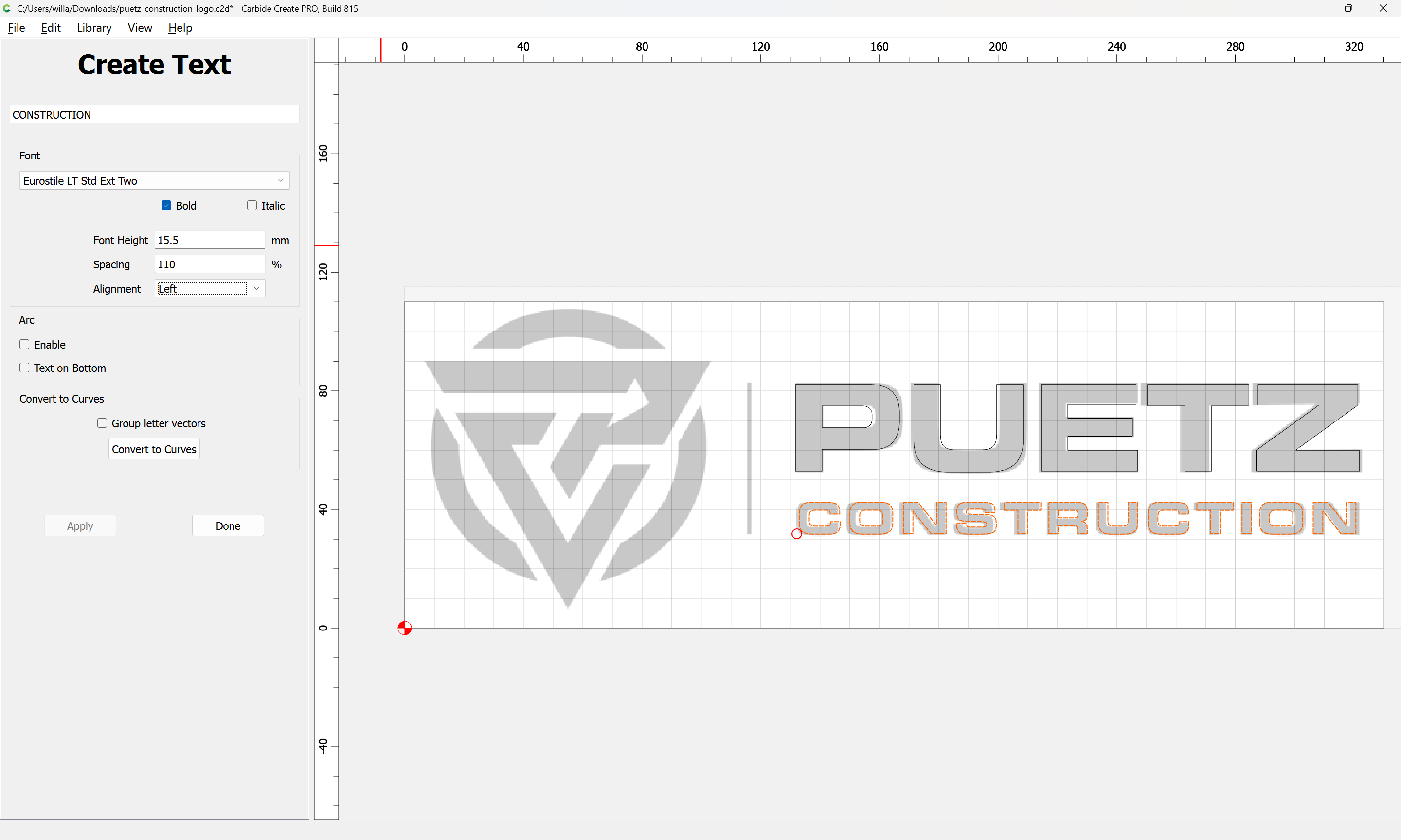

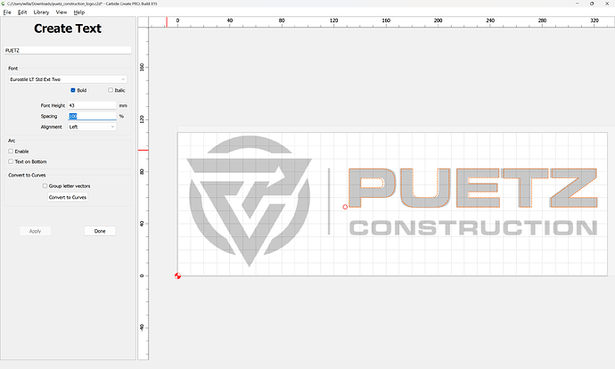

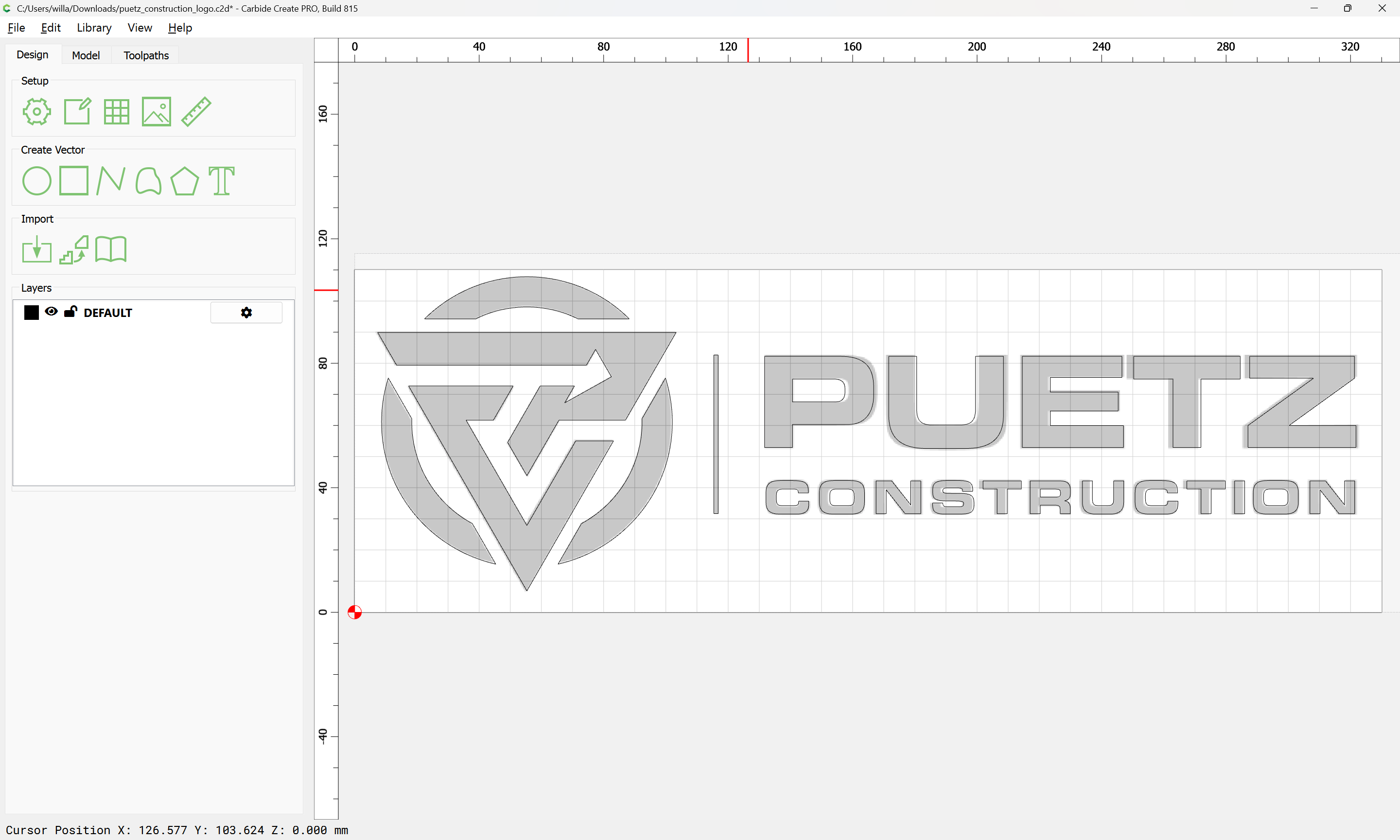

given the image:
which does not trace well with default settings, we re-set the text and re-draw it.

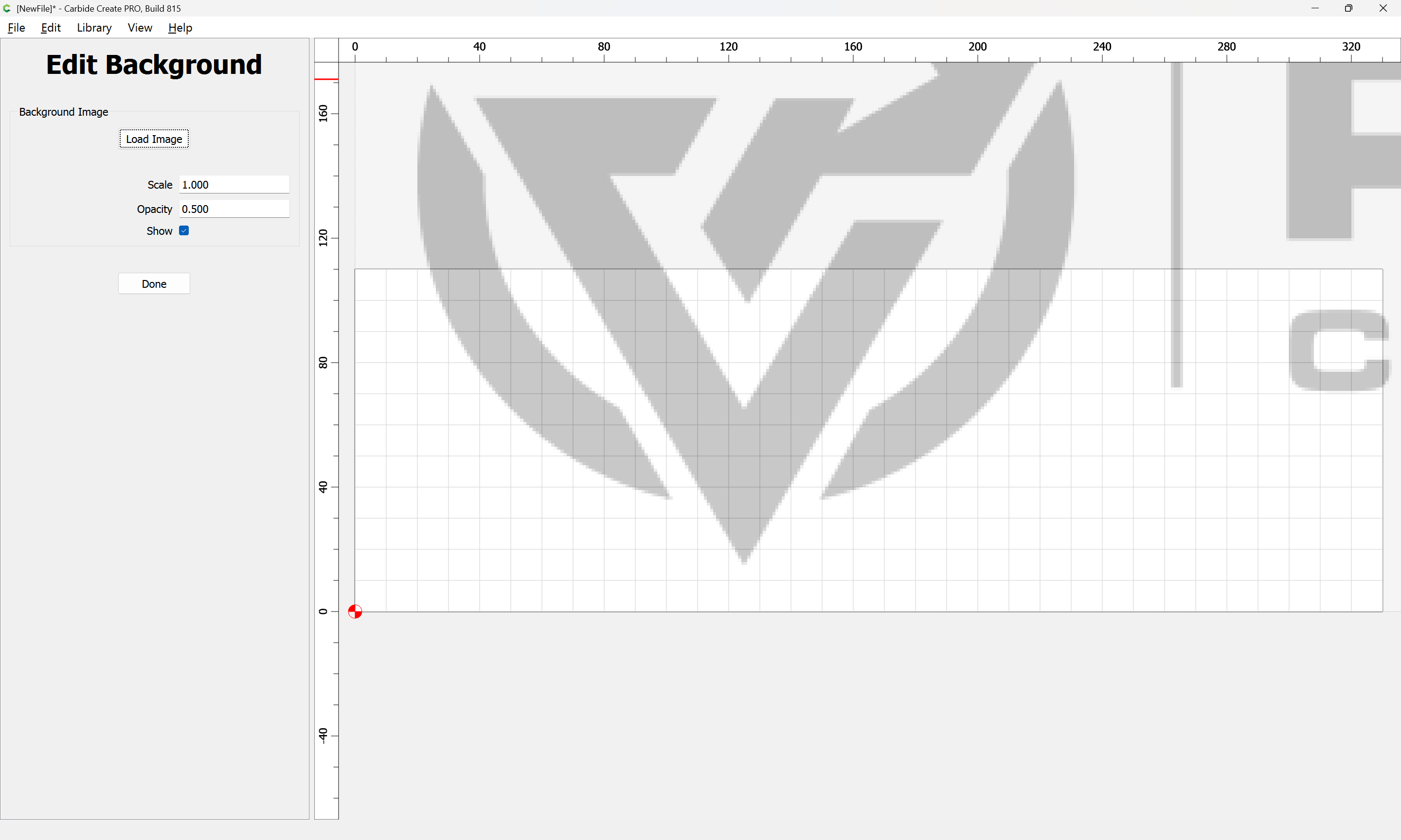

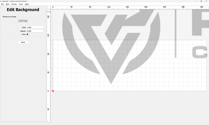

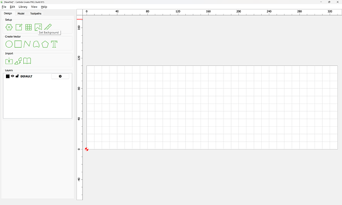

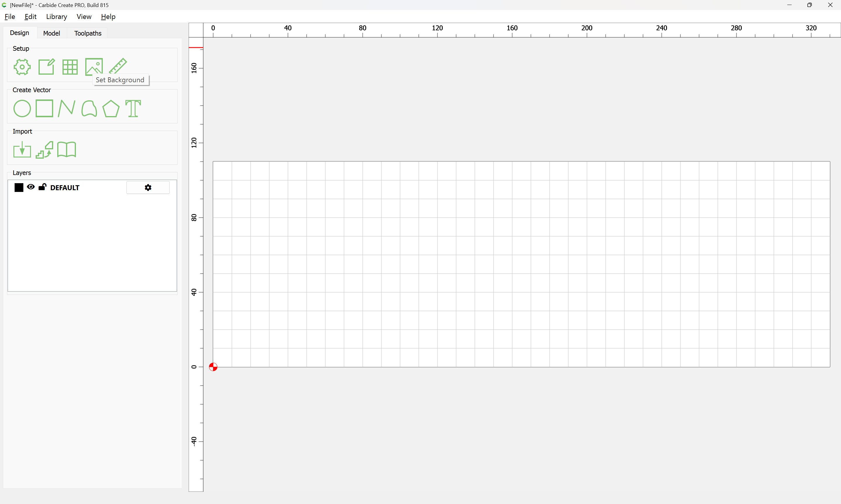

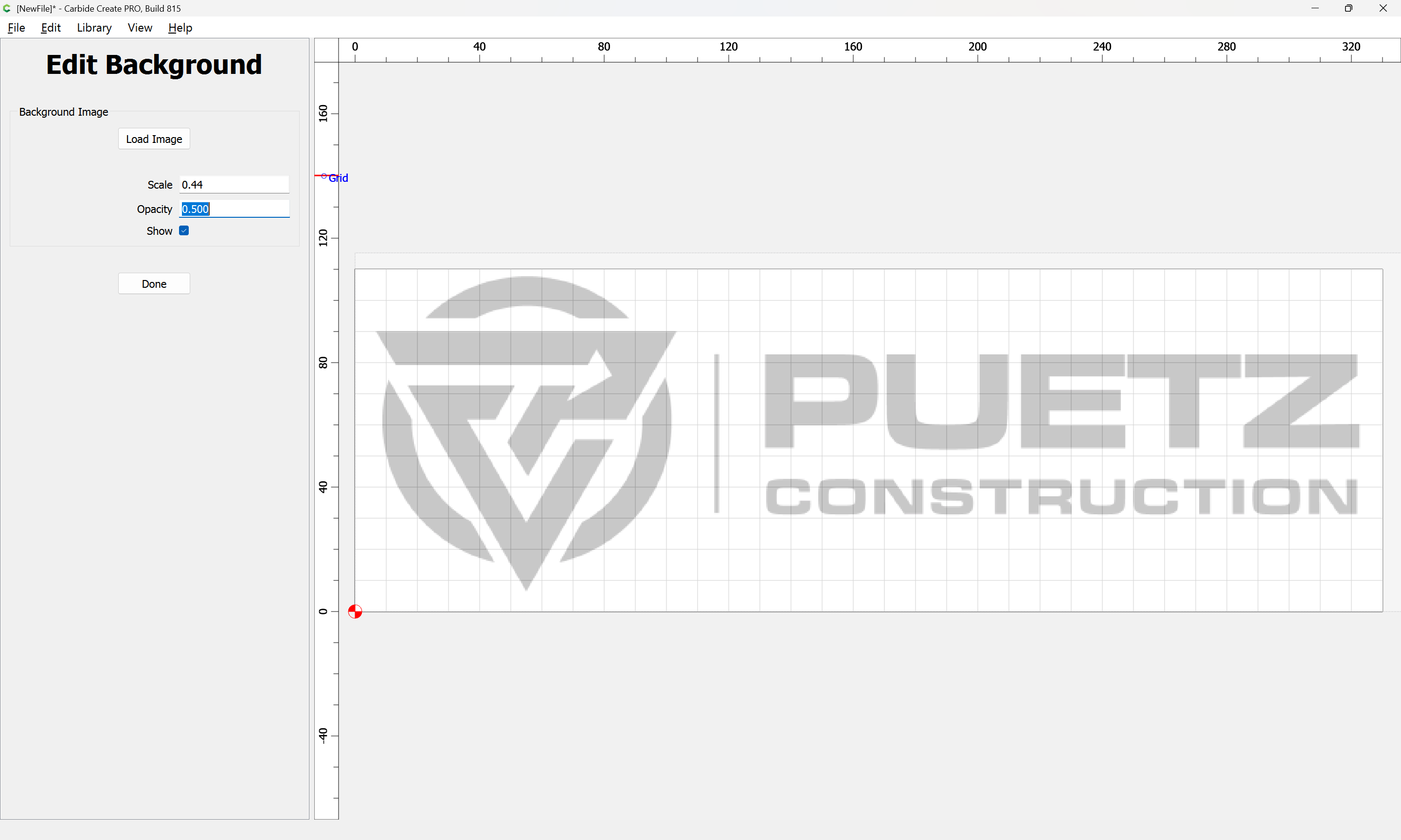

First, import the pixel image:
Set Background
and adjust until a reasonable size/detail:

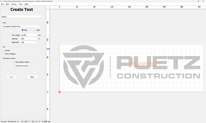

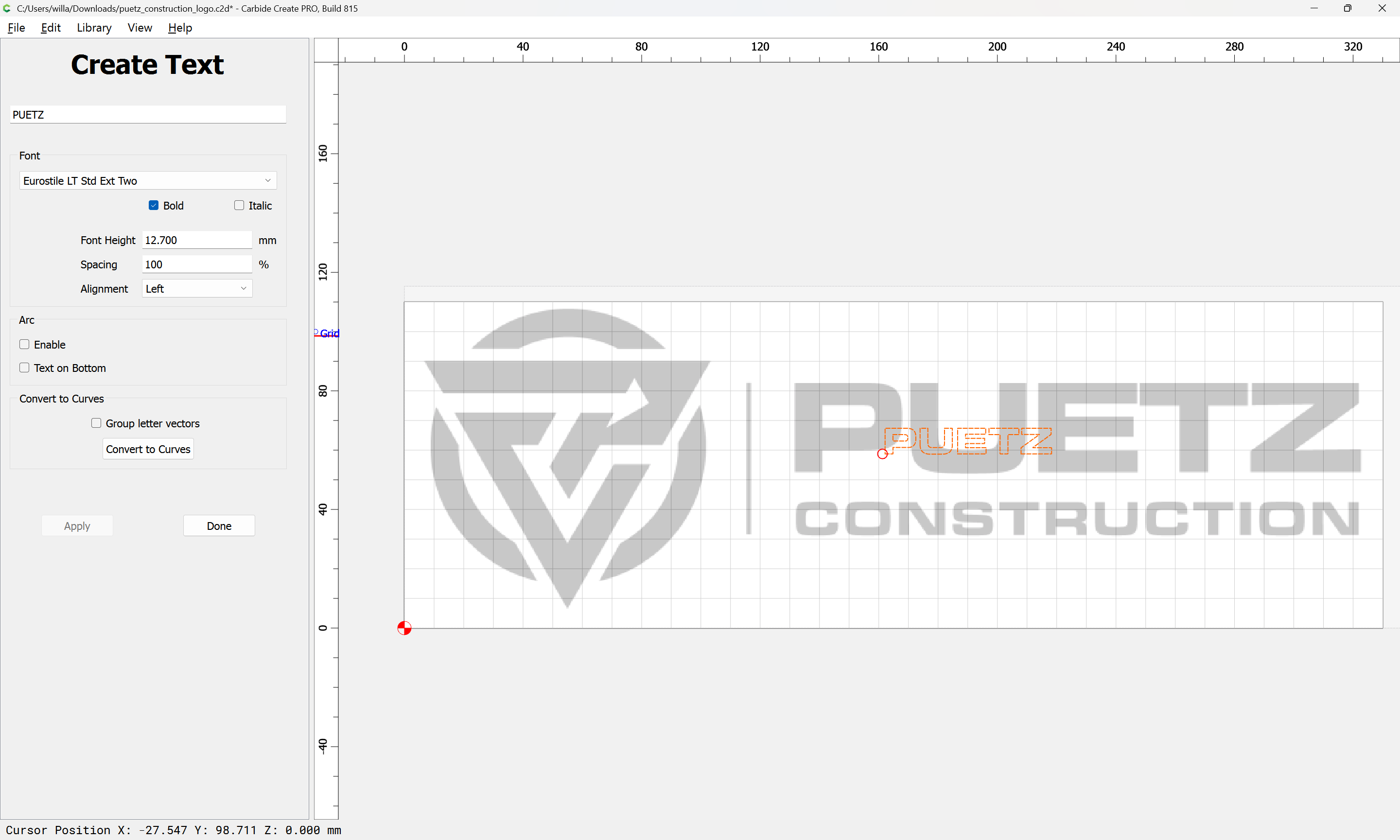

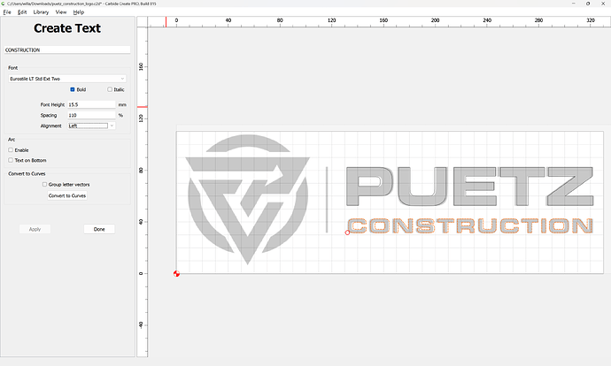

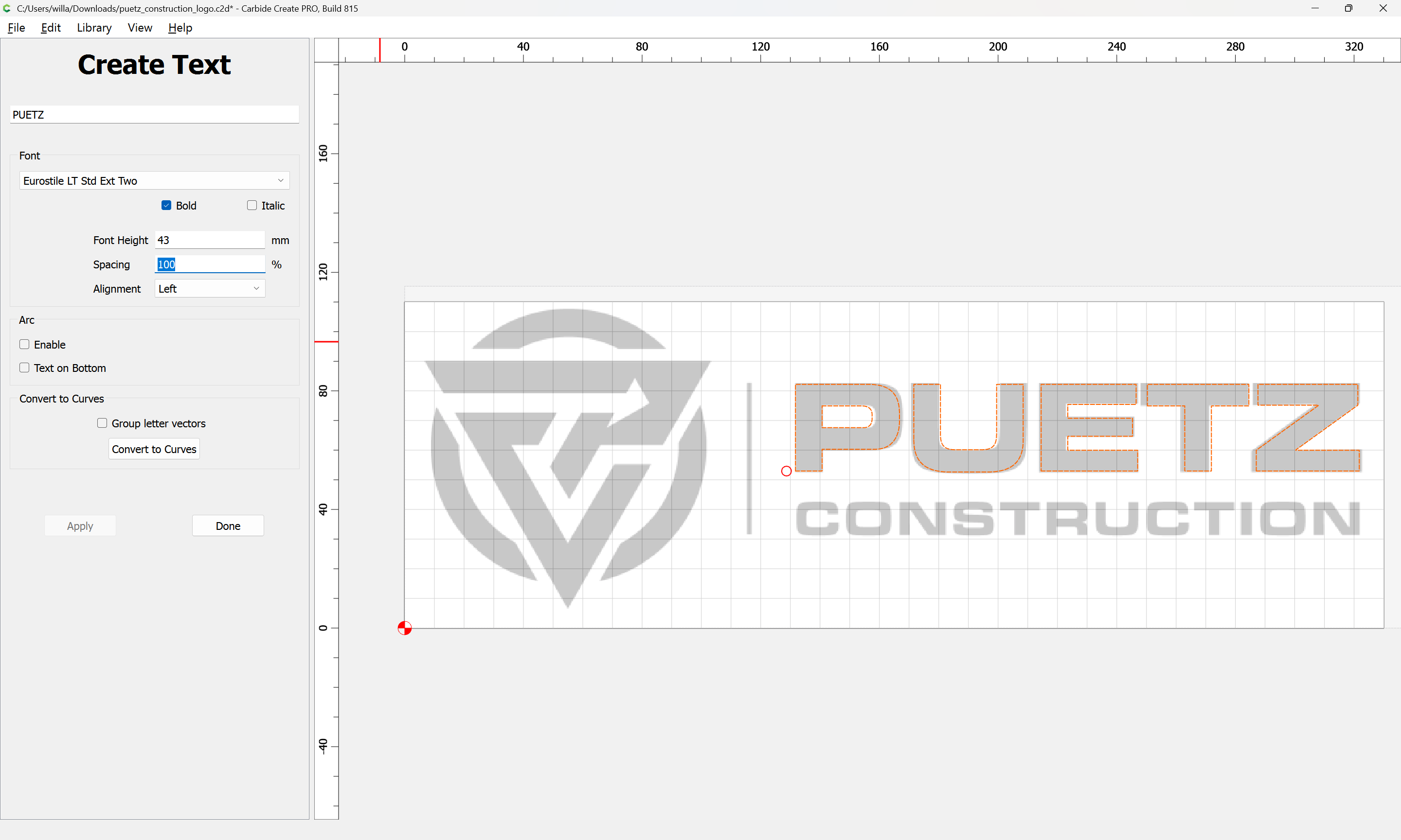

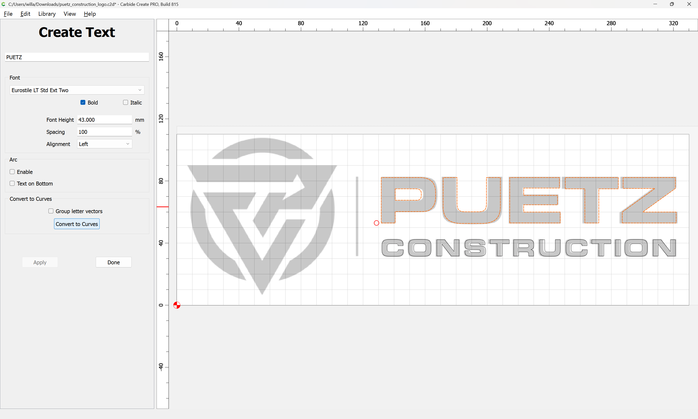

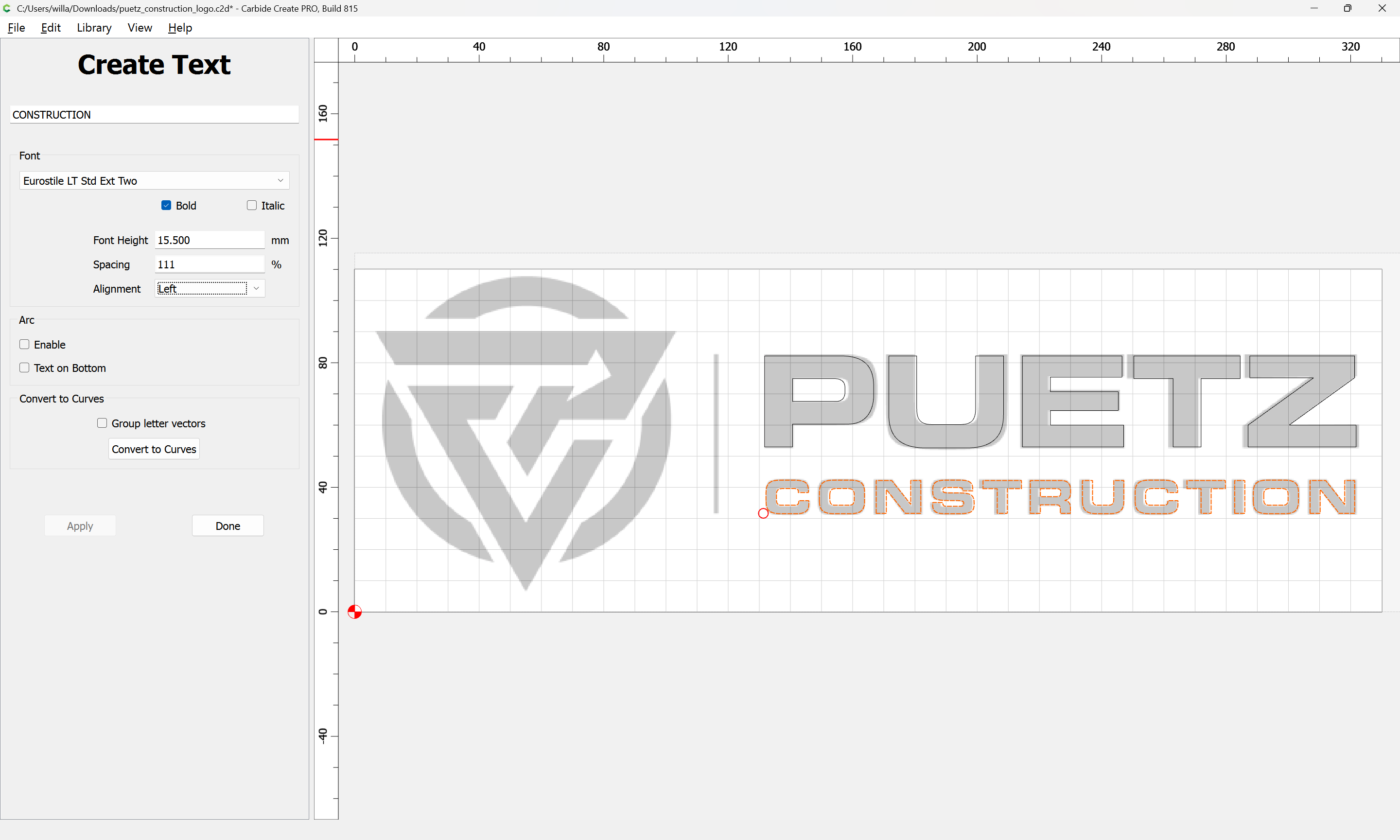

Re-set the text (Aldo Novarese’s Eurostile Bold Extended):
then convert to curves and redraw the balance…
WillAdams
(William Adams (Carbide 3D))
2

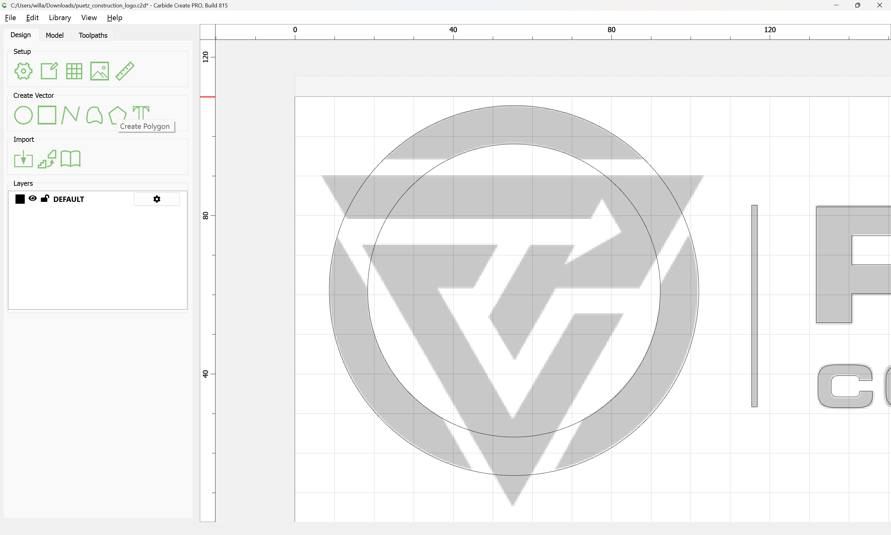

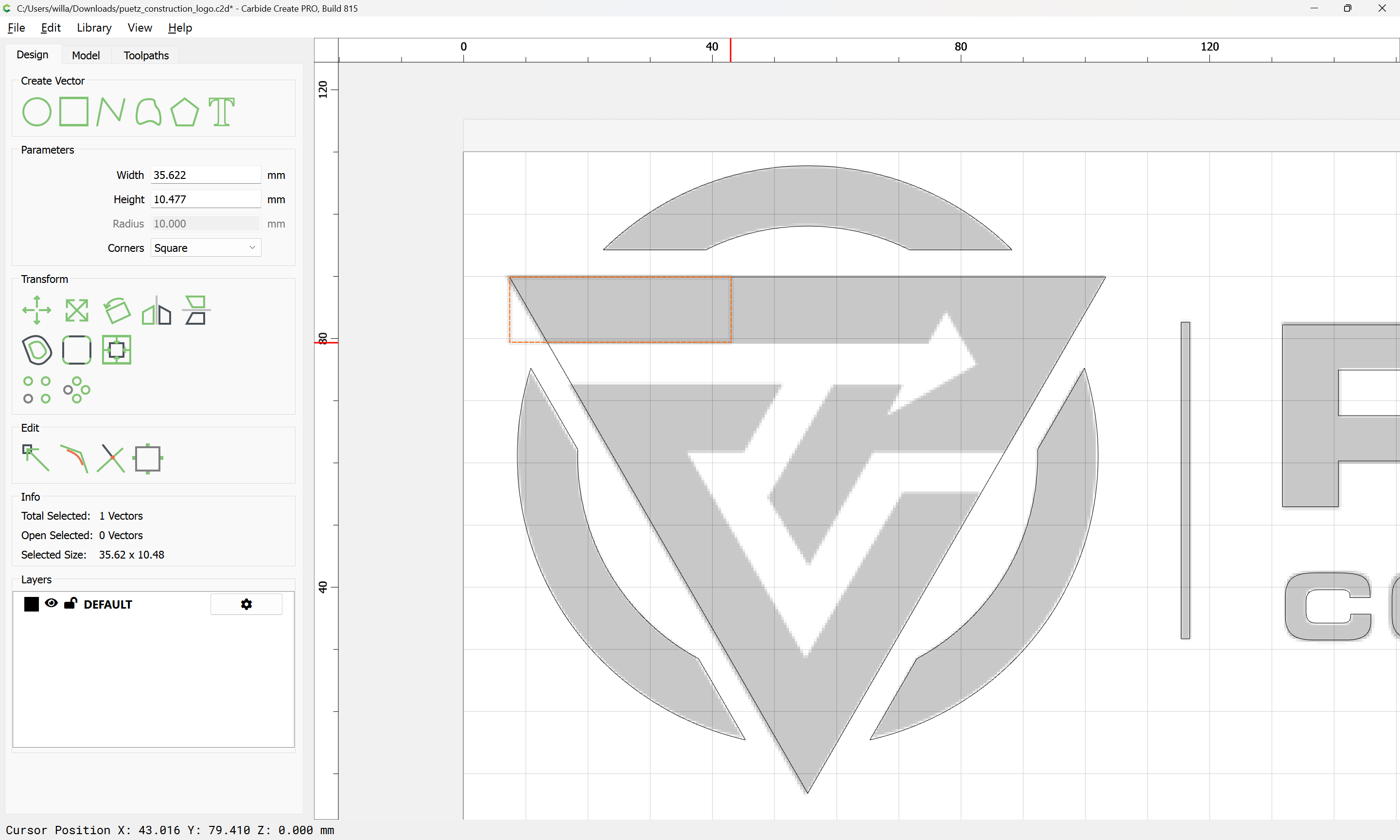

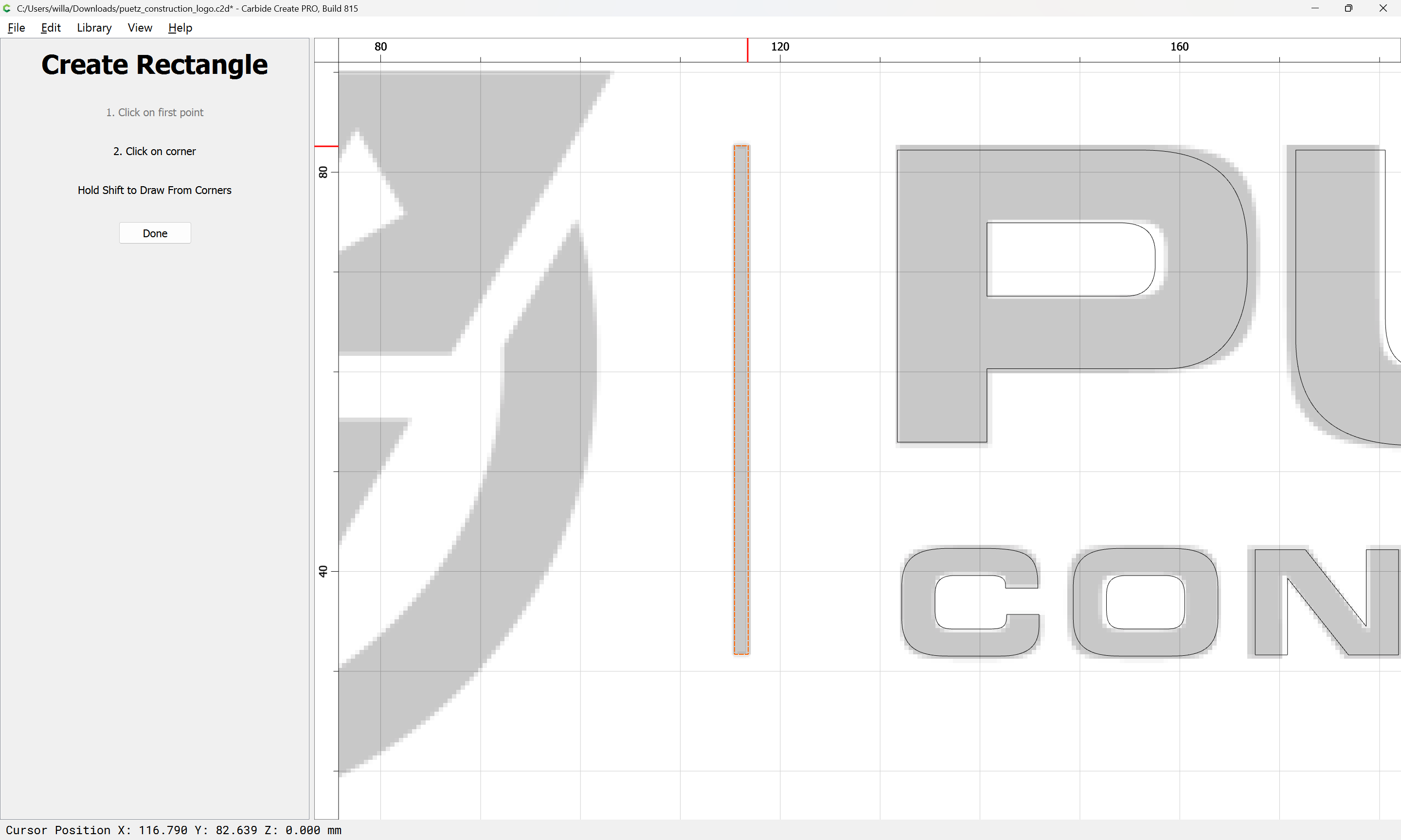

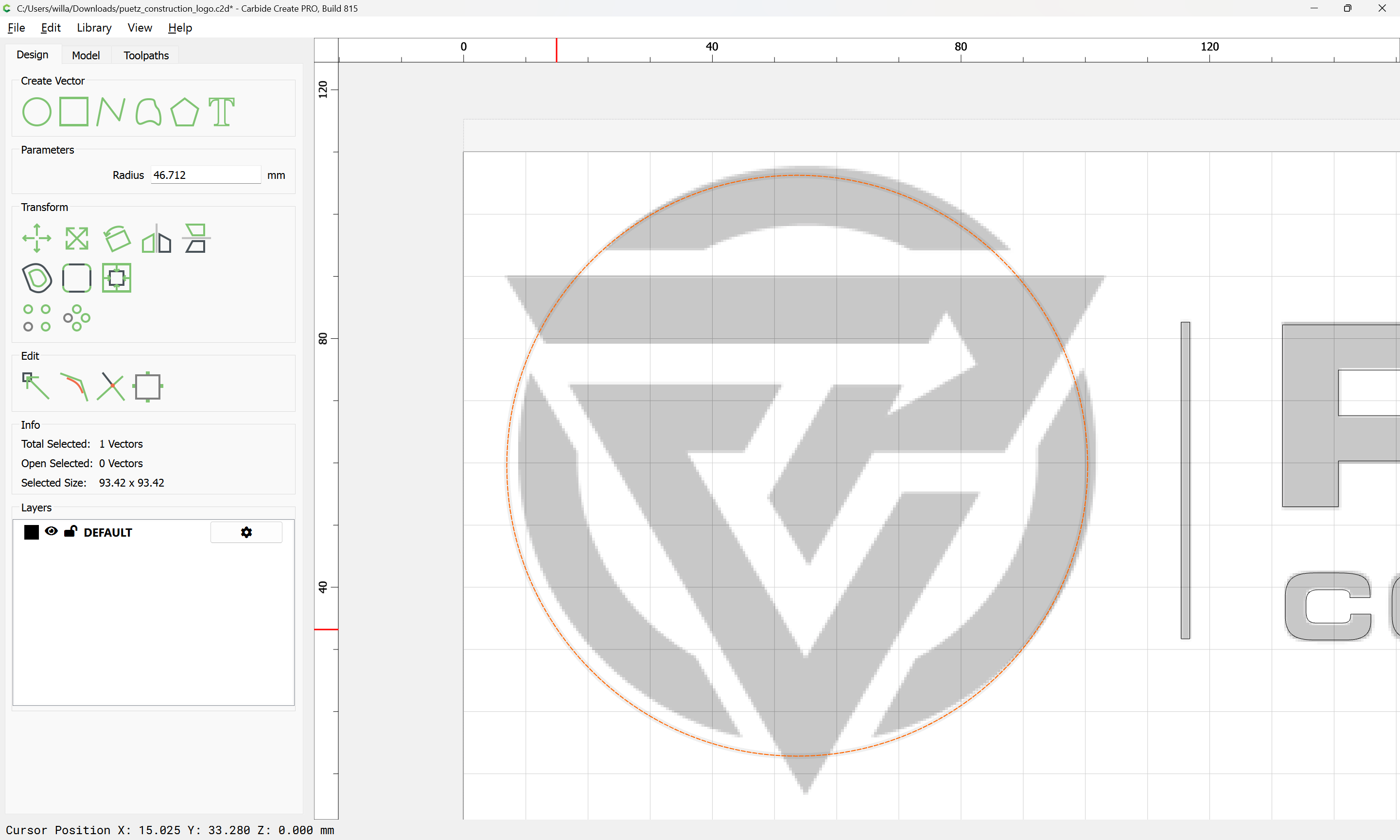

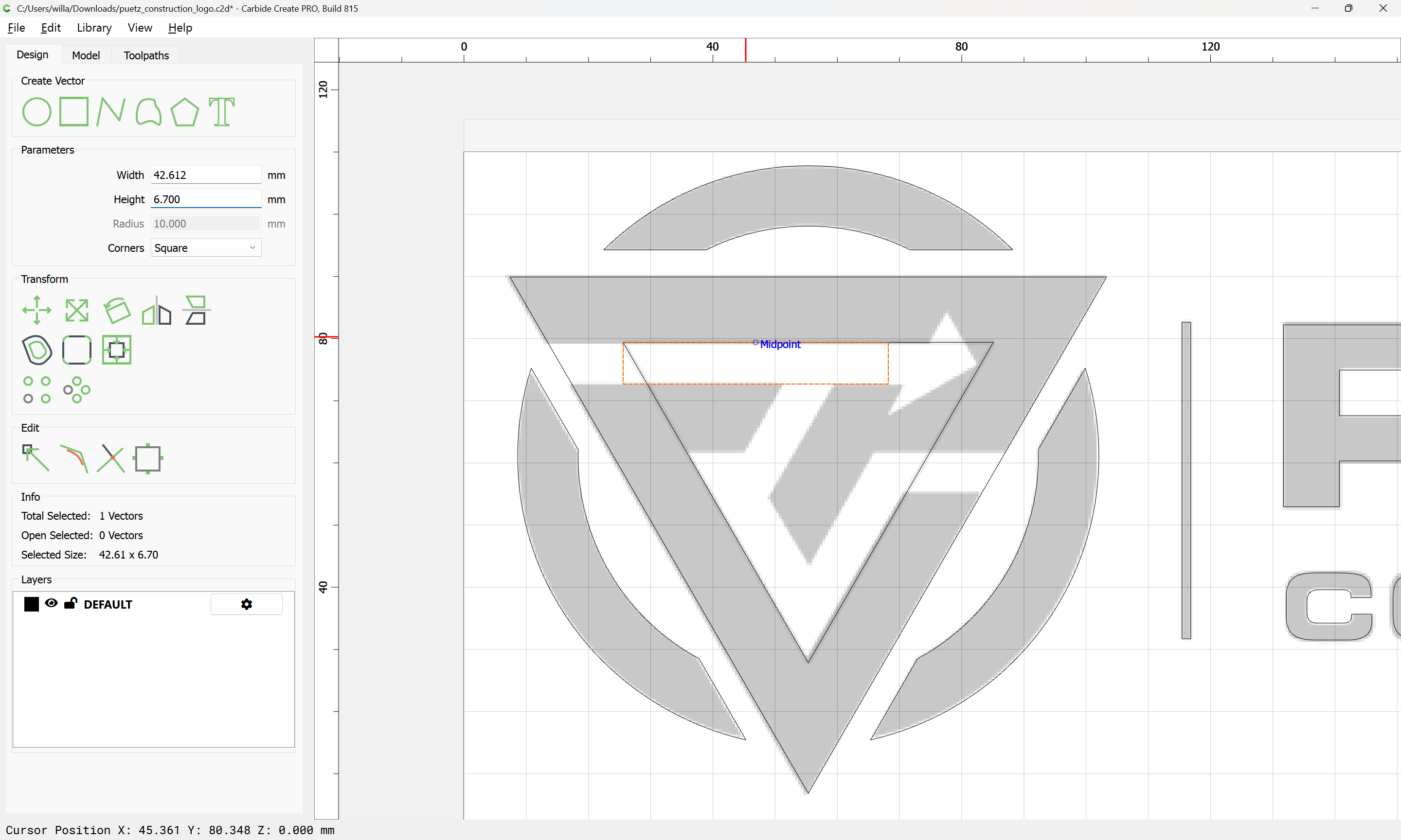

Rectangles are trivial:
as are the circular elements:

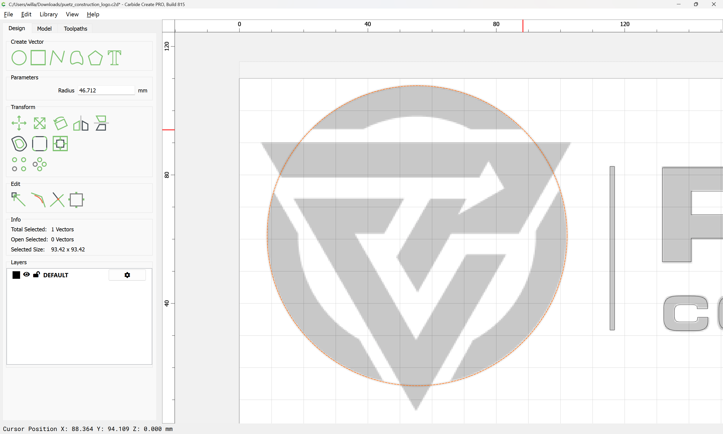

adjust as needed to get things to line up:
then duplicate in place by copy-pasting:
and adjust the size:

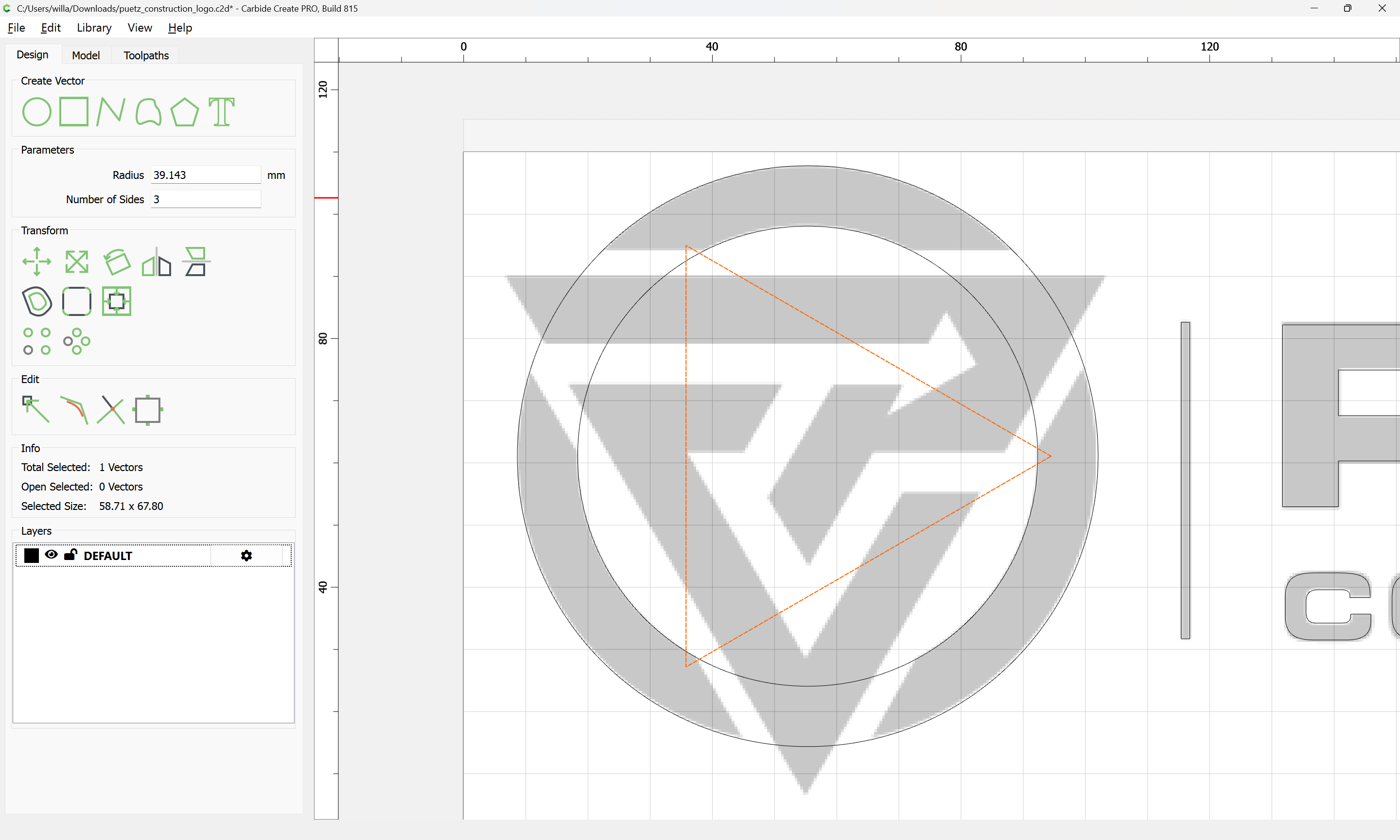

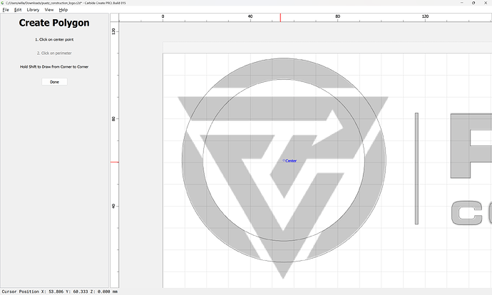

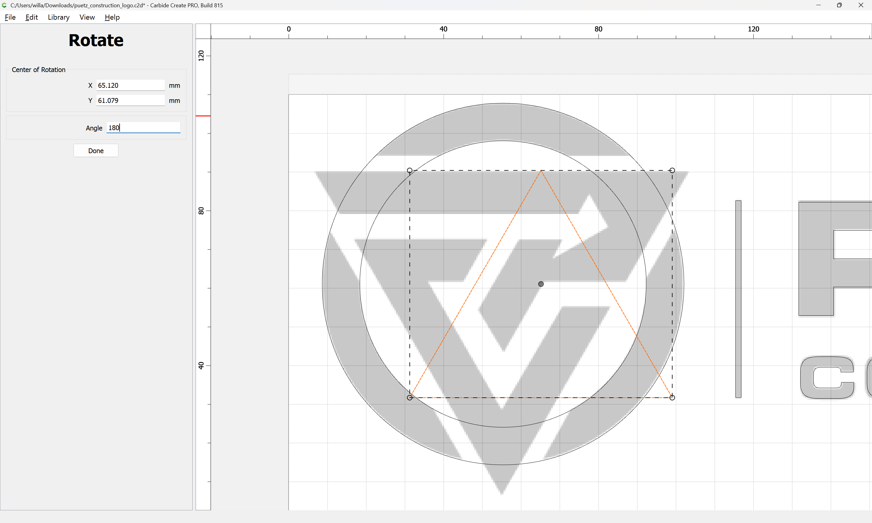

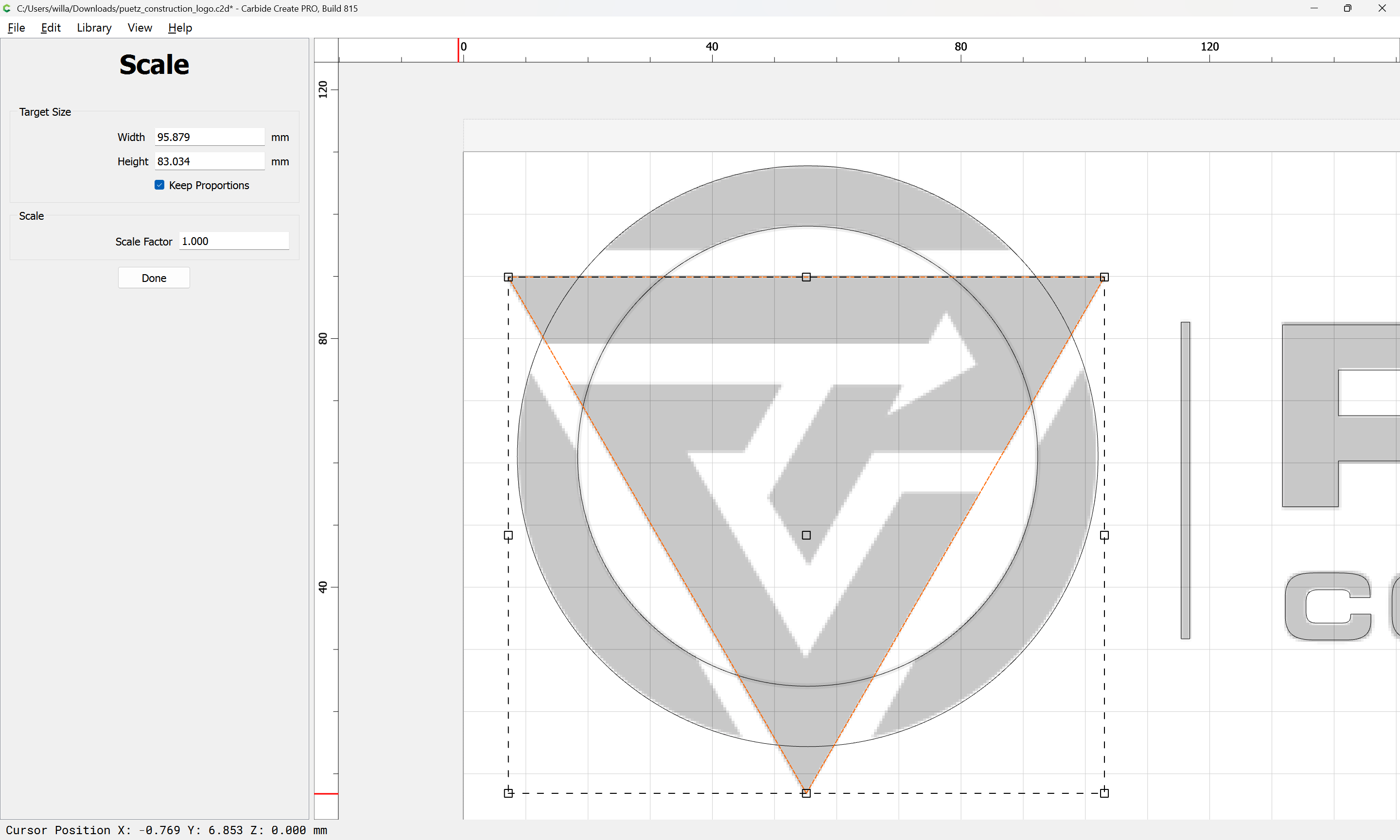

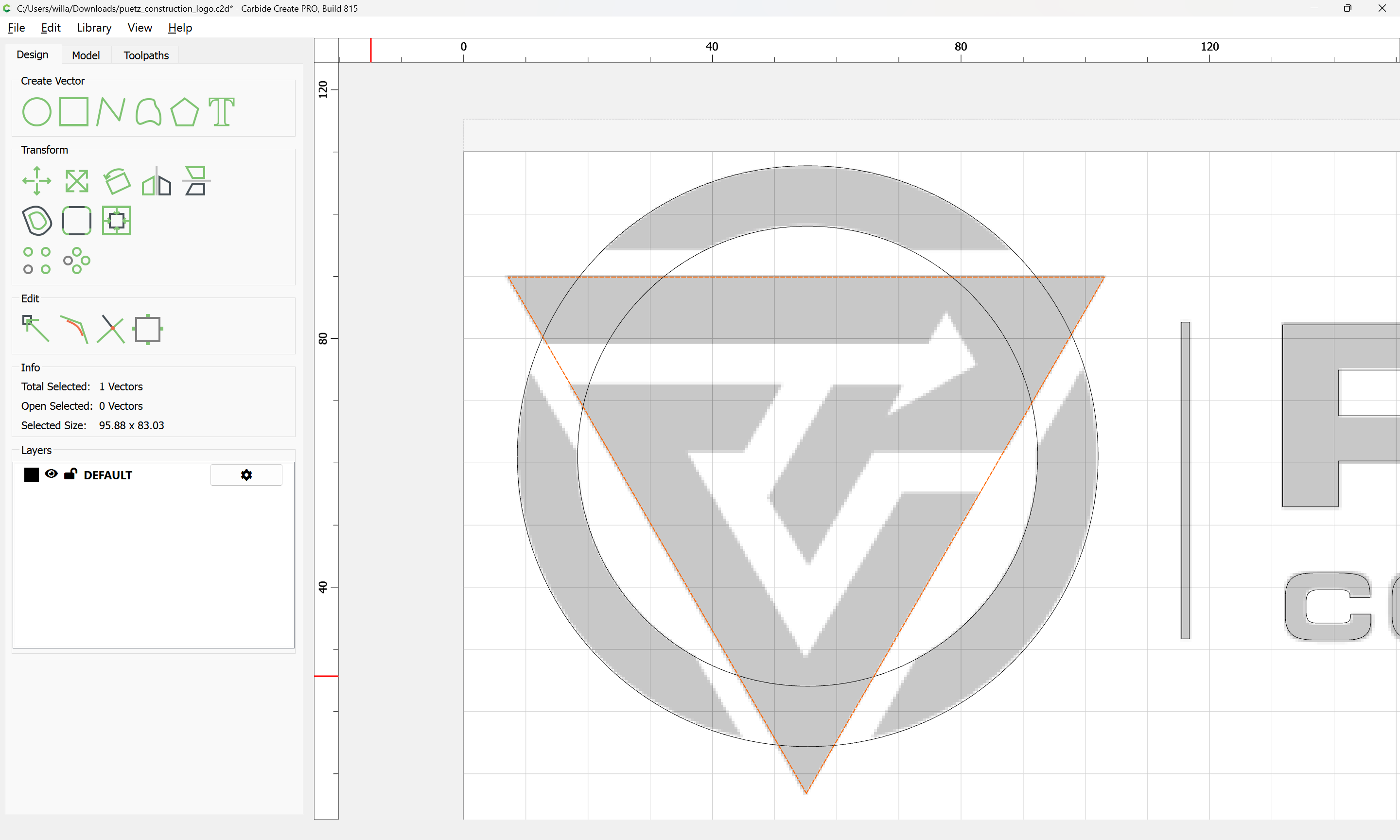

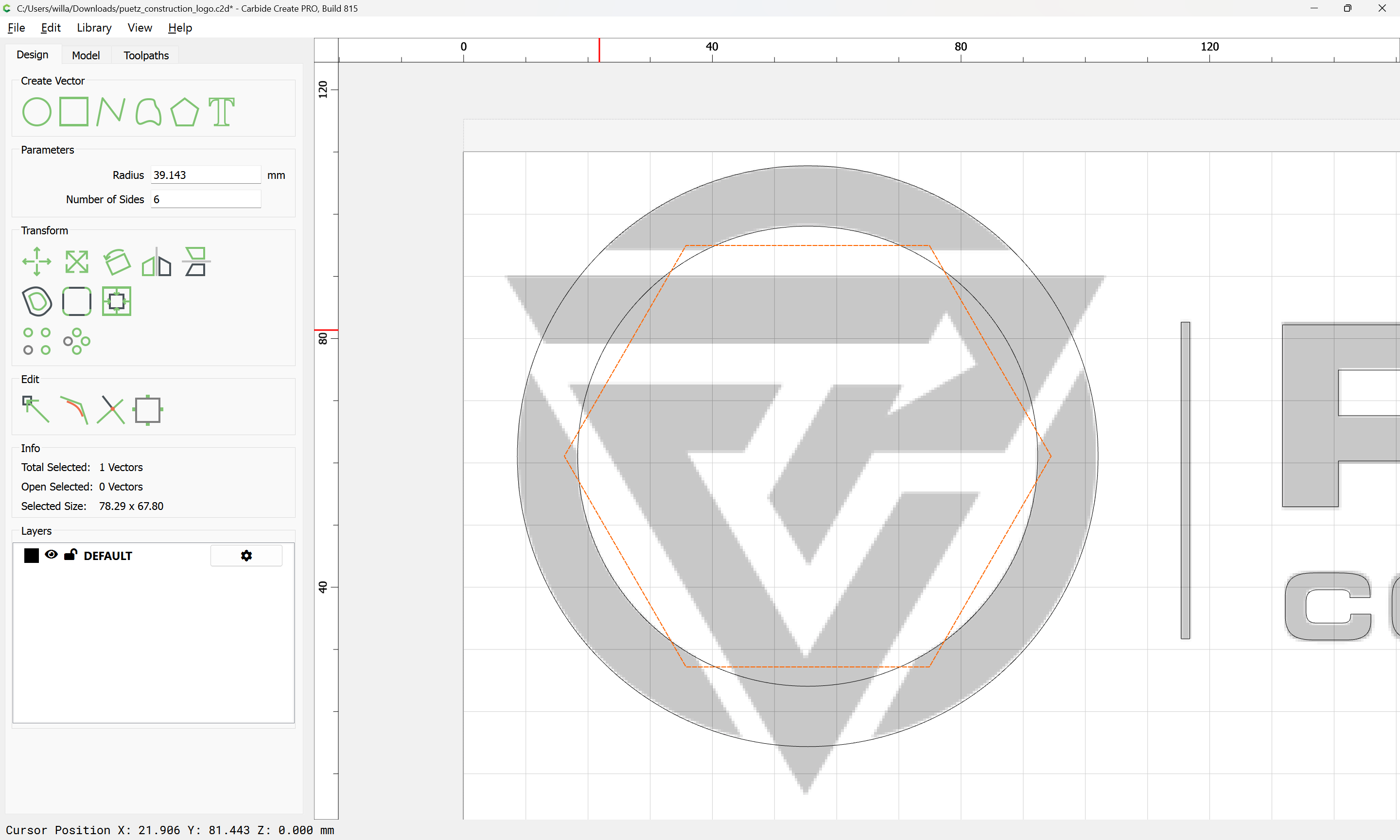

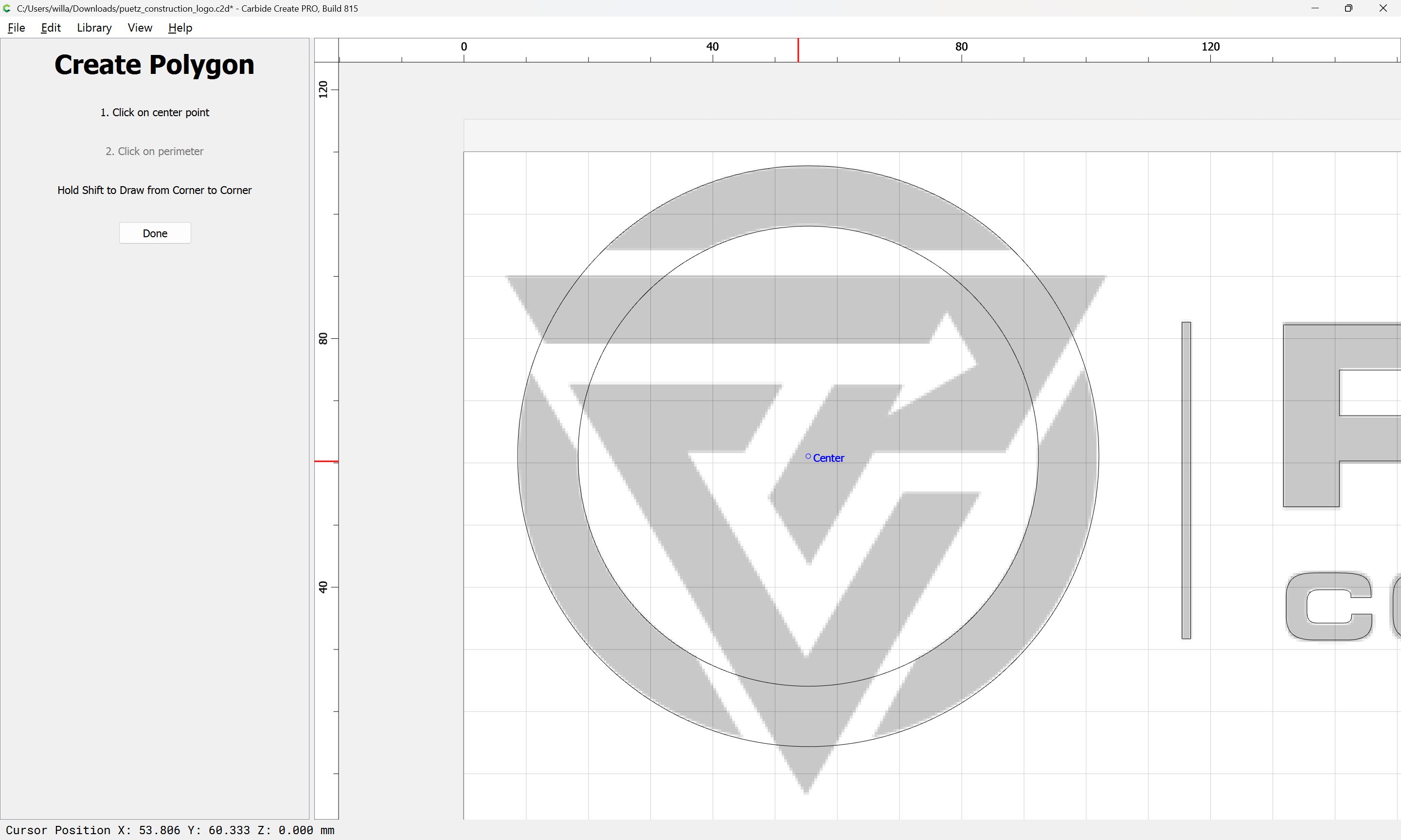

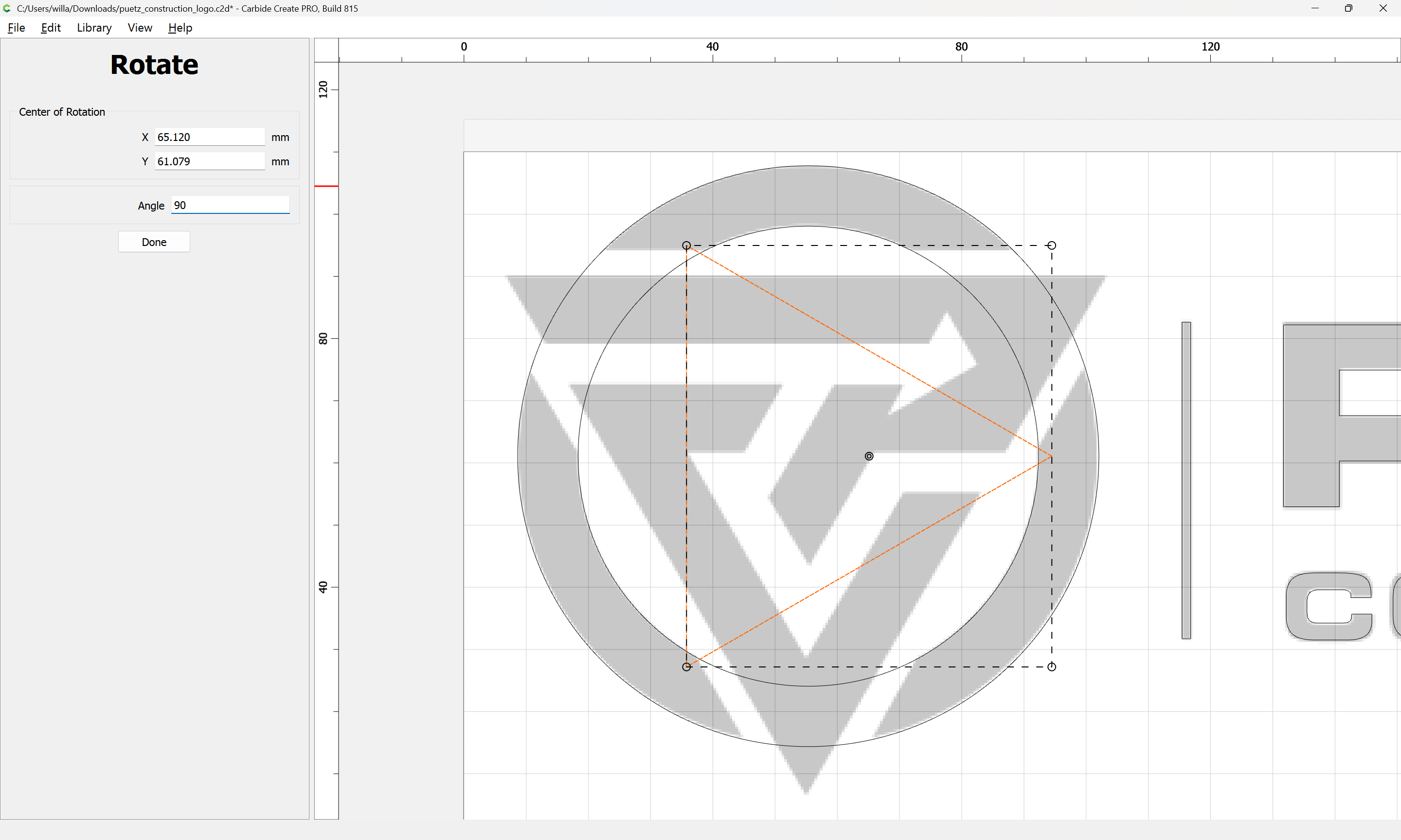

Then draw a polygon from the center:
and adjust the number of sides:

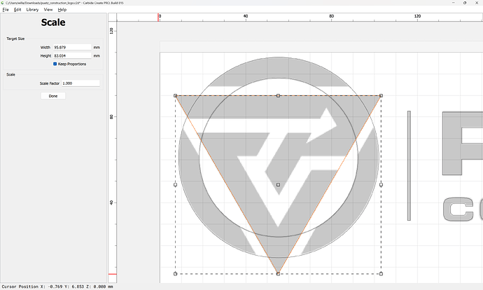

and then rotate and scale/position:
Done

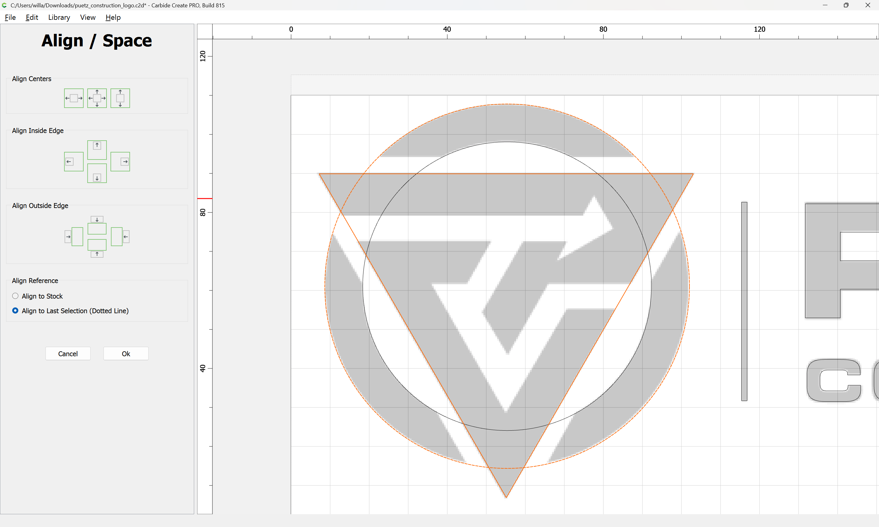

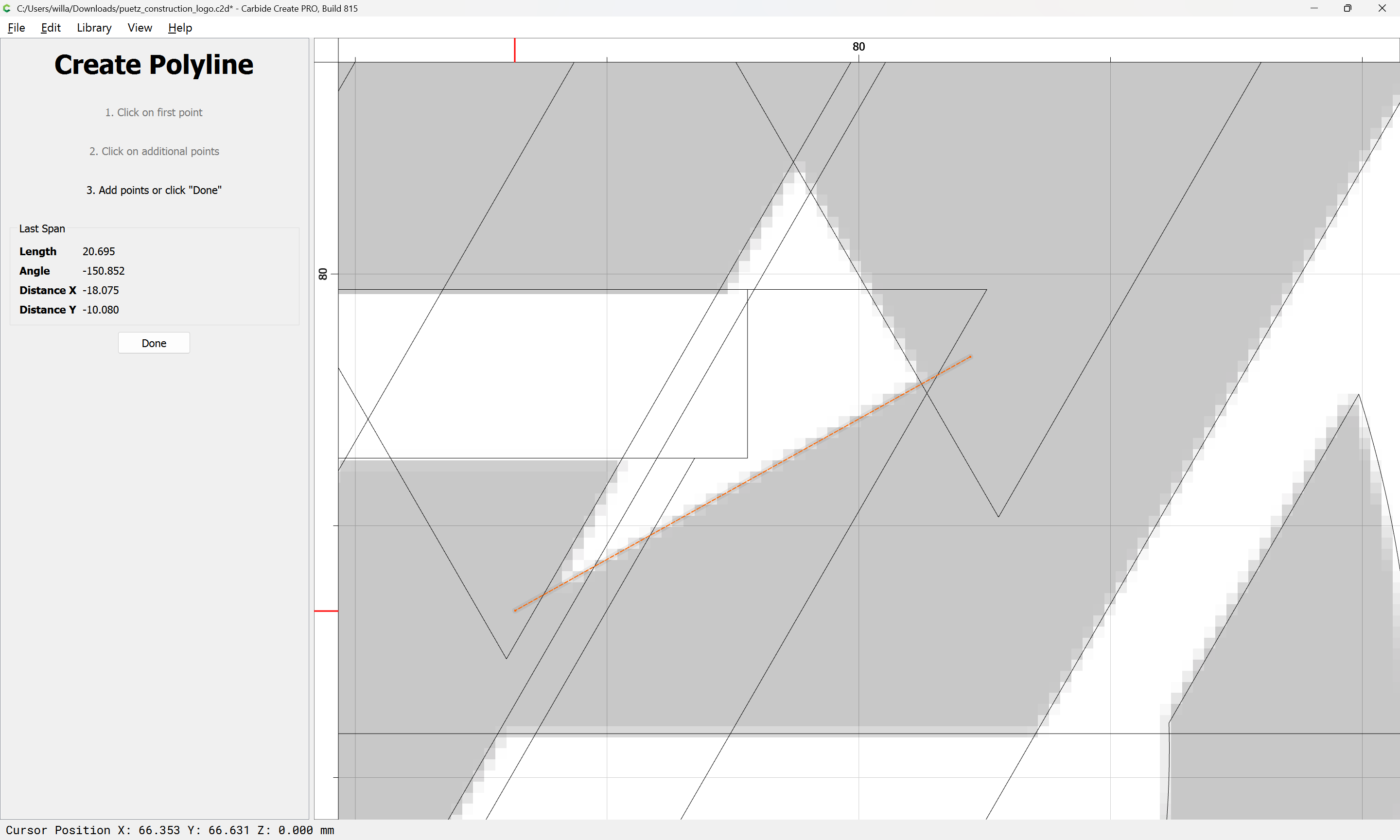

align to ensure things are symmetric:

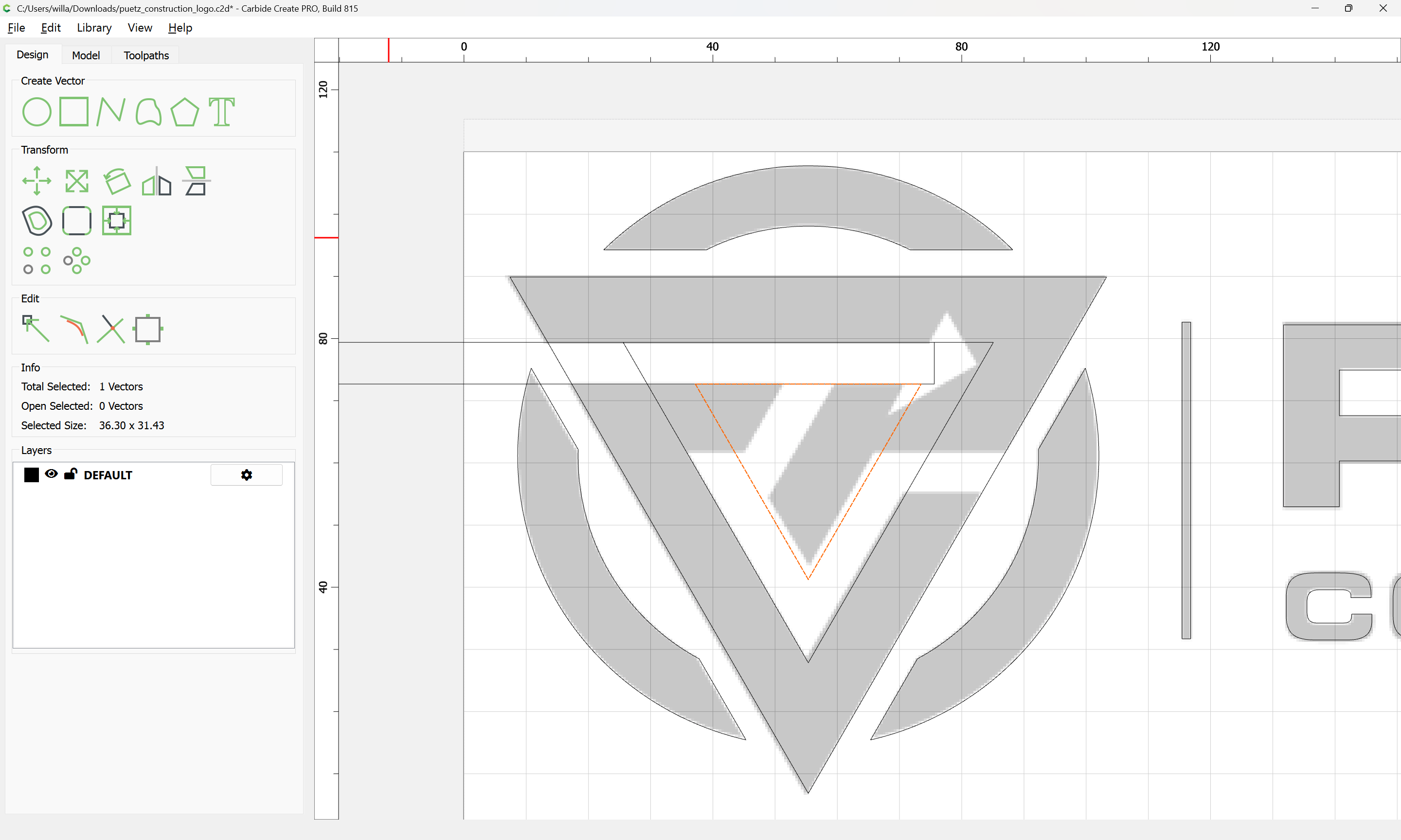

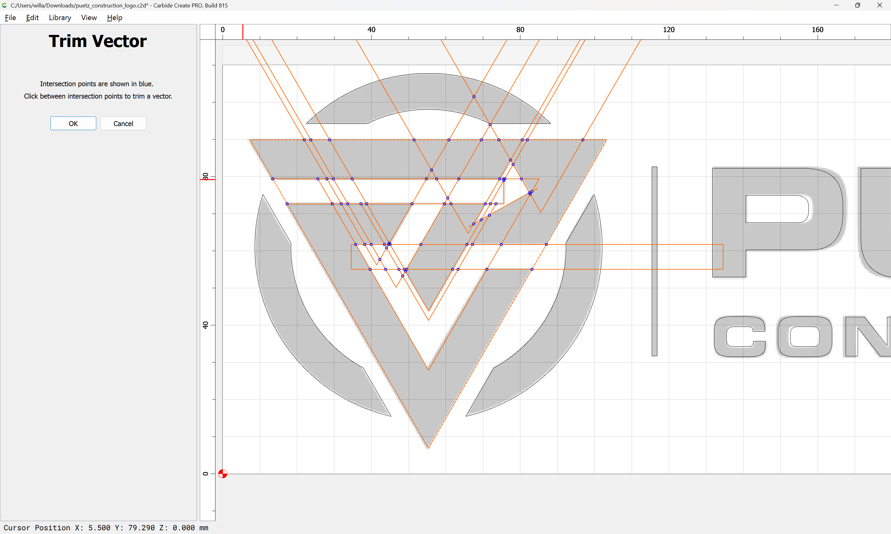

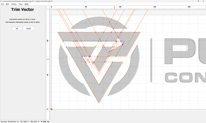

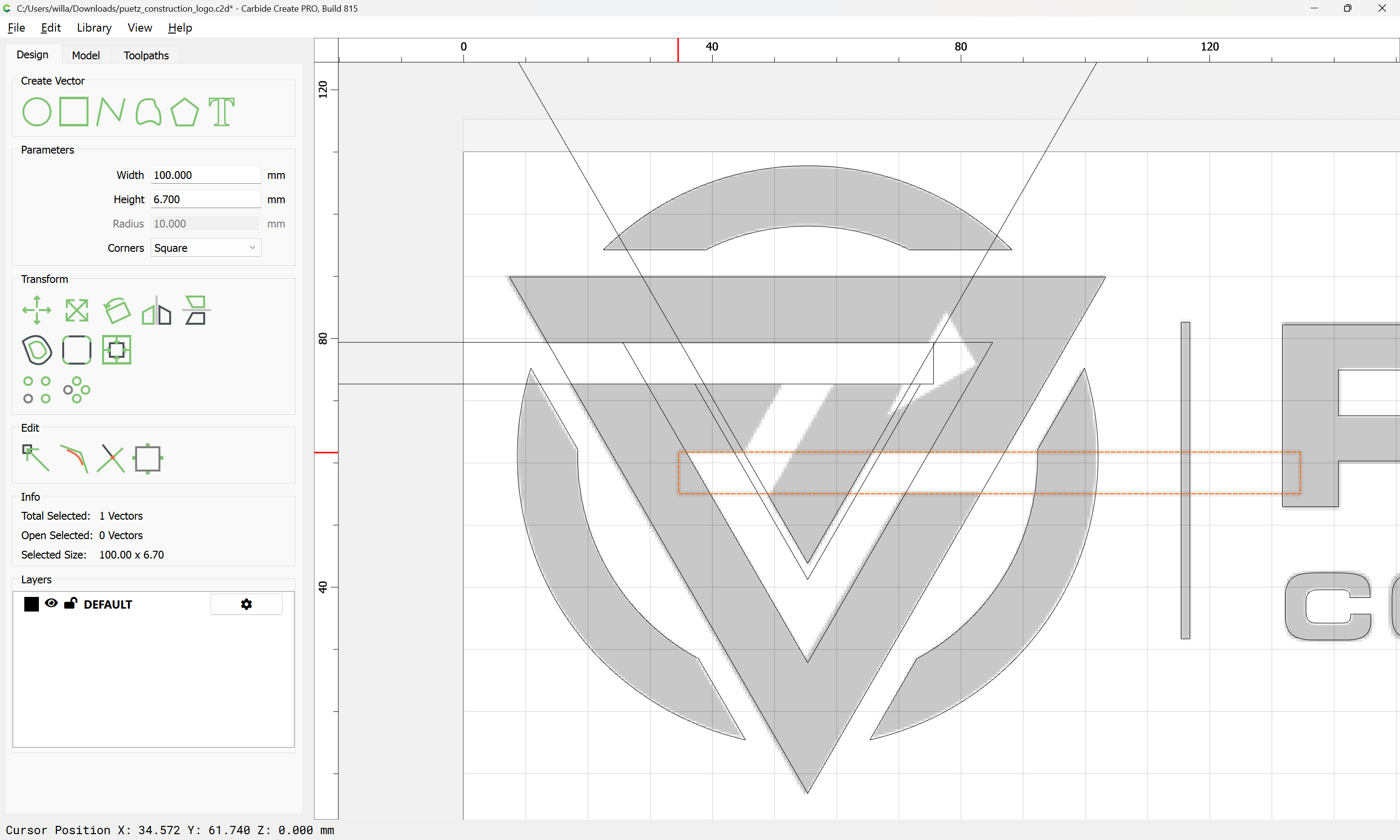

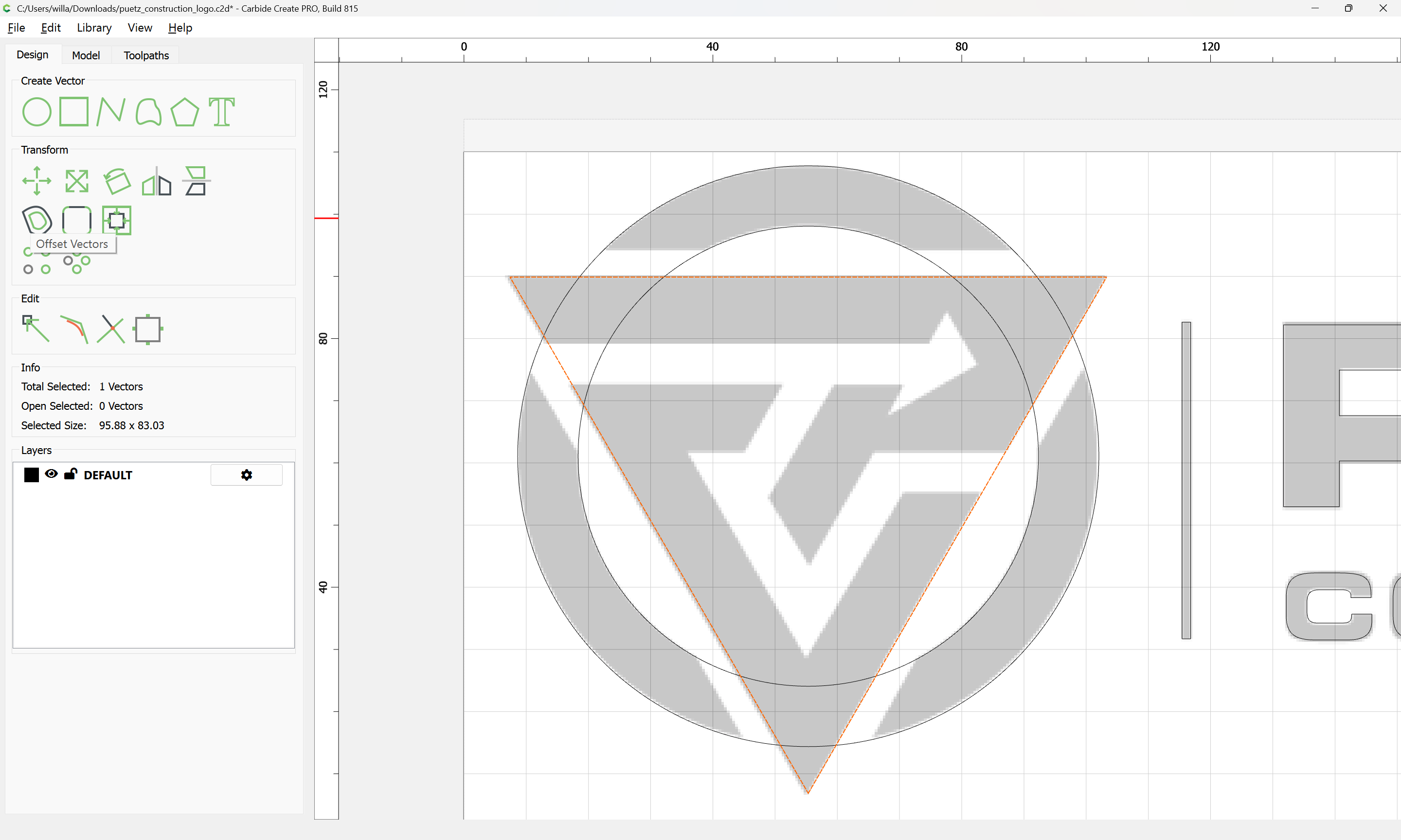

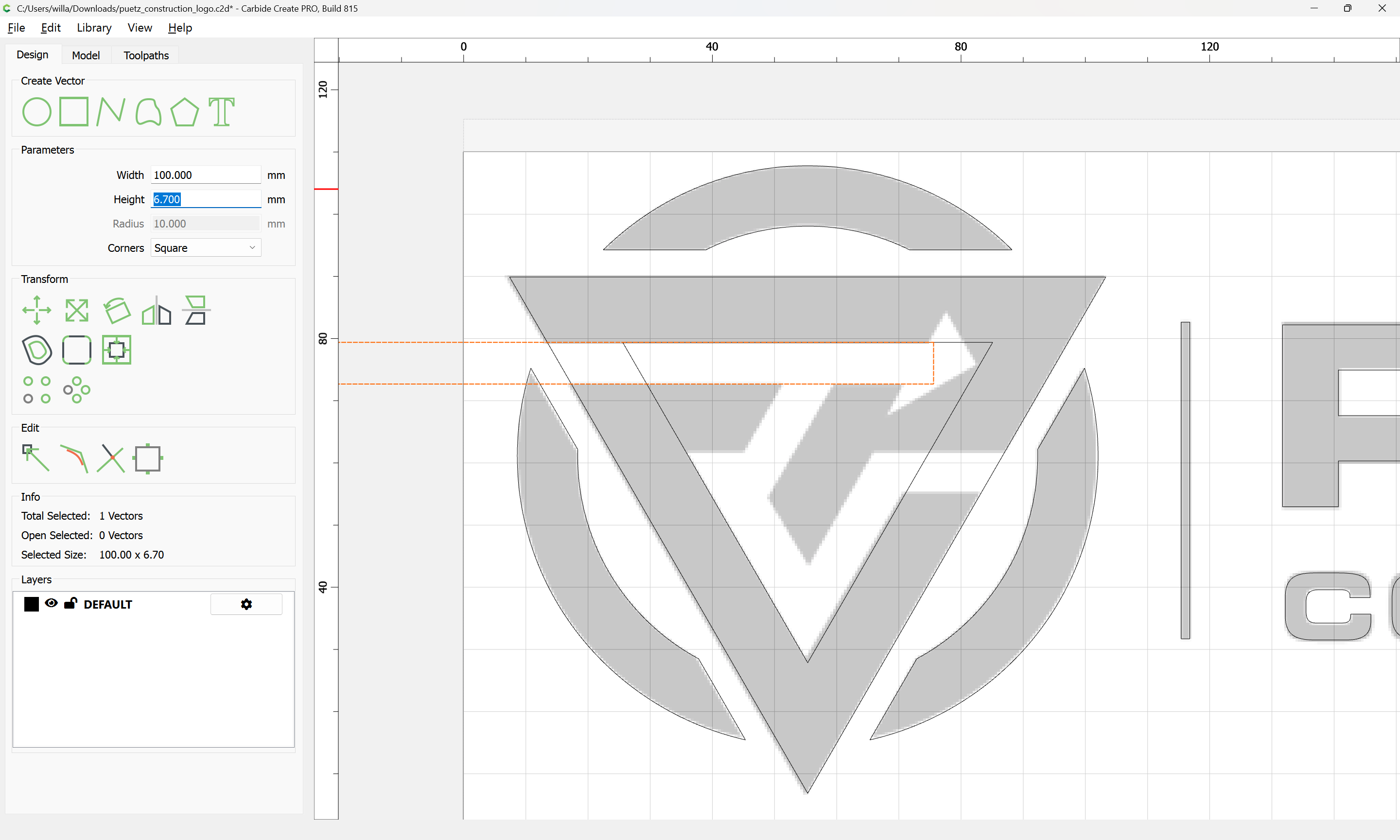

Draw in a temporary rectangle to get the needed offset for the triangle:

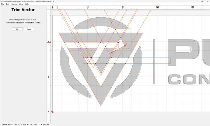

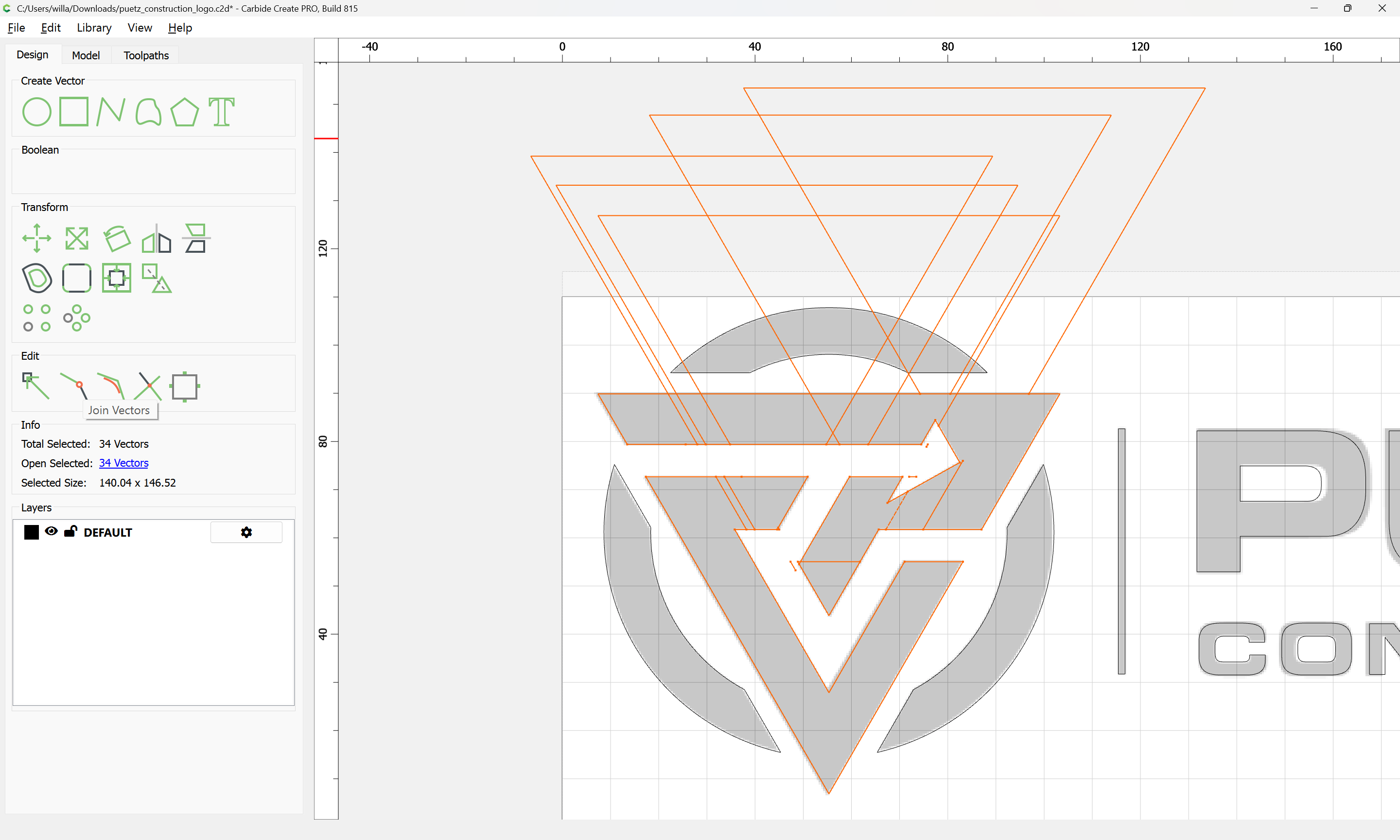

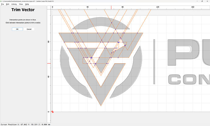

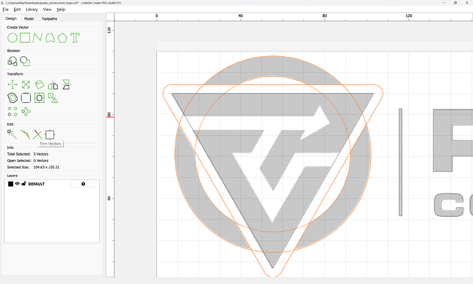

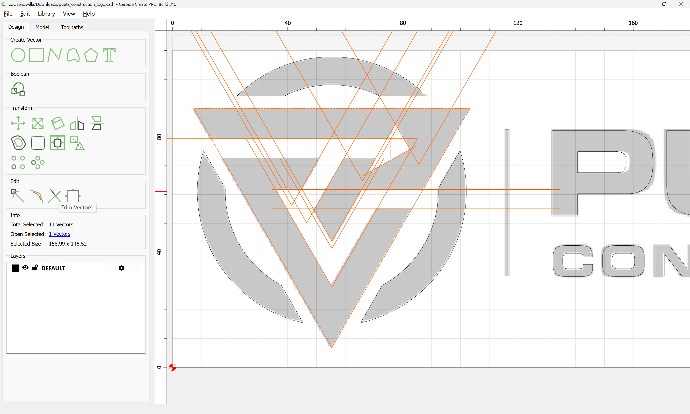

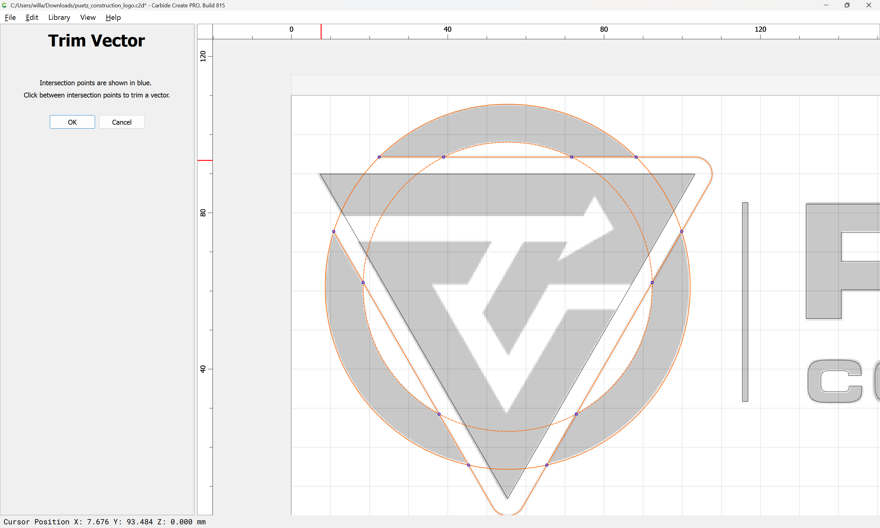

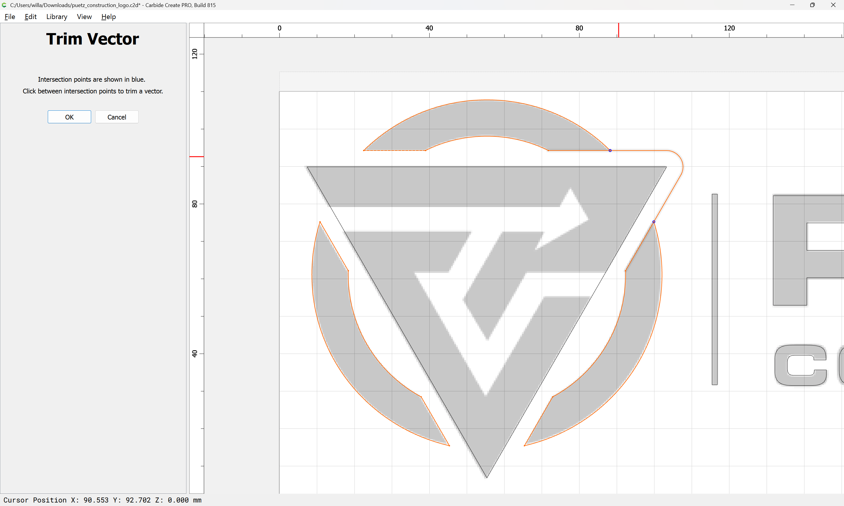

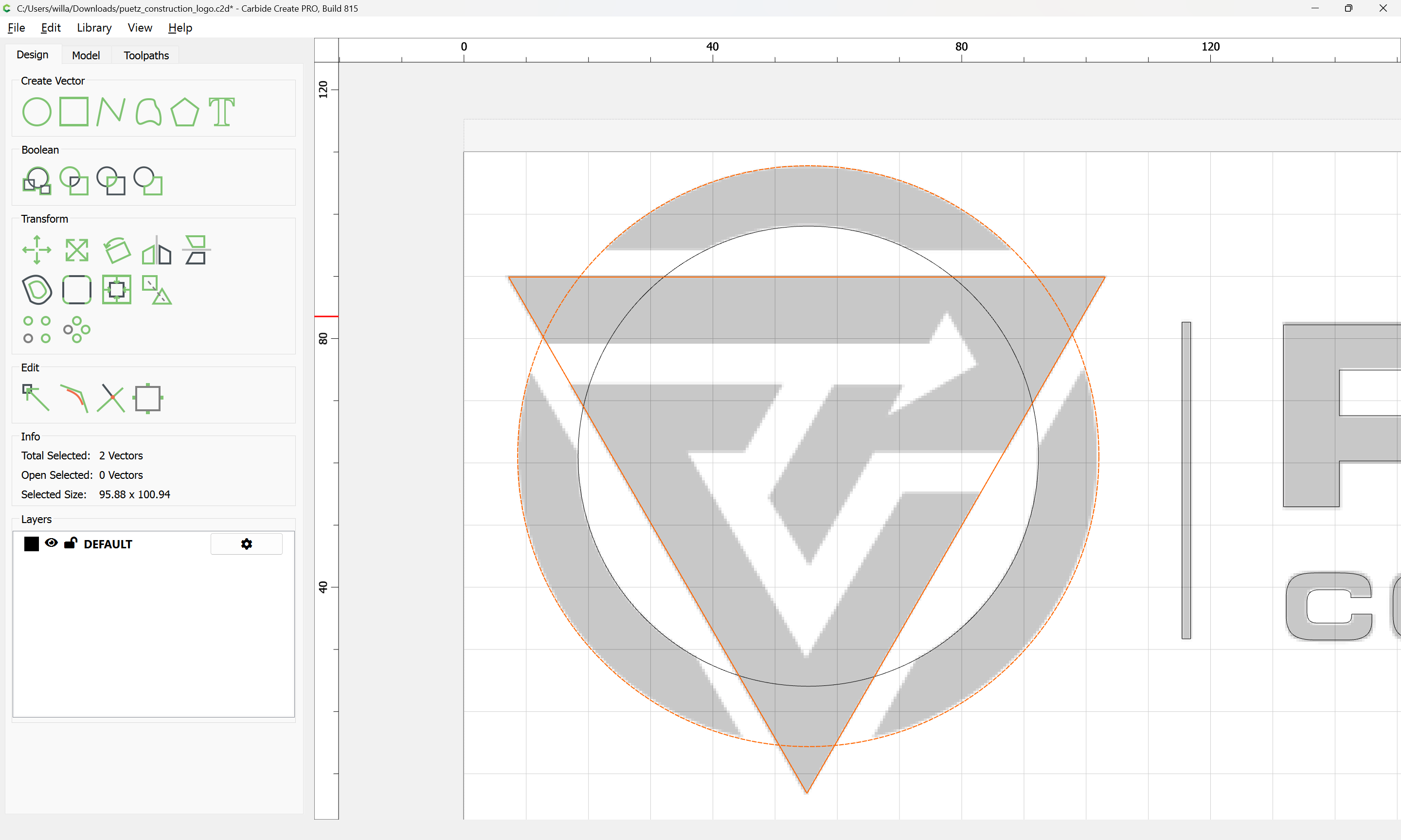

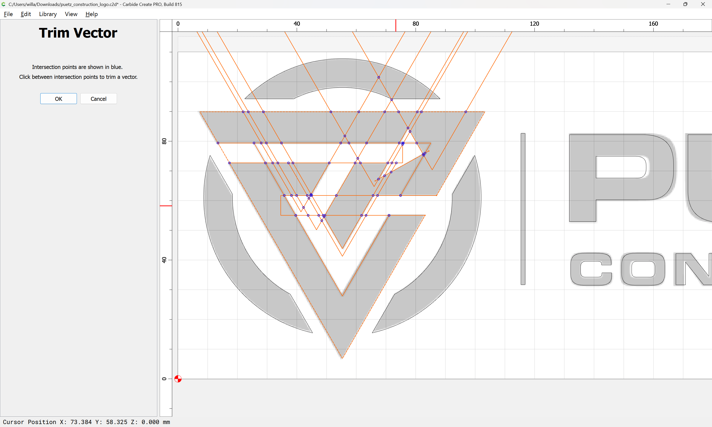

Select the crossing elements:

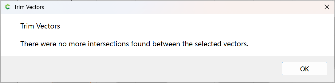

and use Trim Vectors
to remove what is not wanted:
until one arrives at:
OK
OK

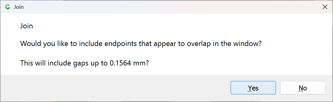

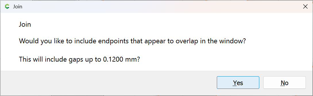

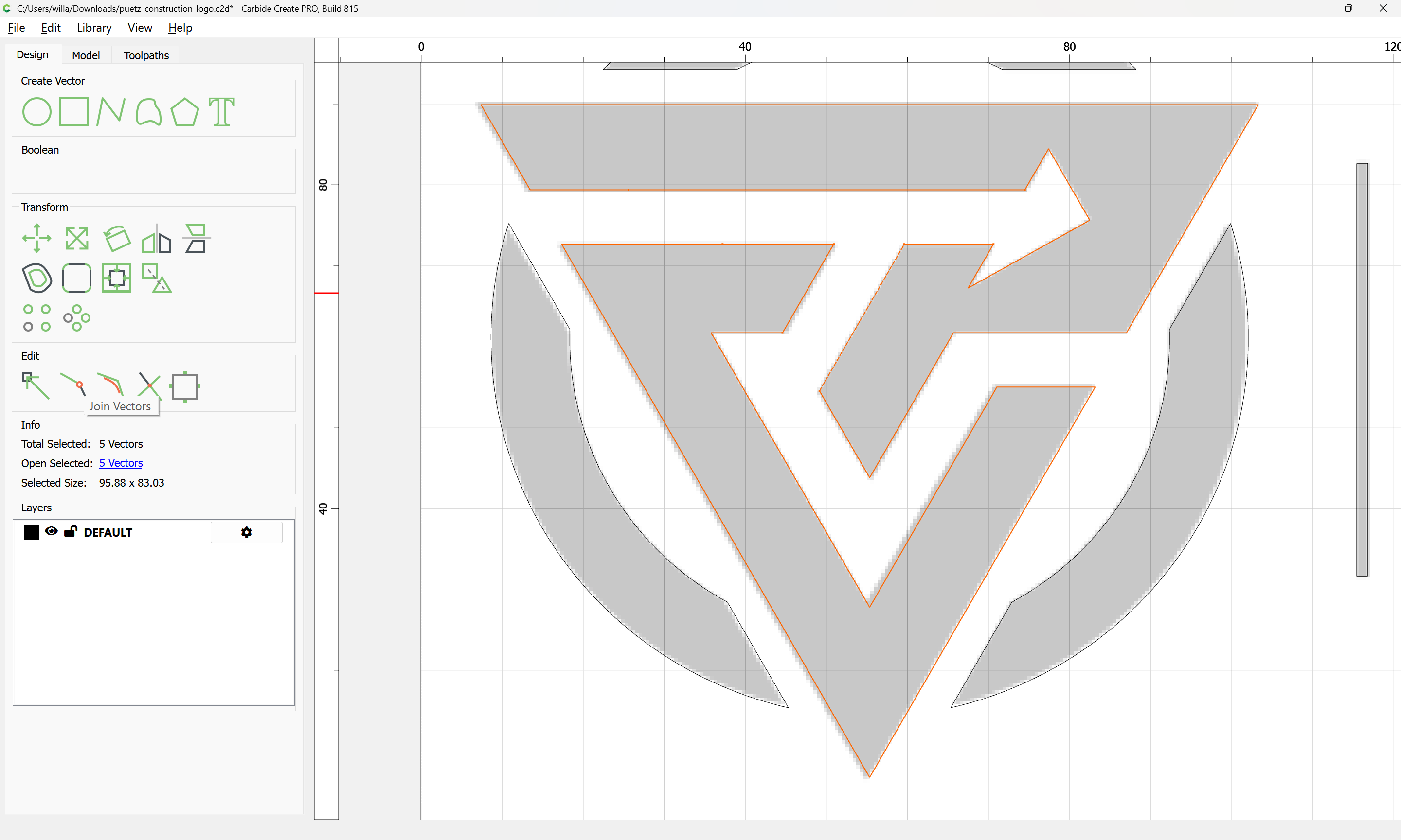

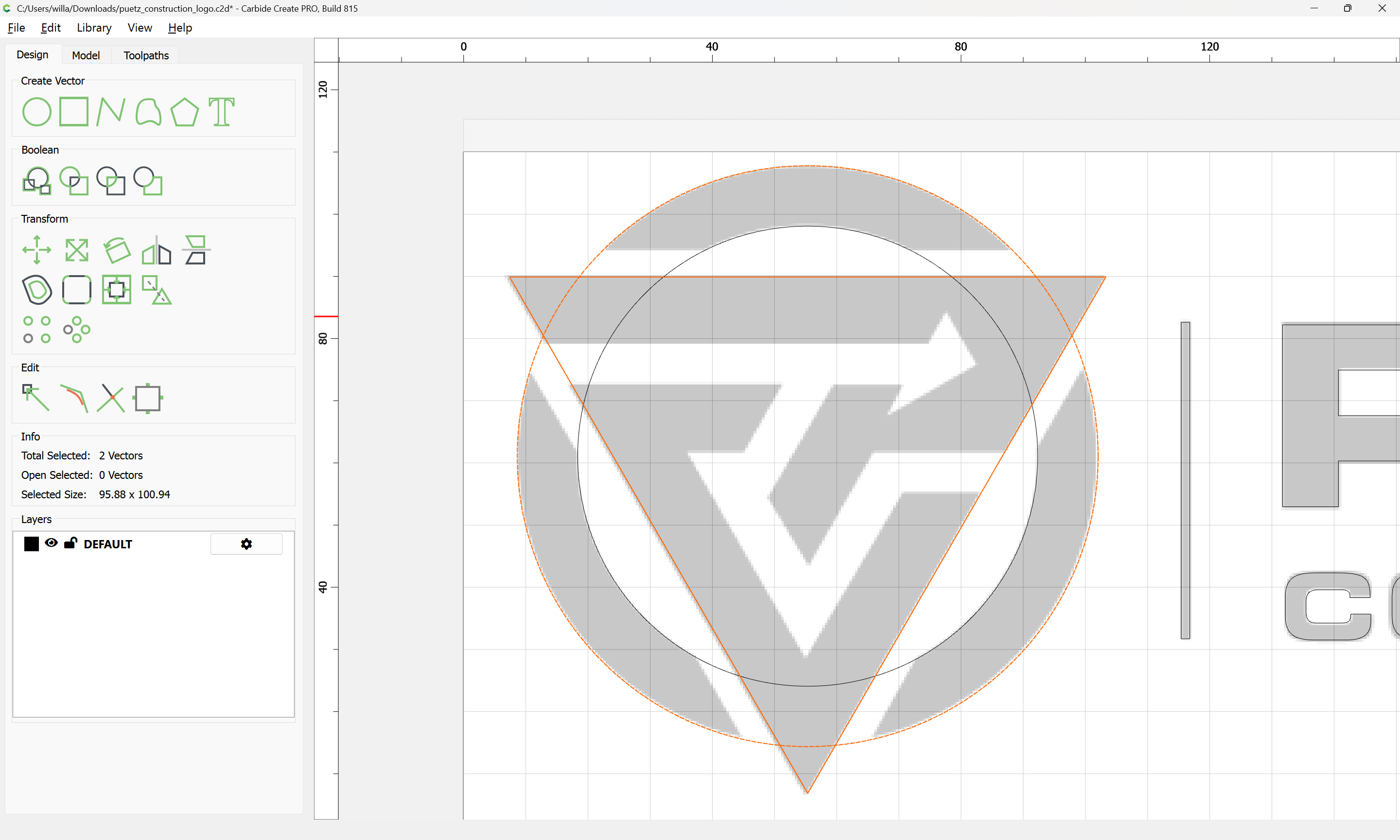

then use Join Vectors to close:
Yes

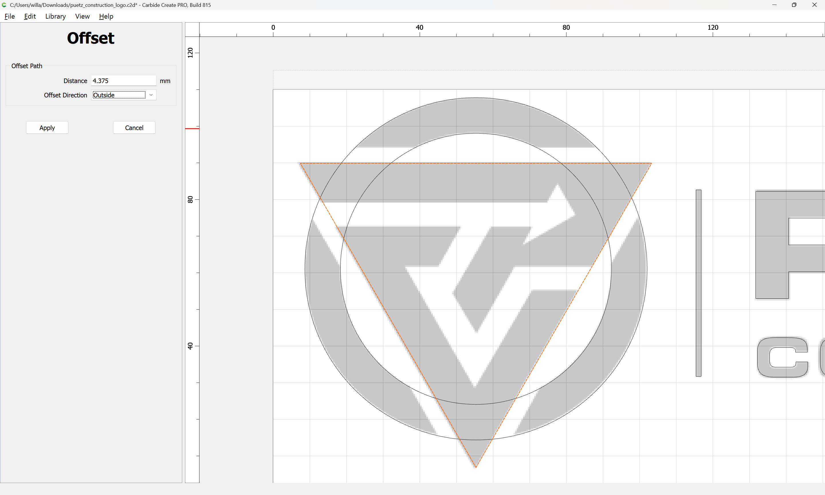

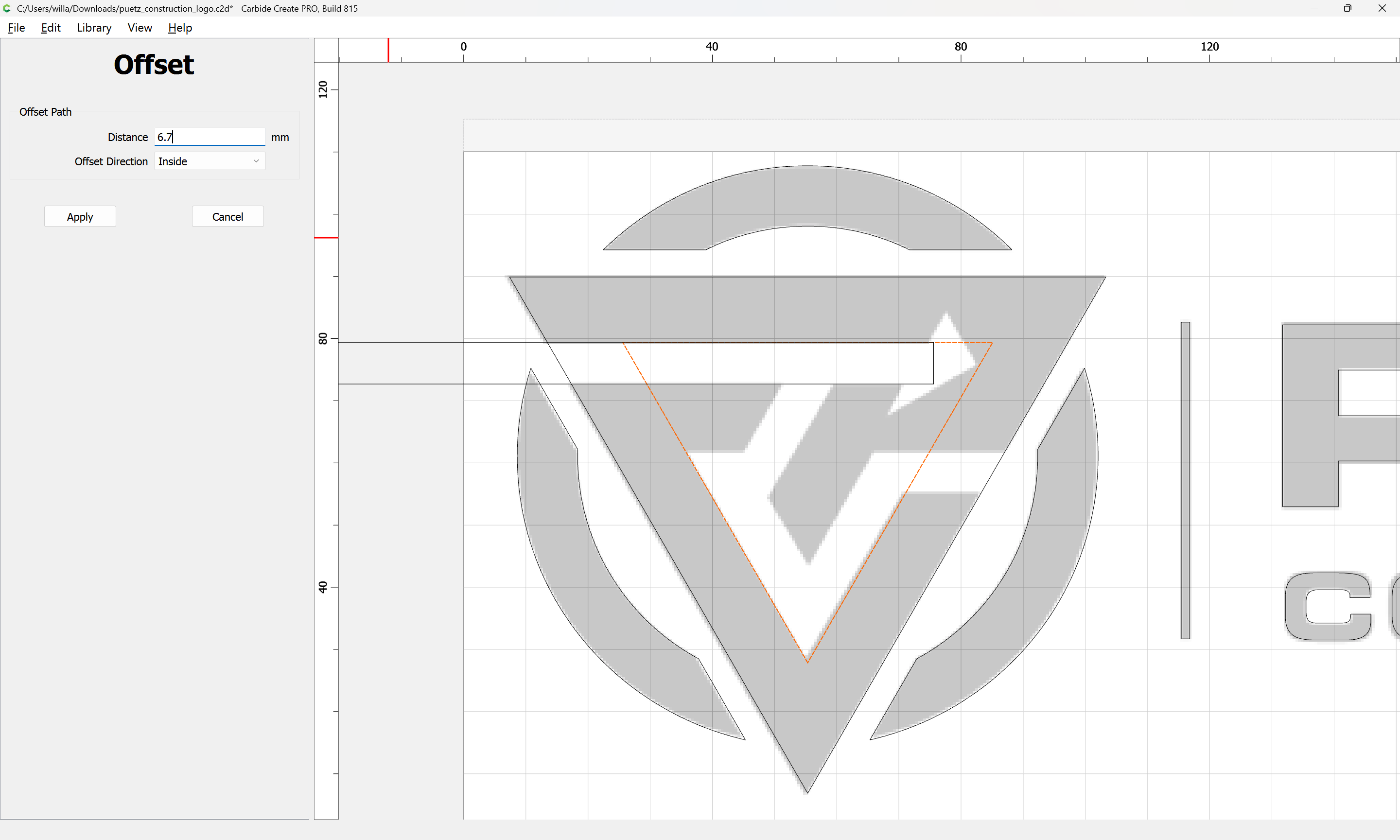

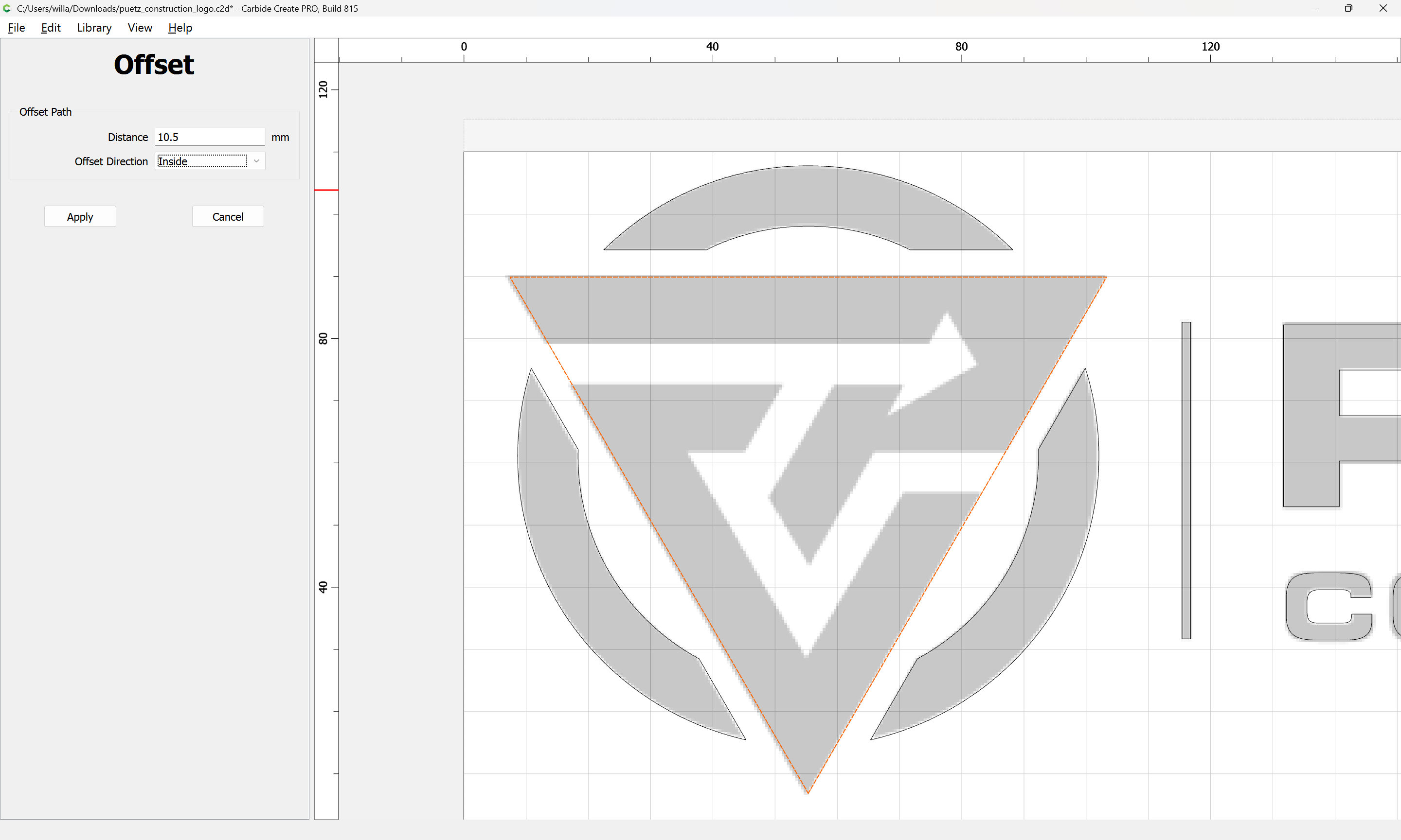

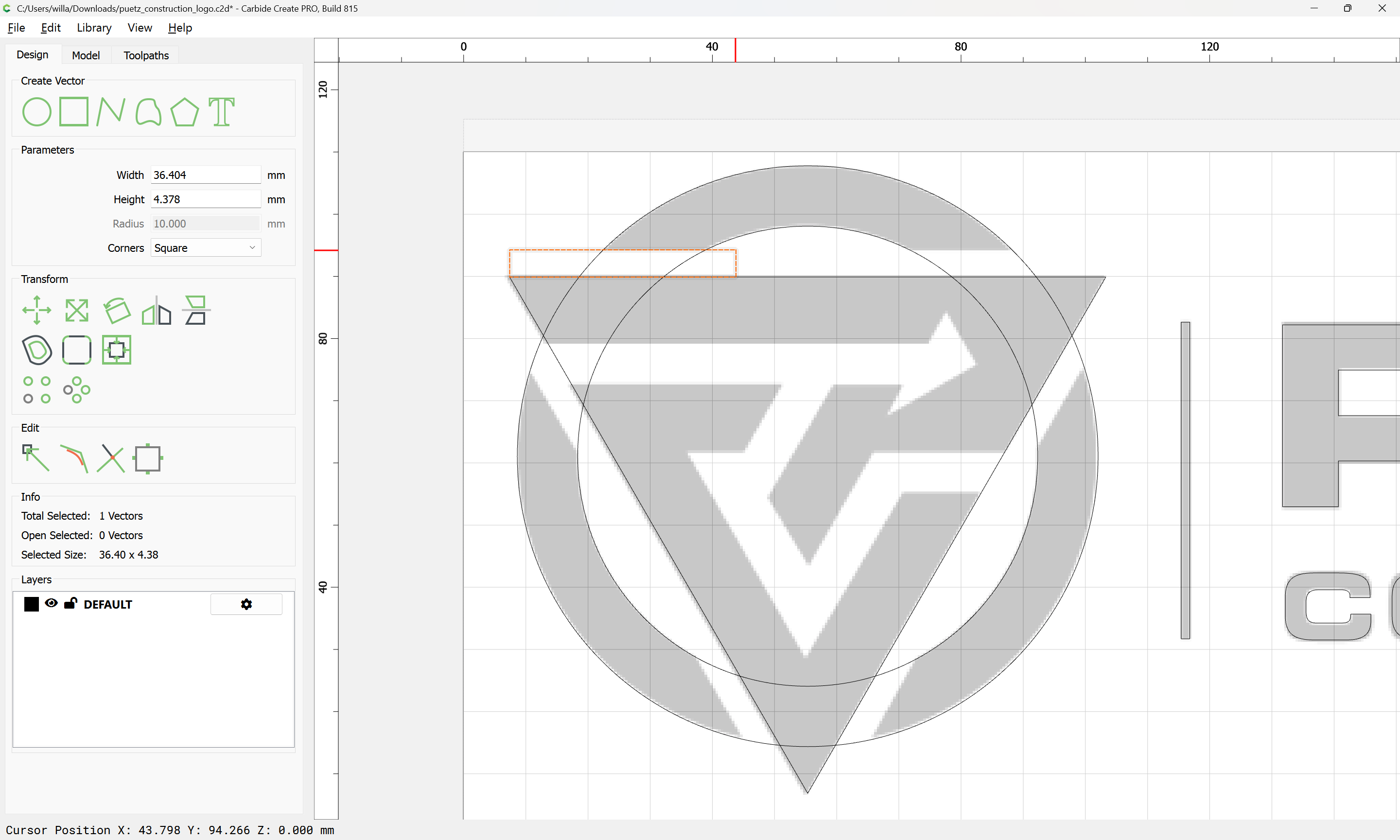

Measure again to get the inset:
Apply
and measure again to get the last inset:
repositioning for later use:
Apply

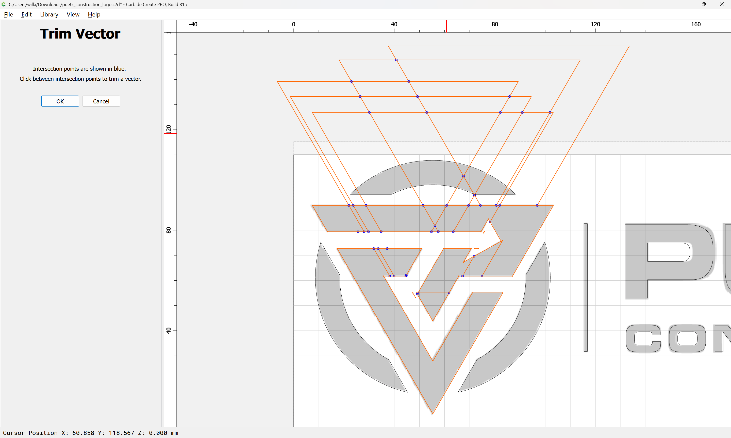

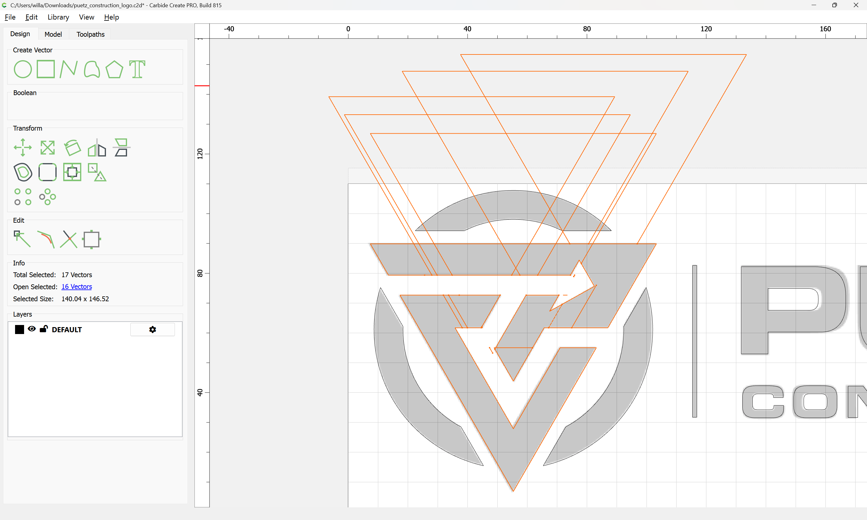

Duplicate the original to get sufficienly long lines to use for the insides:
and draw in rectangles, or duplicate triangles until all lines at constent angles are accounted for:
For the final line, draw it in:
Done

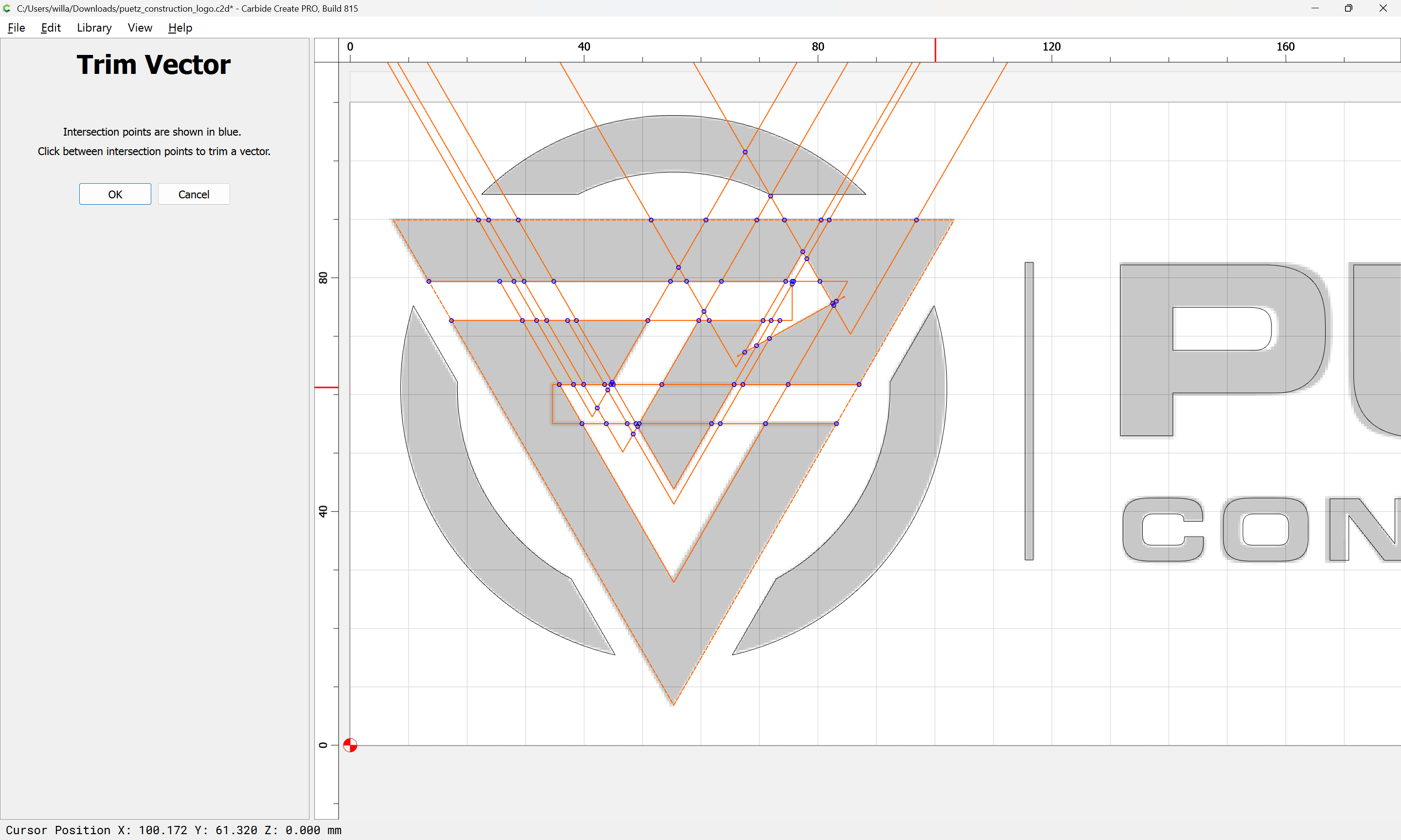

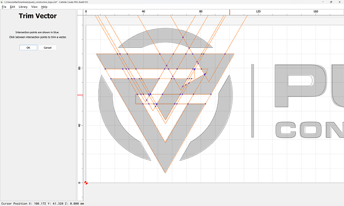

Select everything for the interior:
WillAdams
3

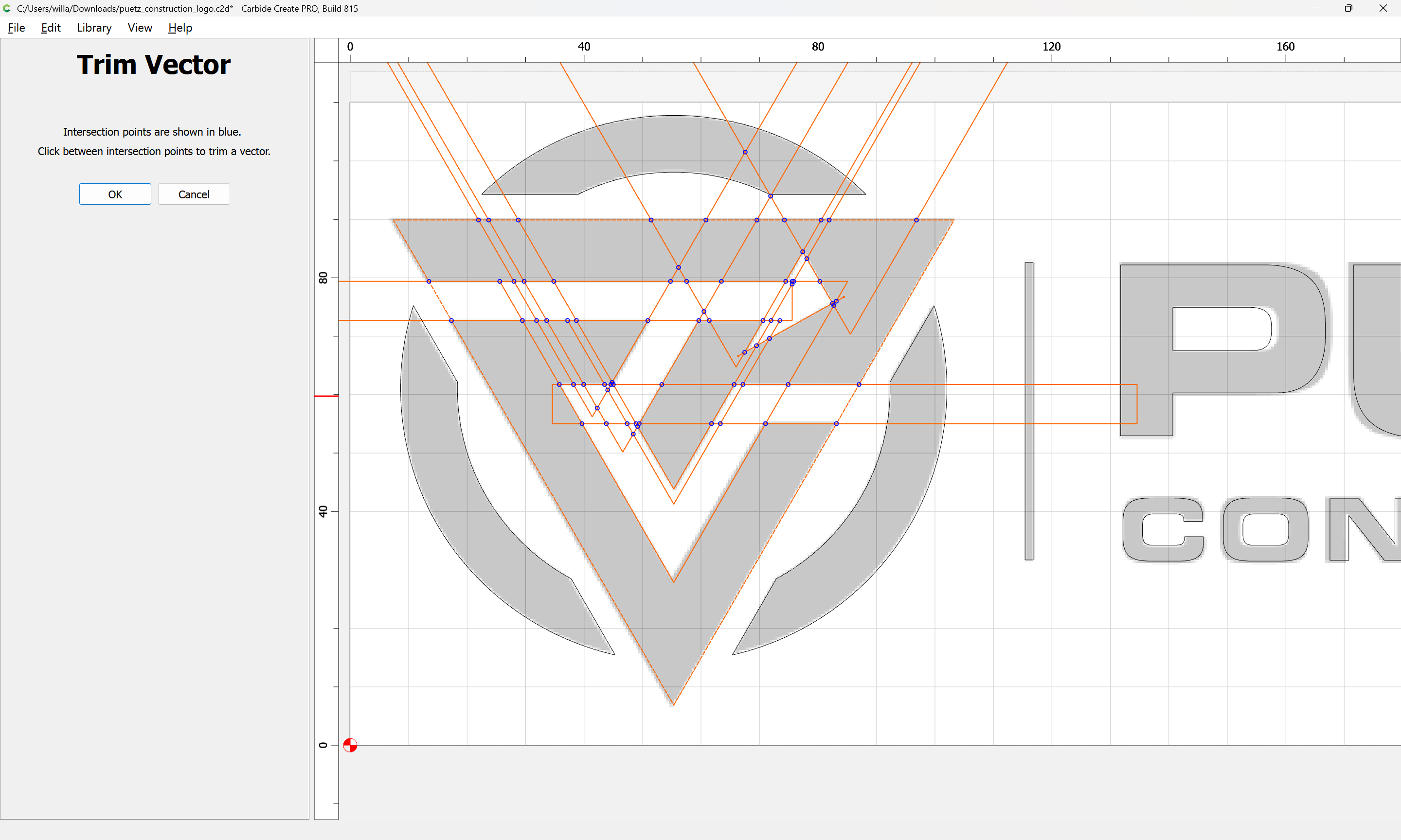

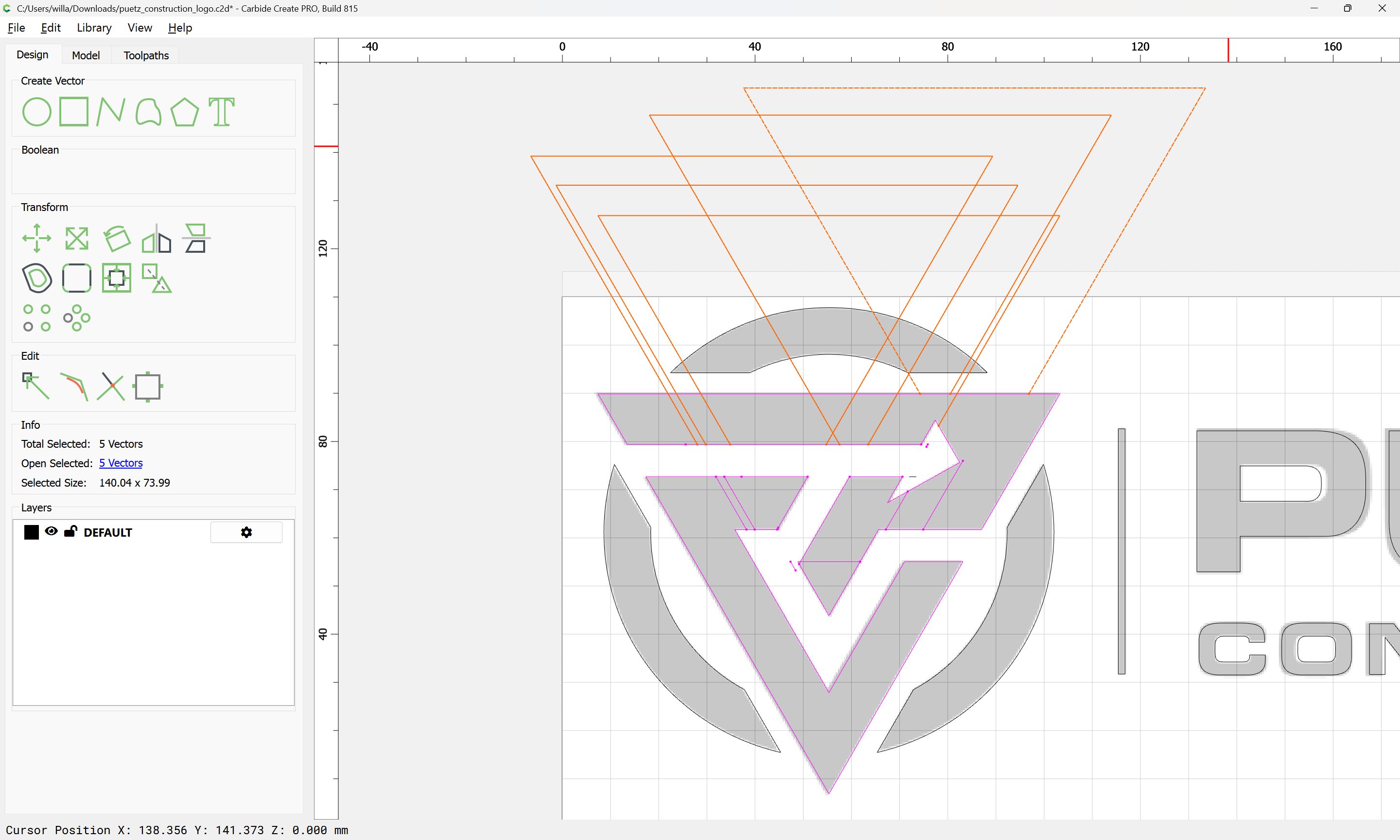

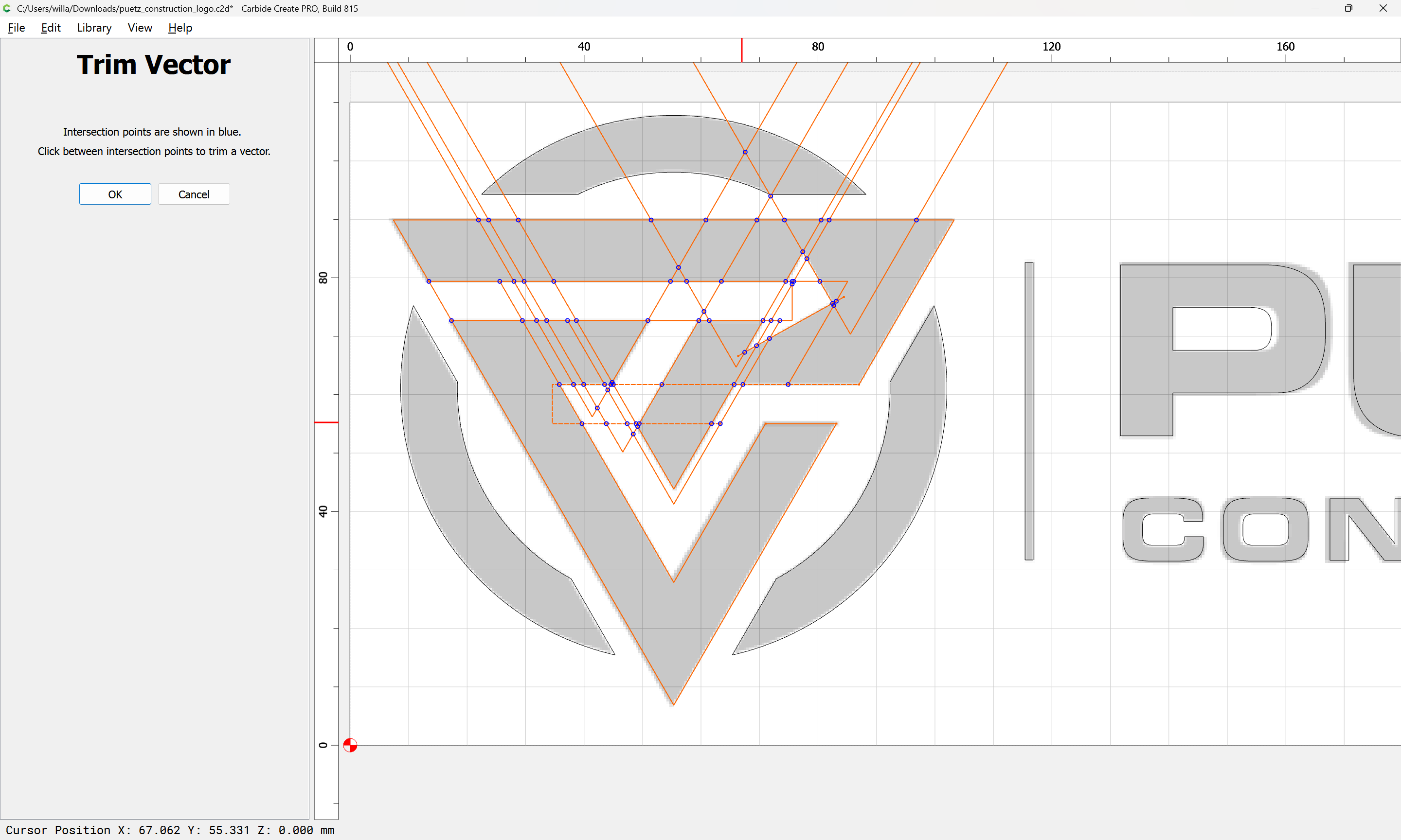

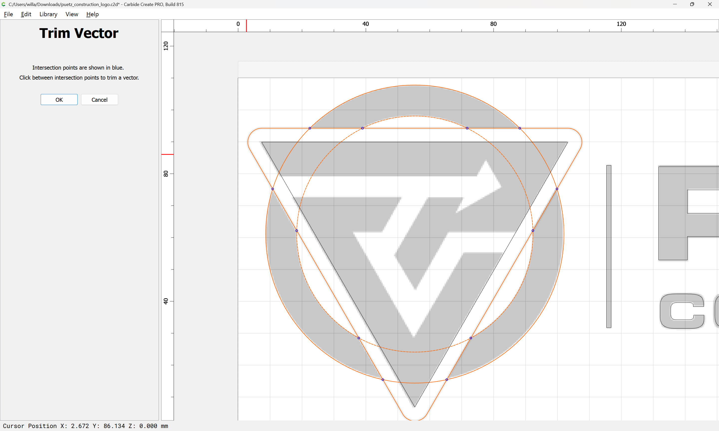

and use Trim Vectors to remove what is not wanted:
continuing until one arrives at:
OK

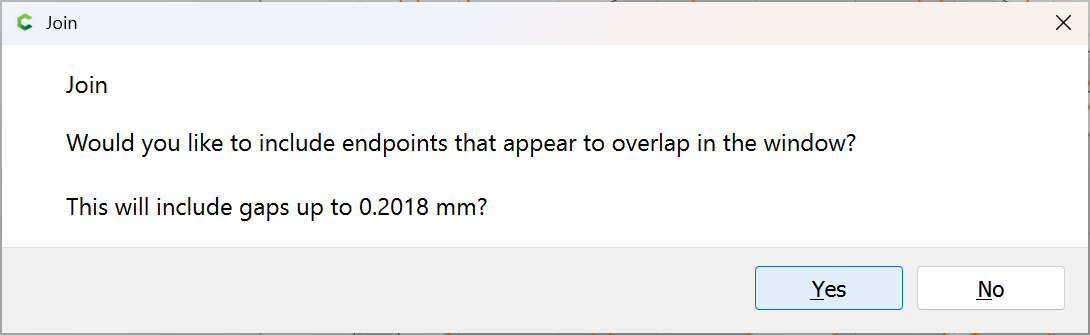

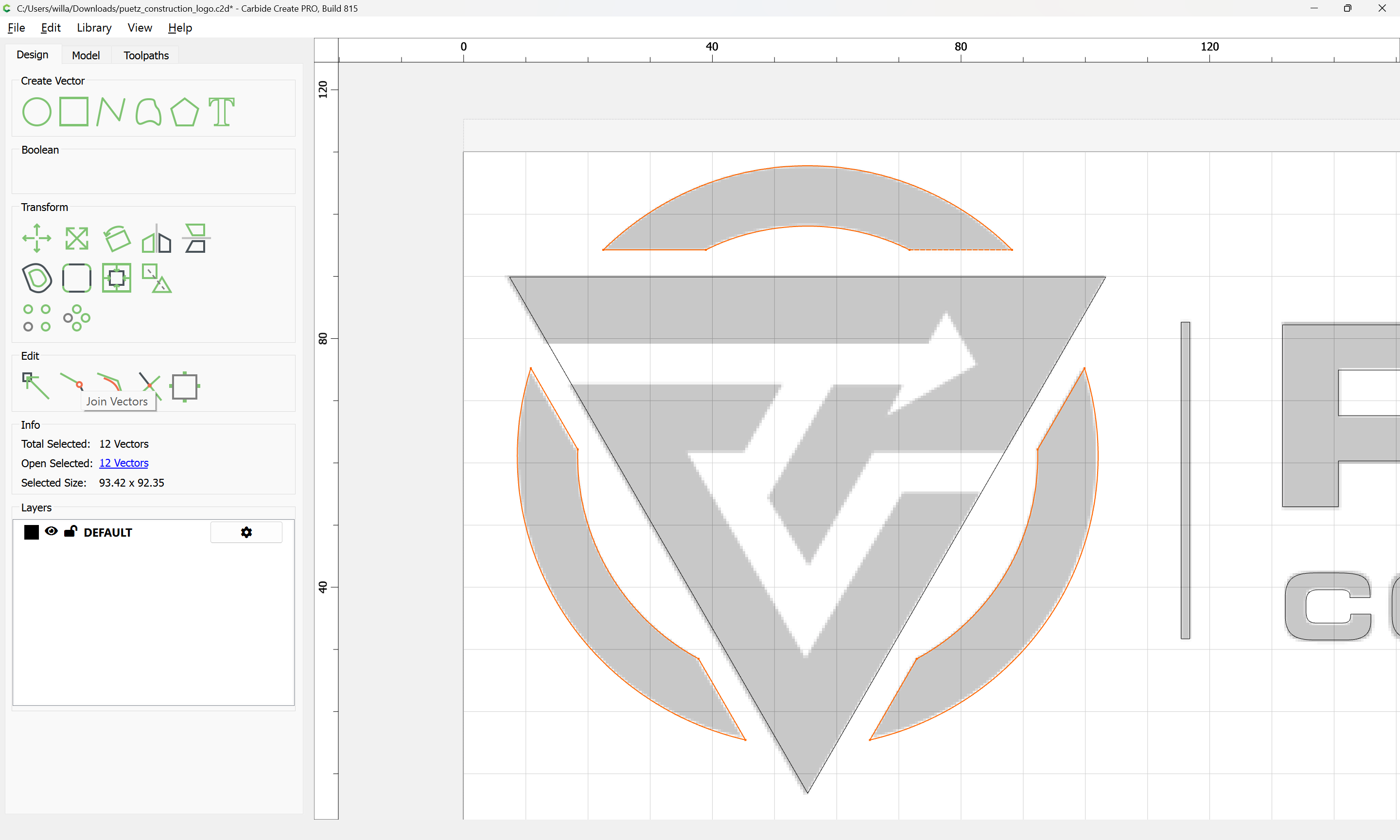

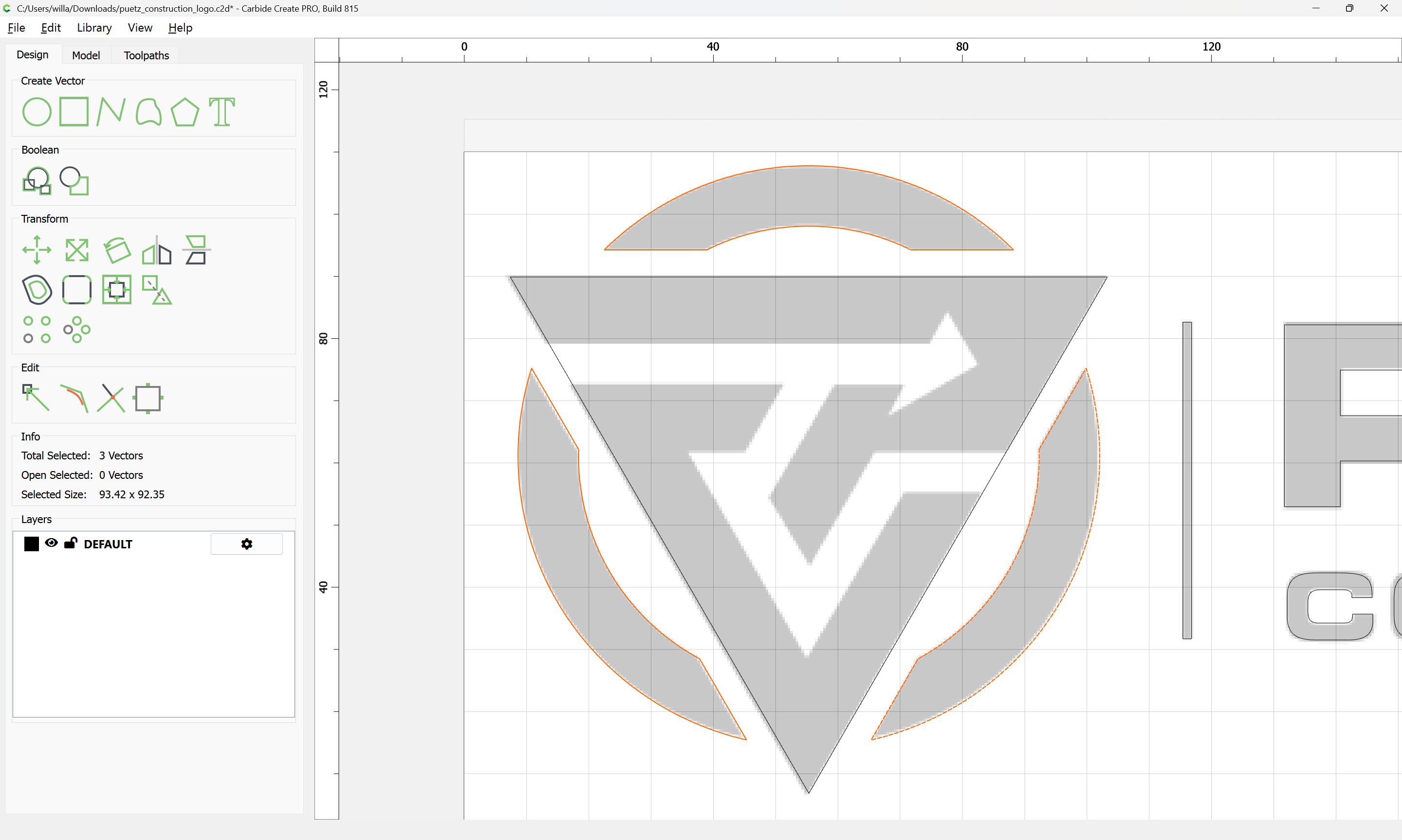

If Join Vectors is used to close things:
Yes

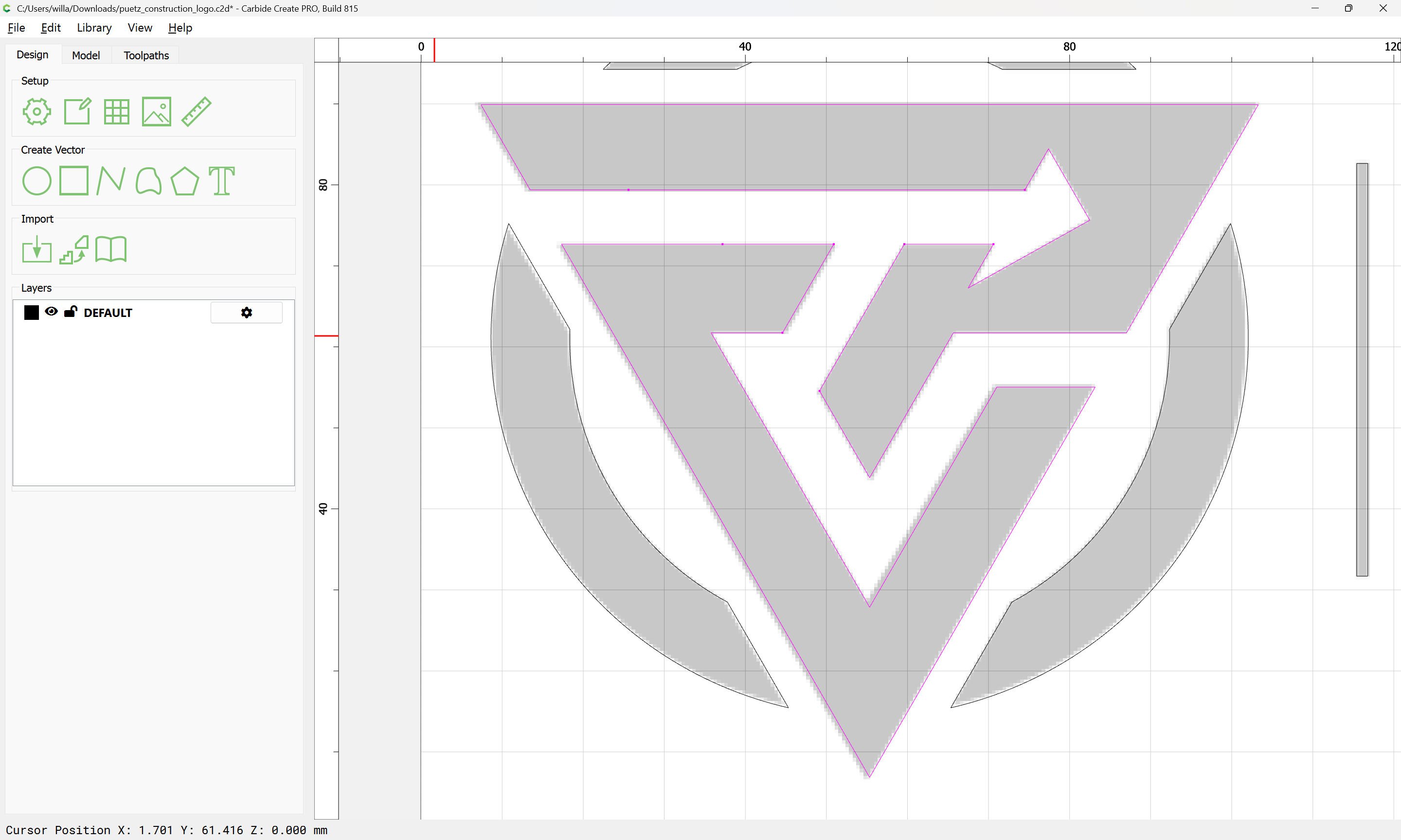

then one should be able to select the extraneous elements:

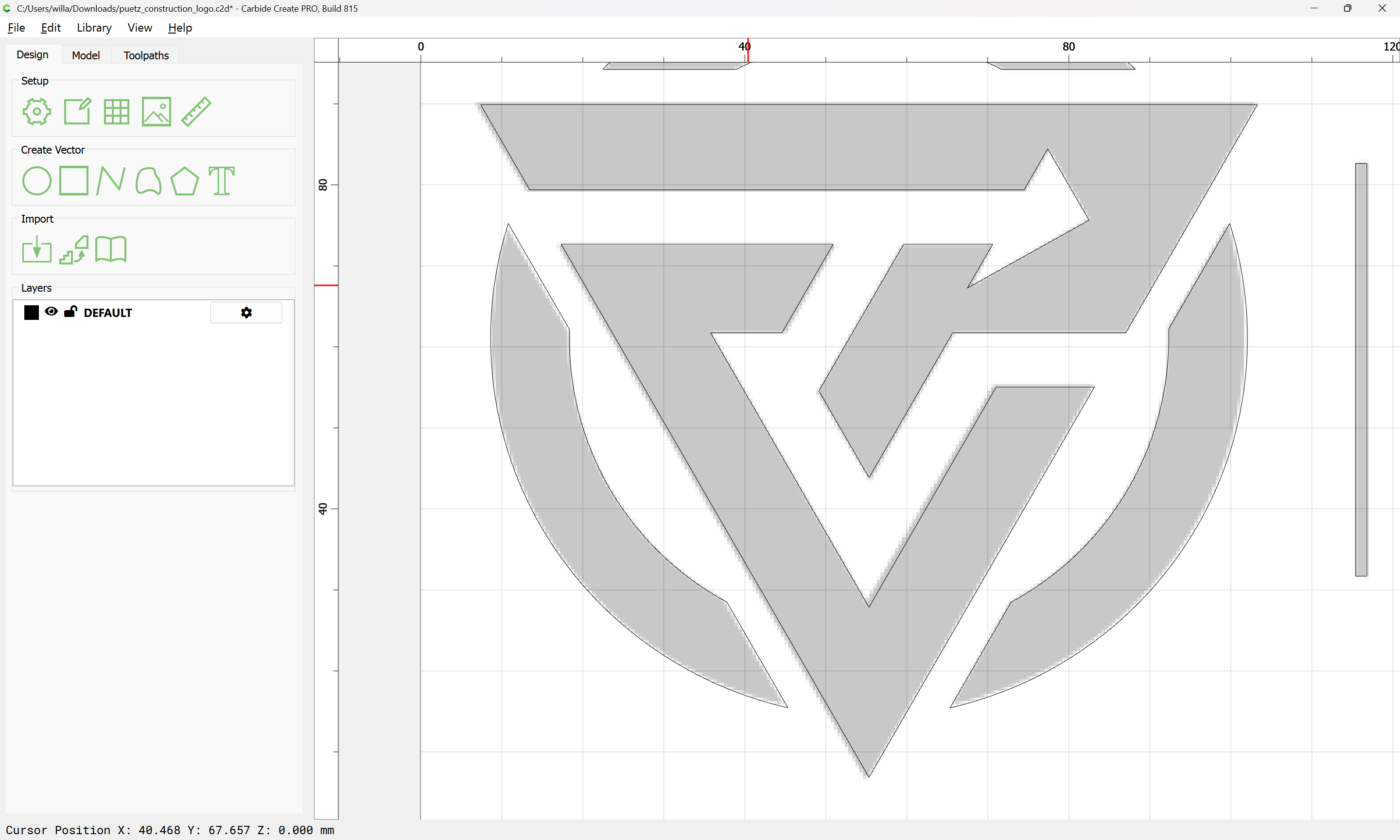

and delete them until one arrives at:
which may be selected again and finally joined/closed:
yes
