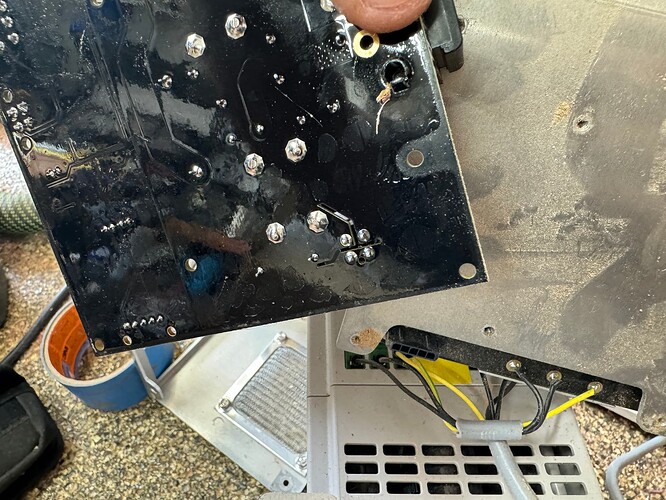

I just got a replacement controller board for my VFD. I’ve moved anything that was plugged into the old one, onto the new one. BUT, there are 3 wires soldered into the old controller board (the VFD Control 1.0), and the holes are labeled “L”, “N”, and “E”. There aren’t any holes anywhere near that location, and nothing labeled L, N, or E. Does anyone know what to do with (IE, where to solder) these wires?

The new board is the one on the top of the image, and the original board is on the bottom. The wires in question, are on the upper right corner of the old board.
This is the back of the 2 boards… The old board is on the right (still in the metal tray). You can see the soldered wires on the lower right. Both boards are in the same orientation in the image. The new board has a socket for 4 wires near the location where they are soldered on the old board, but there is no plug (and there wasn’t one that came with this, for me to attach to the end of these wires, if I de-solder).
Looks like the v1 boards do not use a 4 pin connector between the board and the VFD. You have the option of soldering the wires to the back of board where the 4 pin connector is. I have included a wire diagram below. If you do not want to go that route which is understandable, you would likely need to send the entire VFD box back to C3D for a replacement. You can also buy the connector and pins to crimp your self. I believe the connector is a Molex Mini fit jr:https://www.mouser.com/ProductDetail/Molex/46992-0410?qs=UxK%2FDTs6dB6CBrldigXeIw%3D%3D

The newer boards use a molex connector instead of the soldered wires. If you had an older board, the support team can send you one of the newer cables to go between the PCB and the VFD.

That sucks when this happens, my advice is to just contact C3D and get the correct matching parts. either change up the cable or get the V1 board instead of a V1.2 board
L,N,E refers to Line(Hot), Neutral and Earth Ground. So 120Vac and it looks like a fair bit of current. I don’t have a VFD. I am just going by the pictures.
If you believe you have the skills and the right “crimp tool” that is needed, you can add the connector.
Please do not tack those wires on the back of the board. They are required to be mechanically secured just in case the heat melts the solder.
