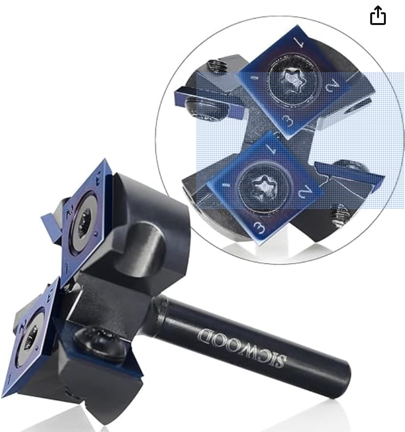

the bitsetter must be switched off in CM, because the McFly does not have a cutting blade in the center to hit the switch. BitZero works IMO, usually beause my stock lately is rather thick so that the pull back of the Z axis after Z-zeroing on the BitZero exceeds the max.
Therefore I often use
what covers the BitSetter switch button with center blades, or I go down to the surface with 0.025mm steps until the bit cannot be turned manually any more.
One can use a contour tool path with a snake like design of paths, William recently described that prodedure somewhere here, I usually use a pocket tool path.
Stepover depends: if you need to remove some thickness the stepover may be almost the diameter of the bit, although one might consider a bit that removes some material like the GoldenGirl/GoldenBoy from CICWorkshop as first step, and for finer surface the McFly. I never remove more than 1mm (never even 1mm, rather 0.5mm) with the McFly or one of those anyways.
If one uses a small stepover, little cutting depth and rel. slow speed (not too slow: may burn!) an almost polished surface can be achieved. (toolpathes are still visible, so does not reduce the need of sanding)
For the 1.5inch surface cutter I recently used 1000 mm/min speed, 12mm step over, cutting depth of 0.75mm.
