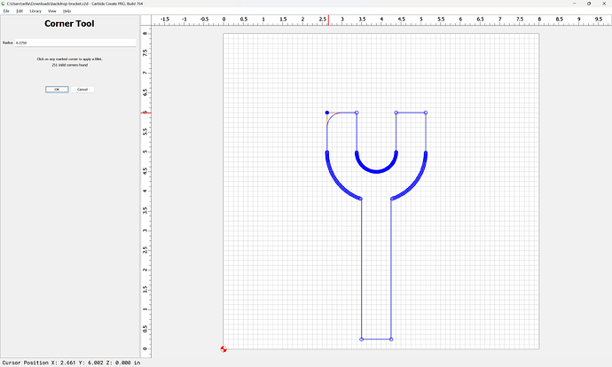

How to smooth/round in CC?
I am trying to figure out how to smooth/round the sharp angles on this piece. The inside of the fork needs to remain at 1". I’m currently using CC version 777.

There are two different commands for this:
The Corner tool:
will find some possibilities, depending on the value set:
If we measure the width:
Then 0.375" should work on both sides (but may not due to rounding):
(it doesn’t)
Reducing down to 0.374" we get both sides:
and with that value it is possible to do all sides:
Similarly, Fillet All:
works if one uses 0.374:

What corners do you want rounded?
If the problem is where the ‘U’ meets the neck, then the expand / contract trick should work:
  • Offset to outside by desired corner radius
  • Using the new vector, offset inside by same amount.
    You can see the result (in orange) match the original except at the junction.
I was wanting it where the U meets the upright. Using fillet and .374" did the trick. Thanks!
