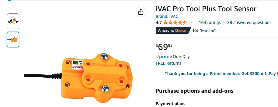

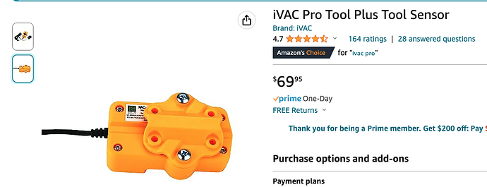

I just find a way via a Ivac tool and Ivac switch that will work. I will show tomorrow how I did it.

The iVac solution is what I use, but I don’t have a spindle so don’t know how that would impact it.
I am thinking about getting the Ivac blast gate to simplify the setup as I currently have a manual blast gate right at the router.
iVac has a system with a power sensor you can hook up to the spindle power cord. when it senses power being sent to the spindle, it can engage the vac or whatever you have plugged into the main unit.
This is exactly what I installed. I will create a youtube video explaining and showinf how I did it.
