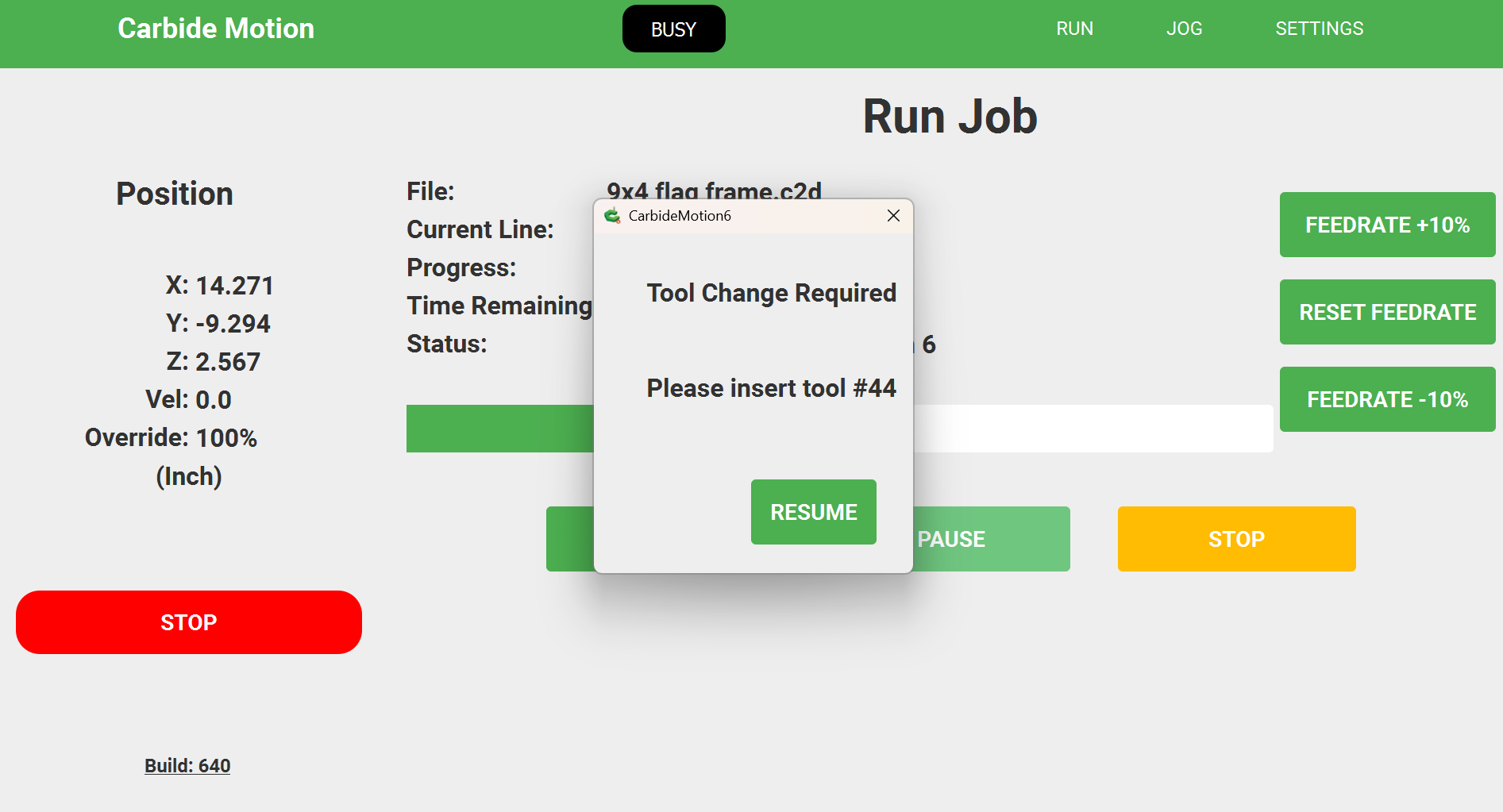

So say I’ve got a project running and I’m like, oh snap. I programmed the wrong endmill, but it’s at the point of wanting to bitset…how do I stop everything and start from home? if I hit the x in the pop up dialog, it’s going to want to bit set anyway…so do I have to hit my own kill switch?

You can also let it go with this tool but press “Pause” and “Stop” in CM before it touch the wood.
Then you can restart with the right tool.

The only thing to remember is to let the ‘Pause’ command finish moving before hitting ‘Stop’.
Michael: if one after ending the tool change window clicks the ‘X’ right upper corner the program goes on, now immediately uses the pause button, waits until the machine came to a complete stop, then the yellow stop button (not the left red button) the machine does not need to be re-initialised. If one presses the yellow stop button before the machine mechanically comes to a complete stop the machine needs to be re-initialised, what wastes time, but no need for zeroing.
If you chose the wrong tool do as others said above and stop your machine. Go back to CC and disable any tool paths that have already run. Then edit the tool path with the wrong tool and then save your file. You would not need to reset zeros because the machine remembers from the last time you set them even if you power cycled your Shapeoko. Then go into CM and load your newly saved file and it will start from there and cut that tool path and any other tool paths you might still have in the CC file.

Just make a note of the current line/estimate where you want to restart at, stop the cut, then resume it.
