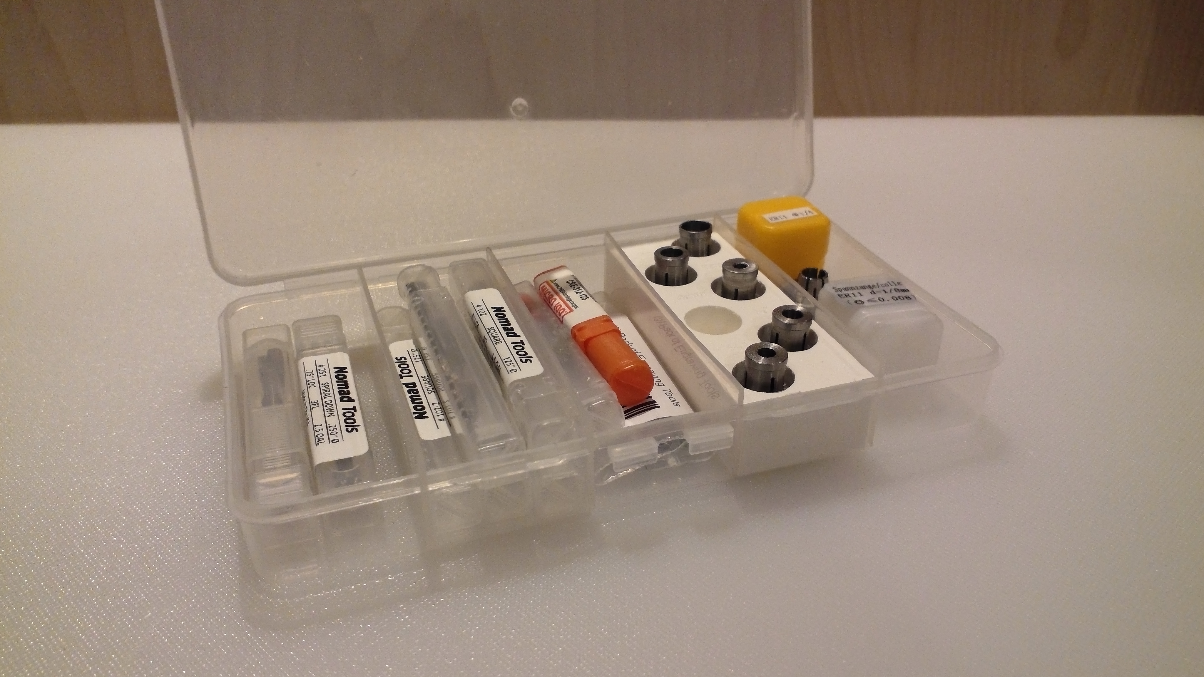

A further consideration is the 3/8" collet is actually just an angled ring, lacking the central shaft — and since it’s usually black oxide, readily distinguished.
I will note that when I put the full set of sizes together, I did feel obliged to label the holder:
(1/8" is from Carbide 3D, as is 1/4" (not shown), the balance is from Elaire Corp. (3/16", 4, 6, 8mm — still surprised there isn’t a 3mm) — the 5/16" has a lip thickness of just 0.78mm or so)
There is a great difference between an 8mm and a 3/8 in collet for the Makita, they don’t look the same at all.
