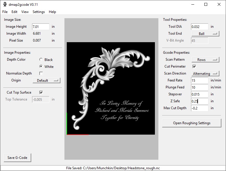

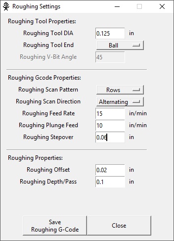

Here are some screenshots and the files:
Merida Roughing
Headstone_rough.nc (334.2 KB)
Headstone_finish.nc (933.5 KB)
I have to set the Zero X and Y axes at the farthest rear, left of the cutting surface, and when I hit ā€œRunā€ it goes somewhere into the center-front of the cutting surface to begin. At some point (about 16% in) it decides to try boring a hole towards Singapore in the Indian Ocean.

Do you have these problems using carbide create/carbide motion? Need to reduce the # of variables.
May have to adjust some settings here:
G17 G90 G64 P0.001 M3 S3000
G64 is not supported by Grbl — please don’t send it.
G20
I would suggest using metric — seems to have fewer problems.
G0 Z0.2500
F15.0000
F10.0000
Weird sending two different feed rates one after the other — send that in to the developer and see if they can clean up that code.
G0 X6.6811 Y7.0100
everything else seems okay.
EXACTLY what I thought.
Yes to carbide motion. I need 3D rather than the 2.5D of Carbide Create, so I used dmap2gcode fto create the gcode the files. Feel free to try these files on your machine and see if they make your machine go into convulsions. If they do, then it is a software issue and I will be forced to go to 2.5D.

Yes, you could edit these, but it would be better to adjust the program in question to properly emit the codes.
Since this is by Scorch, the configuration ought to be similar to F-Engrave: https://www.shapeoko.com/wiki/index.php/F-Engrave#Using_F-Engrave_with_GRBL
You can set the origin wherever is appropriate for a given file — you just need to be consistent about it, and follow through when doing the balance of the setup.
I took a peek into the set-up and it looks like I can change to metric and alter the header codes. Do I need a substitute for the ā€œG64ā€, or just delete it?
@WillAdams dude! You are a huge help…not just for me, but for everyone. You ever get out to Oregon, the first 10 microbrews are on me!
G64 allows one to configure a G-code file to allow a deviation — Grbl doesn’t support it / can’t do it, so just delete it, and its parameter P0.001.
