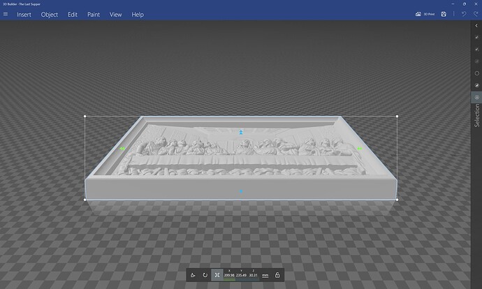

I am trying to do a 3d Last Supper Project. I have a detailed stl file but when I import it, there is not much detail. I have watched the videos on mycarbide3d but the screenshots do not match what I have on my screen. I am using CCPro 778.

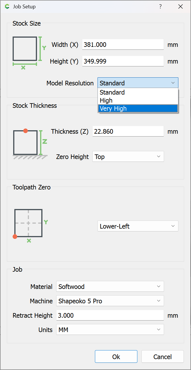

What do you have set for Resolution on Job Setup?

Very high, I am also 68 and don’t have the best vision. In preview mode it looks bad but when I rotate the image it gets better

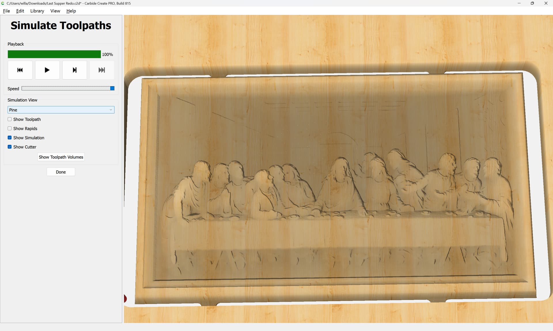

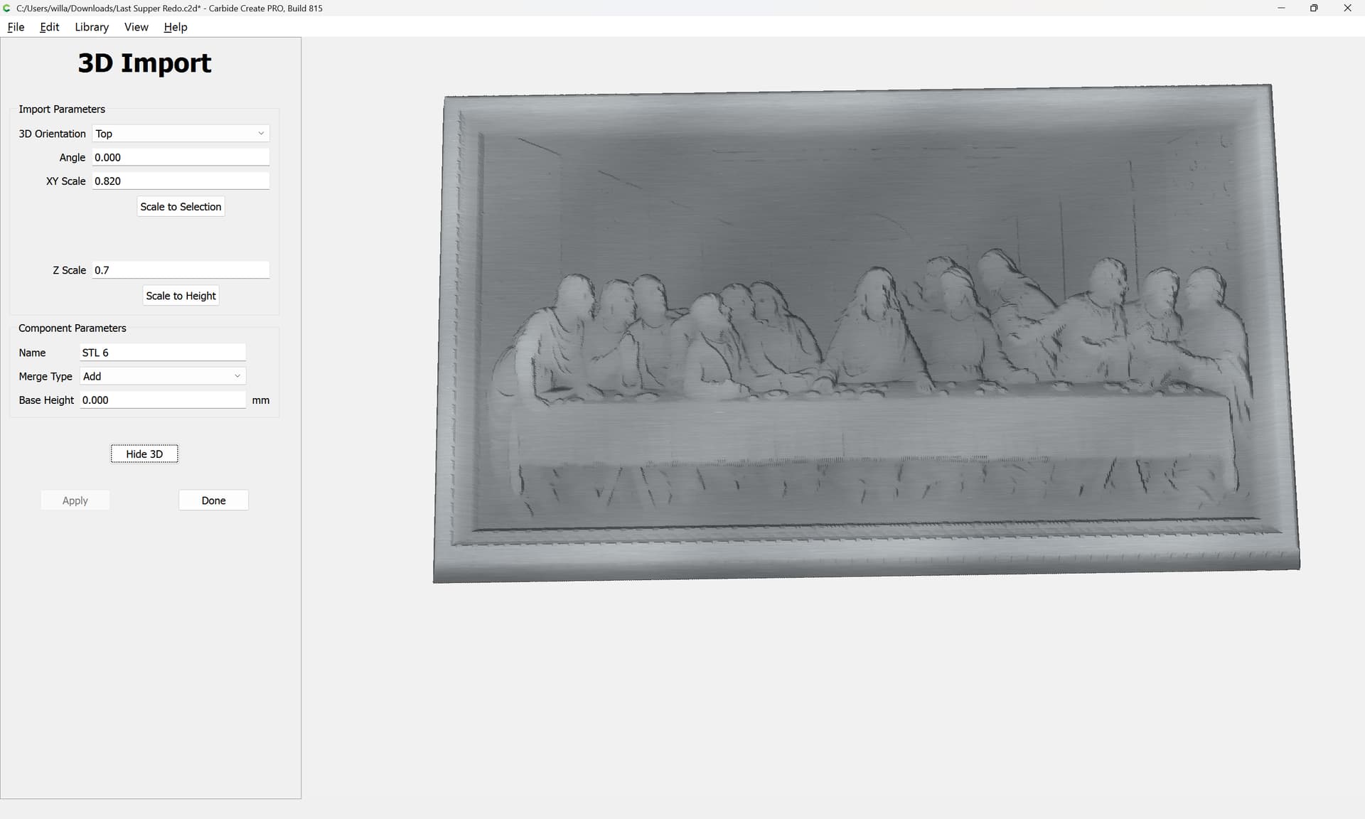

The STL seems fine:

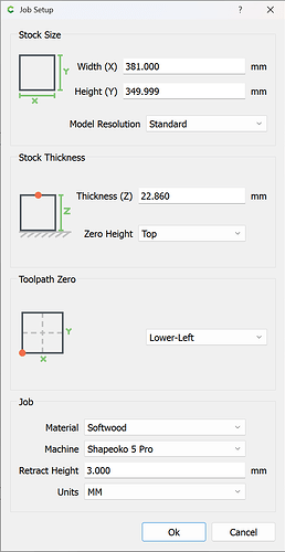

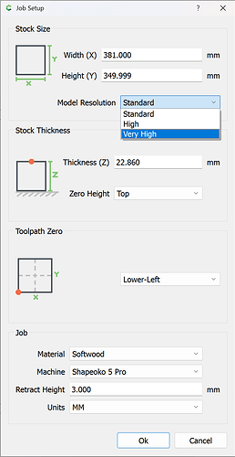

however, the Job Setup in the redo file:
is “Standard”, not “Very High”:
changing to that and re-importing we get:
and after adjusting the stepover we get:
