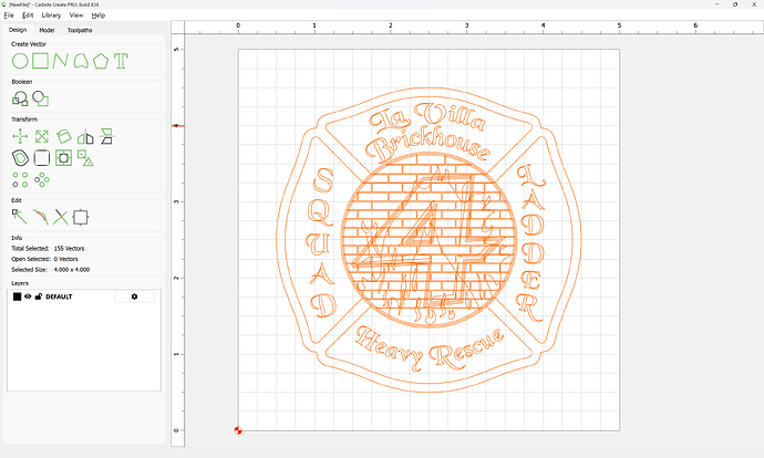

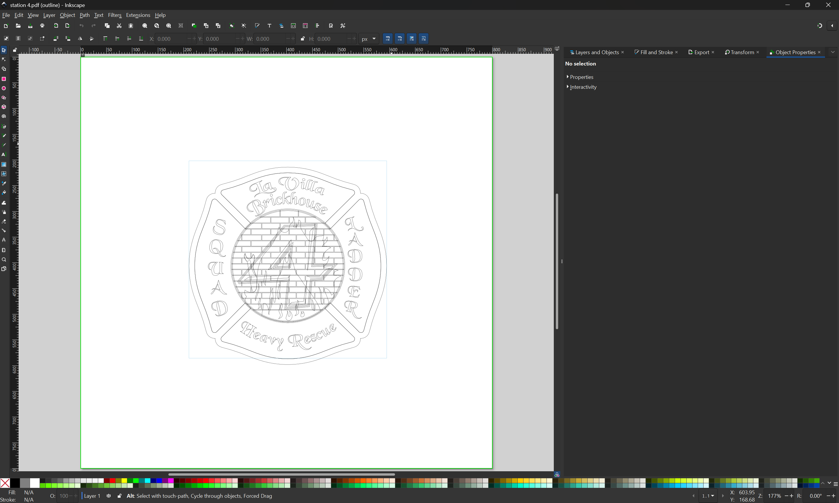

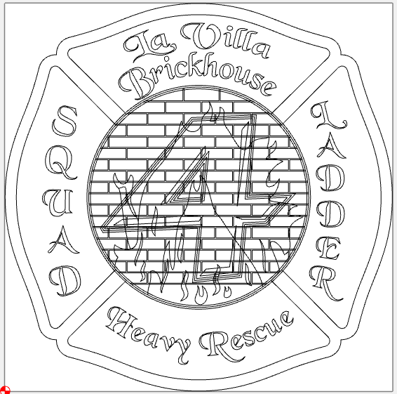

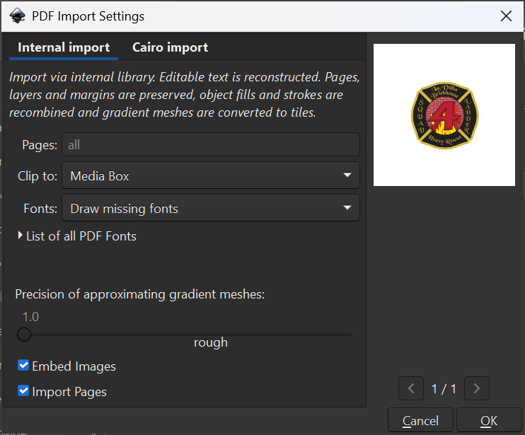

I can't get this file to load into CC
station 4 squad maltese full color copy
It’s an empty file. There’s an SVG structure with no actual paths.
So how can I get this file in a format to be uploaded into CC?
station 4.pdf (357.4 KB)
I’m trying to load it so I can route it into their table for their fire station.
I opened it in Inkscape & exported as .svg
It will need some cleanup as the vector objects overlap.
station 4

So I’m new at this game. When I try to open the file in CC it doesn’t give me option to select it. It’s grayed out.
You need to open the PDF in Inkscape:
Resave as an SVG:
station 4

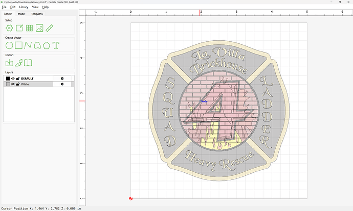

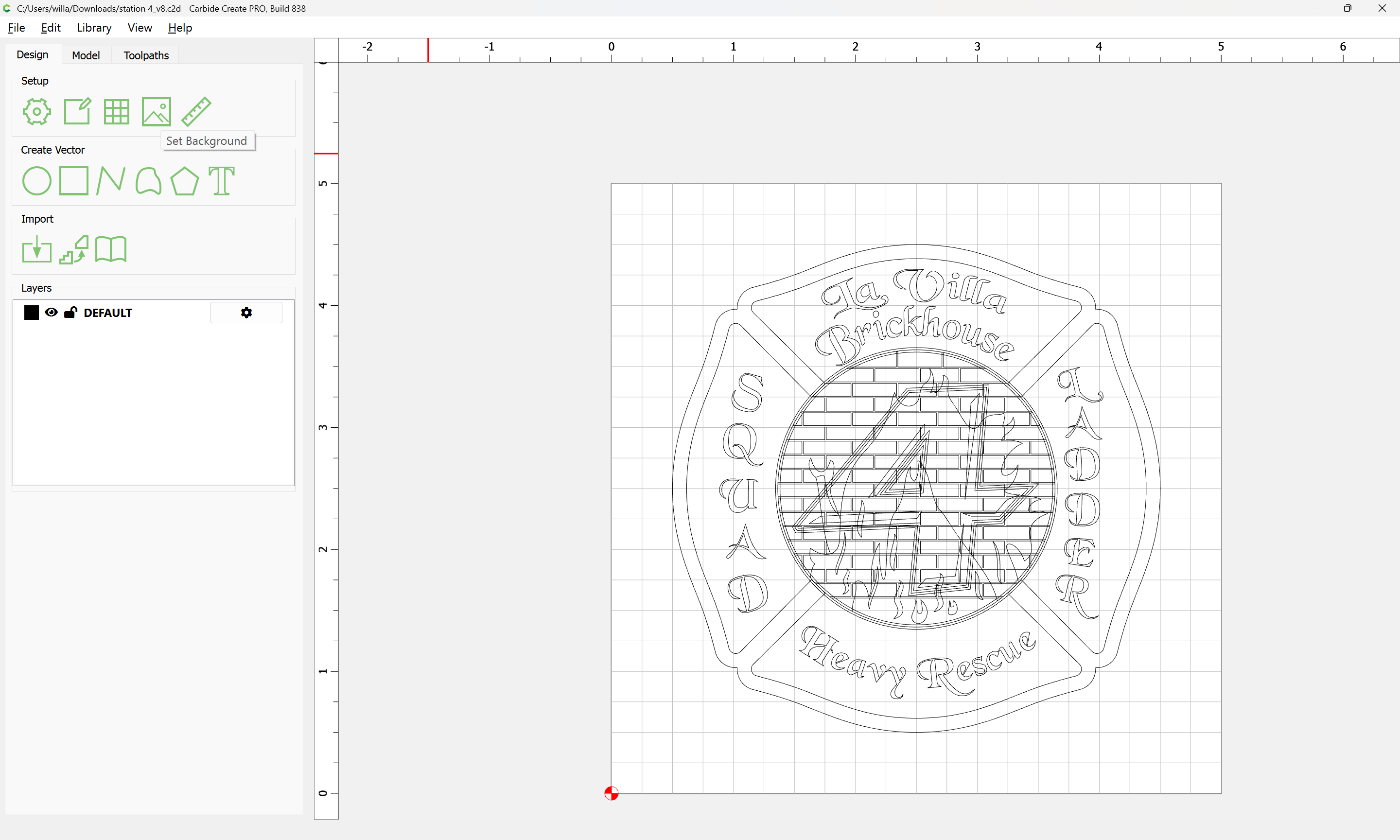

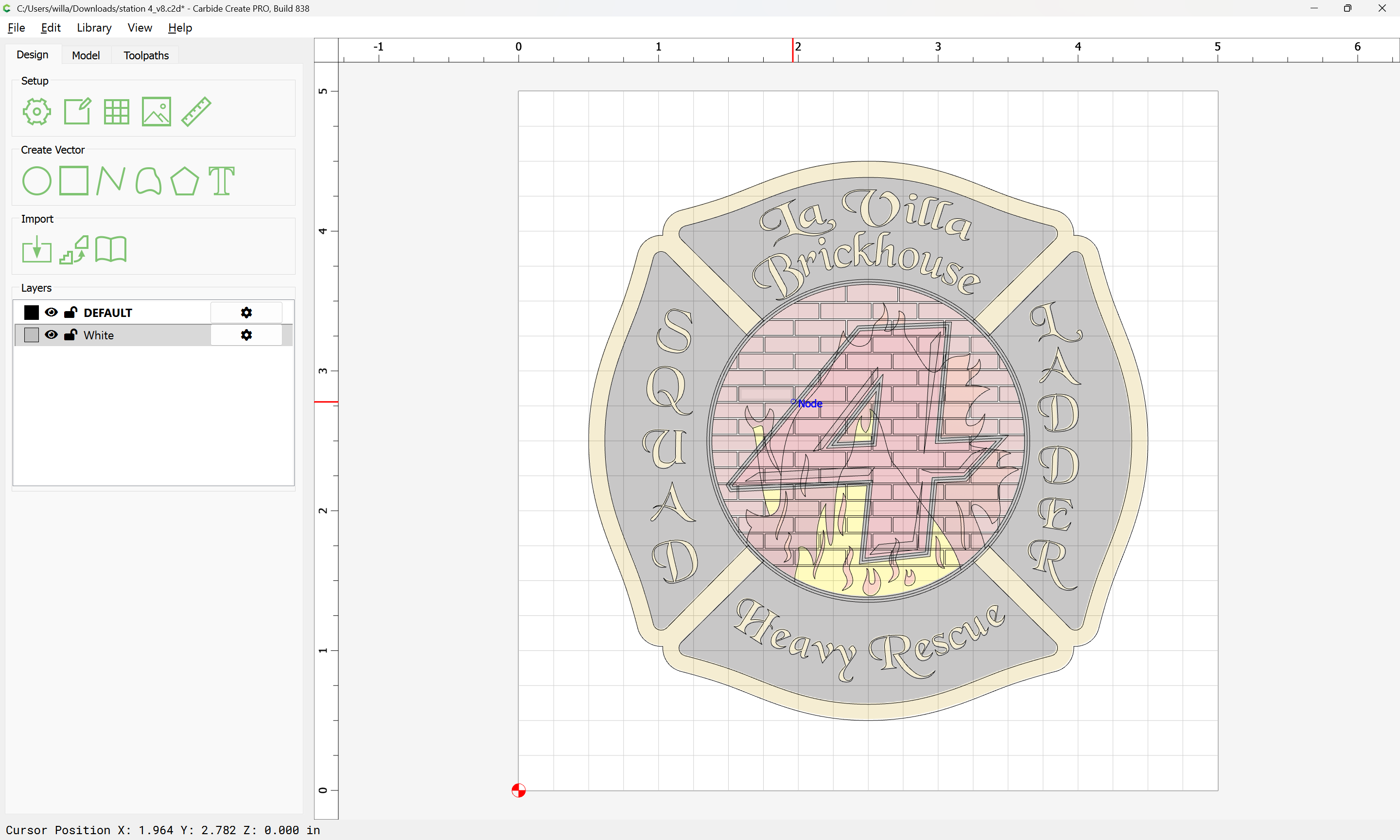

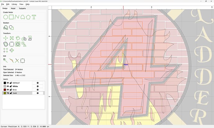

which will then open in Carbide Create:

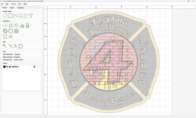

Attached as a v8 .c2d
station 4_v8.c2d (320 KB)
Fixing the file is left as an exercise for the reader (or something for me to do during lunch).

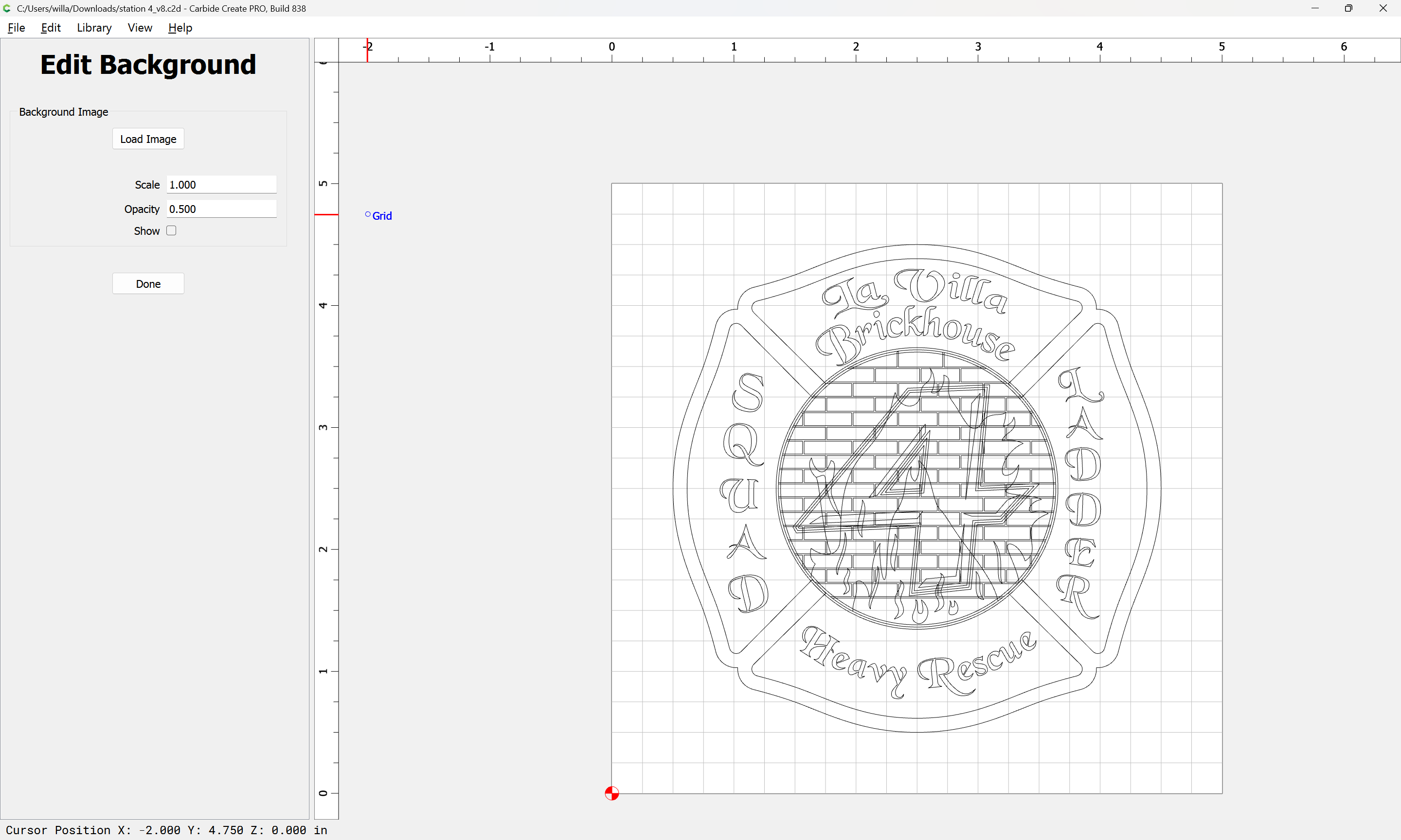

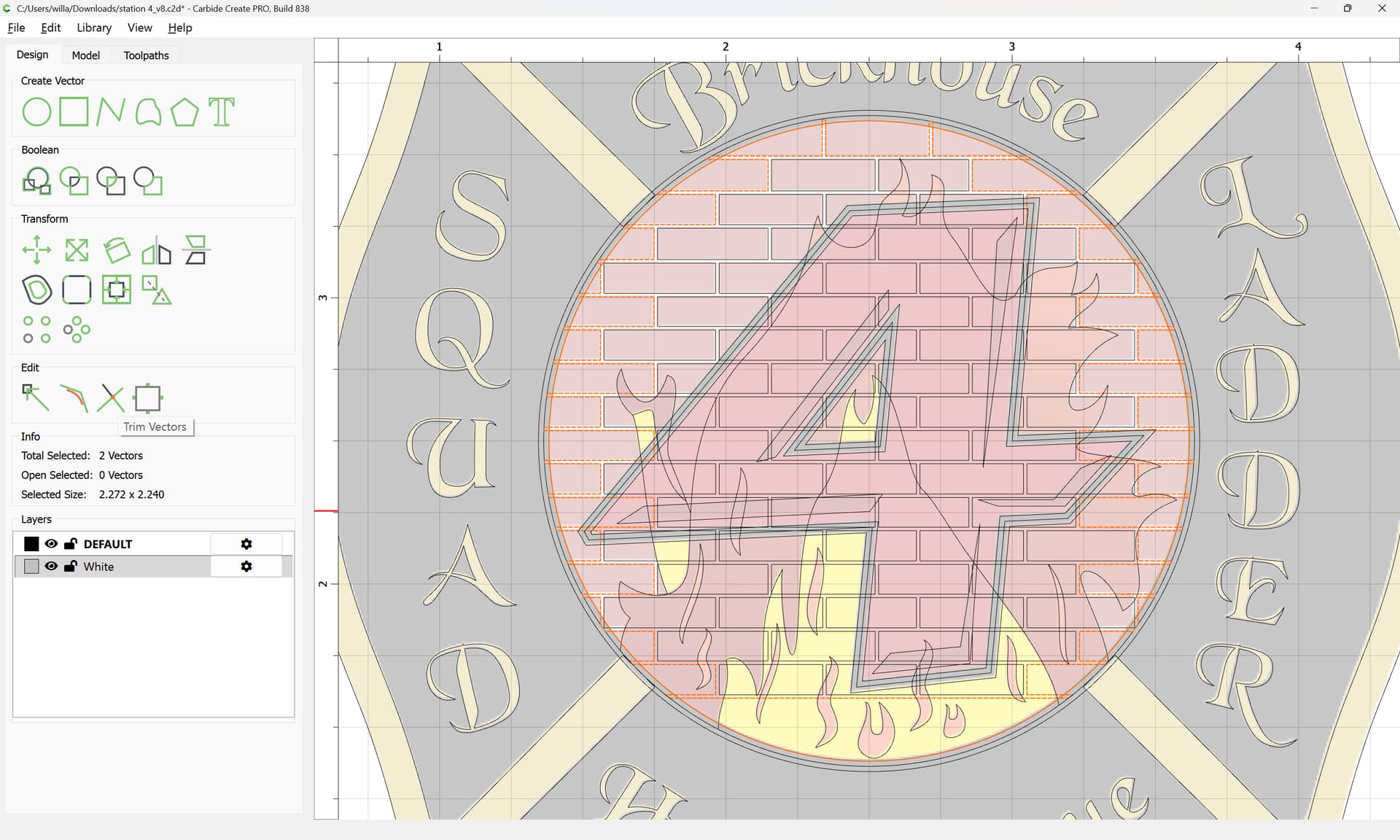

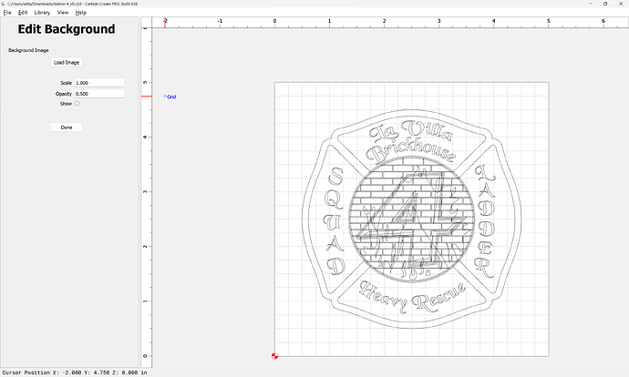

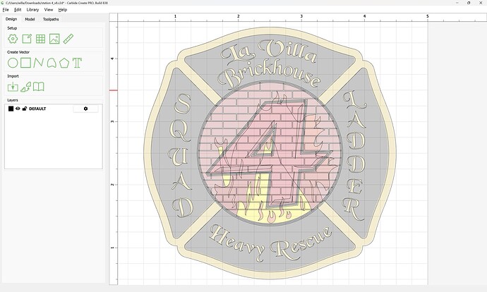

Start by importing the pixel image for reference:

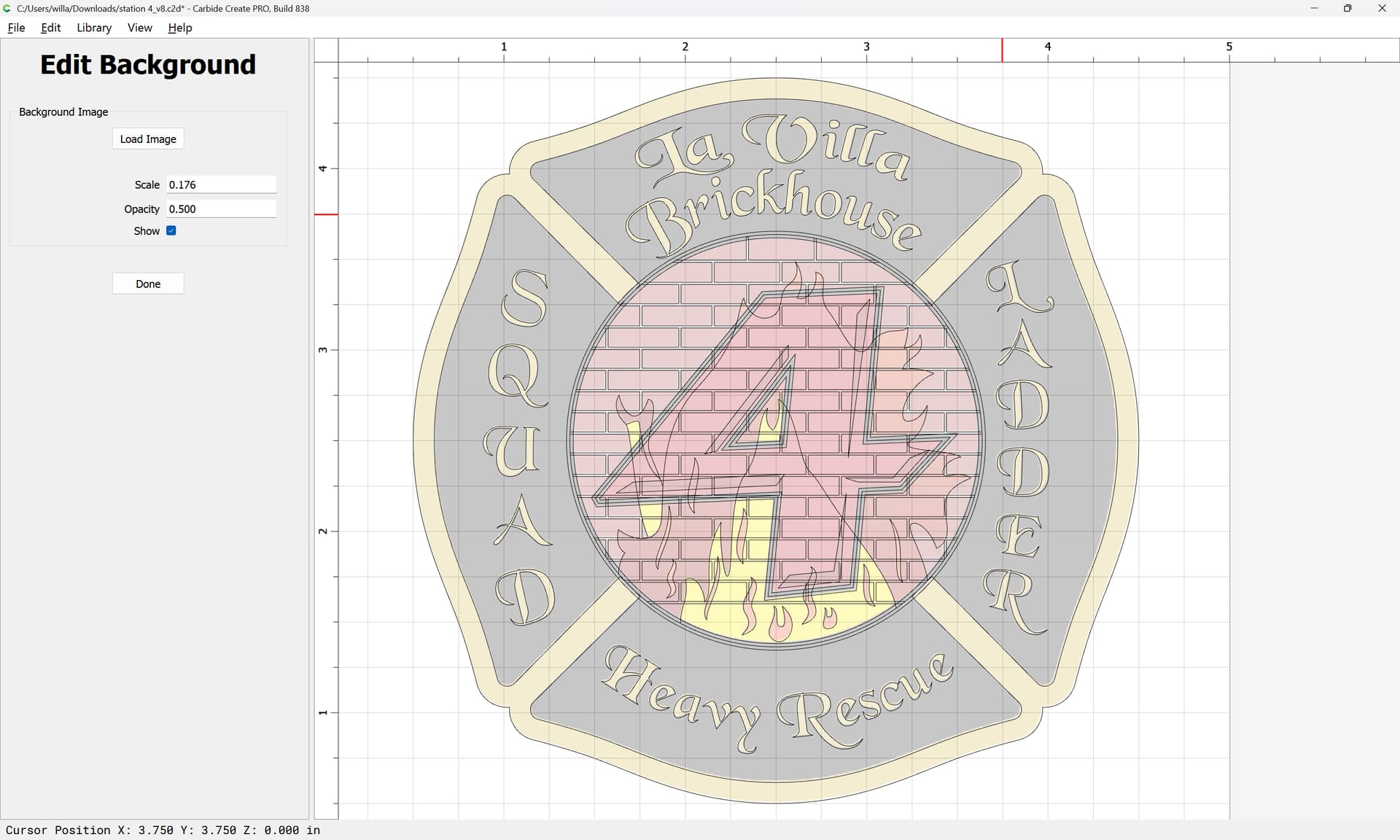

Load Image and adjust:
Done

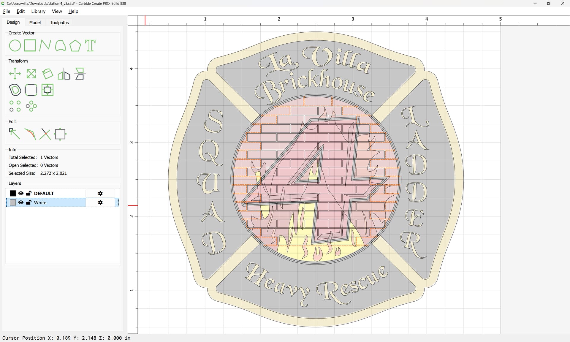

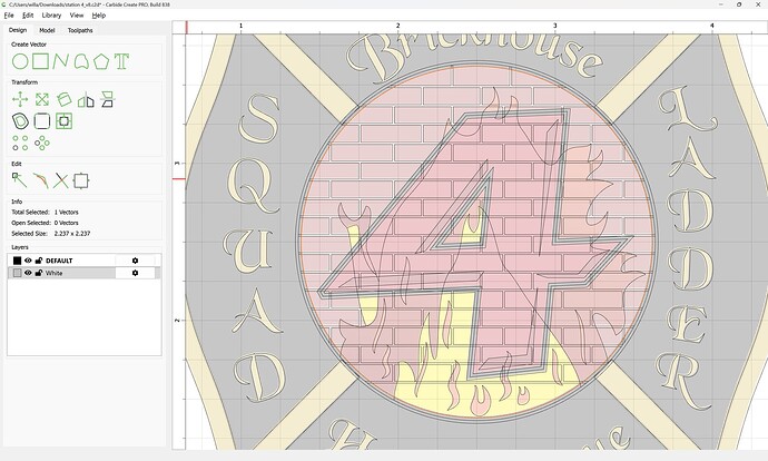

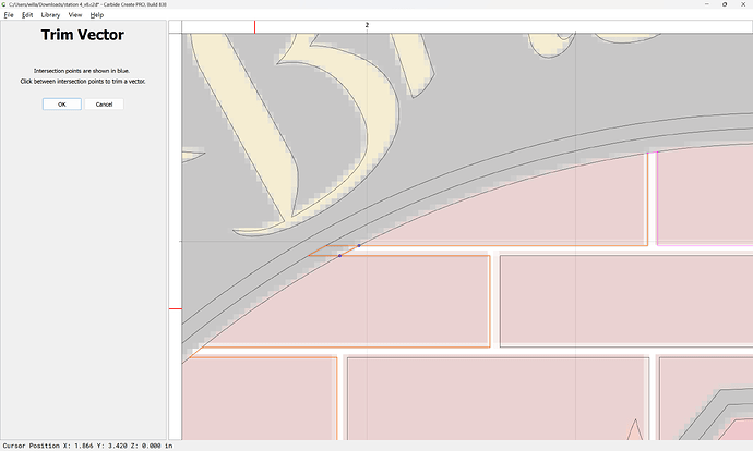

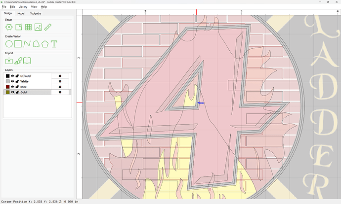

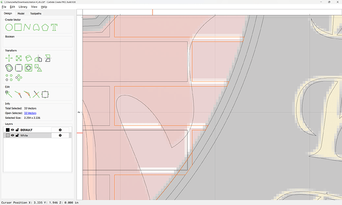

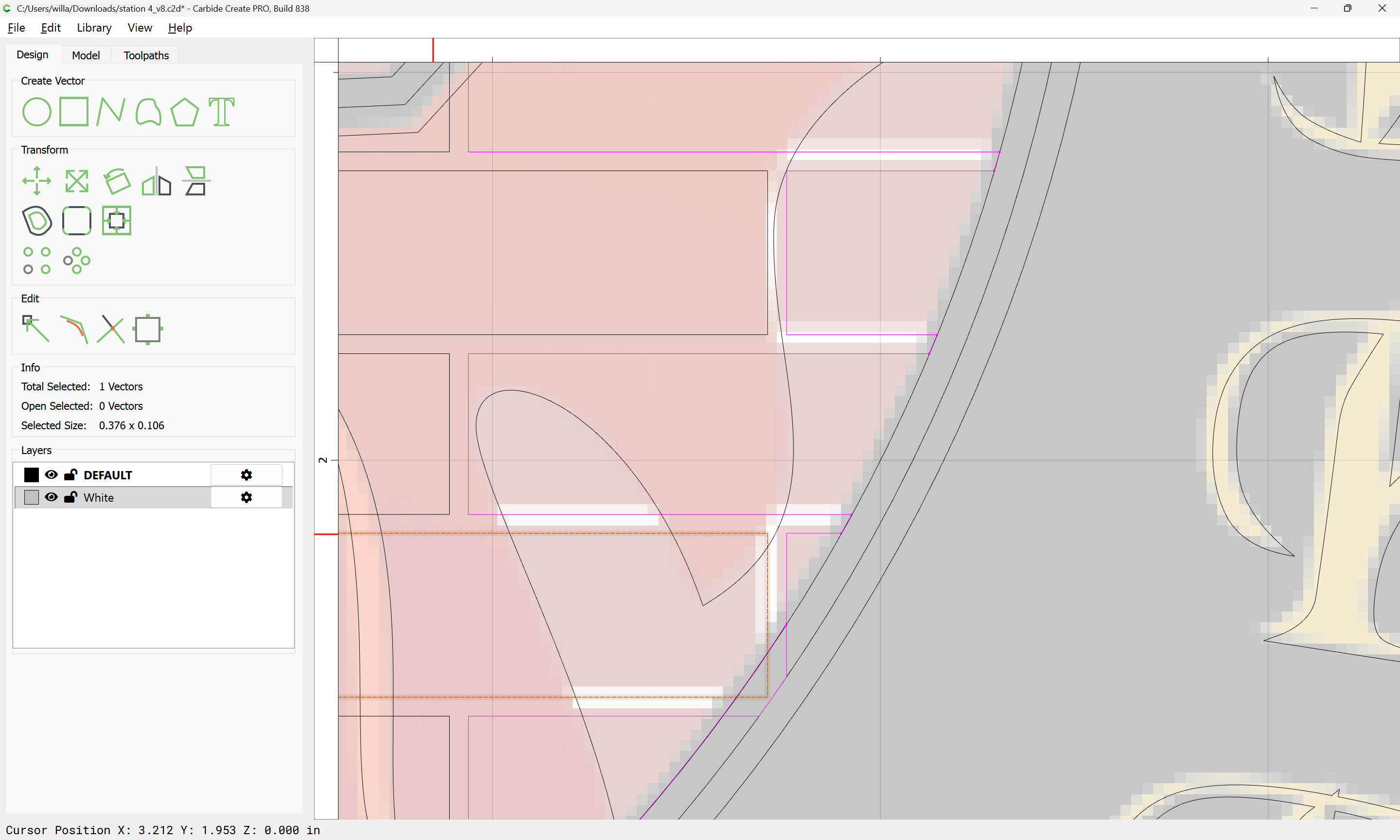

It will then be necessary to isolate each colour to a separate layer, and edit the geometries until each colour region is represented by a distinct and discrete set of closed vector regions.
A pixel image version of the file:

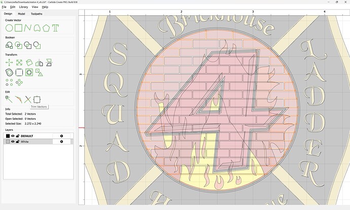

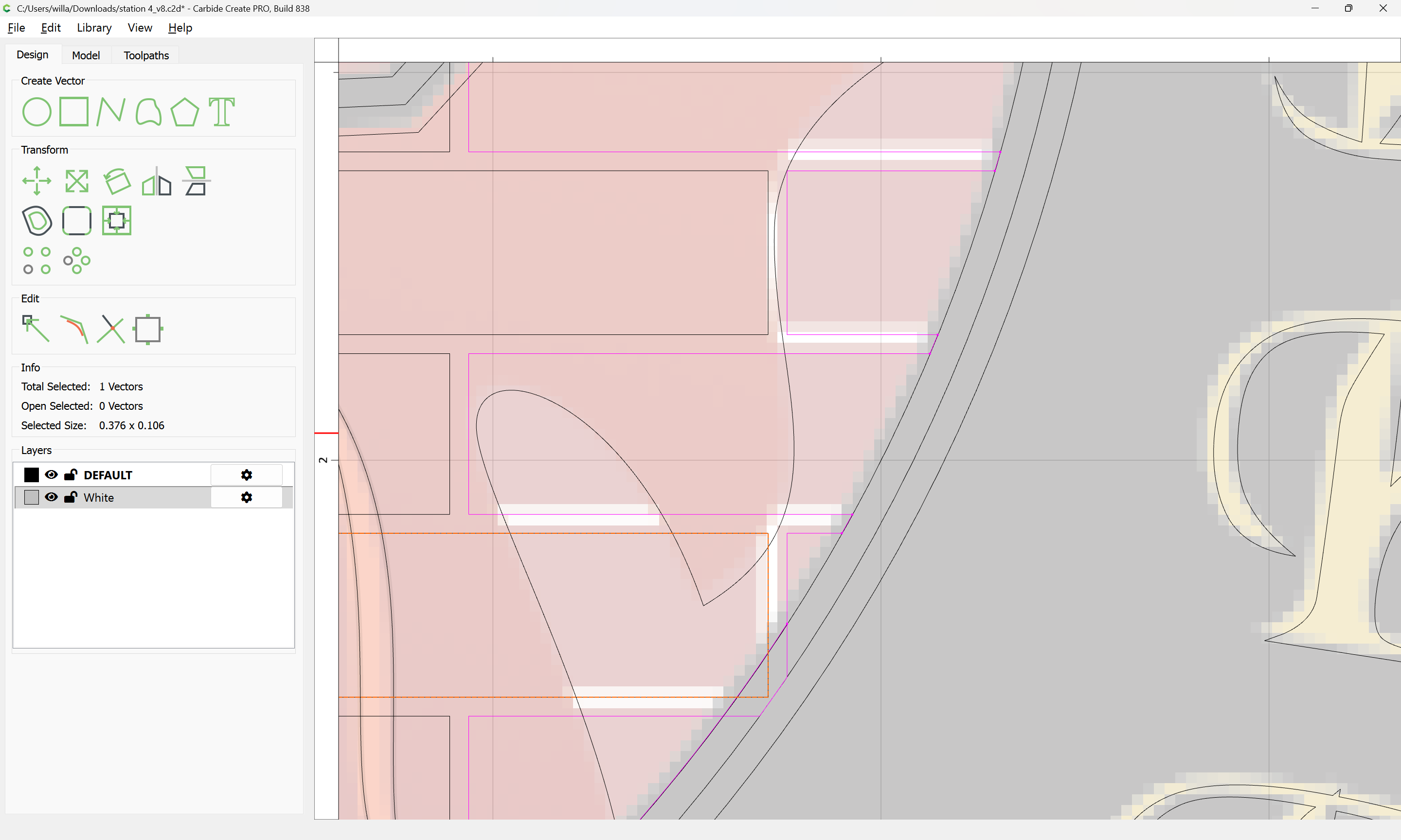

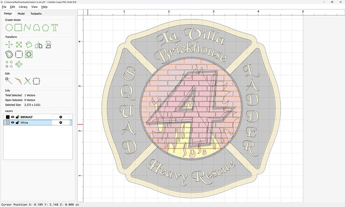

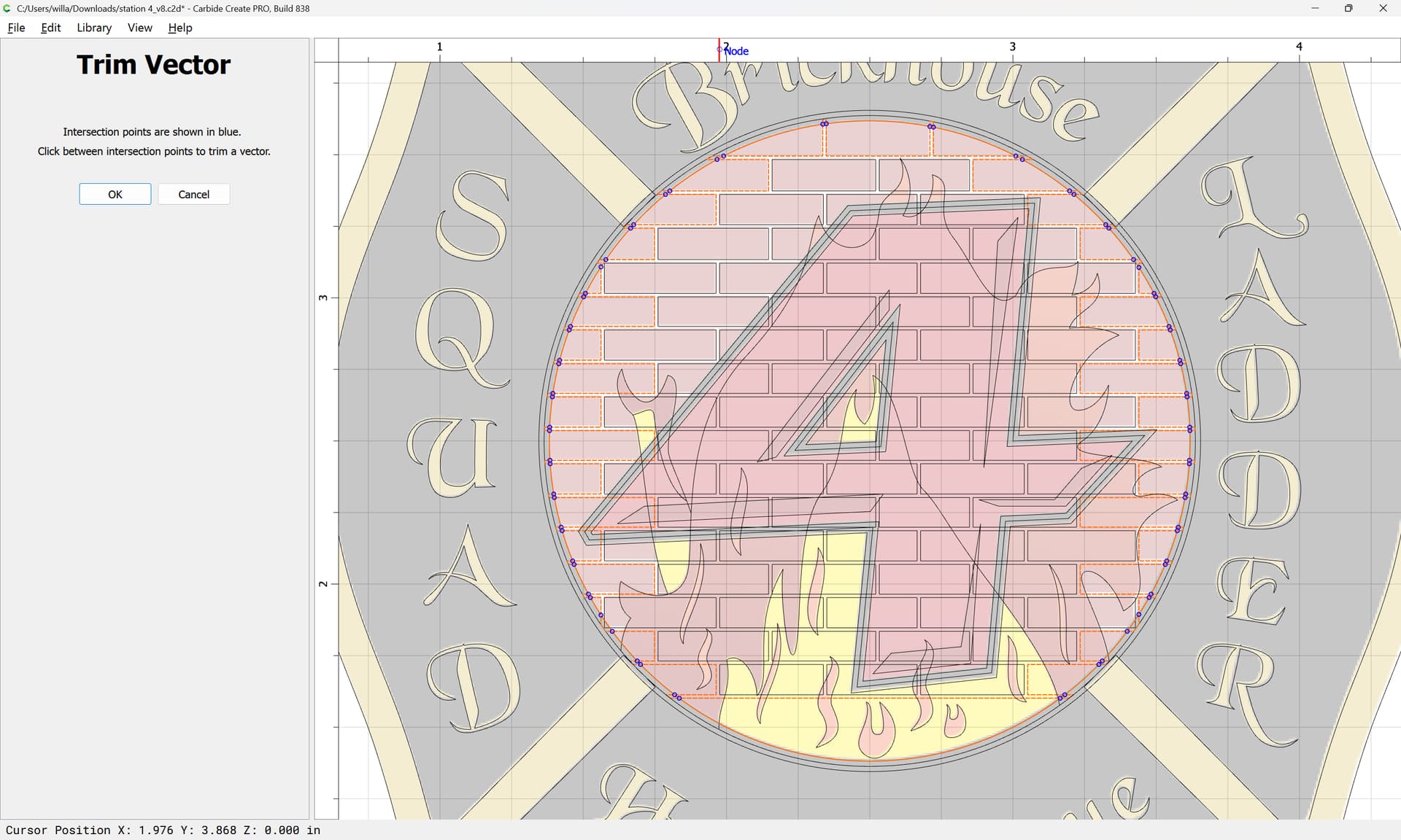

For each region:

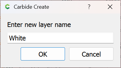

It will be necessary to create a layer:
and duplicate any geometry which also defines another region:

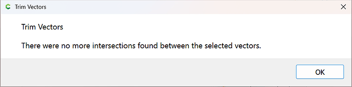

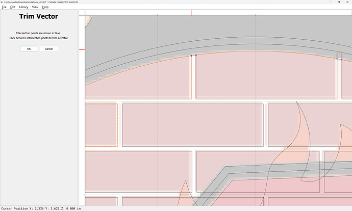

Then shift-click to select all the geometry which one wishes to work with:

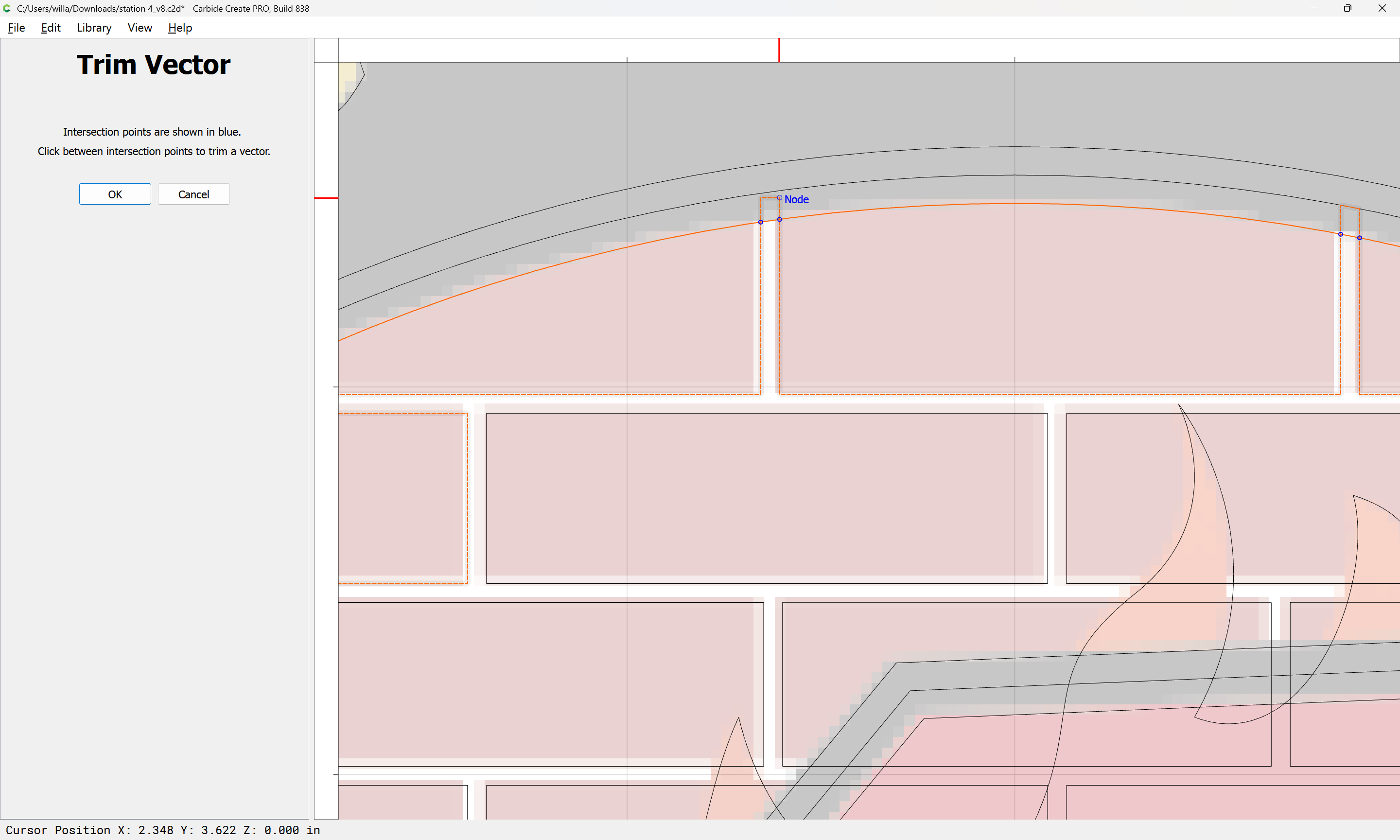

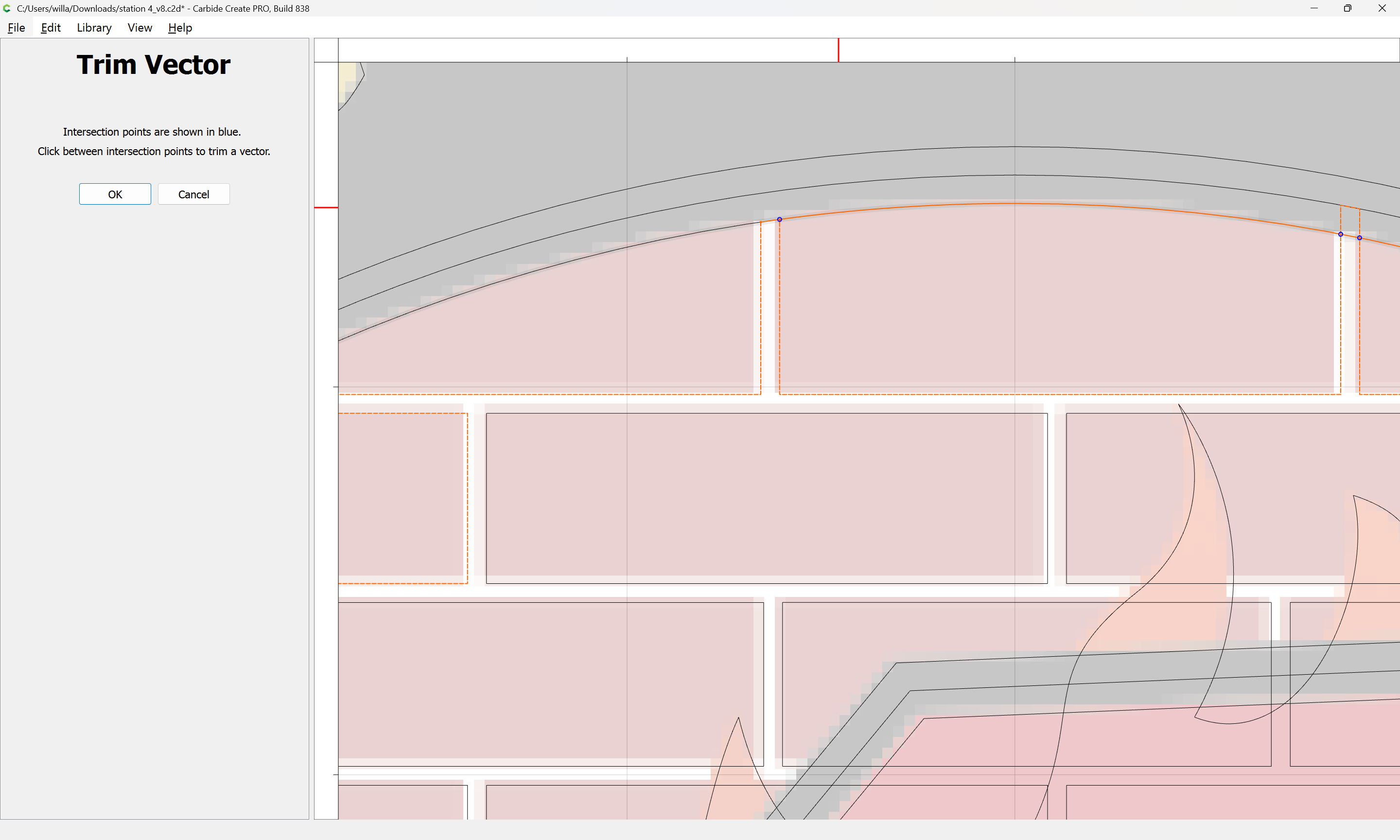

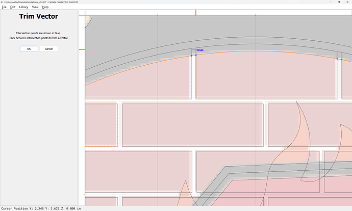

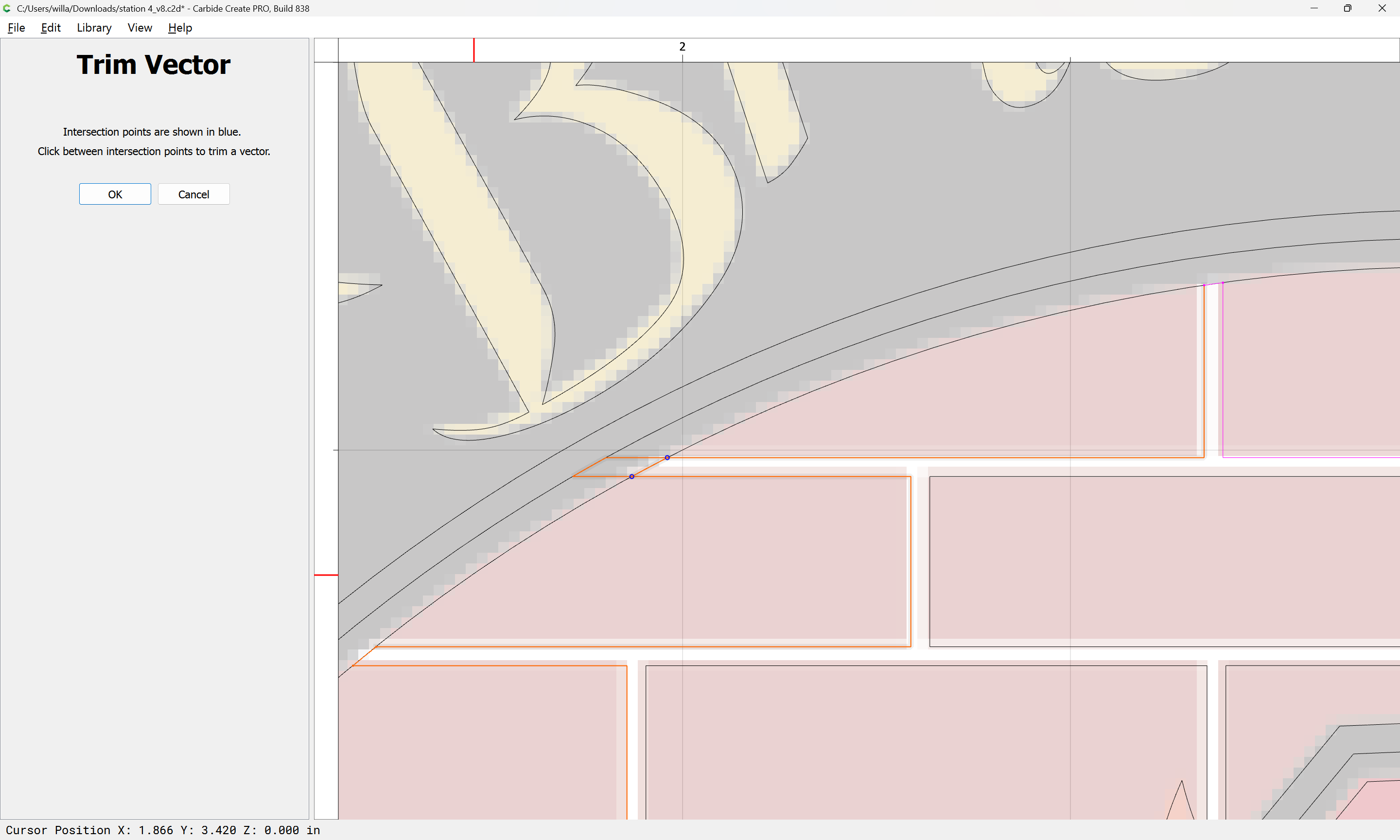

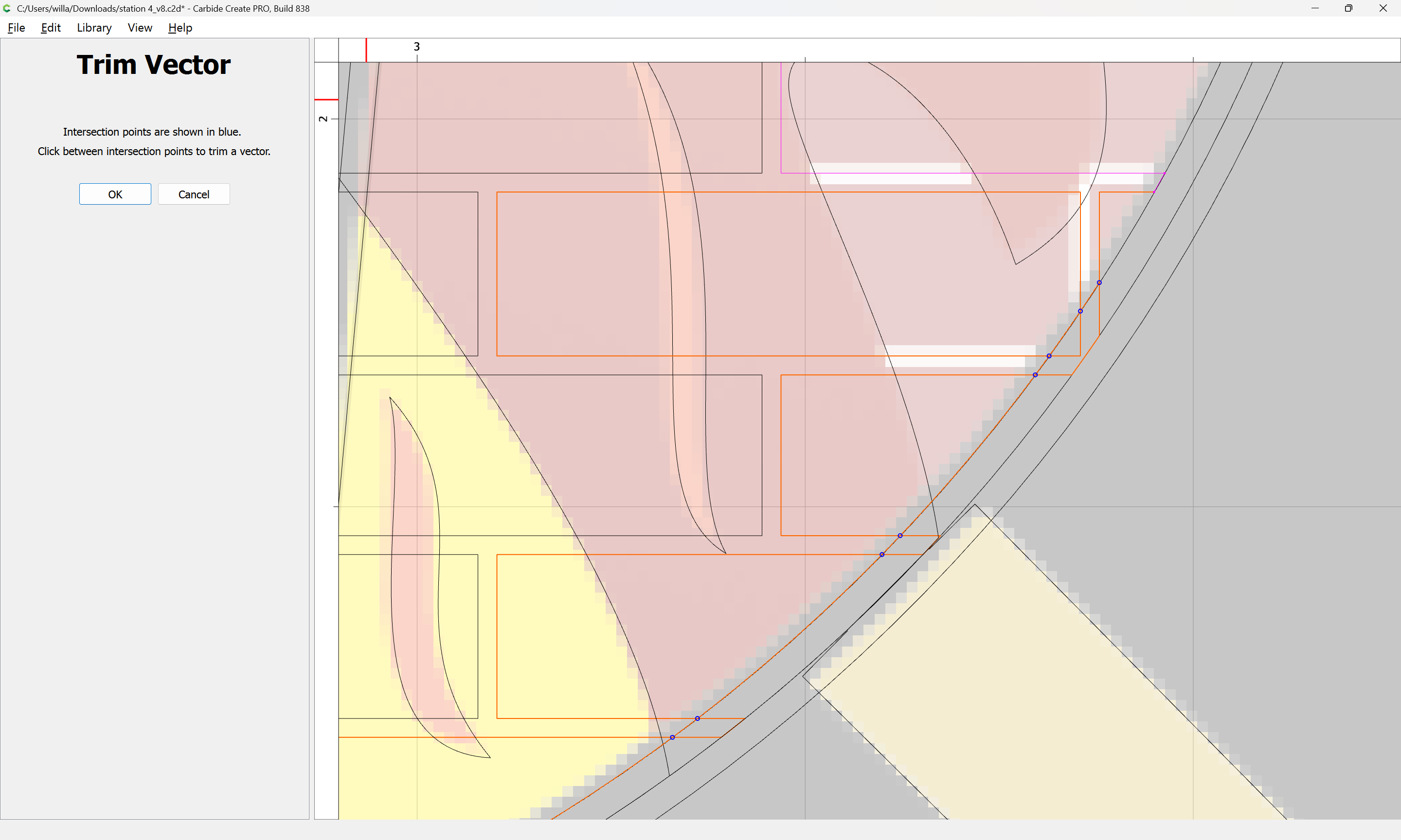

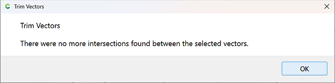

and use Trim Vectors to remove what is not wanted:
zooming in where necessary:

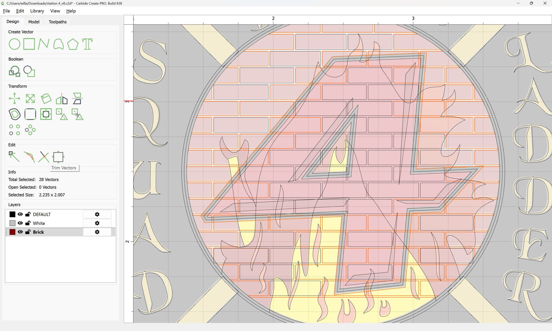

and where need be, exiting:
and duplicating:
adding to the selection:
Working around until one arrives at:

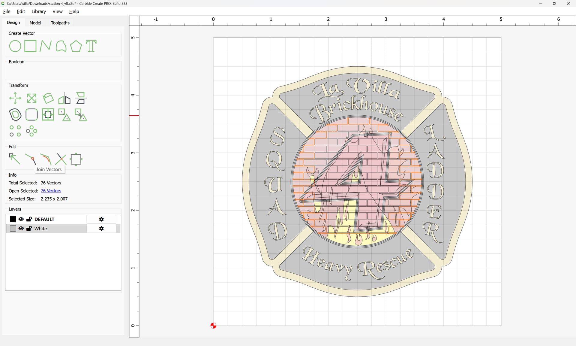

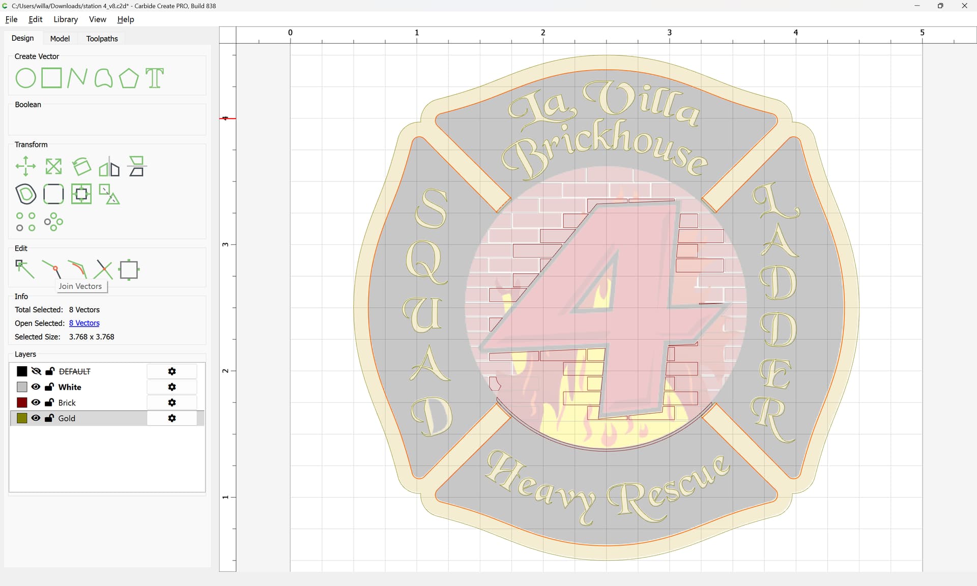

OK

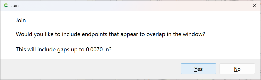

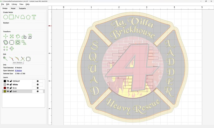

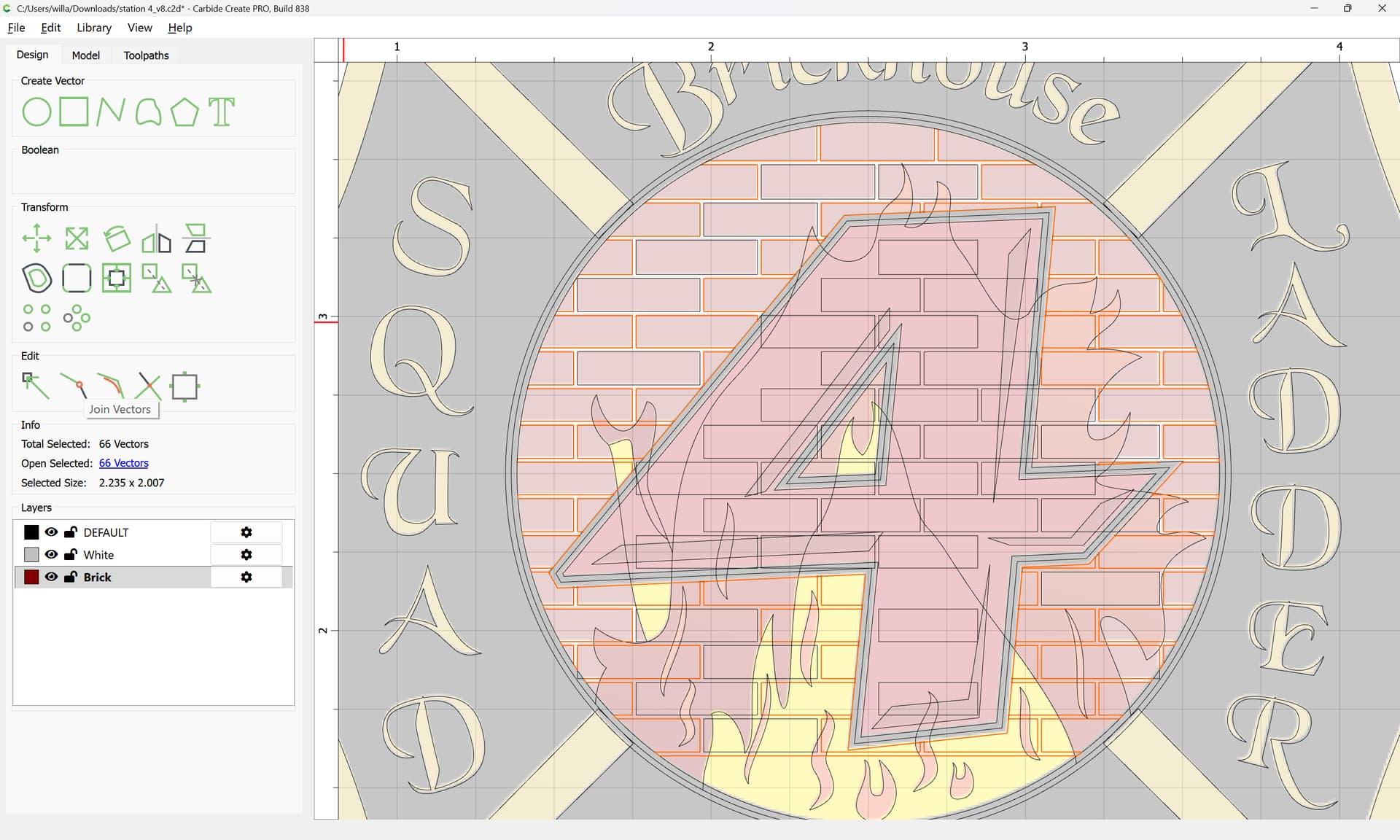

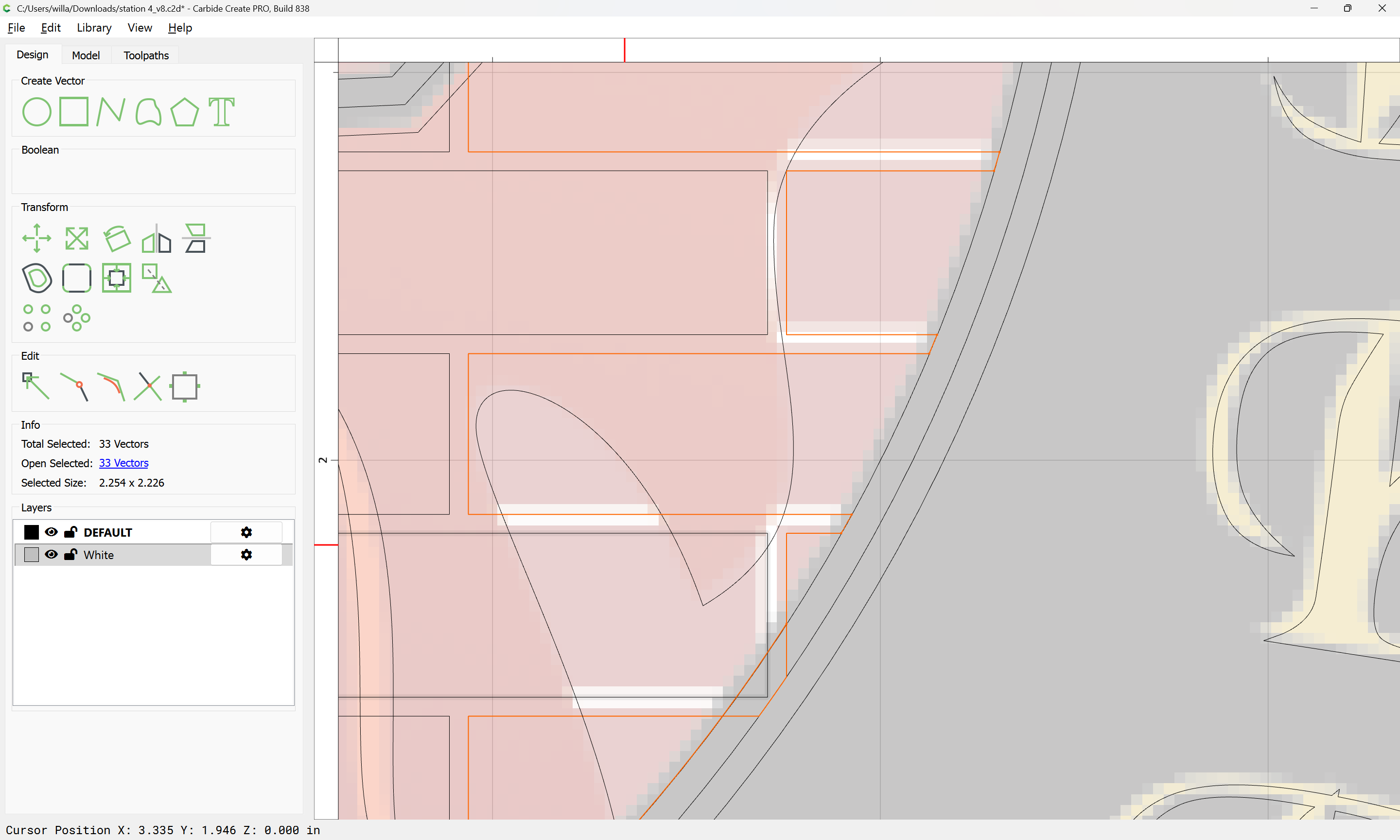

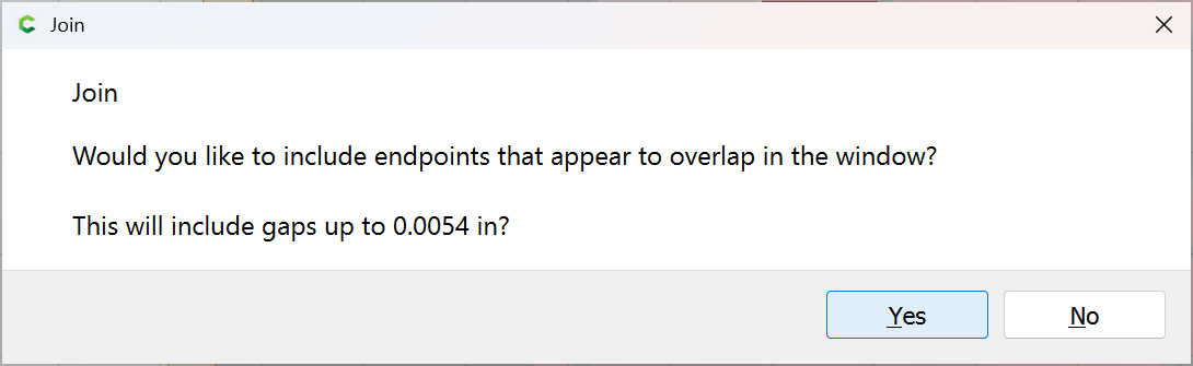

Join Vectors:
Yes

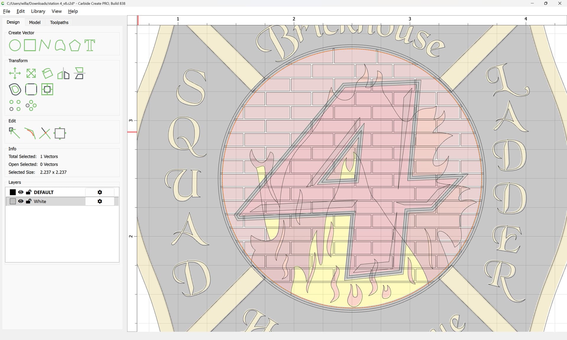

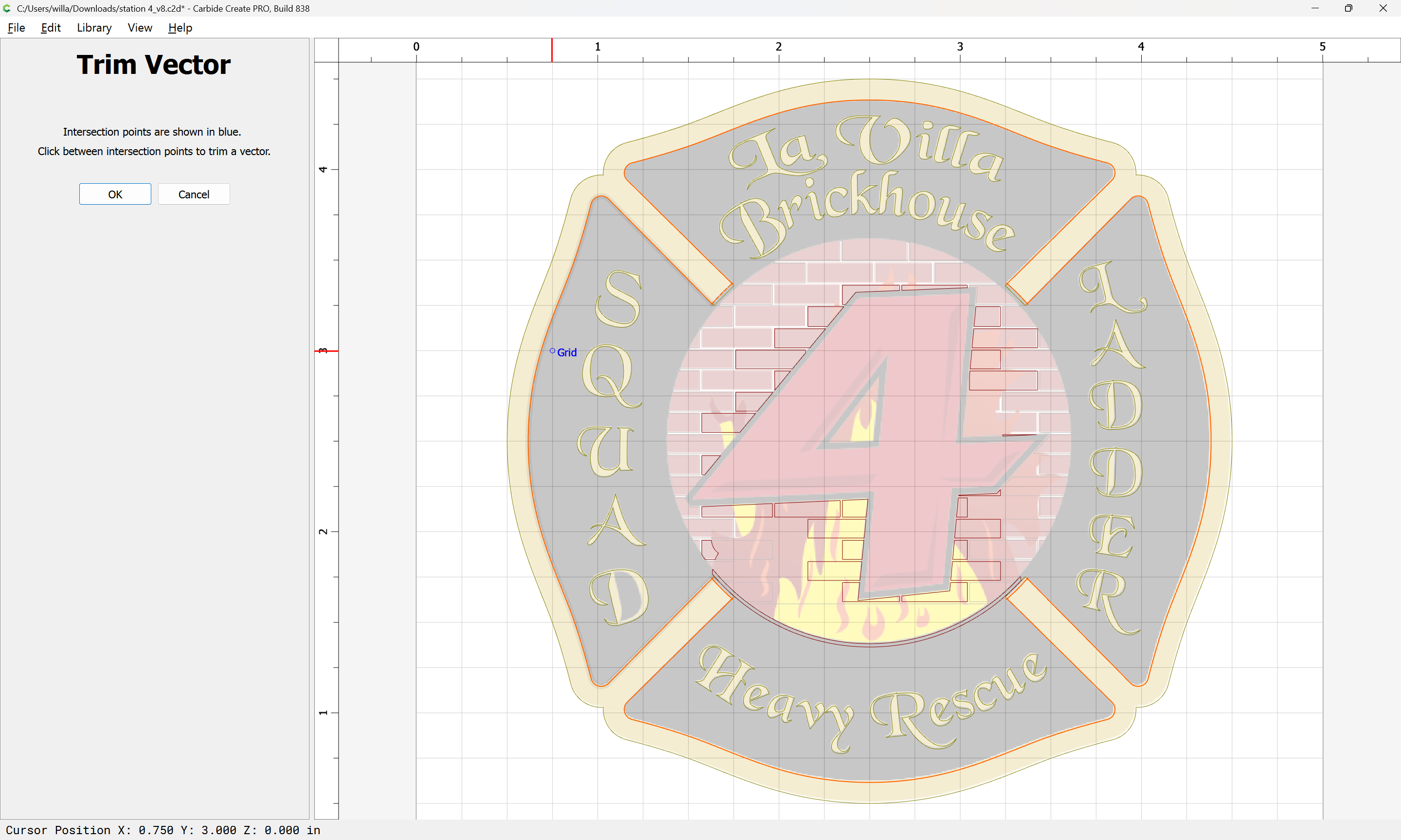

Repeat for the other colours/regions.

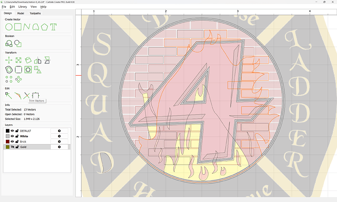

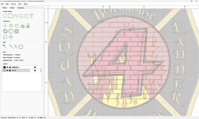

Trim Vectors
OK
Join Vectors
Repeat for other regions:
Join Vectors
Yes

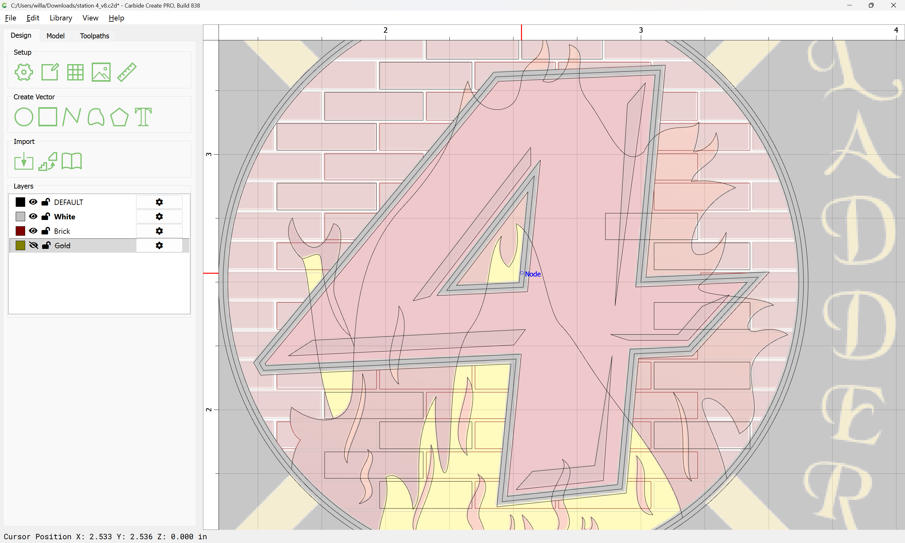

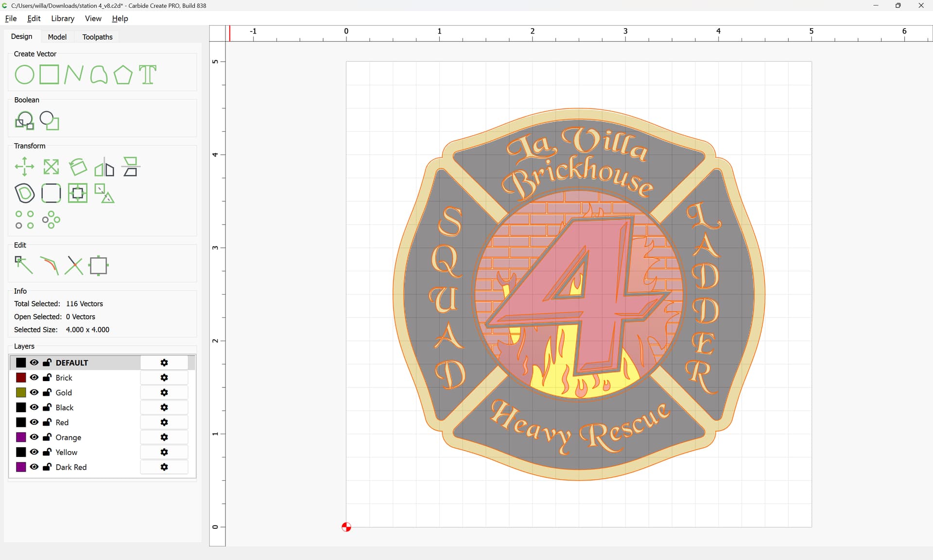

Where appropriate, select elements which are totally obscured:
and delete them:
Continue for other regions:

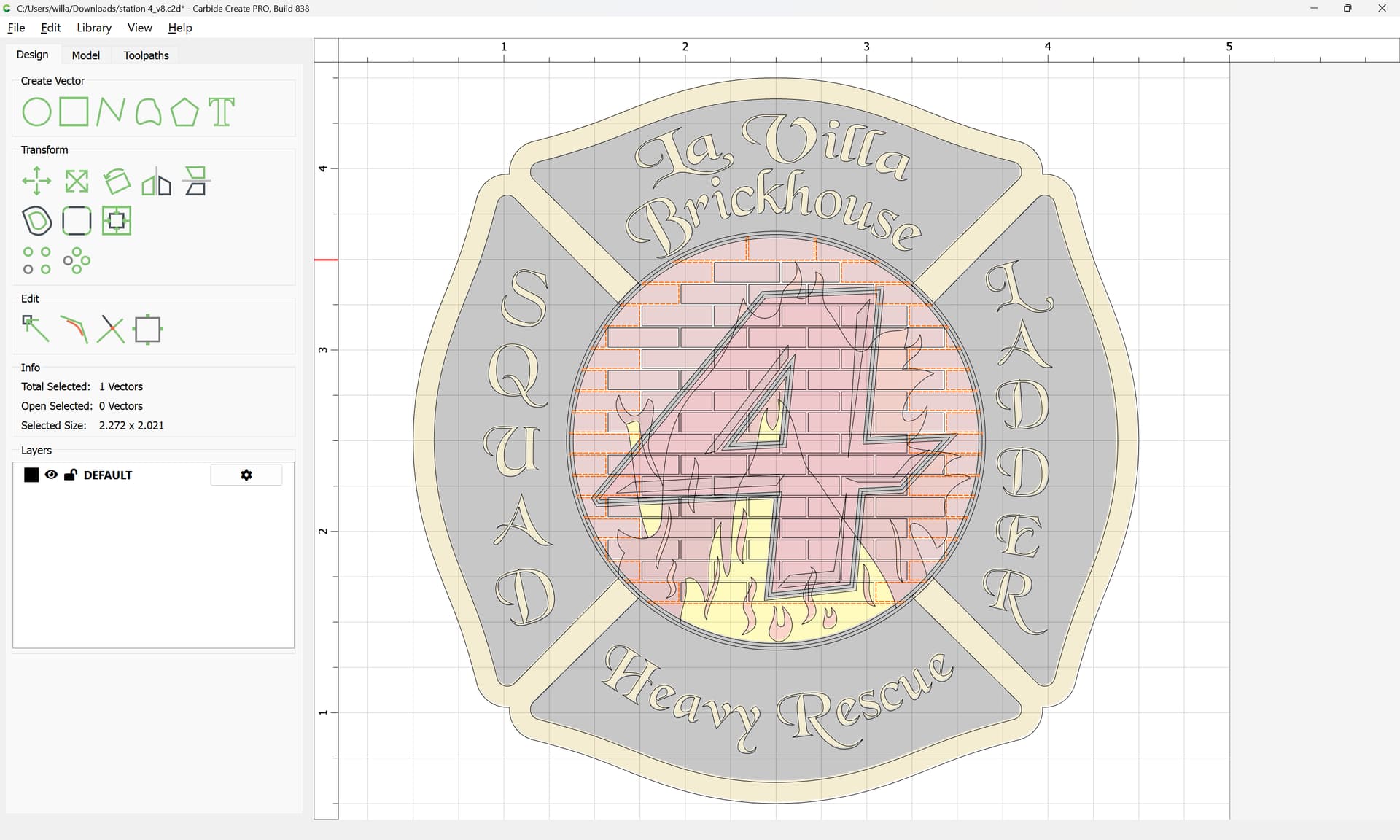

Eventually, one arrives at something like to:
station 4_v8.c2d (464 KB)
