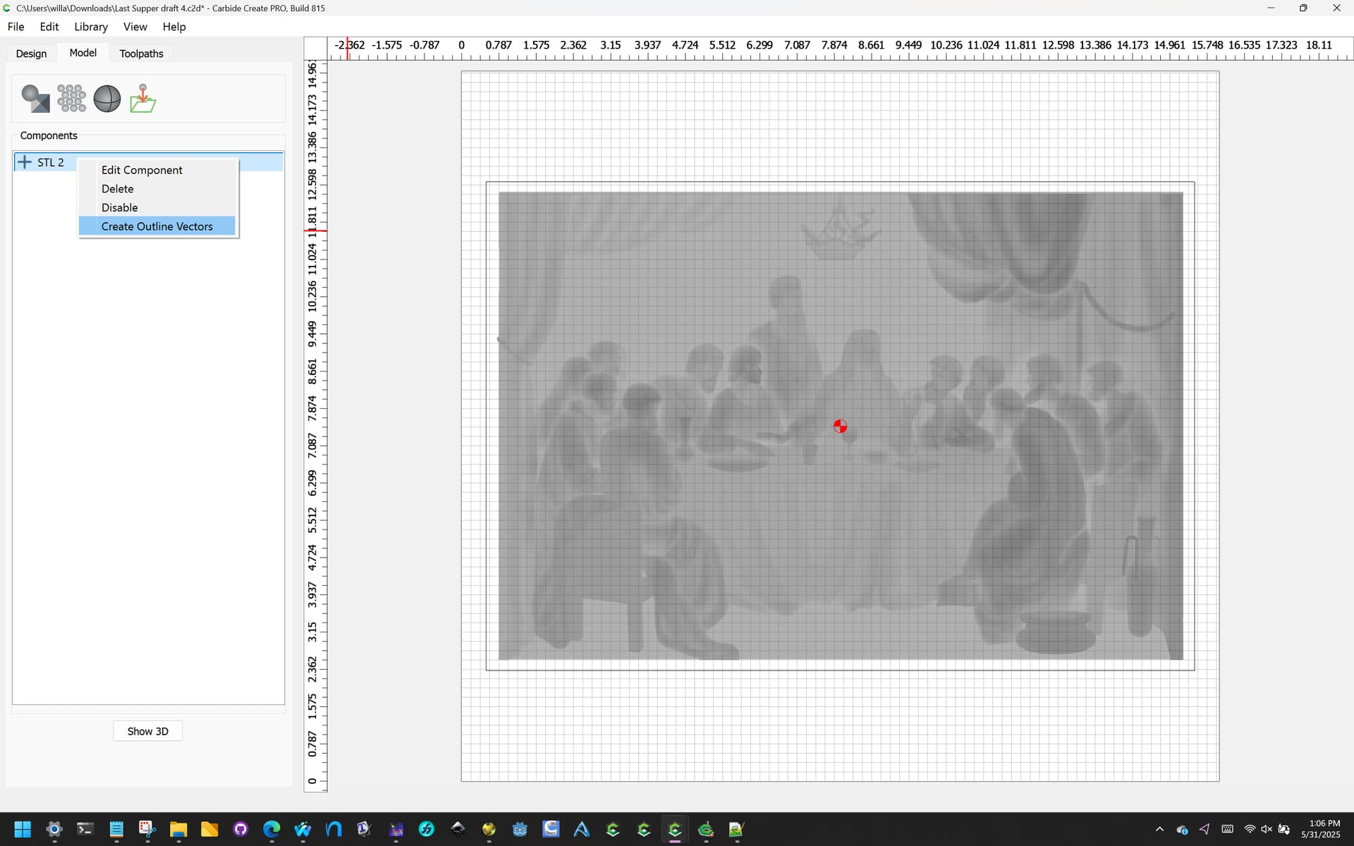

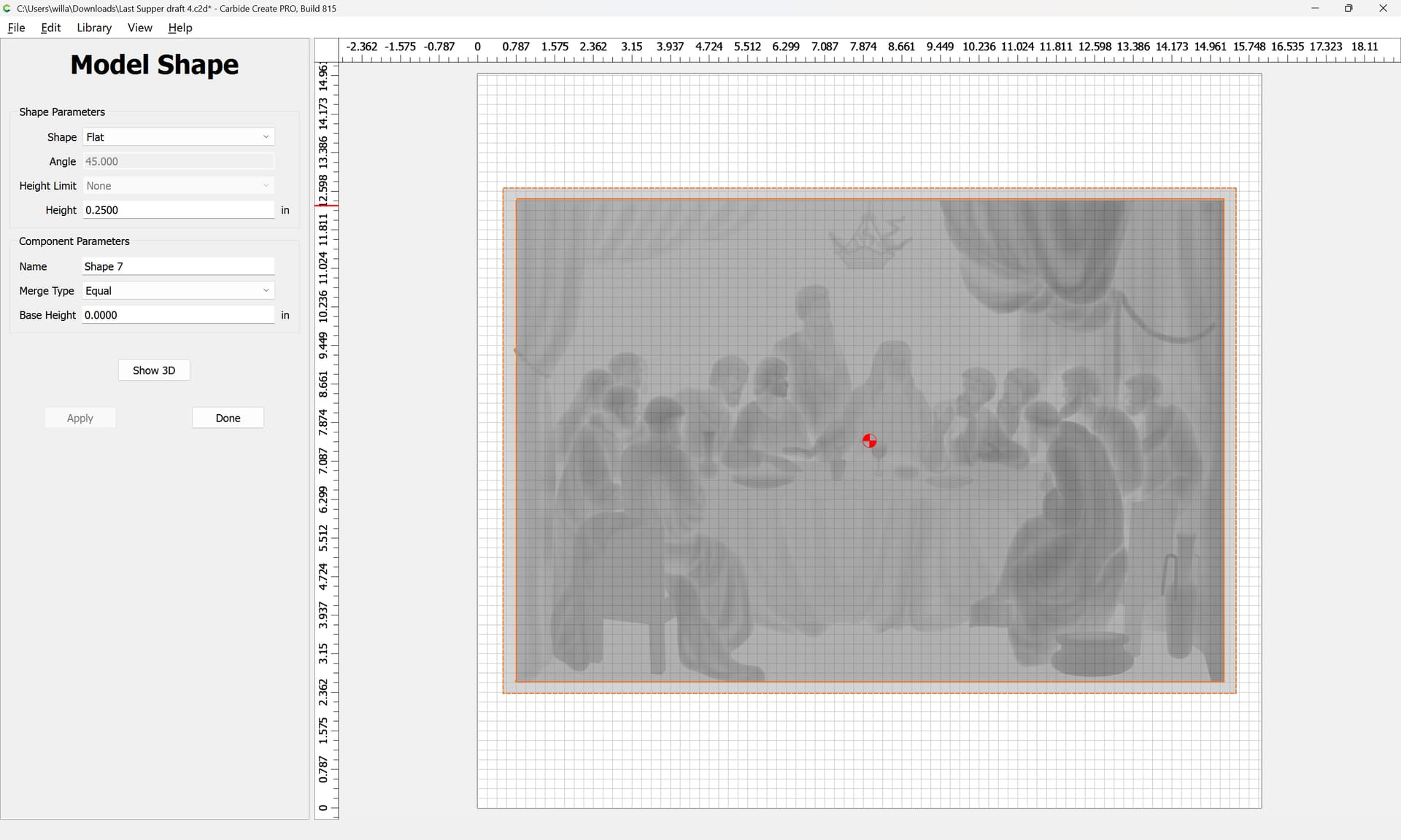

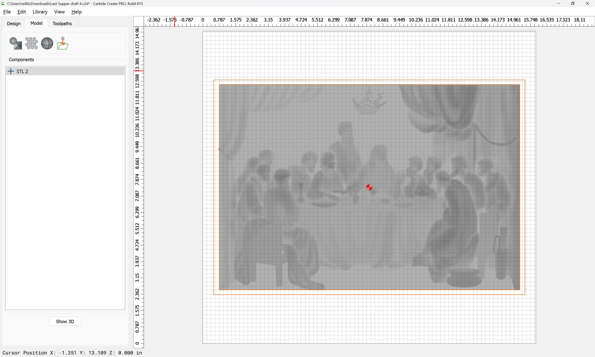

I need help with a file. On my 4th version
I have imported a stl file and assigned the toolpaths. The simulation shows the stl image cutting well but it also shows the project perimeter being cut fully out.
I would like to have a 1/4 inch perimeter around the project and can’t figure out how to do that.
Any help or guidance would be greatly appreciated.
https://www.dropbox.com/scl/fi/q8vgnf0xzjzojzmtmiz44/Last-Supper-draft-4.c2d?rlkey=cpwkm3ntm9lwan03dicku949b&st=9gwdard3&dl=0
right-click on the 3D model:

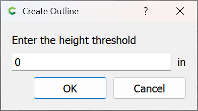

trace it:
OK

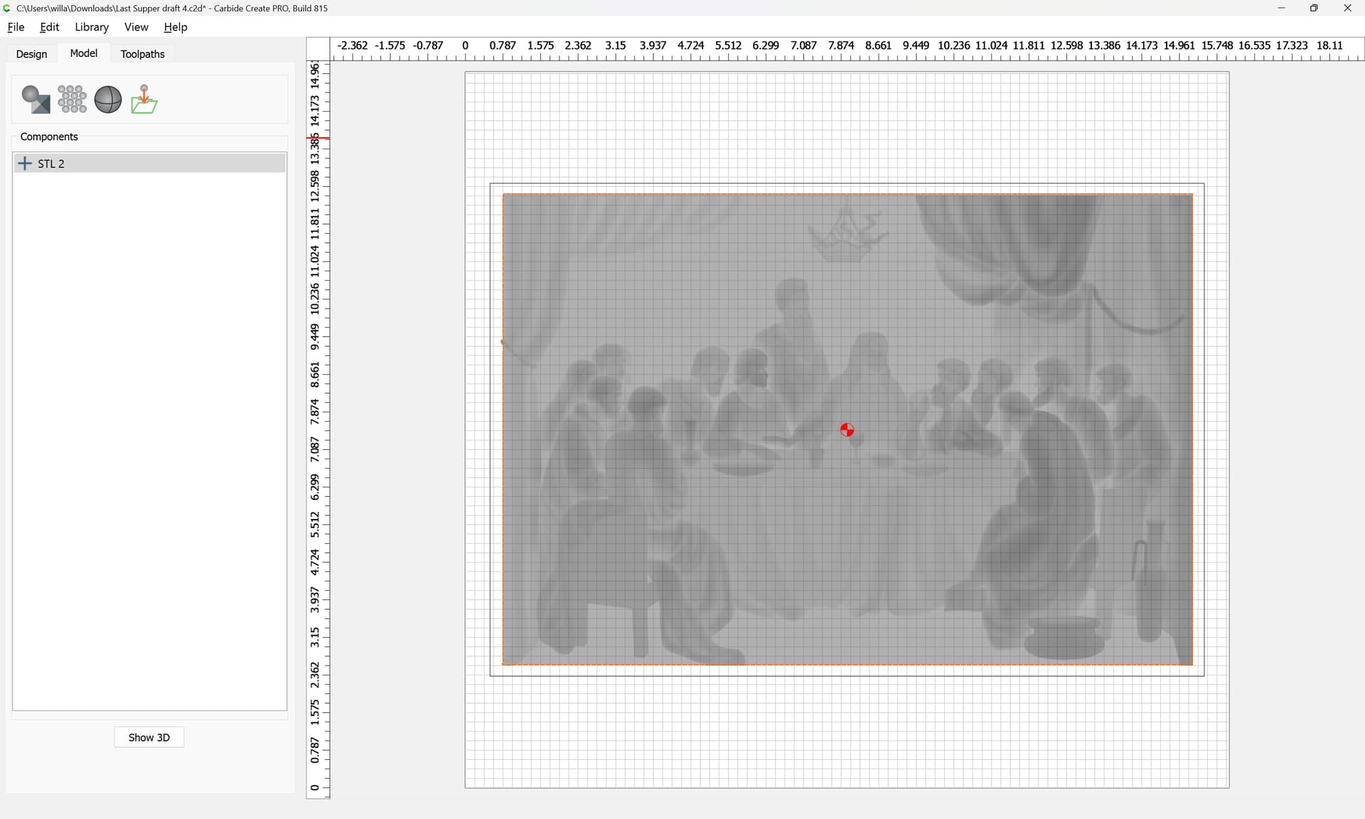

Select that and the border:

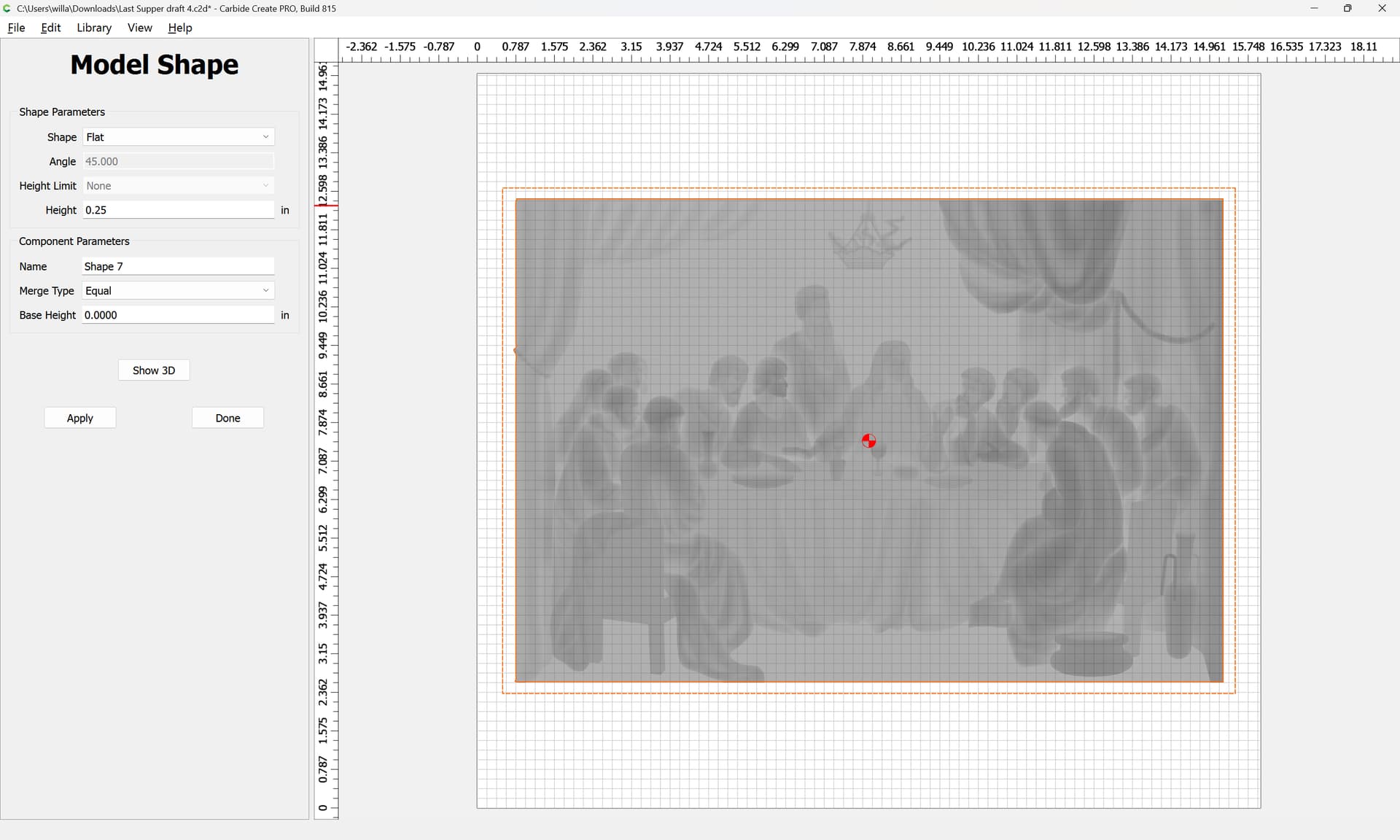

Model as an 0.25" flat thickness:
Apply

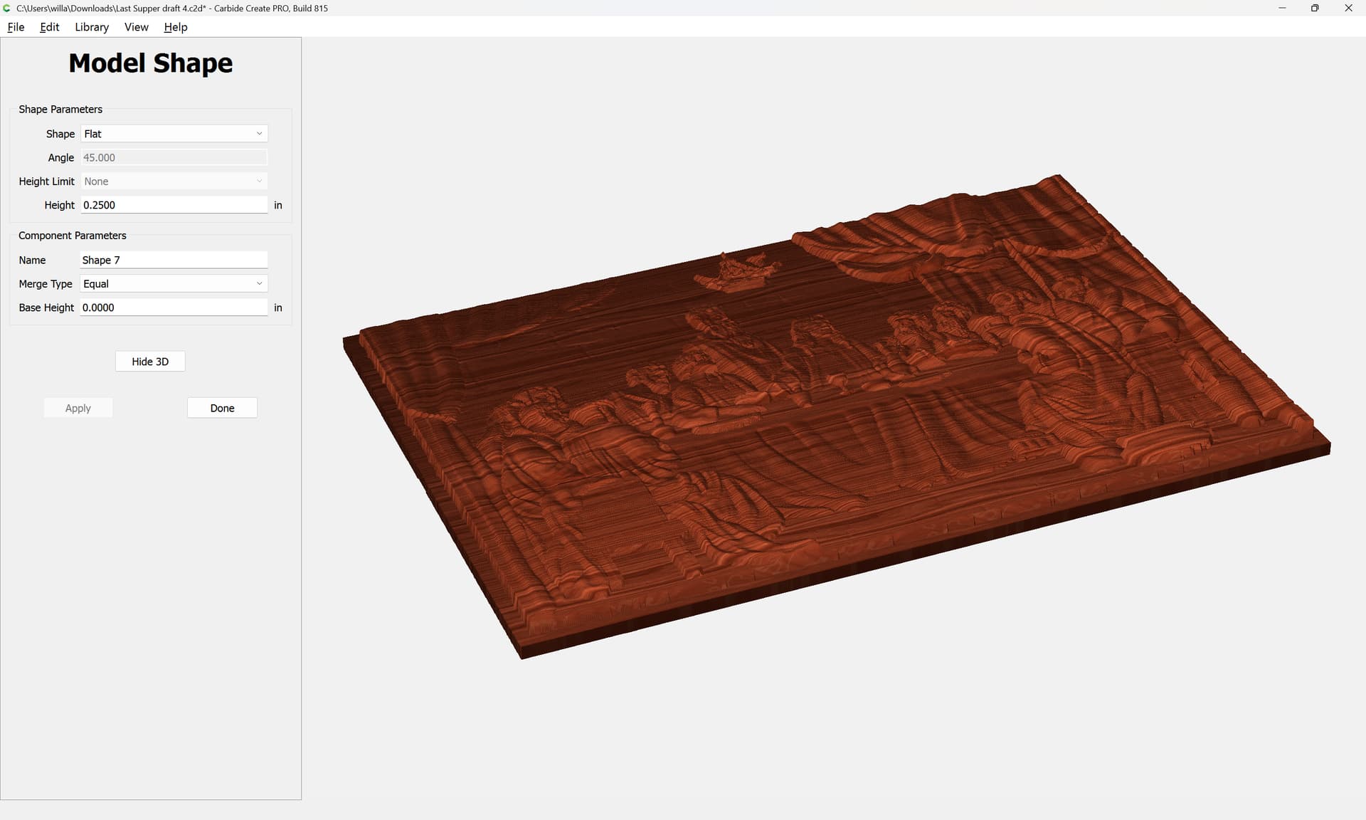

Show 3D:
Will, Many thanks, You took a few minutes to fix a week of frustration
An alternate approach would be to set the model to “Equal”, then draw in the flat area before hand.
