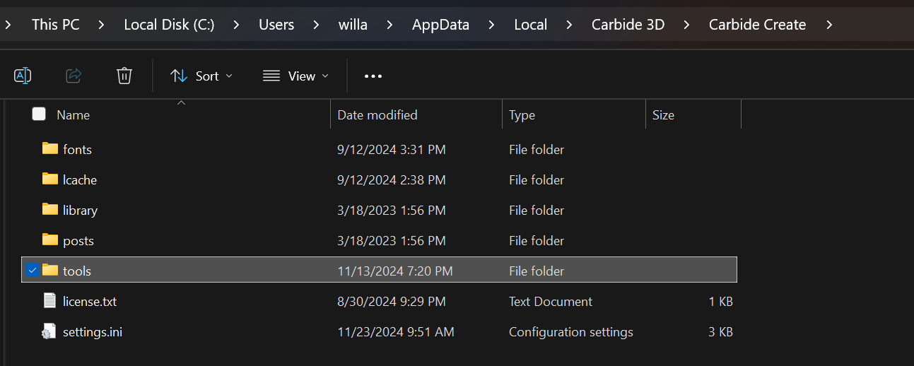

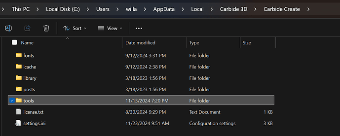

Carbide Create uses a very simple .csv file format which is stored in a tools folder in the Carbide Create folder revealed by:
Help | About | Open Data Directory
but it will only work to put .csv files in that which conform to the format which it uses.
