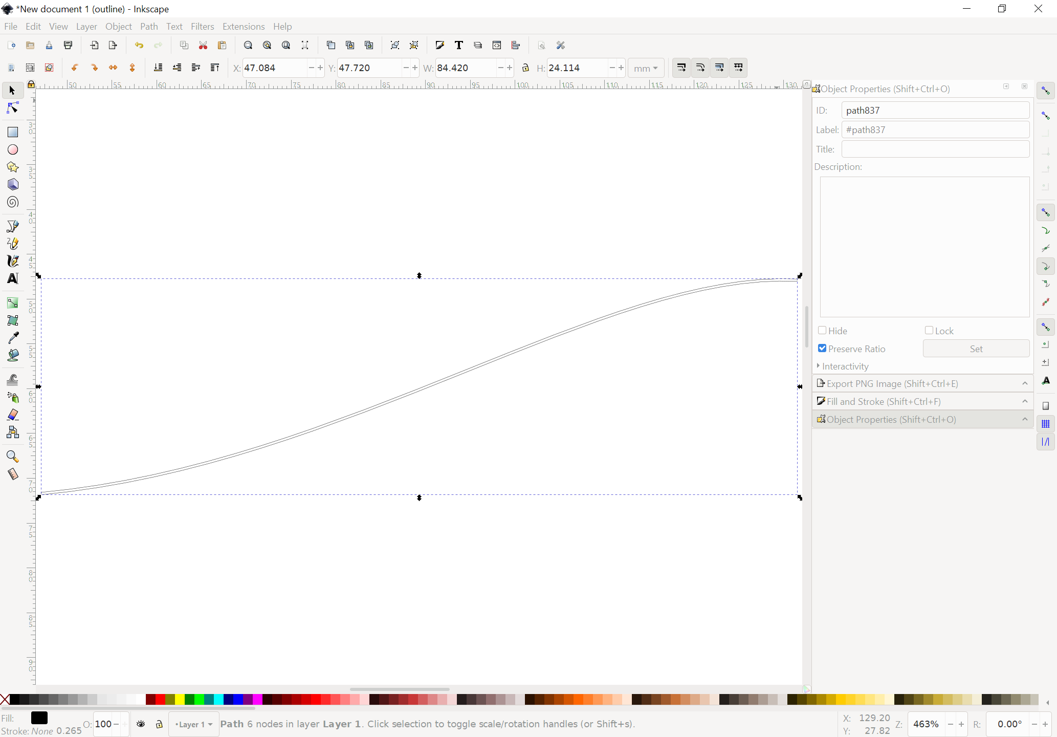

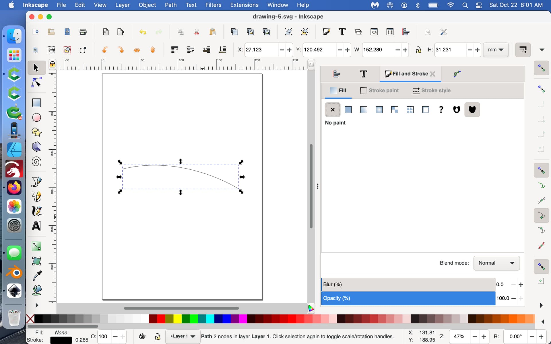

I see double lines when I import a Inkscape SVG

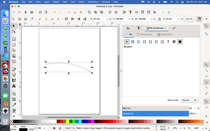

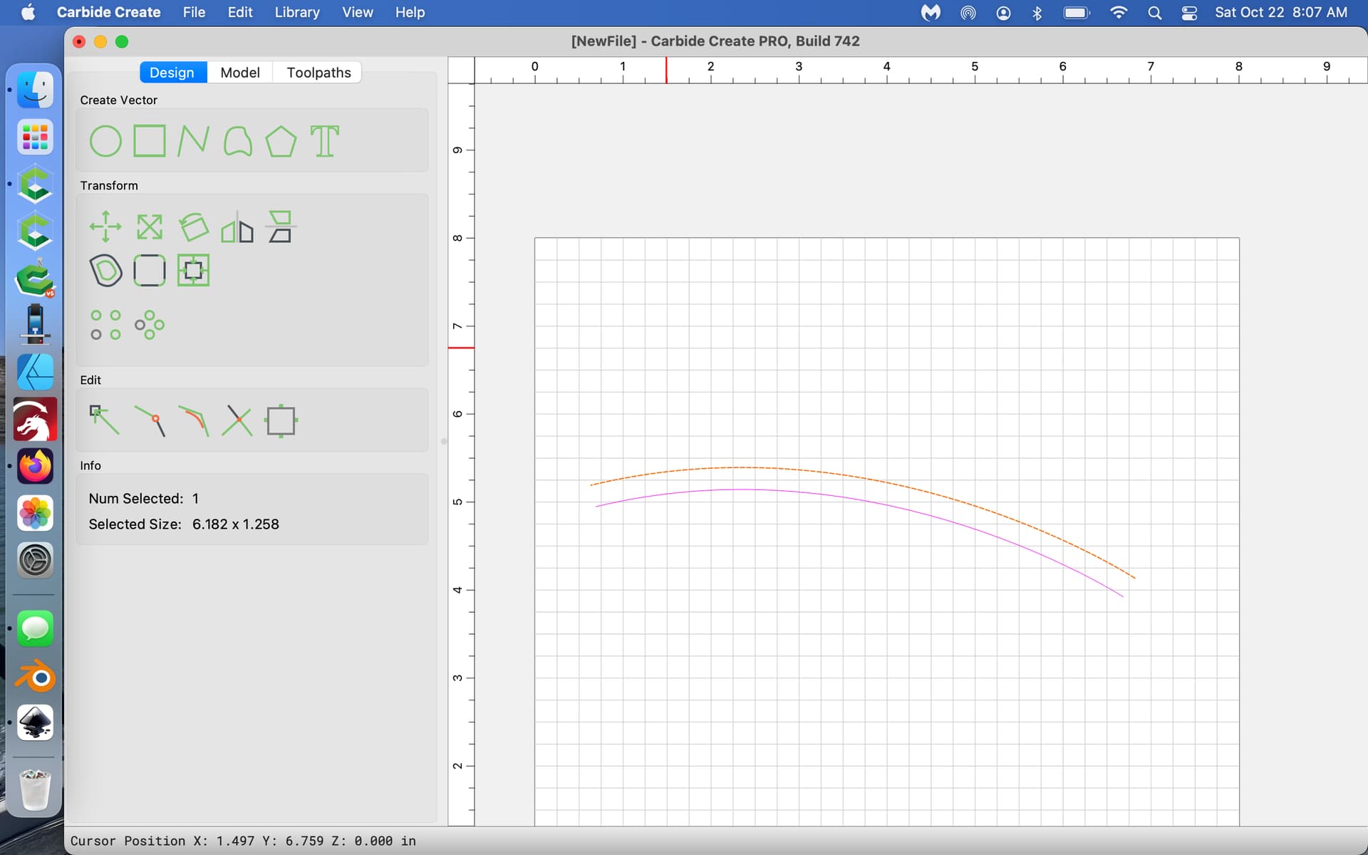

Have you tried making the Bezier curve with the No Fill option checked. That should produce an open vector for export as svg. CC will import as a single line and offset as that.

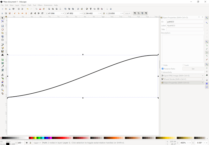

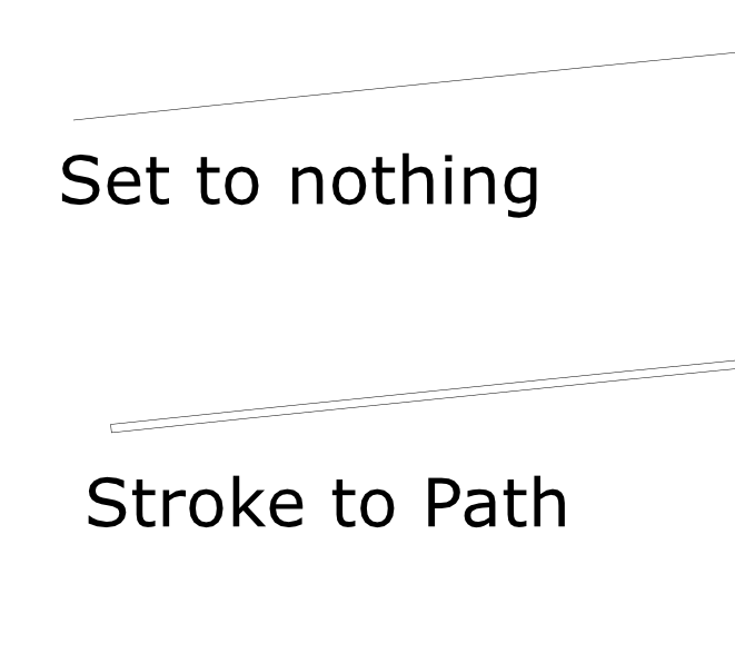

You want to not use stroke to path — that command is what creates the double lines — it’s also not reversible.

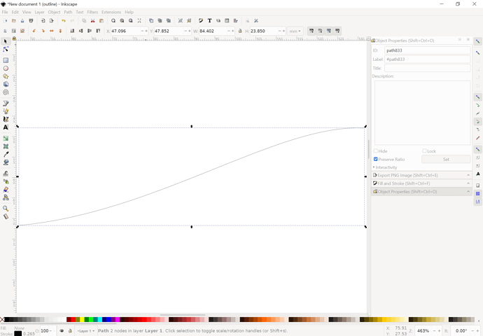

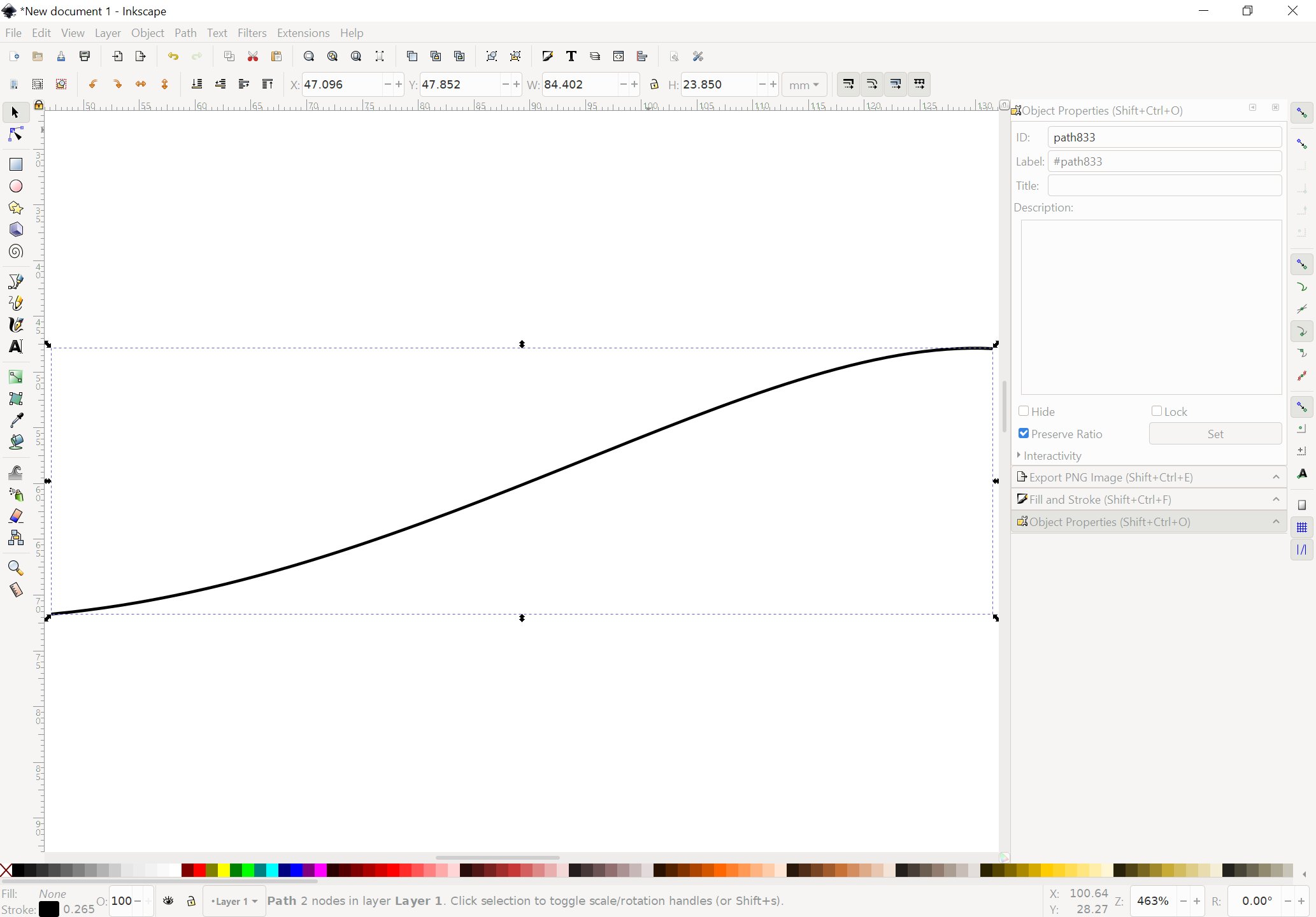

A path:

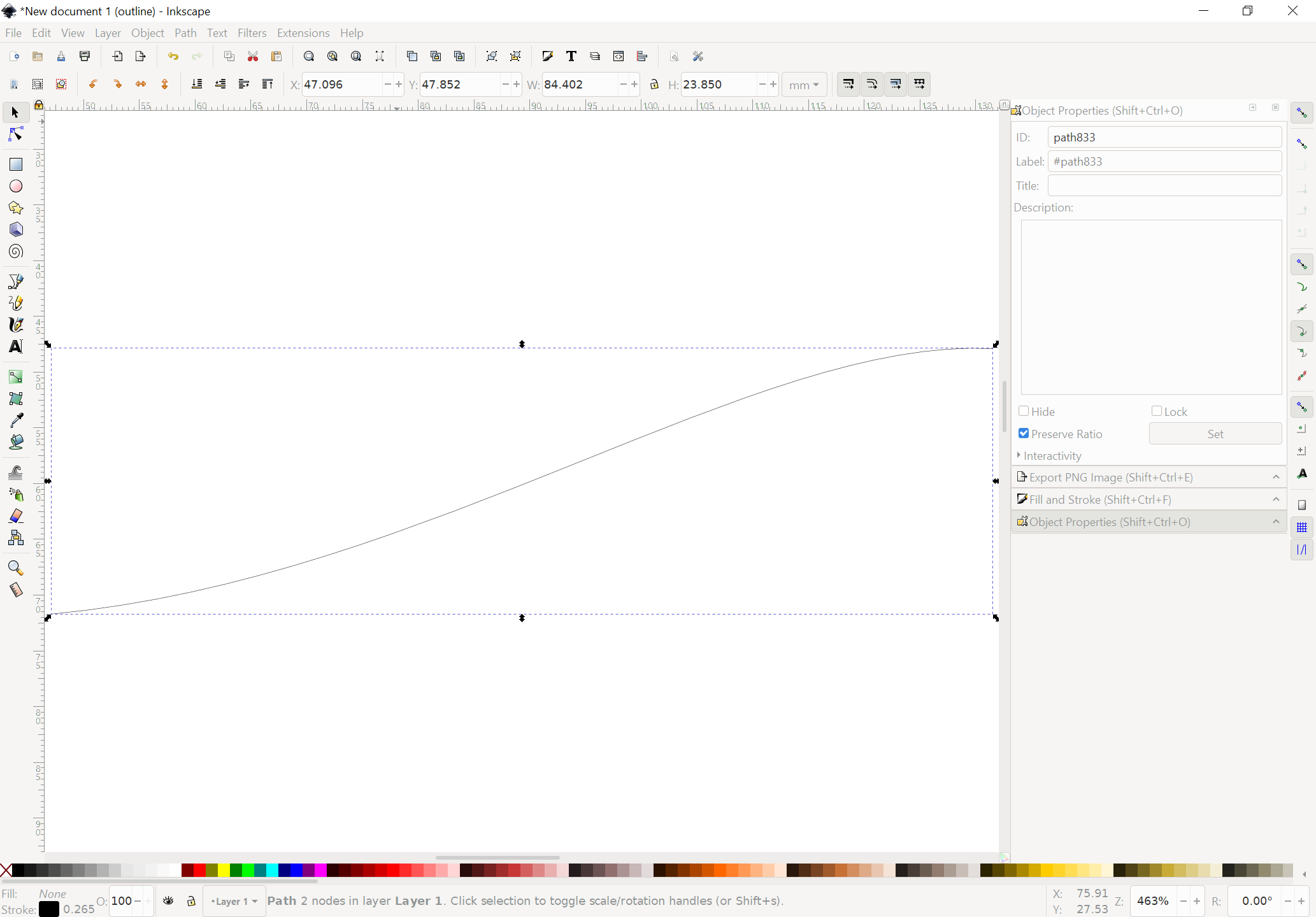

When viewed in Outline mode, one sees what will be imported — just the path:

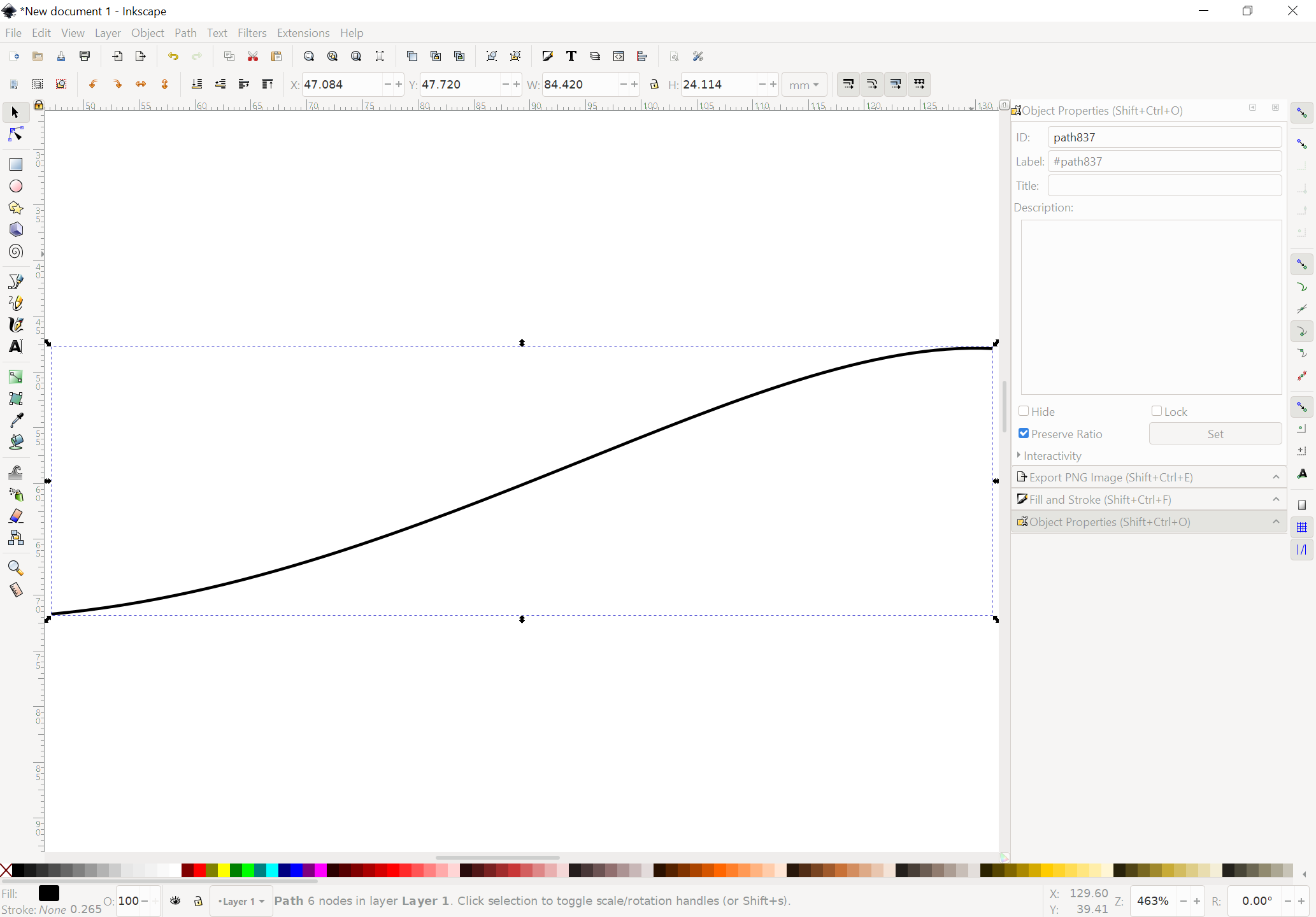

If one then applies the Stroke to Path command, while the preview appearance is unchanged:

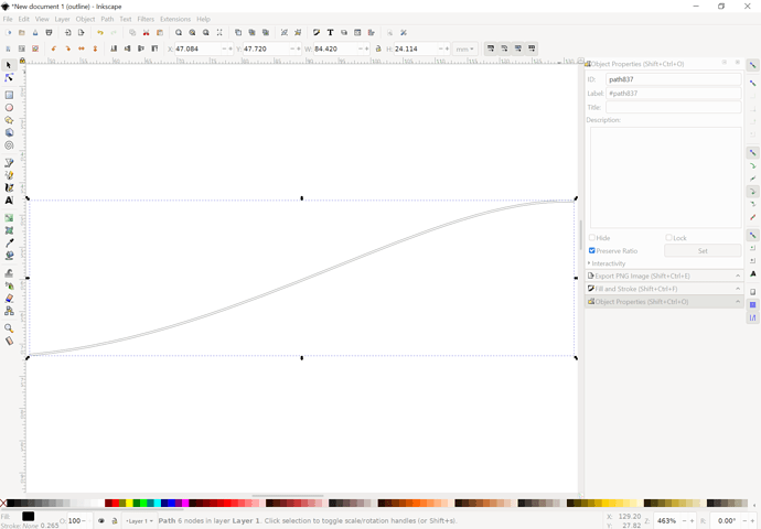

note that the object has gone from 2 nodes to 6, and when viewed in Outline mode:
shows the double path noted in the original post.

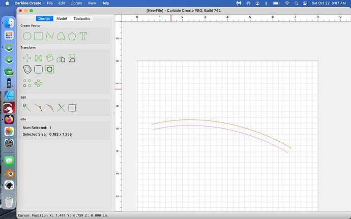

Yes, I agree with Will. The moment I apply Stroke to Path, I see double lines (see below). Good learning curve… Thanks much Will.
Yup, that’s why I asked. When you perform a stroke to path operation you’re creating a closed path with the same area as the original stroke. Object to path creates bezier curves from objects (like text or shape primitives) and creates a path.

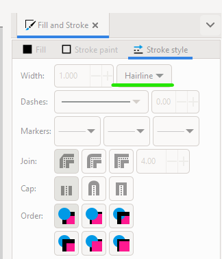

It’s helpful to keep the stroke very thin when designing for CNC as your CAM software sees the paths.
