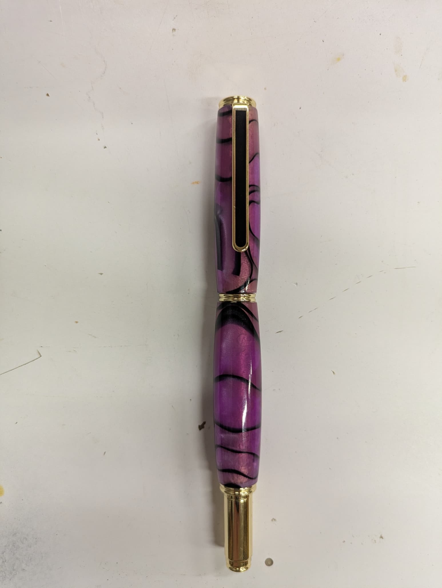

I wish C3D had a rotary capability. I would love to engrave on round objects. I made this pen today and would like to engrave a name on it.
Is this just wishful thinking or will it ever happen?

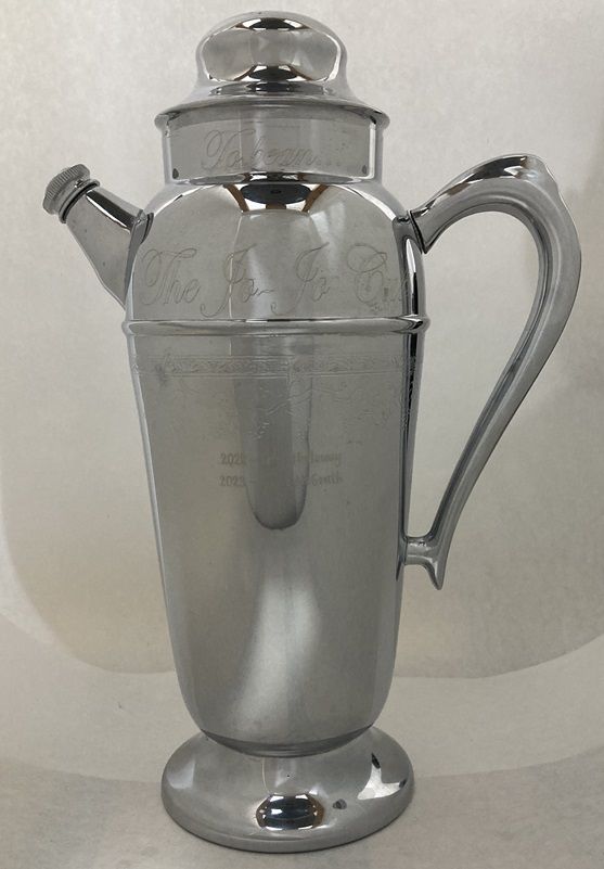

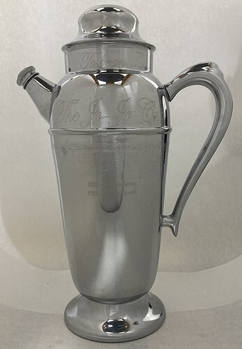

That being said, for something like putting names on pens you could do this on your machine in 3 axis. I engraved this trophy on my HDM. I used NX to do the programming, and to wrap the text around a model I created that matches the trophy. I’ve been told Vectric can ā€˜wrap’ toolpaths onto contoured surfaces.
Given your familiarity with nx and gcode in general, I’ll take whatever you manage to do and knock it down a few pegs for my own expectations :sweat_smile:

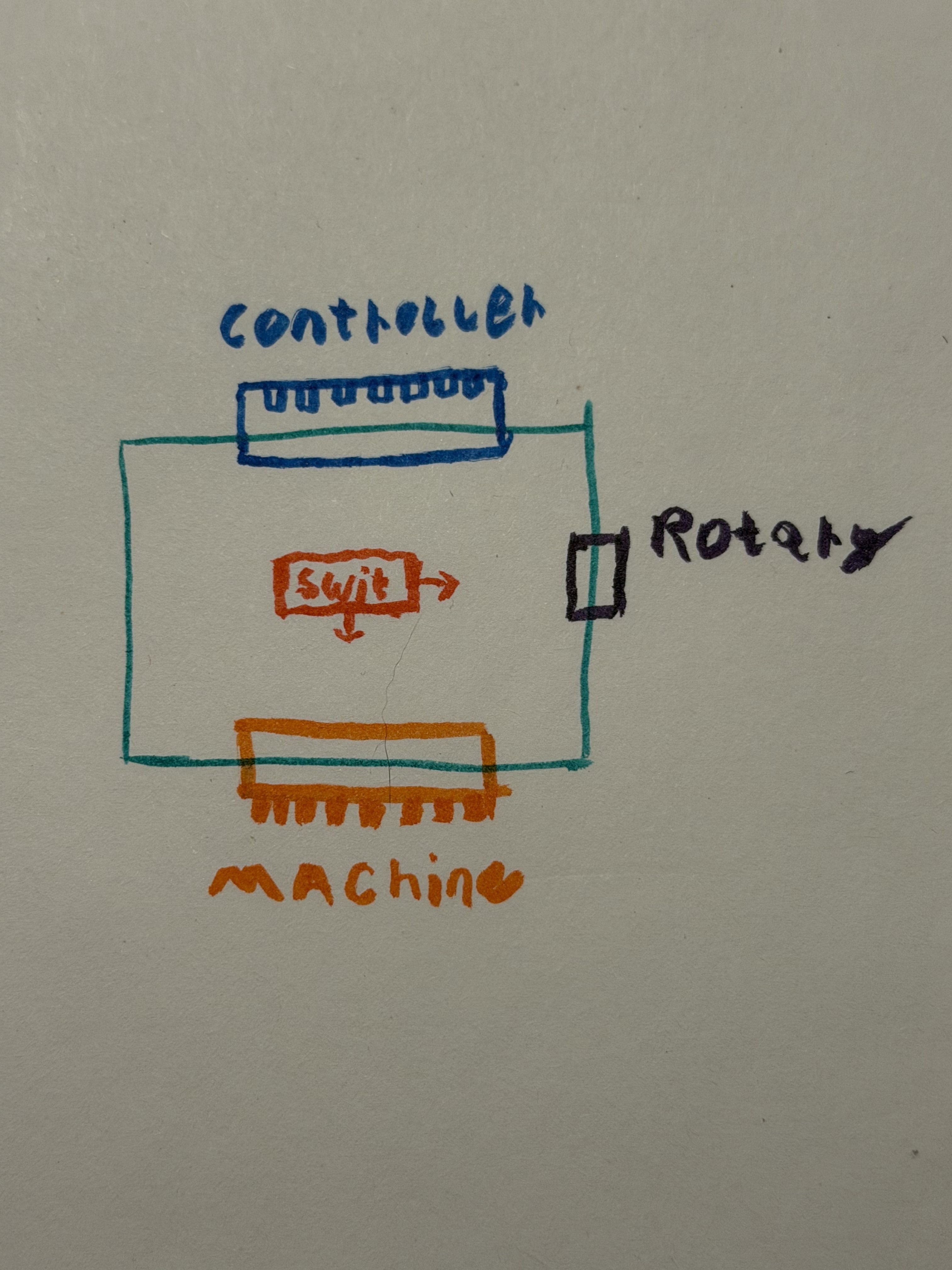

Thinking about this more, maybe the best way to get a conversion going is with a small pcb to sit between the machine and controller :thinking:
The pcb could allow switching signal and power of the relevant motor axis being converted.
Something like this very crude drawing:
This would be nice because there’s no real modification necessary. Just a drop in addition. (Not sure about how homing and such would work though…maybe have to do the same switching mechanism for the sensor loom?)

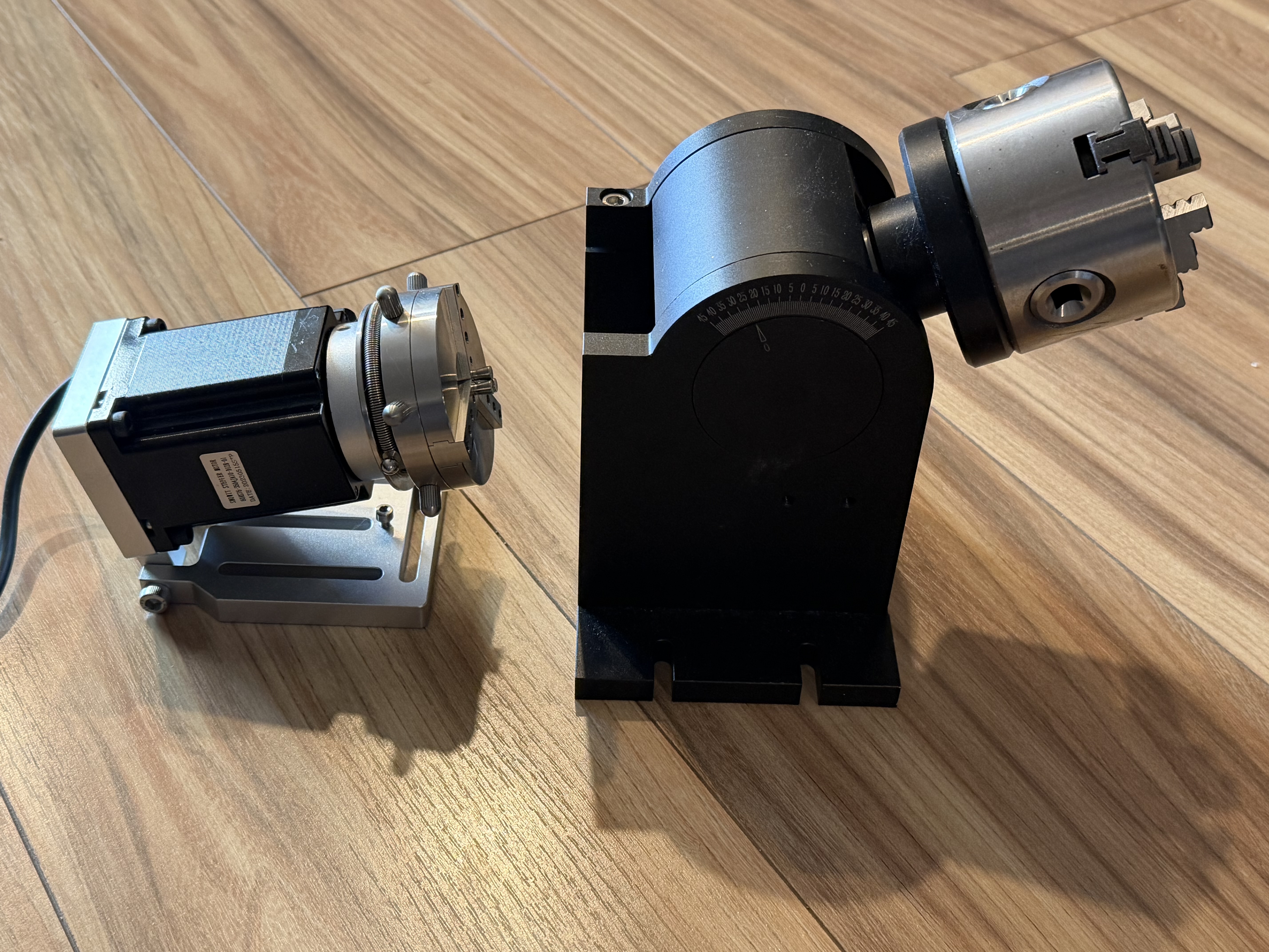

I’ve got rotaries from my laser and all of the necessary equipment on hand to make one if folks think it would work :man_shrugging:
What do folks think? Worth pursuing as an open source project? Put up the relatively simple pcb and settle on two reasonably priced/accessible rotaries that we know would work. (Small and large)
I’ve done a similar thing with adding a rotary my nomad so I expect it should be ~the same process. The benefit here being that woodworking probably doesn’t need near the same precision or rigidity.
If anyone has experience with an off the shelf rotary with built in homing, that might be interesting.

When you switch between a linear & rotary axis, you will also have to change some parameters.
step/mm would become steps/degree, or similar.
Acceleration/deceleration & rotary feedrate would also be a concern.
This could be handled in the g-code, so perhaps a separate post for linear vs rotary?
It can certainly be done, and it has. Just not as simple as throwing a switch. :wink:
