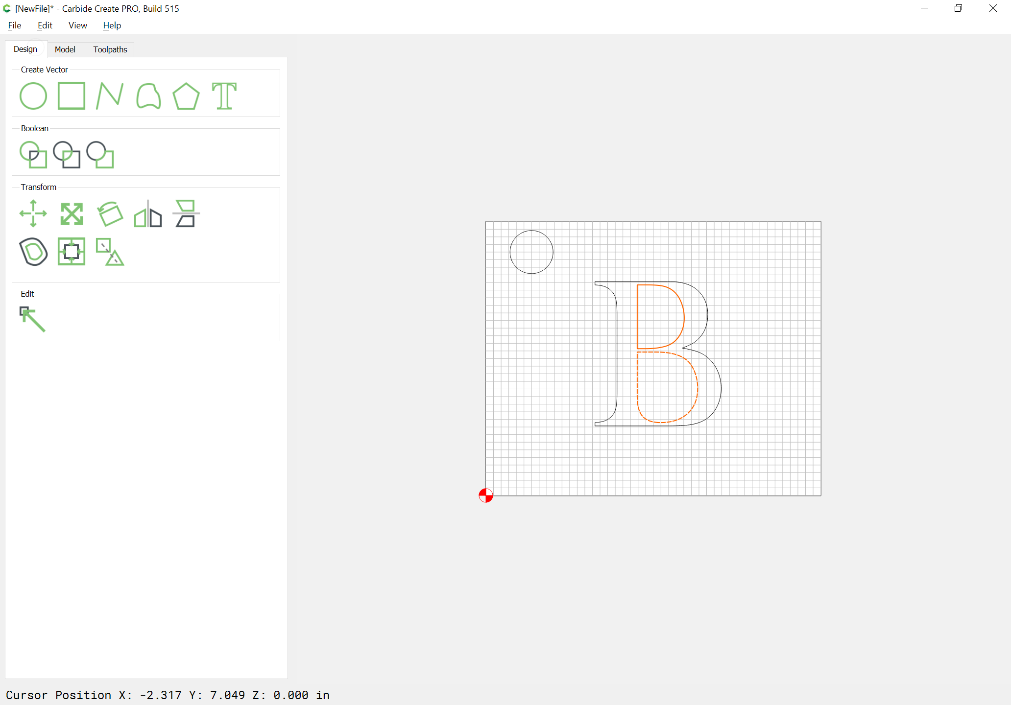

Put a square around the letter that is larger, select both, and use the boolean operation. It should change the letter from a text to individual pieces… if that’s what your looking to do if I understand correctly.
Maybe there is another way but that’s how I do it.
Once that is done you can select the inner pieces and make you pocketing toolpath for a shallower cut.
You understand my problem. I will try that thanks

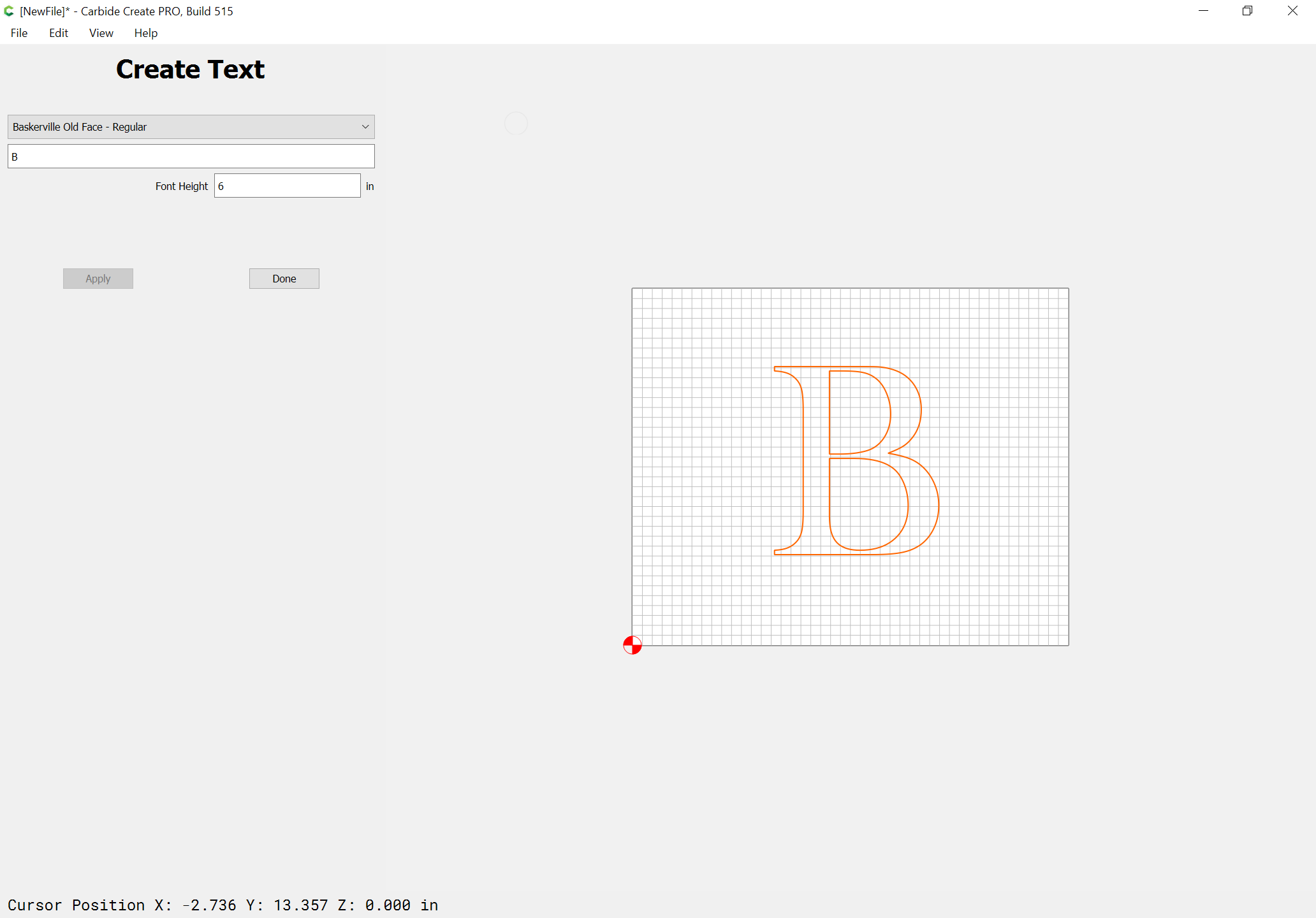

  • set the character:

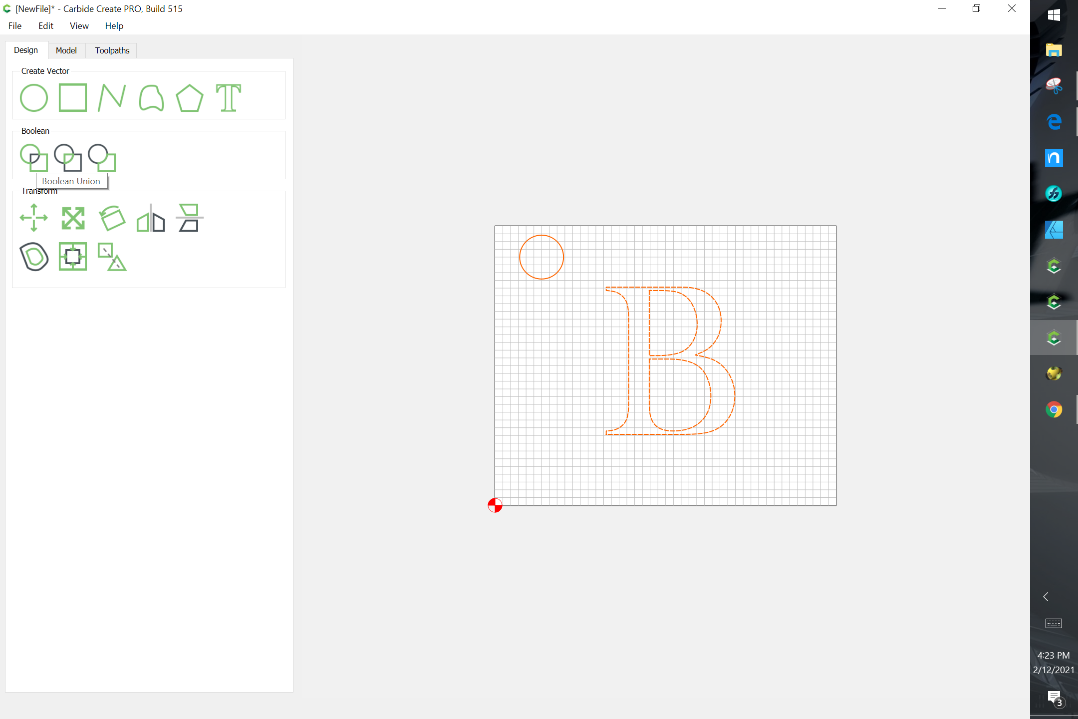

  • draw in some additional geometry, select both and Boolean Union:
  • arriving at geometry which may be discretely selected:

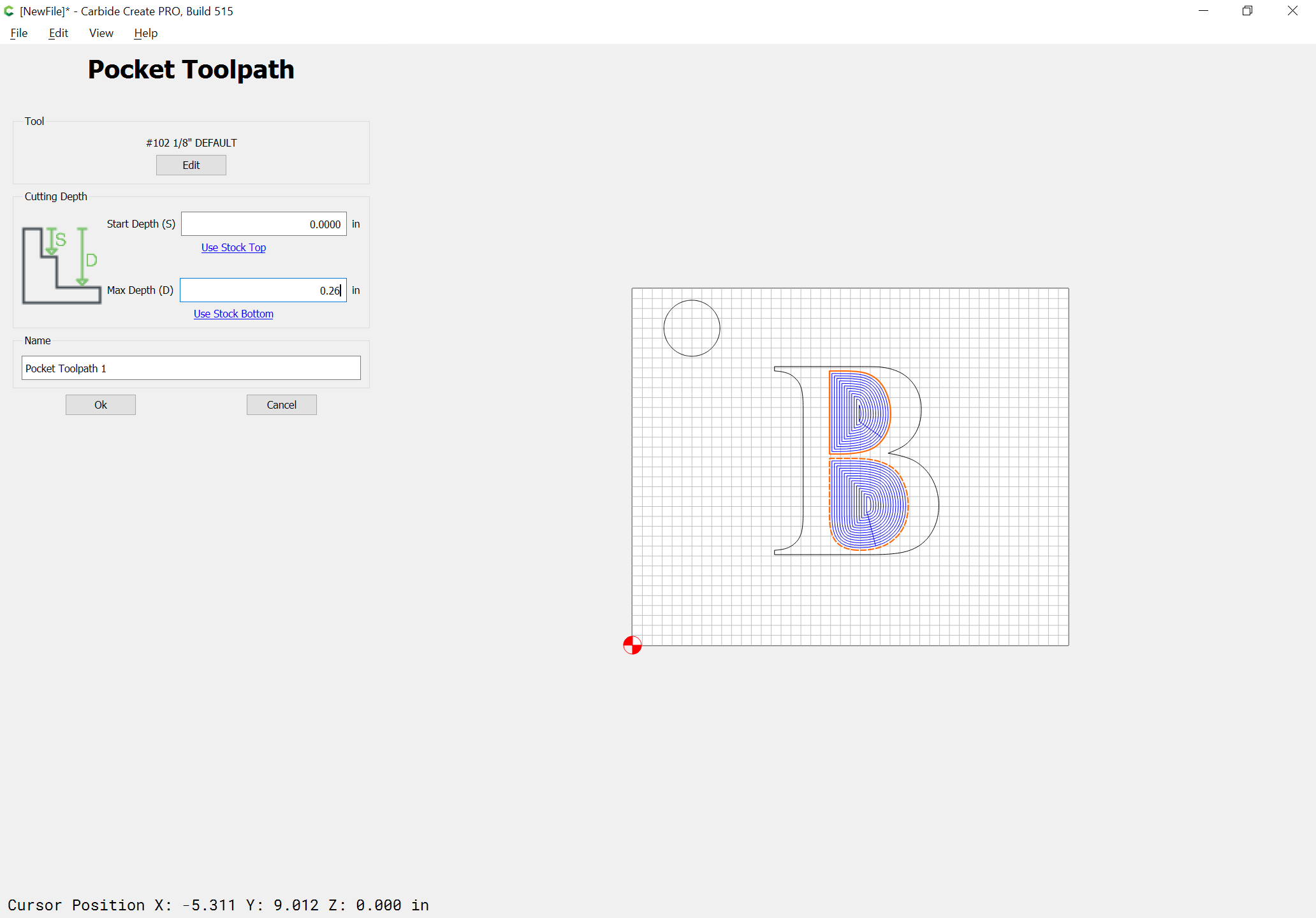

  • in Toolpaths assign the pocket operation to the counters:

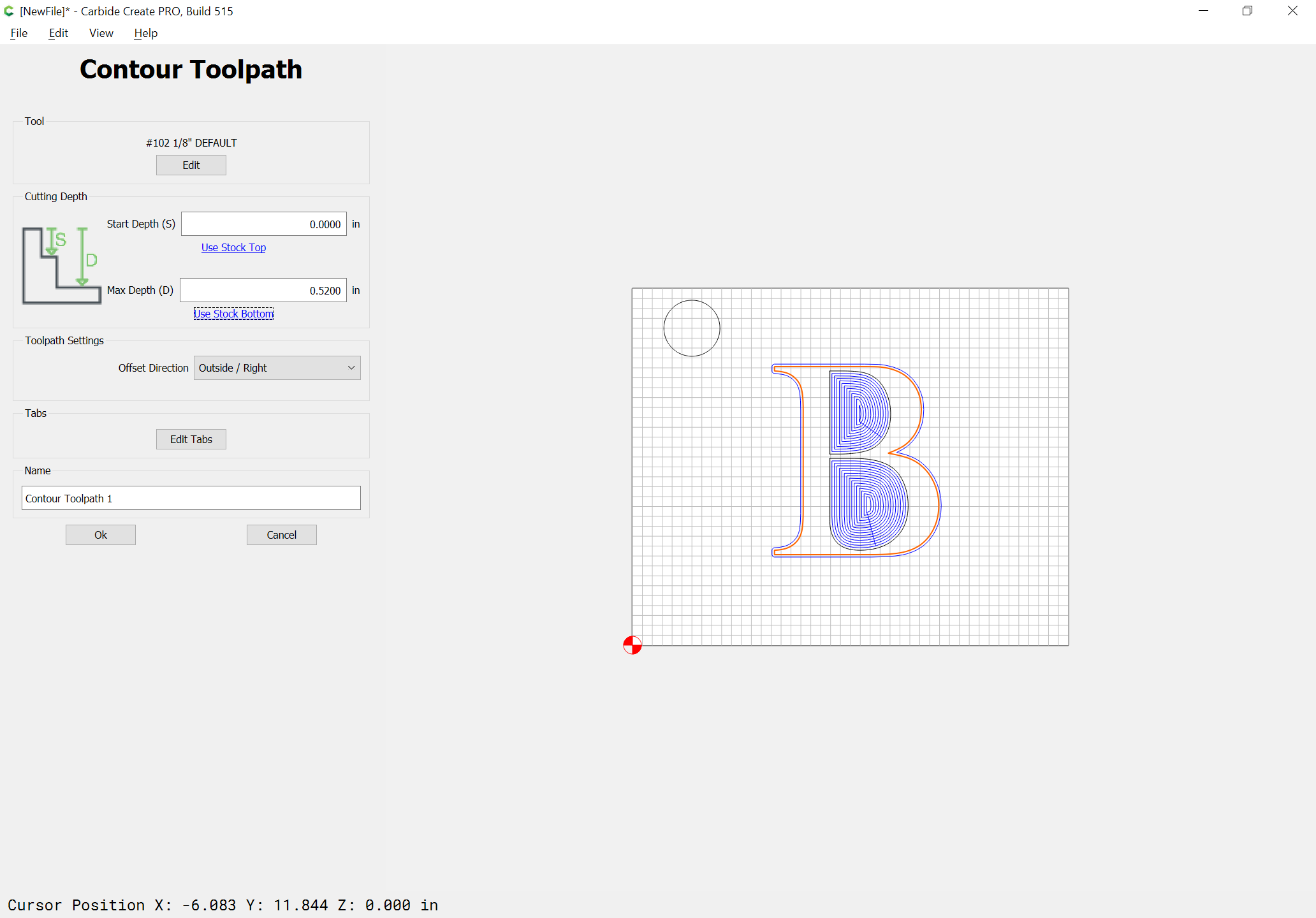

  • use an outer profile to cut out the outside:
(you should add offset geometry and cut as a pocket down to tab depth or the final pass)

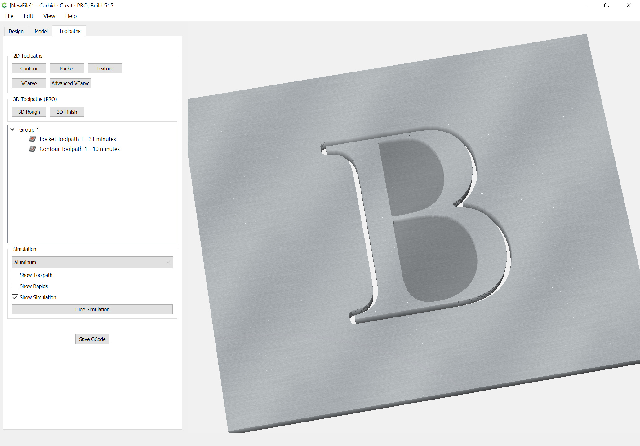

  • resulting in the preview:
