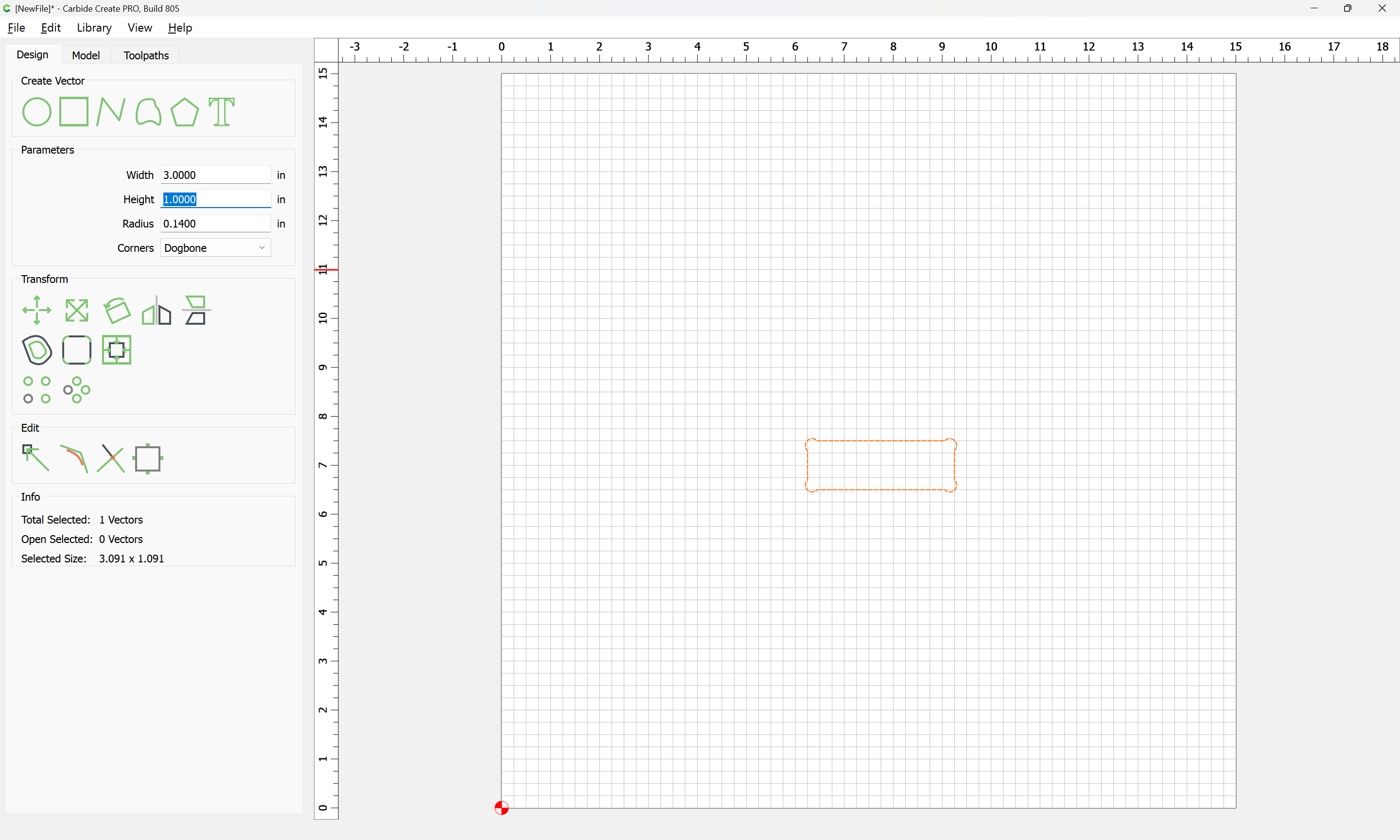

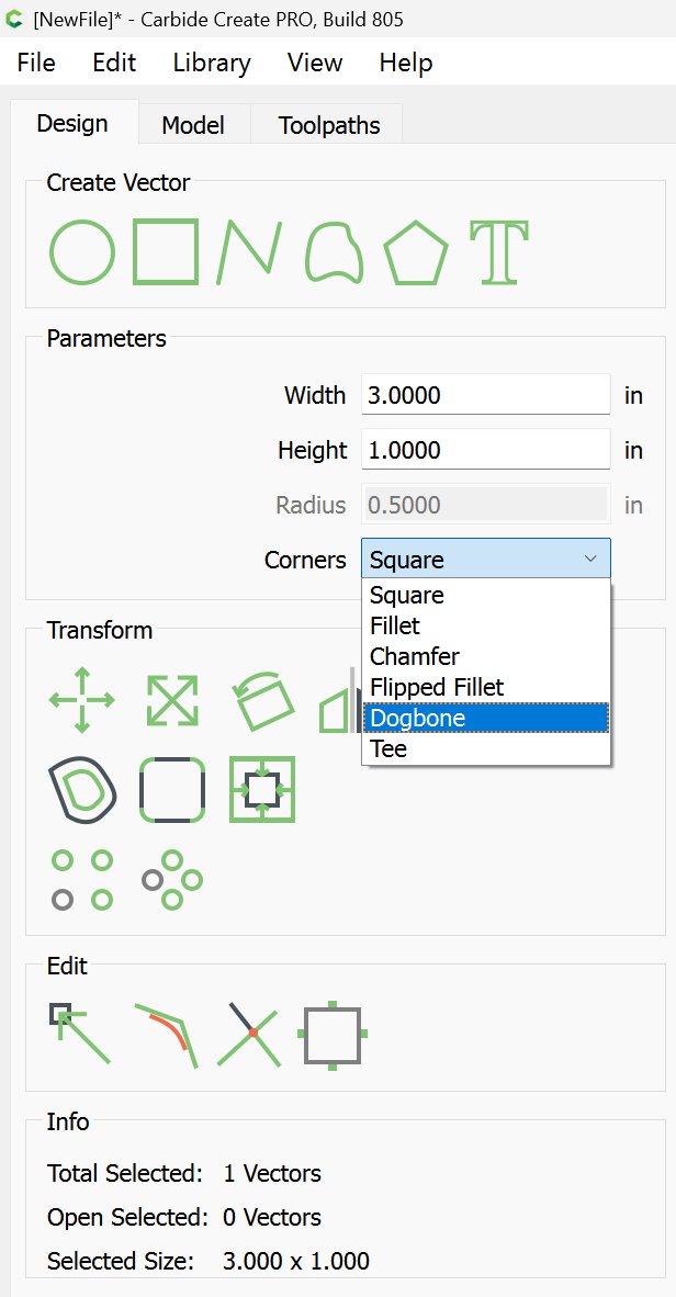

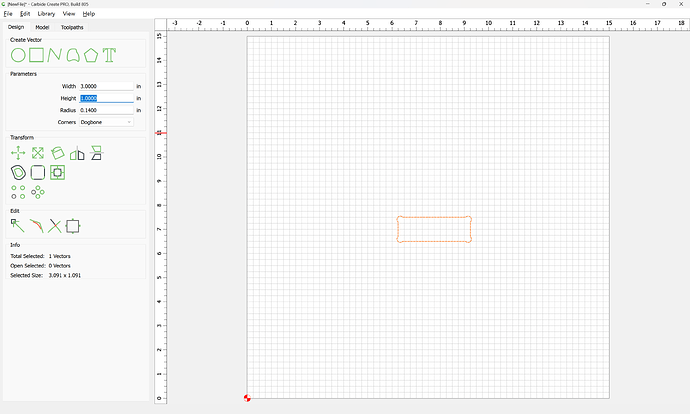

Rectangles have Dogbone has an option for corner treatments:

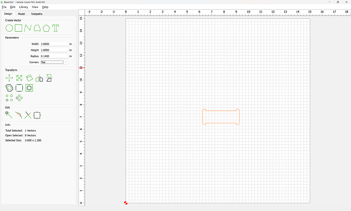

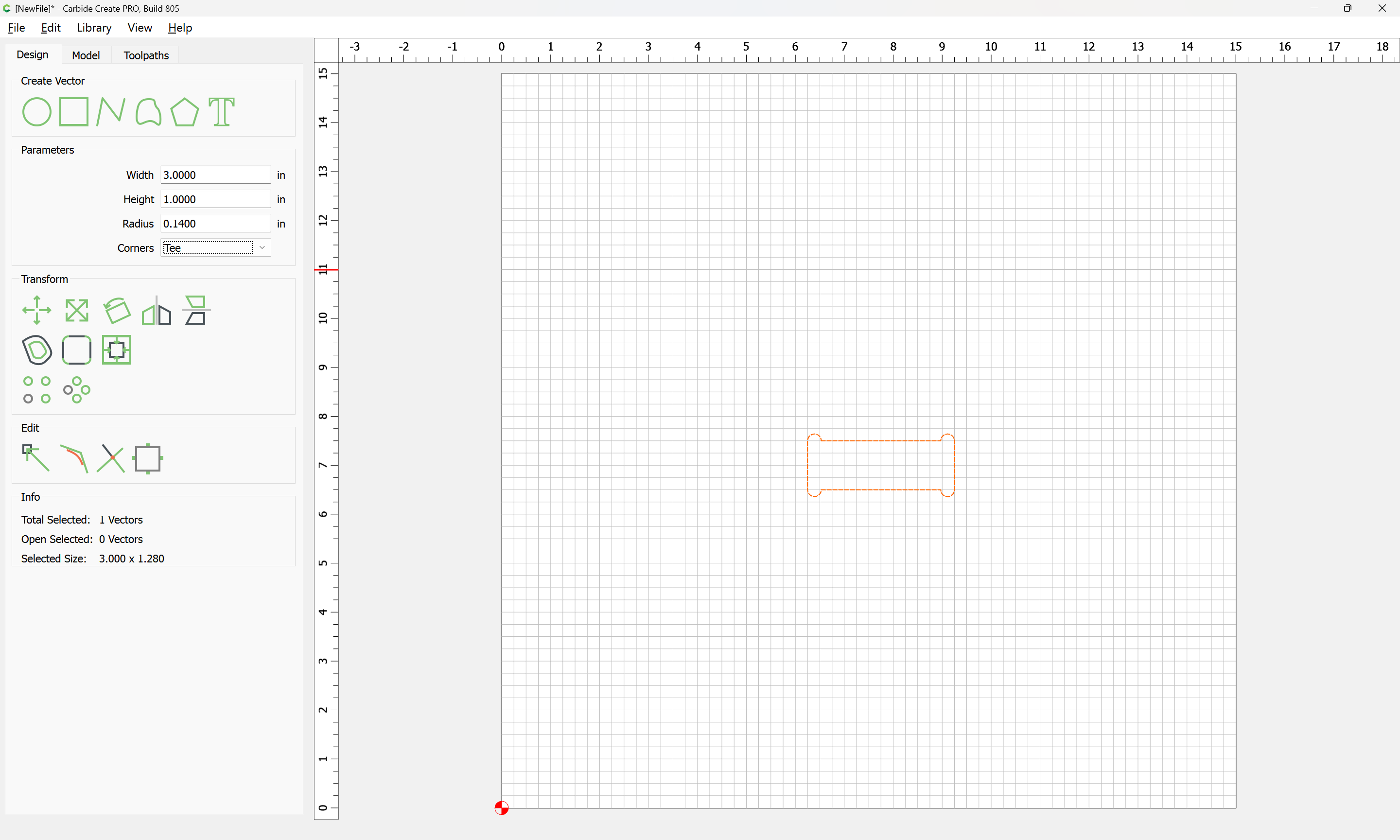

As well as a Tee option:
