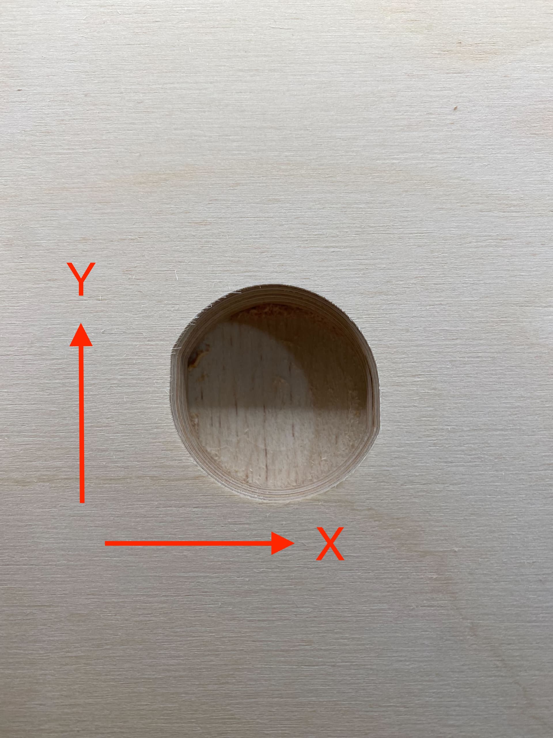

Prior to this cut, all the circle pockets I’ve cut have been spot on perfect. Now, after not using the machine for a few days, I started to hear some odd noise when traveling in the X direction, almost like the stepper motor was revving up and down (best way I can describe the noise). Didn’t notice this until 2 circles into the cut, but there is some missteps on the y-axis of the circles, as if the x-axis motor was off on both sides and didn’t complete the whole circle width-wise, causing a flat spot.
What could be causing this? A bad/dying motor? Everything in the file is fine, there’s no weird flat spots or anything on the simulation.

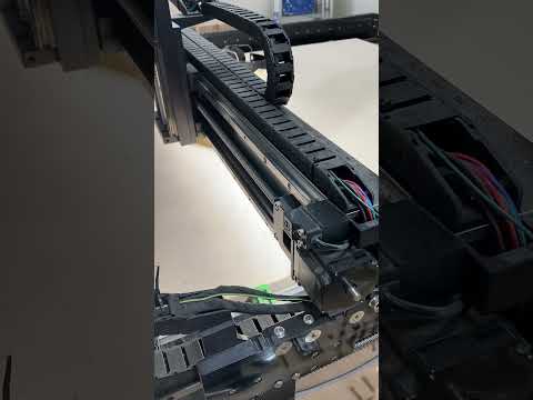

FWIW, I’ve reached out to Support with a video which has the motor sound as I can’t upload it here.
Perhaps put the video on YouTube? I am running a 5 as well. I would be interested in listening.
Good idea! Here’s the link:

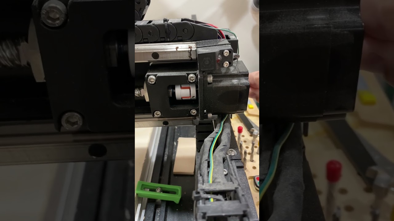

Also give the coupler screws a quick check. There is both a clamp bolt and a set screw for each side of each coupler.
I will bet this is the Fix!
My Shapeoko 5 Pro did a very similar noise when I first got it. The support guy was actually pretty helpful. In my case, the issue was that there was a loose nut at the end of the right-side Y-axis leadscrew. The noise was caused by the rubbing of the leadscrew against the front bushing from not being captive near the motor. They had me remove the motor, coupler, and tighten the nut. Luckily, I had wrenches that would reach but I could see this not being the case for everyone. Good luck with this. It has been a great machine for me since I got this issue corrected.
This is most likely the fix. I’ll run a cut tomorrow to make sure, but this is how I found the x-motor coupler, very loose. I tightened all 4 screws and it turned perfectly.
I still have a lifetime supply of vectra oil being delivered this week that I’ll still use in case that was a partial cause.
Confirmed that tightening the x-motor coupler fixed my issue.
Not just the coupler screws, but there’s also a set screw that snugs down on the flat of the motor shaft. Make sure you get that one also.
