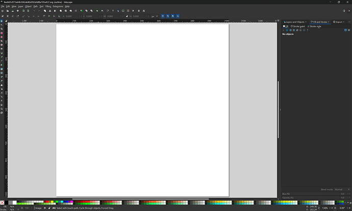

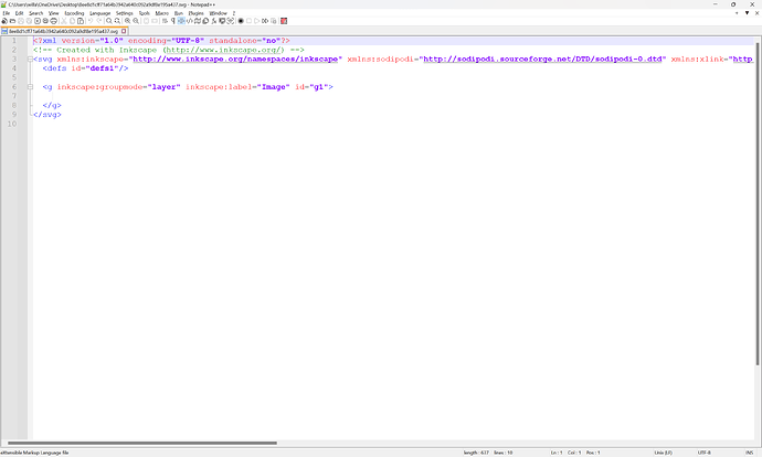

The file seems to be empty:
Which is odd as Inkscape will open it.
Yes, and when Inkscape opens it, it is empty:
Not when I open it…
That’s not the file which you uploaded above.
I took a picture of the desktop with my phone and uploaded what the contents of what the .SVG is.

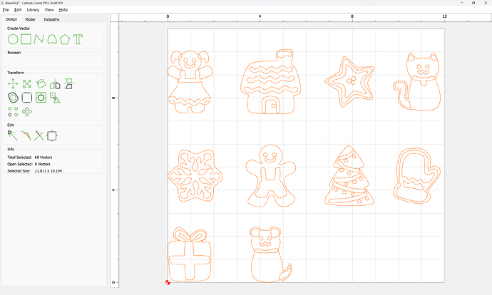

Used Inkscape to extract the pixel image:
and when imported for tracing:
once the Threshold is adjusted we get:
Trace Image

I may be missing something with this… Did you mean Trace Bitmap function?
No, I extracted it and posted it as a separate image above.
Also just to add to hopefully clarify… When I select import, choose the image file I do get the prompt to trace the image. When I select to trace the image… It acts like I clicked on cancel or NO. The tracing window does not open at all.
My apologies if I didn’t explain the issue correctly.
Ok… face palm moment… rack it up to still learning the software…
Instead of importing the .SVG I used just the trace image function on the .jpeg file itself and I was able to get the same results as you pictured.
Annnnd now I know!
