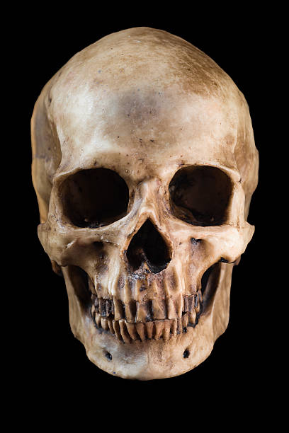

Good morning all, What image format is best to produce a smoother 3d rough and finish with Carbide Create or do I need to hand over the cash for V Carve desktop?
Here is the C2D file if you have a moment to guide me along. This preview just looks all jagged.
Image as well.
Thanks in advance.skull test.c2d (189.8 KB)
Carbide Create is intended to work with pixel files which have a clear, unambiguous relation between grayscale value and height/depth. It’s not really intended to work with full-colour images.
So in this case would converting the image to a black and white maybe with a halftone help?
Halftone won’t help — the problem is, you don’t want a pictorial representation — you want an algorithmic depiction.
