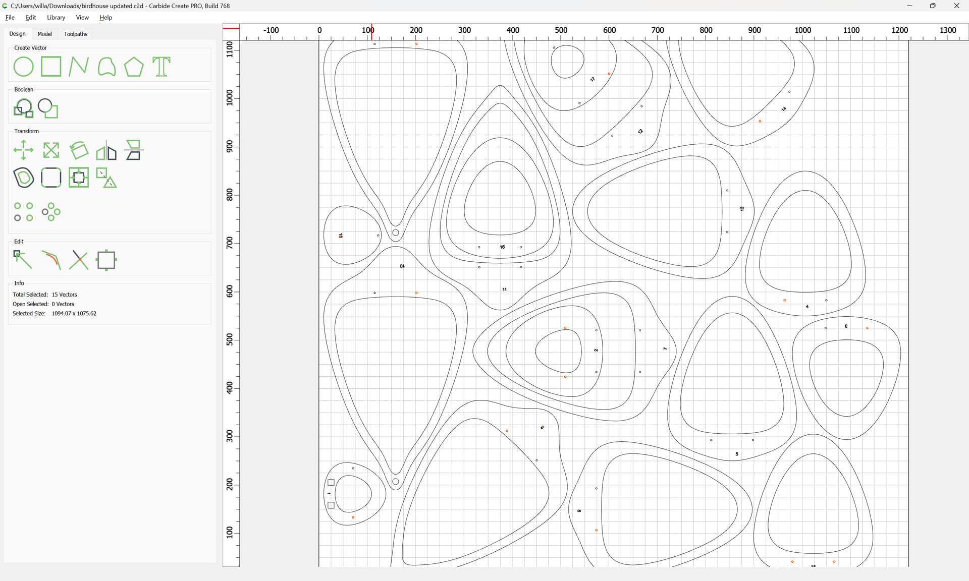

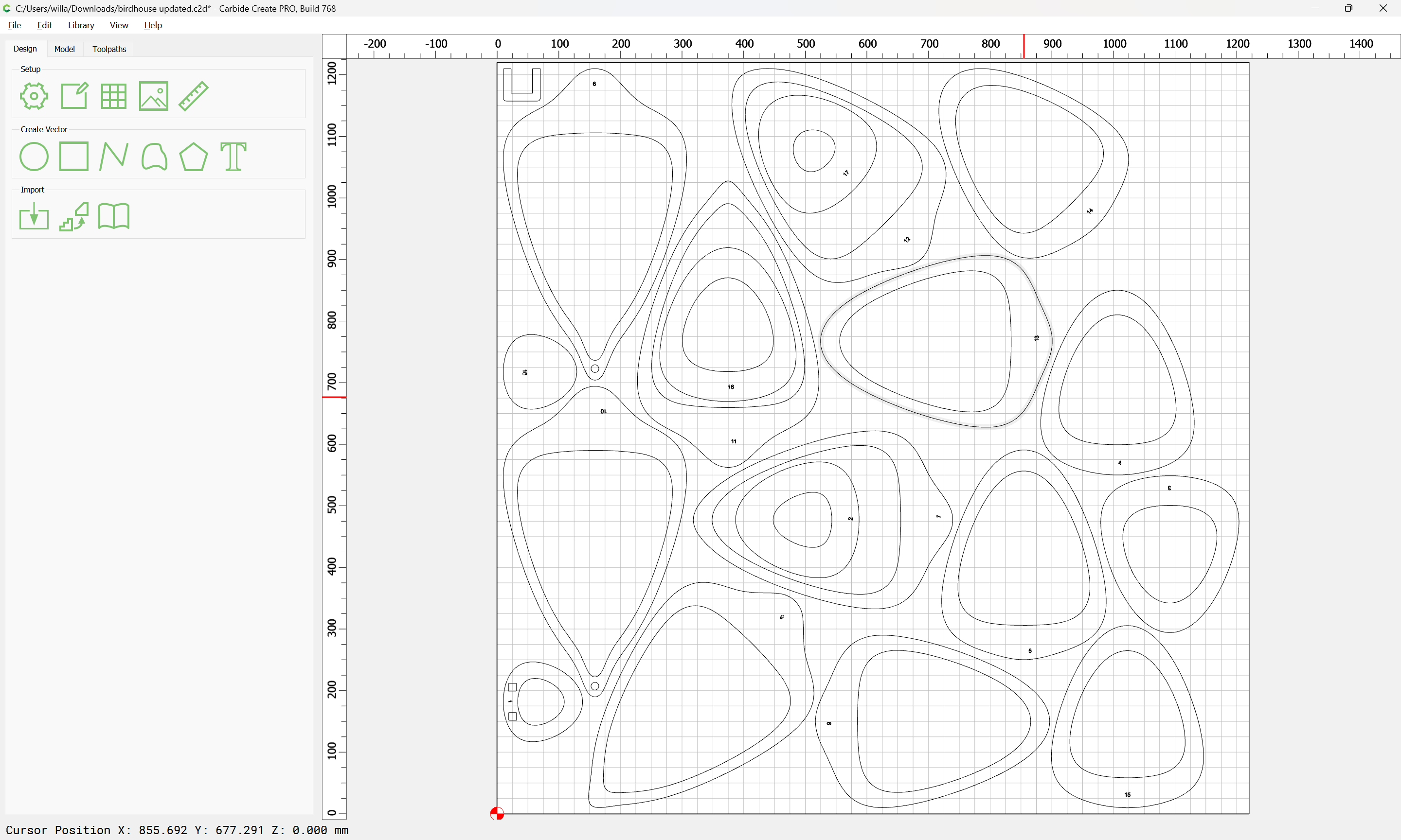

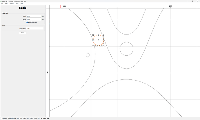

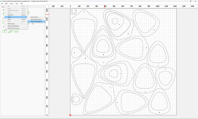

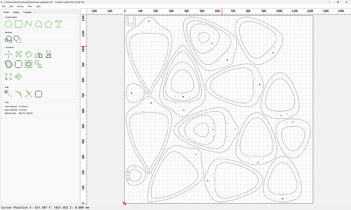

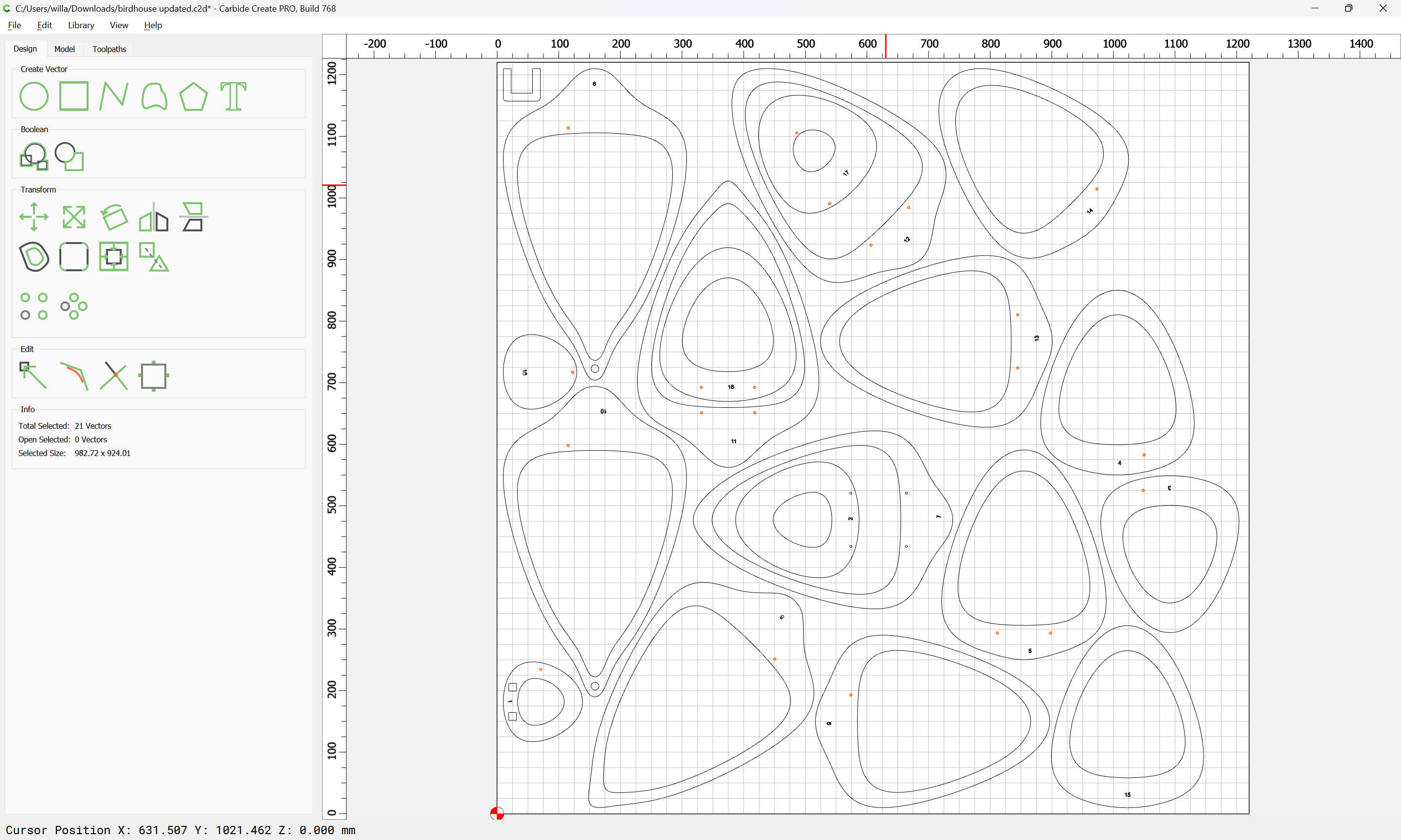

Given a DXF which imports as:

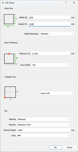

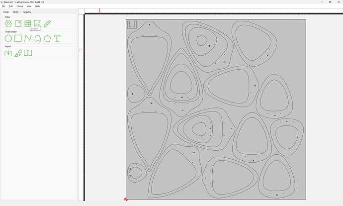

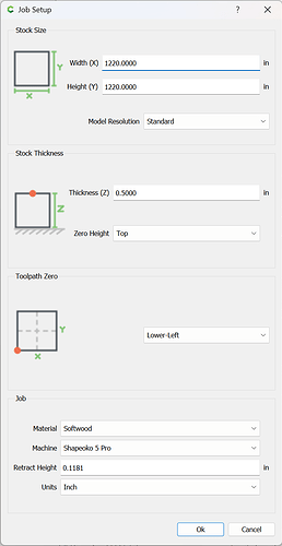

We first go to Job Setup:

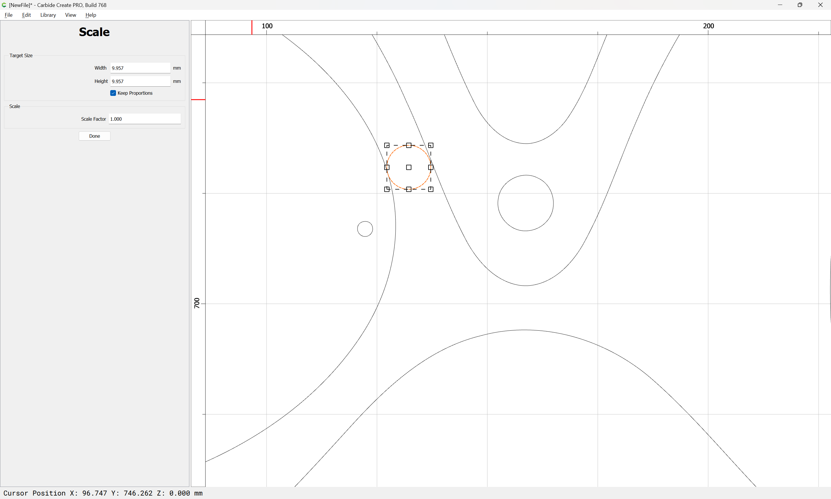

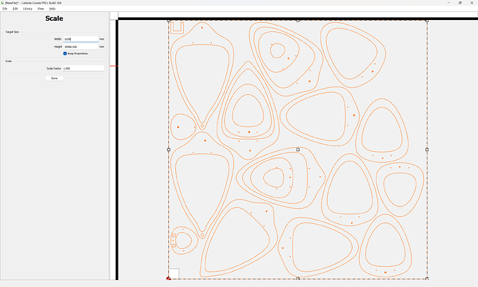

and adjust things so that they can be re-sized in terms of millimeters instead of inches:
and we re-size the geometry to the correct size:
Done

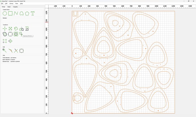

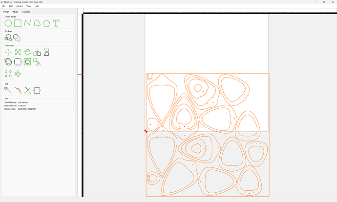

and group it and align it to the stock:

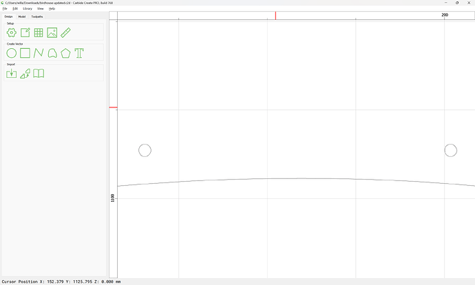

The very fine grid is potentially confusing:
So we set it to a reasonable size:
and Ungroup:
Checking, the space around the parts is reasonable:

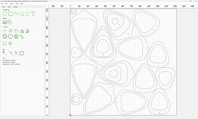

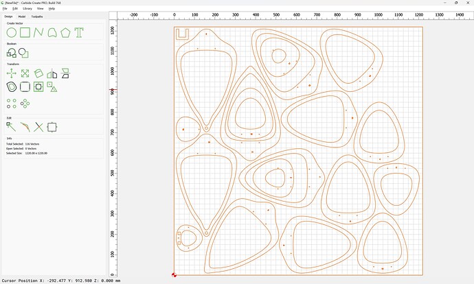

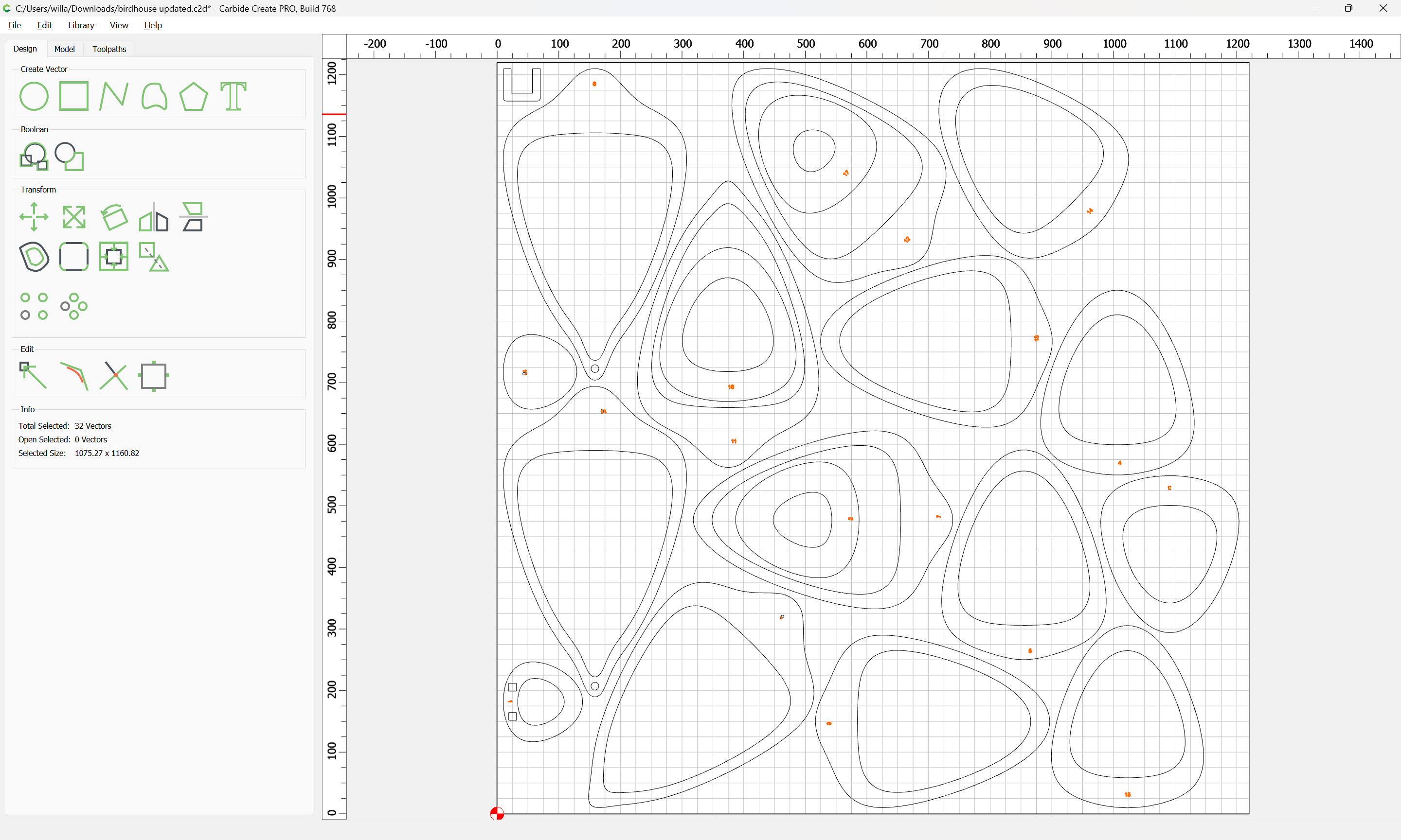

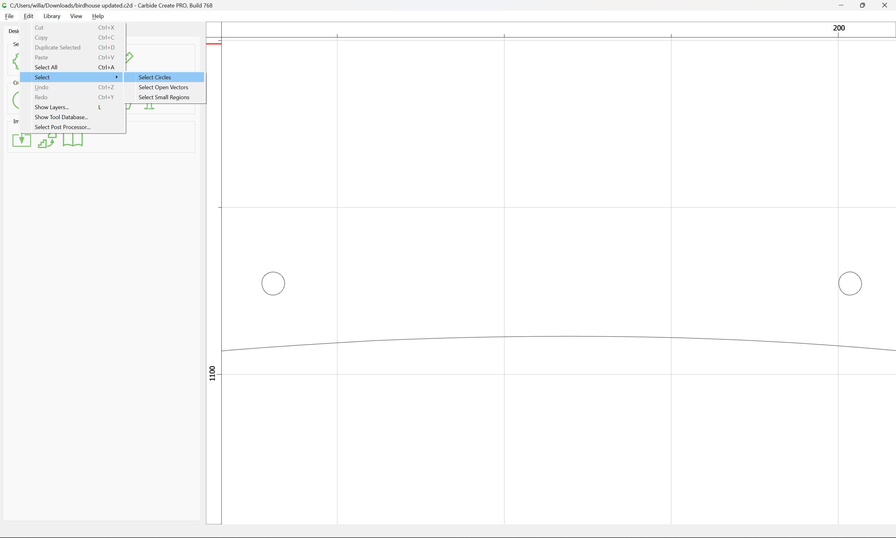

Presumably the small circles are for holes for dowels:
There is a feature which should select them:
which oddly misses some:

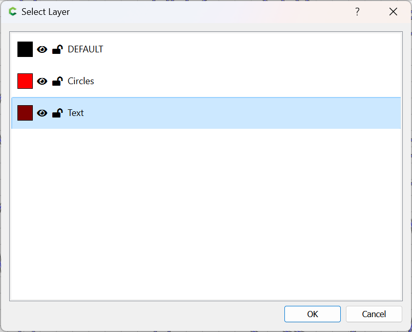

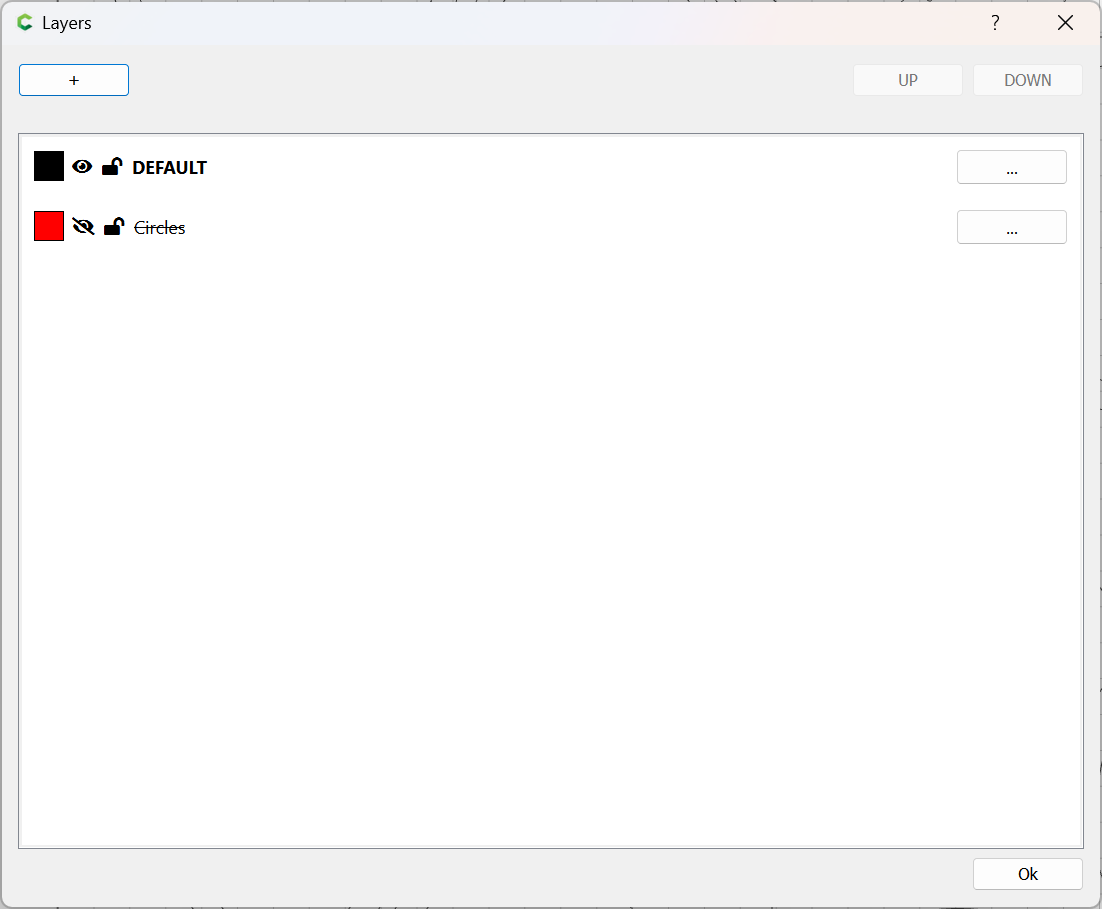

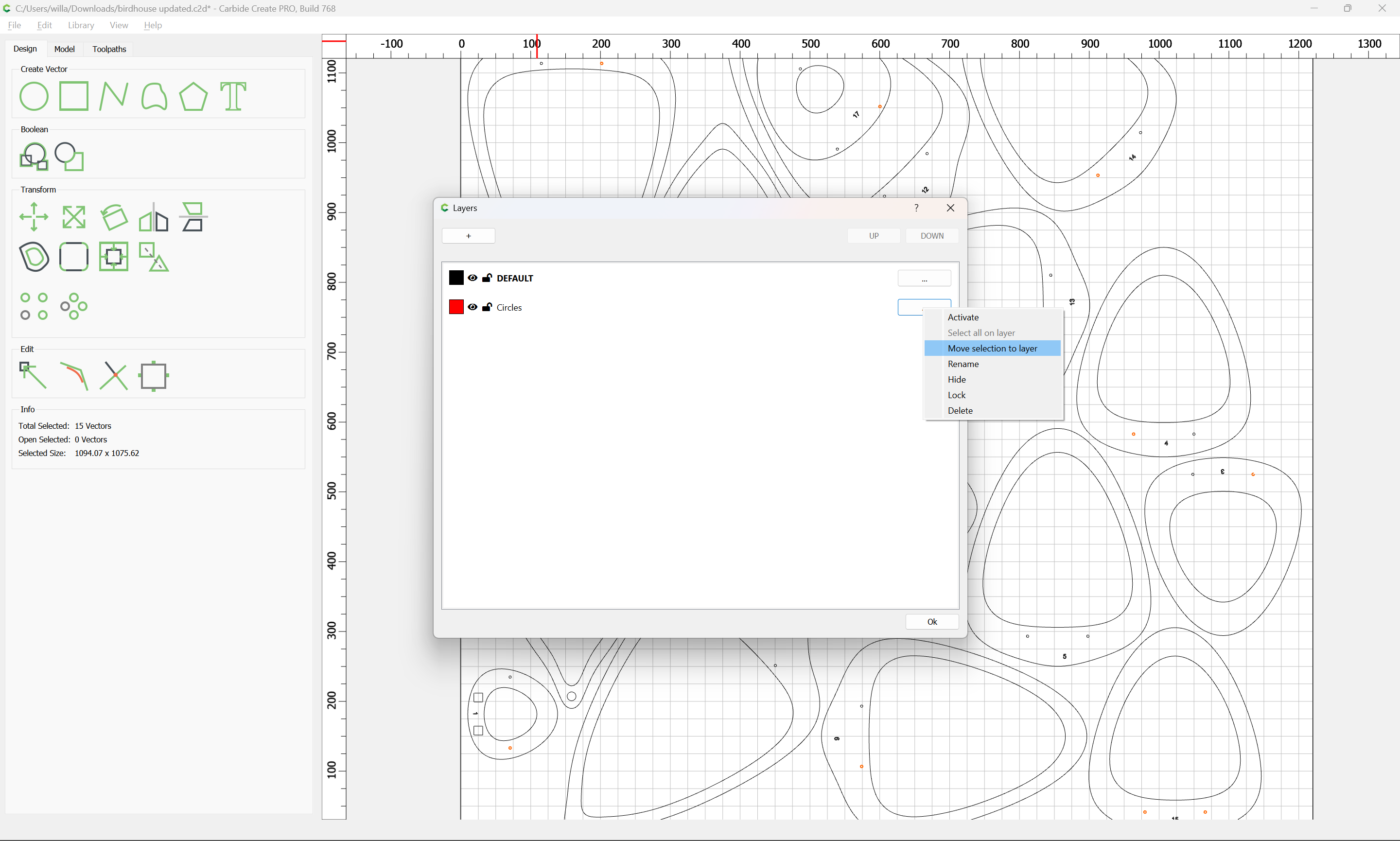

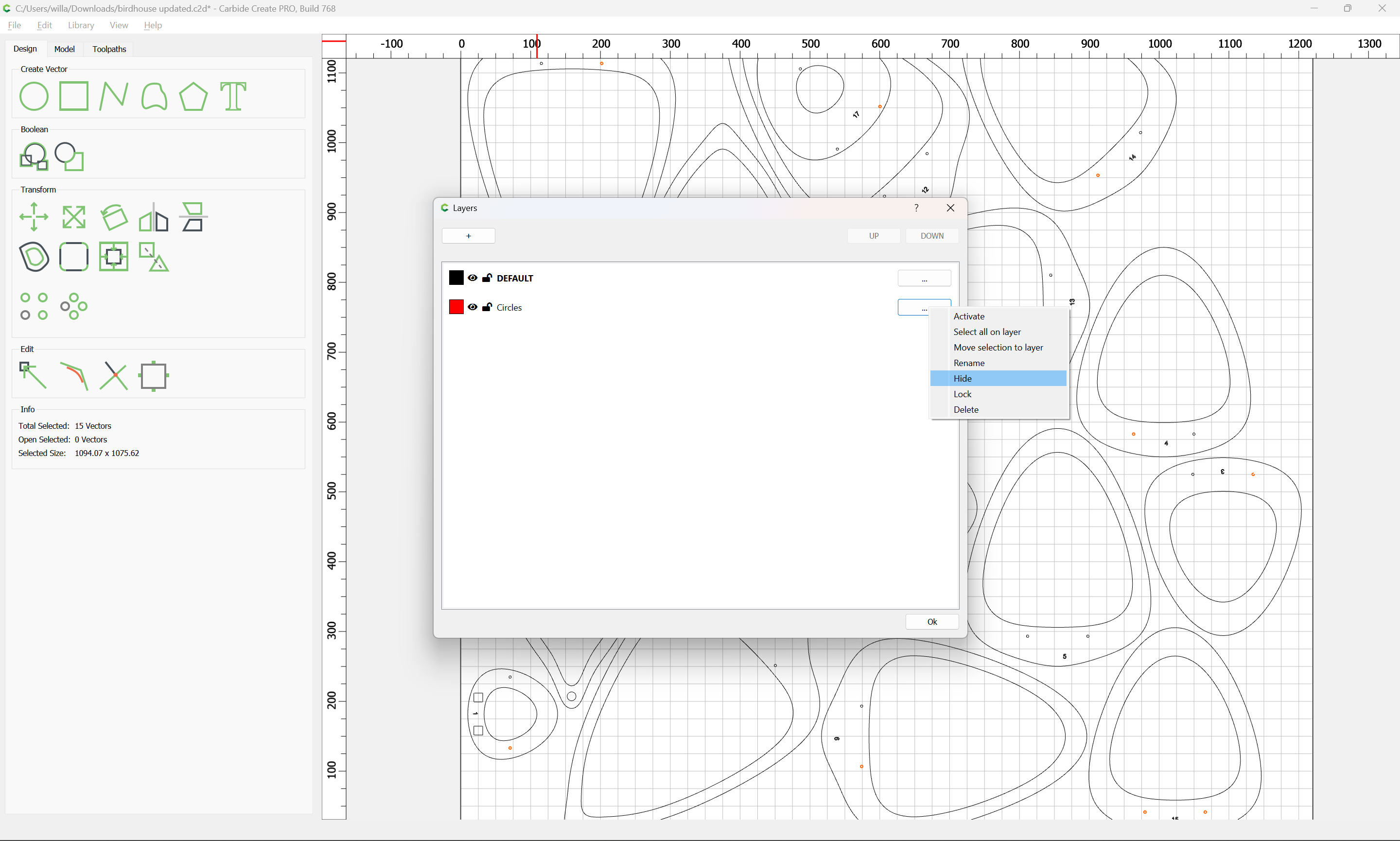

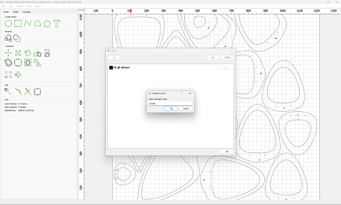

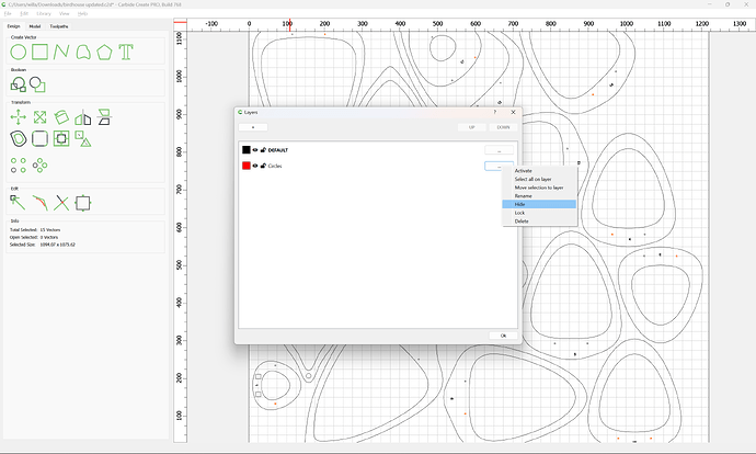

We make a layer for them:
and move the selected ones there:

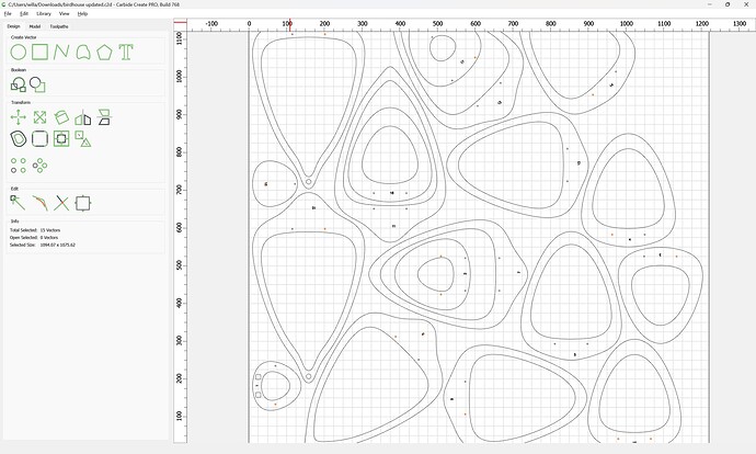

Then we hide that layer:

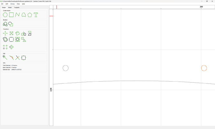

select the remainder:
and move it to that layer as well:

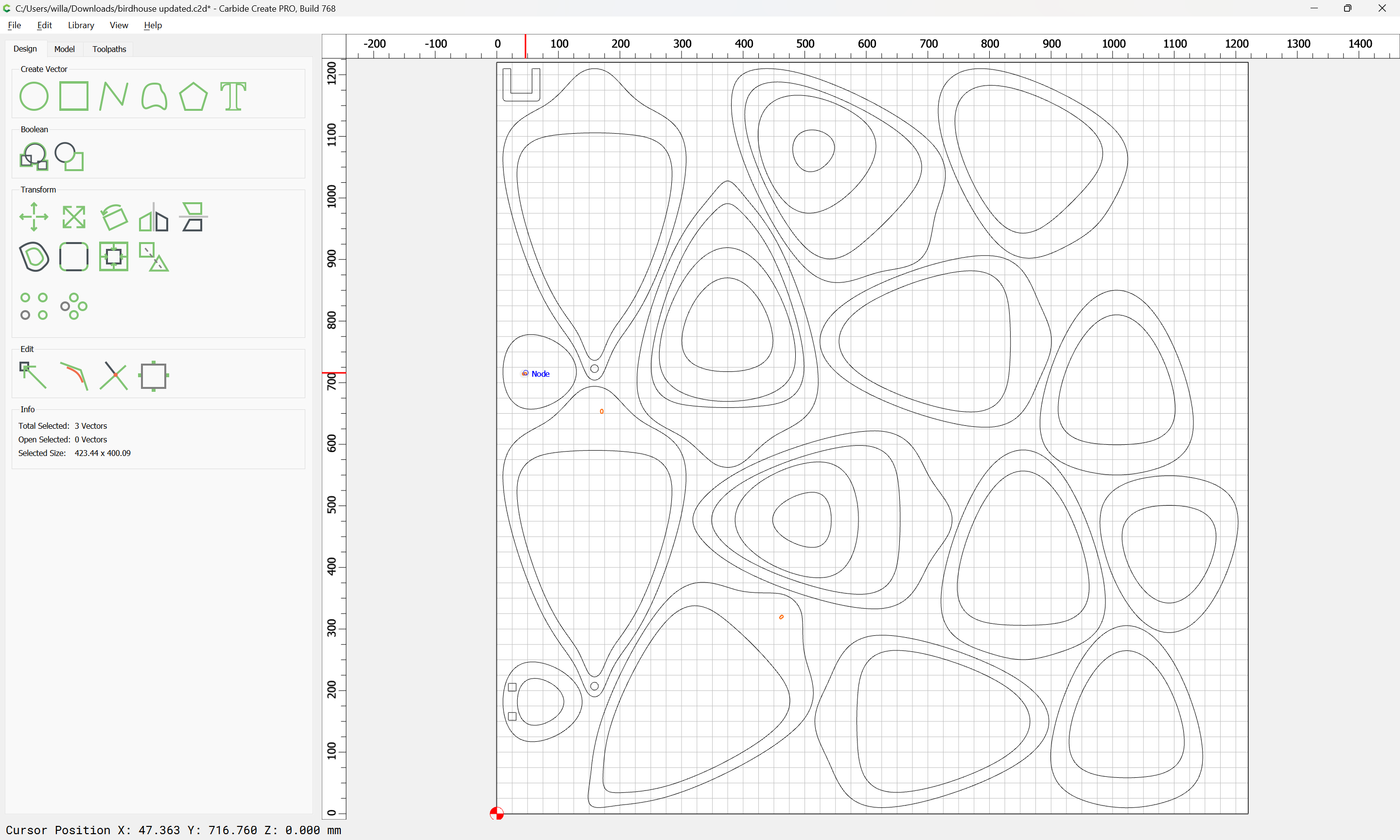

Next we use a feature for selecting the small regions:
Select anything which was missed and move it to that layer as well:

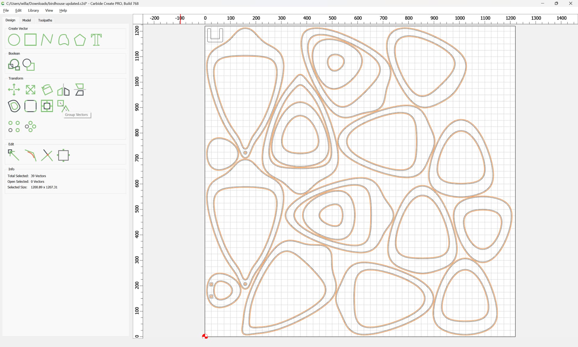

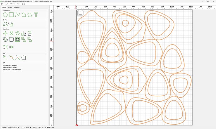

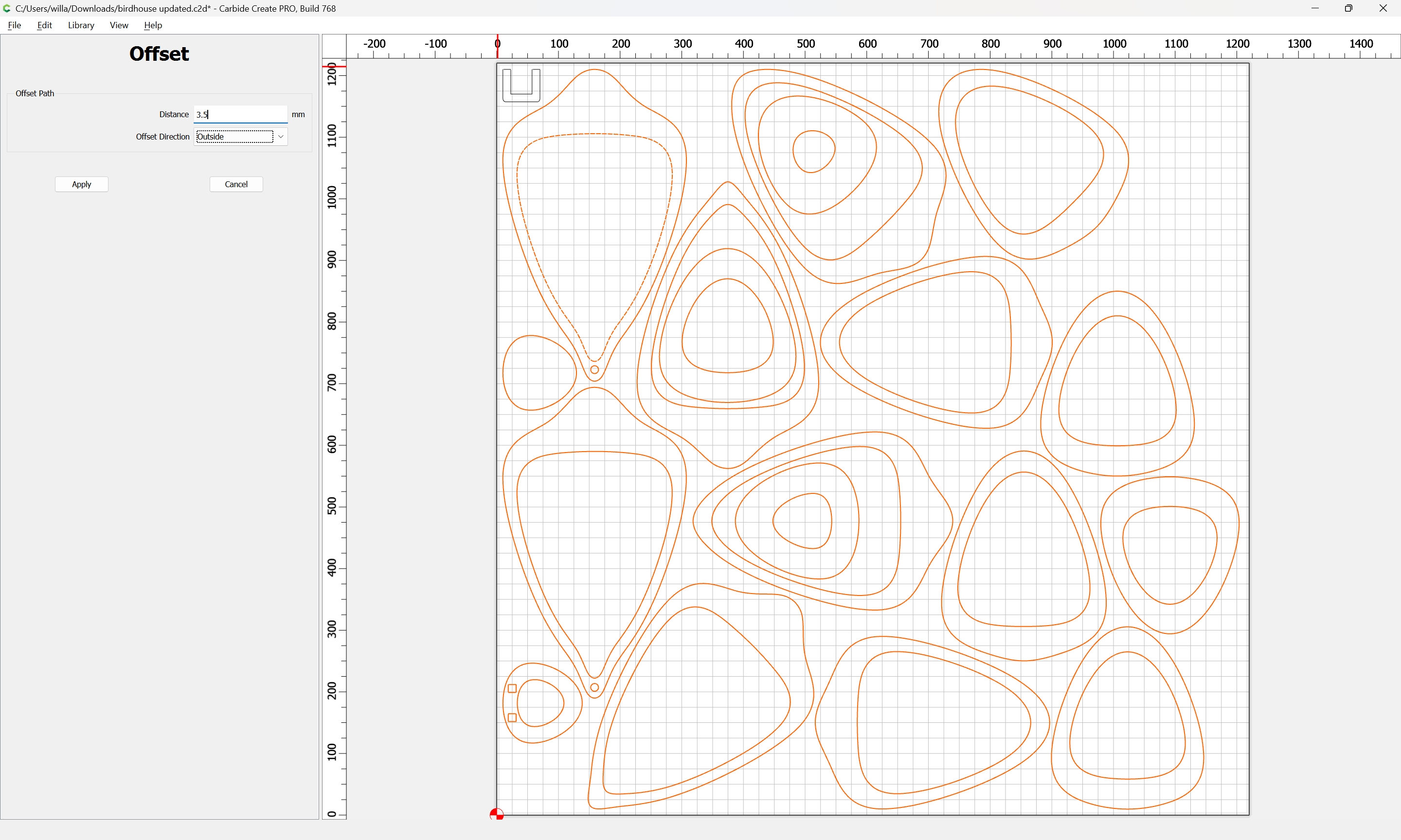

Select all the part geometry:
Offset to the outside by endmill diameter plus 10% or so:
Apply:

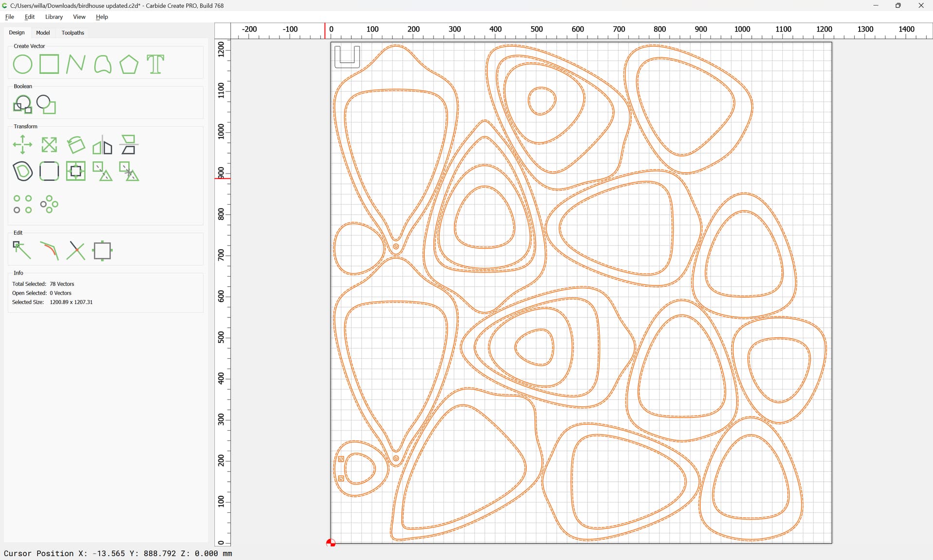

Group Vectors:

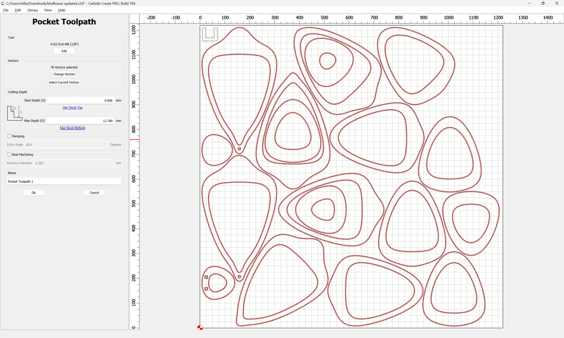

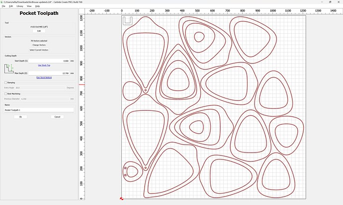

Select everything except for the outermost geometry and the branding:

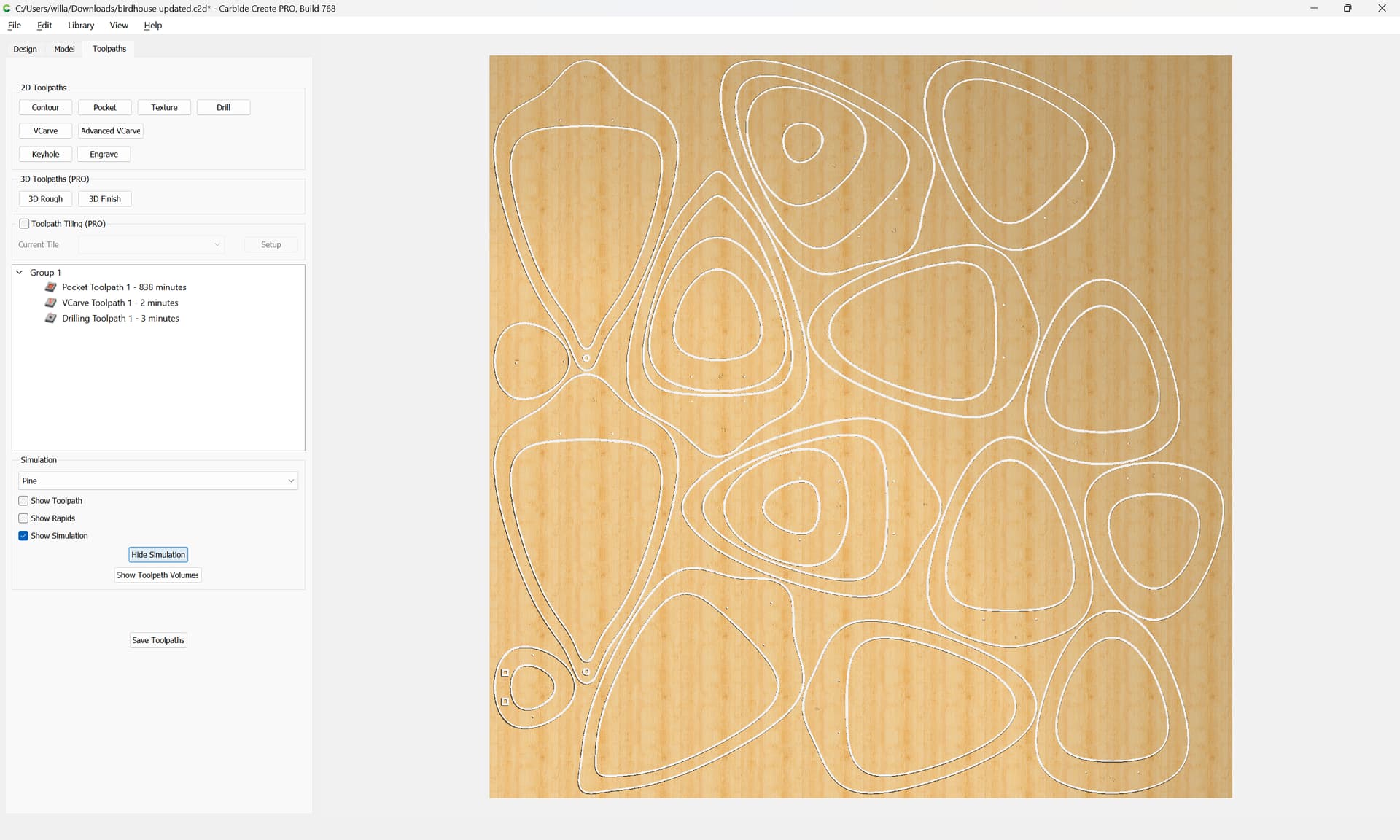

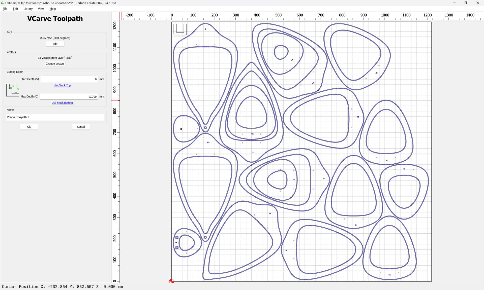

and assign a Pocket toolpath with a suitable tool:
(Note that we are assuming that the workholding will be such that tabs are not needed)

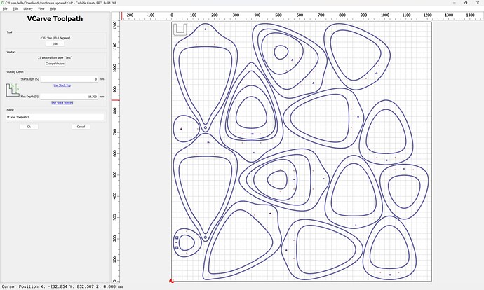

If one wants the Text for labeling, assign a V carving toolpath:
Selecting by Layer
and similarly a Drill toolpath for the alignment holes:
