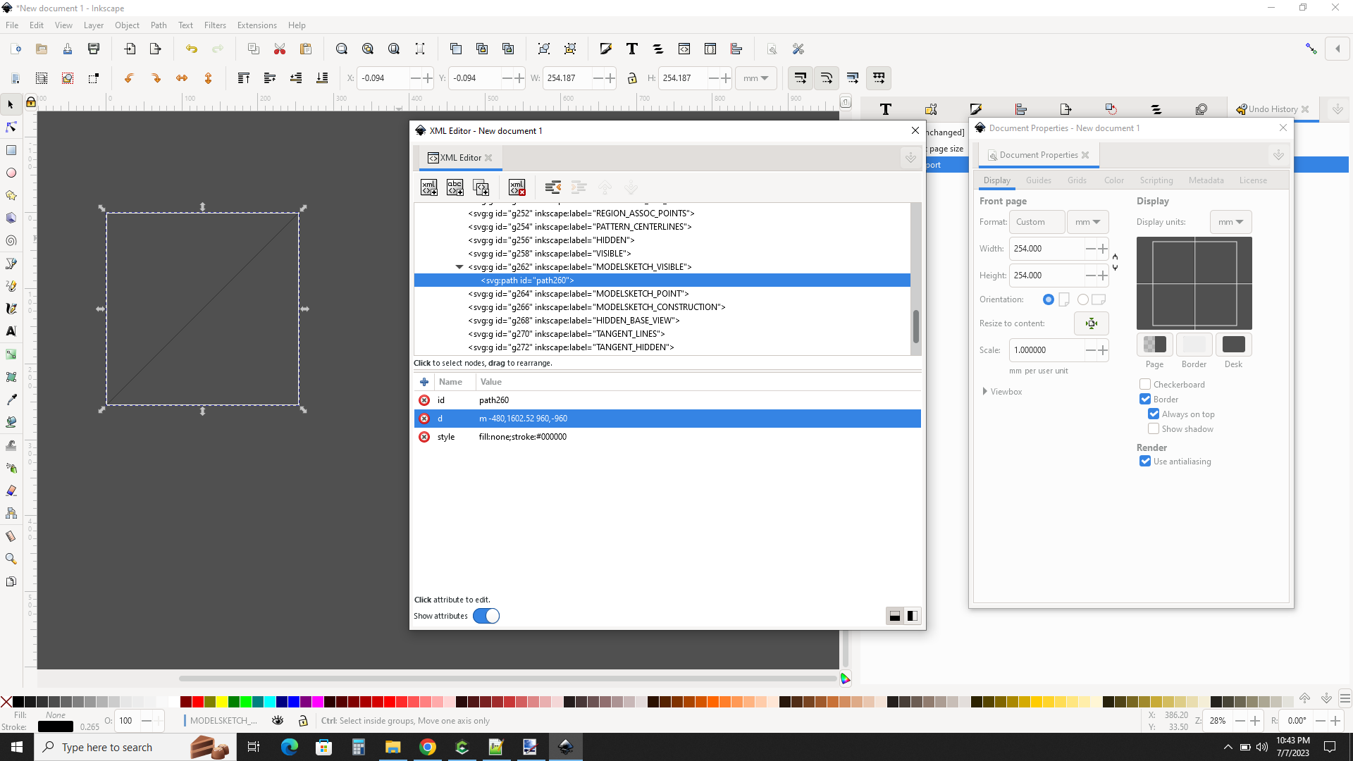

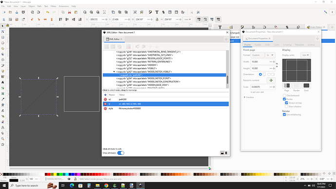

Using Inkscape, here is an example of a metric DXF file imported to a metric SVG document.
The XML Editor Dialog in the middle shows the SVG PATH
Note the coordinate of m -480,1602.52 960, -960
Little m means relative coordinates.
I have no idea where the first coordinate comes from but the relative move is 960
Path definition
The Document Properties Dialog on the right shows the canvas size

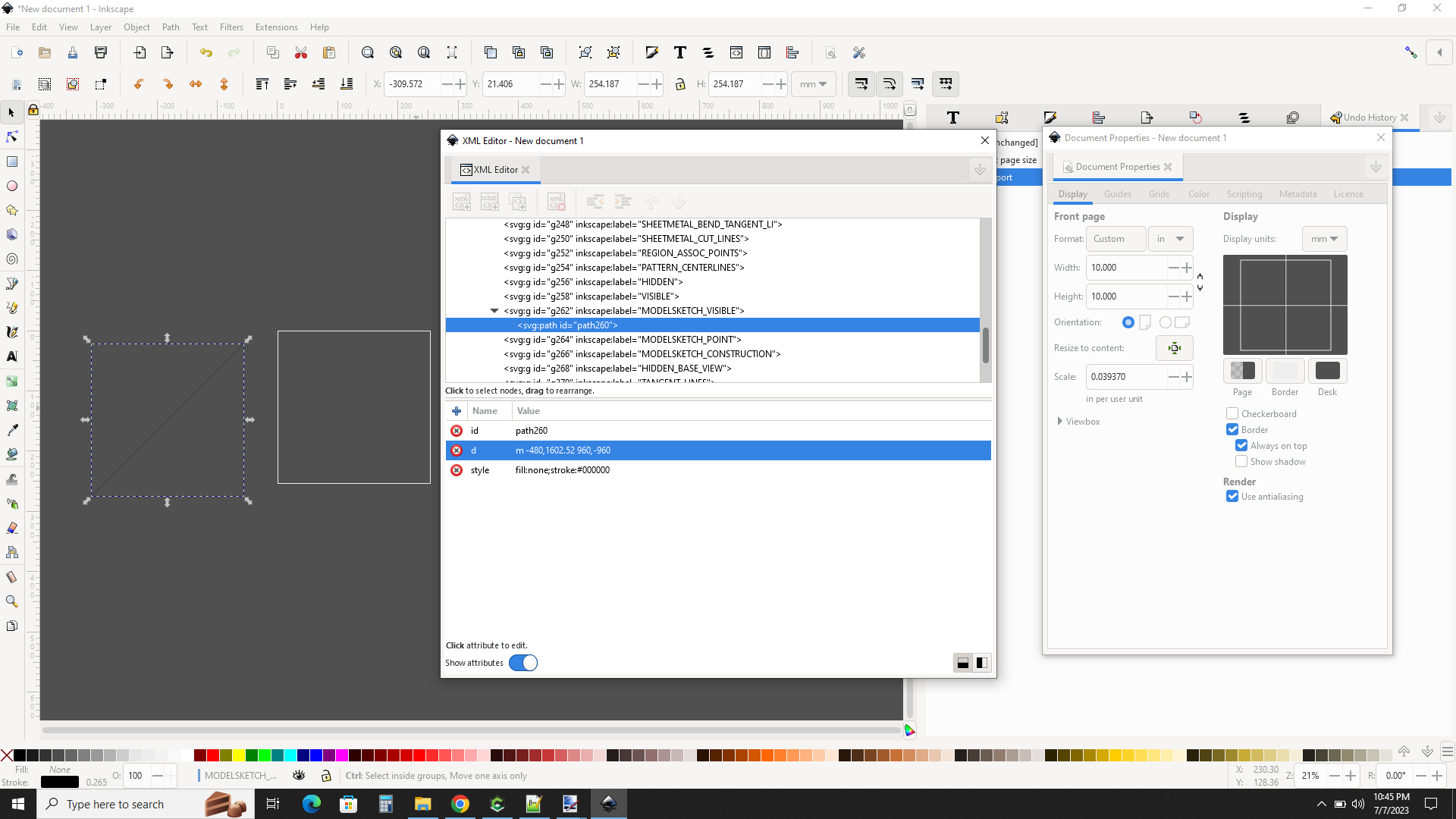

I tried this on all combinations of MM and Inch imports and got the same results, except the ViewBox and the Entity extents didn’t line up correctly, but te Path data was identical.
