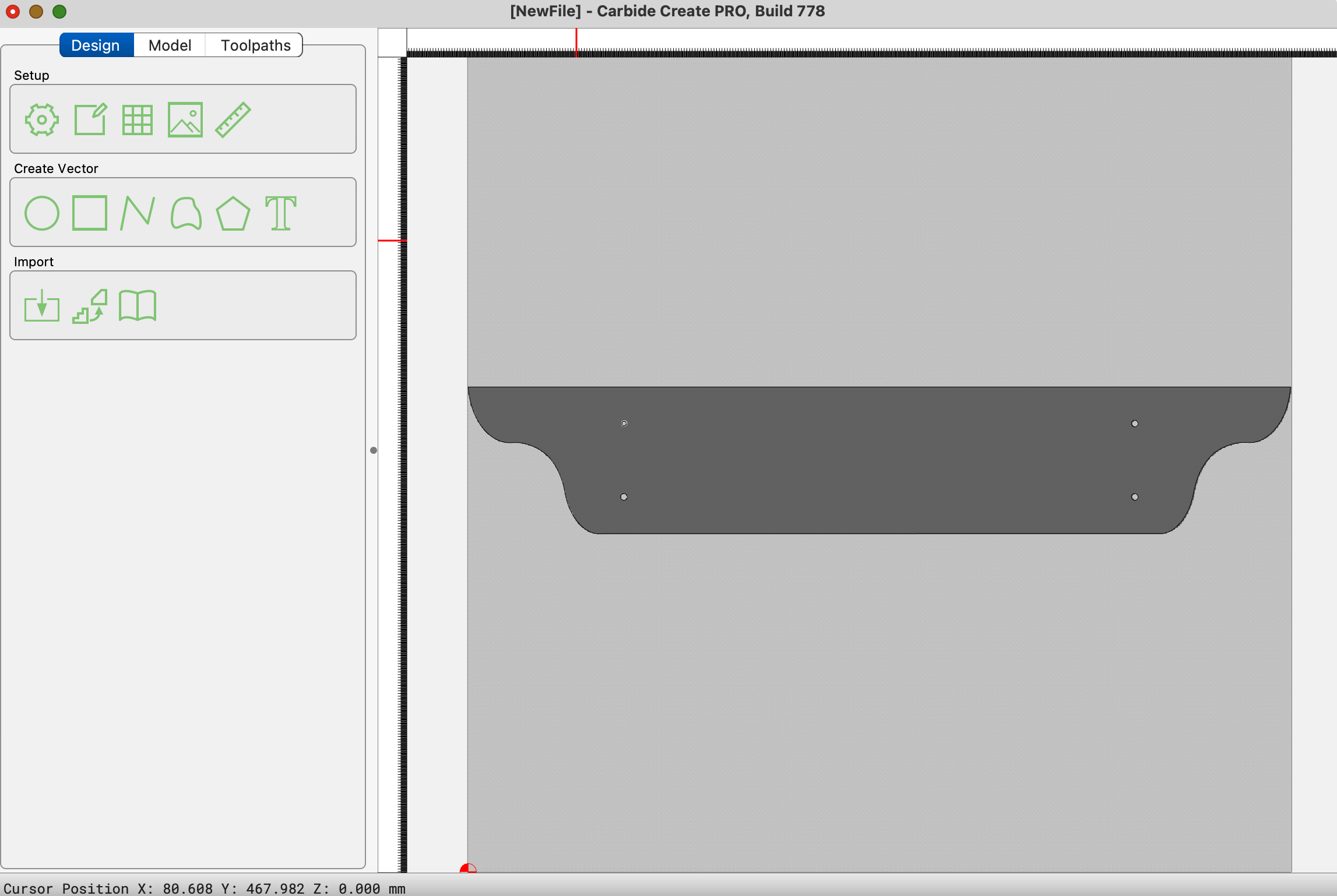

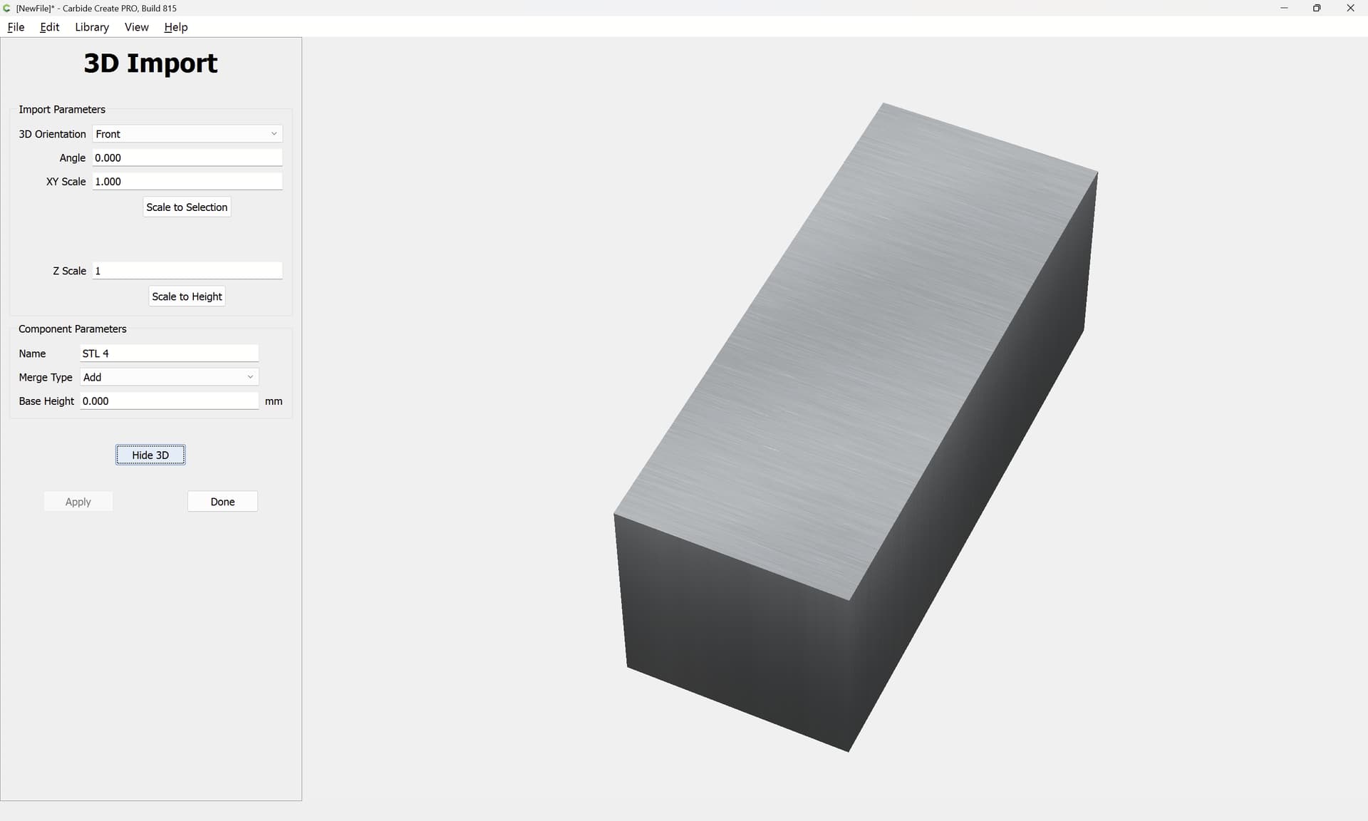

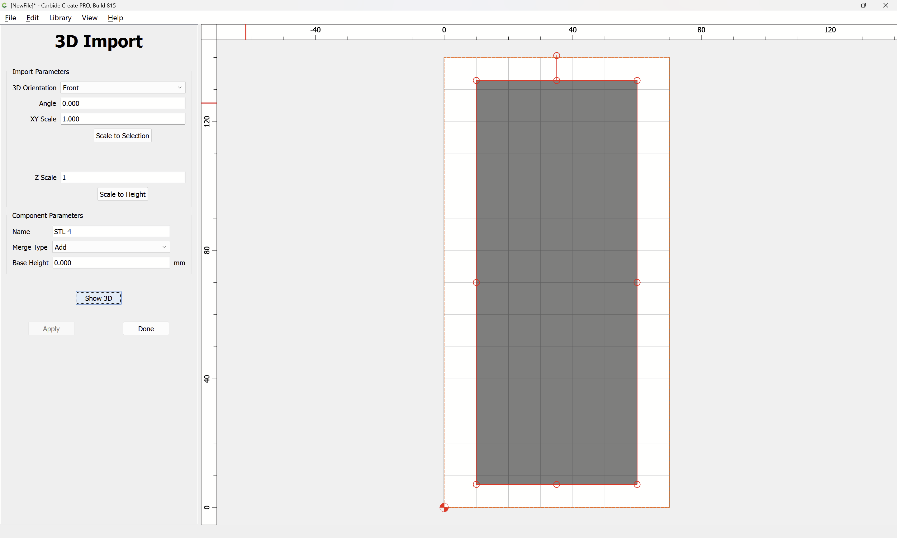

I can export each body from Shapr3d as an STL, but when I import to Carbide Create, the dimensions don’t get imported. Whatever height and width I have in the blank design is the width it converts the imports to. The design shading also looks dark and I’m not sure that’s correct either. I’ve attached an example.

When you import an STL into Carbide Create it is possible to set the size in Carbide Create to match the STL file.

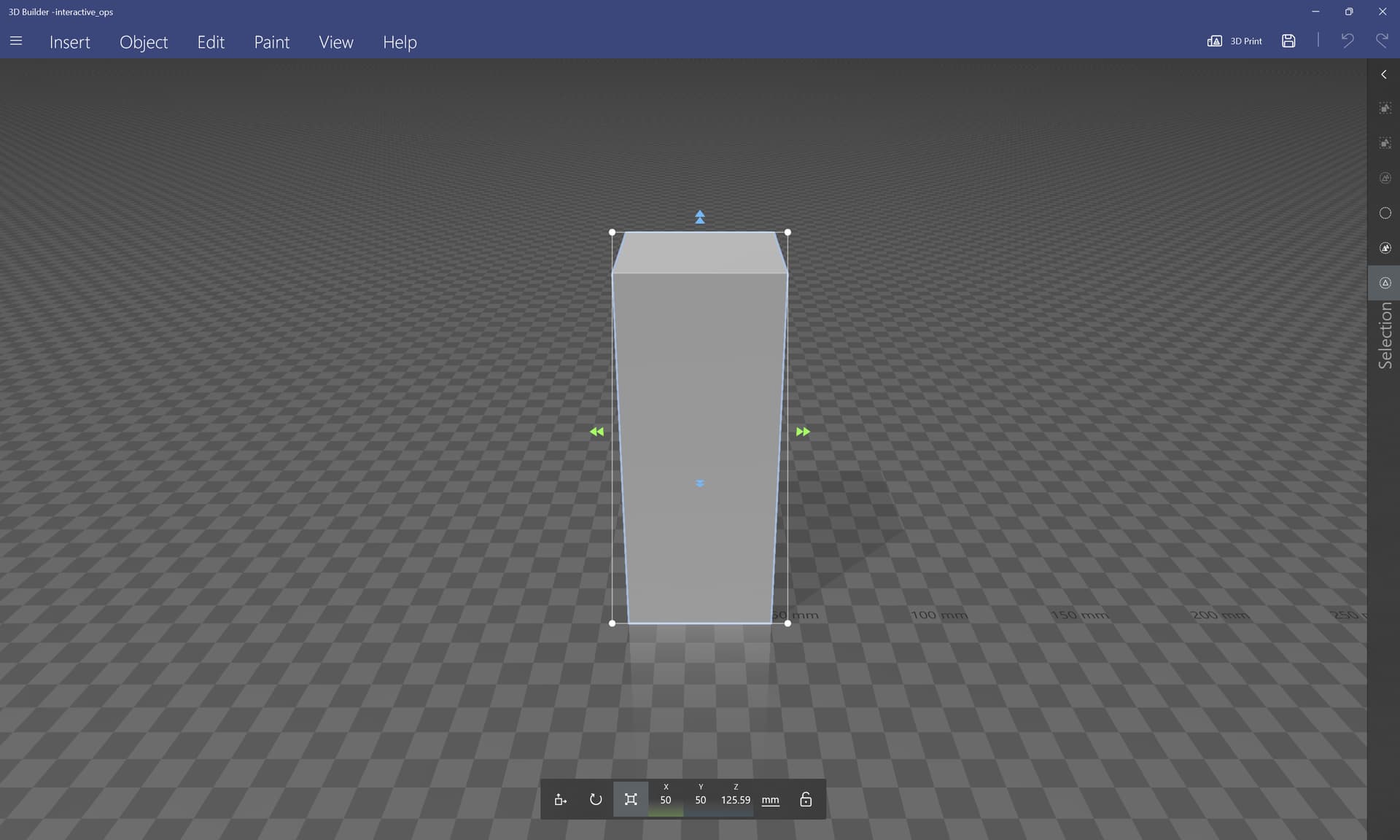

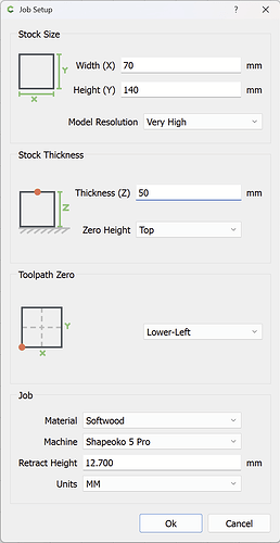

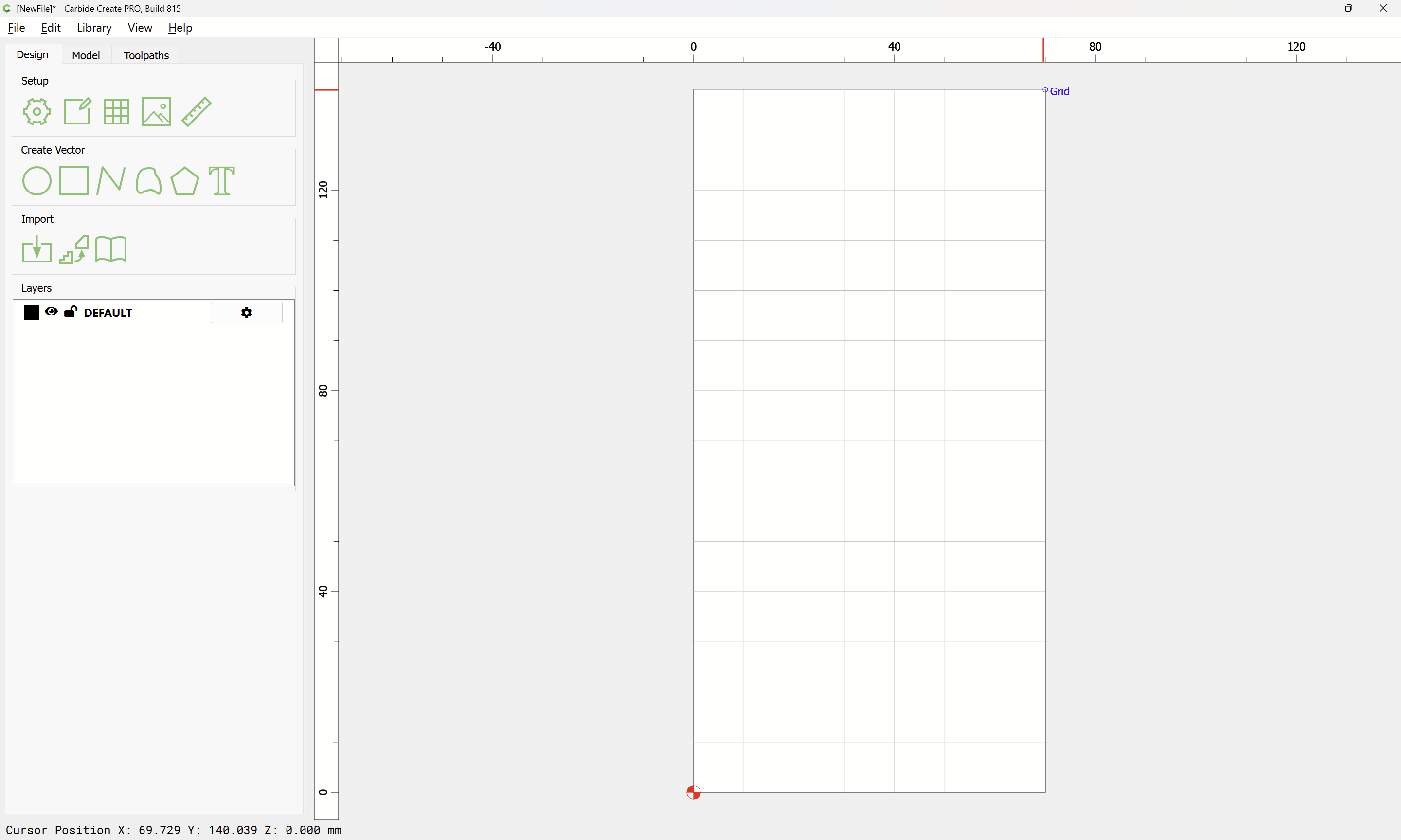

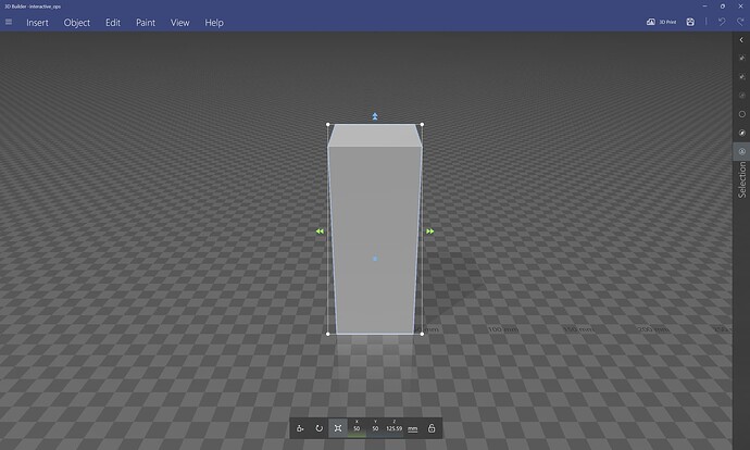

An STL is usually defined so that the internal units are millimeters:

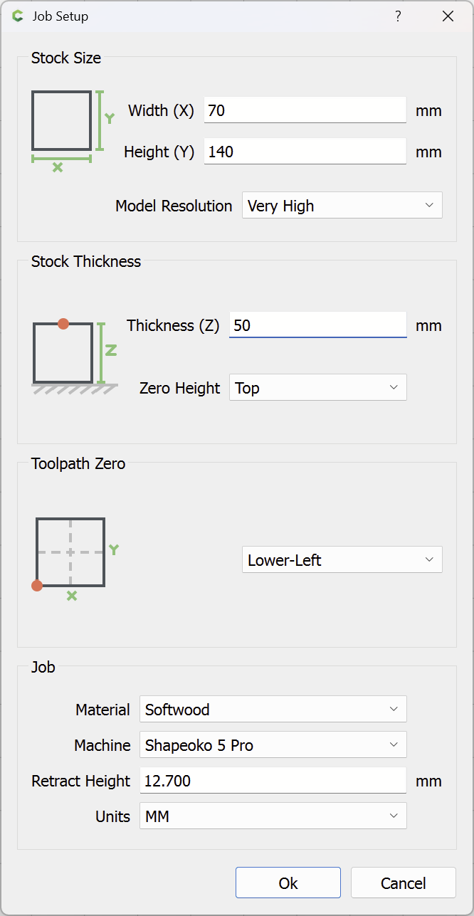

If one then sets up a job to dimensions which are slightly greater than that for X and Y and equal for Z (accounting for rotation):

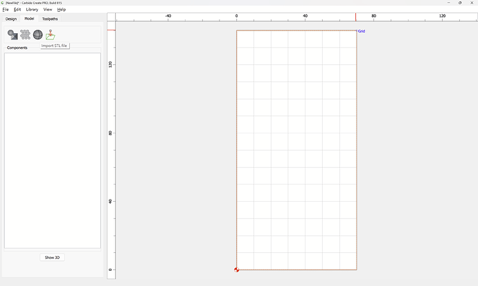

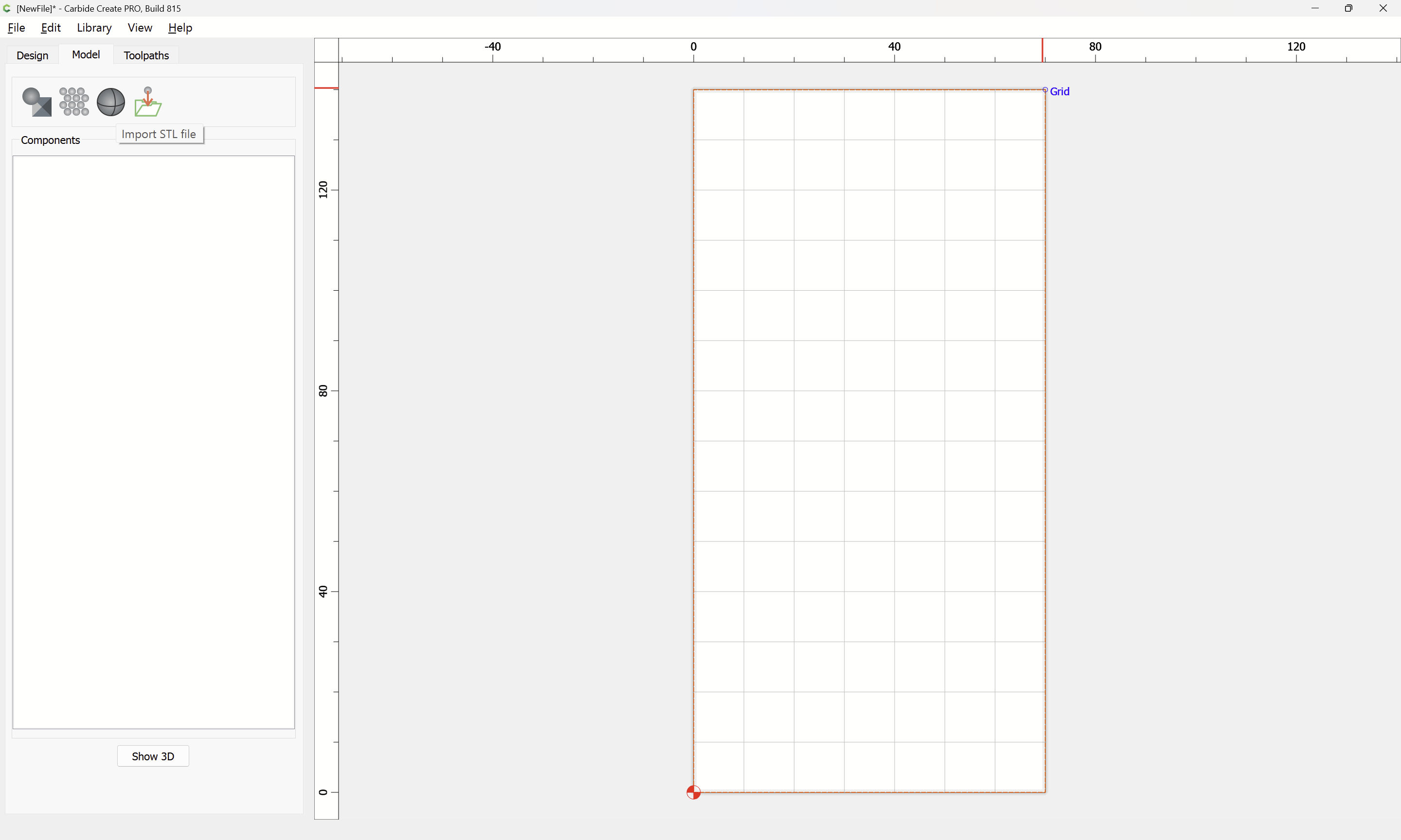

draws in geometry to define where the 3D model will be centered:

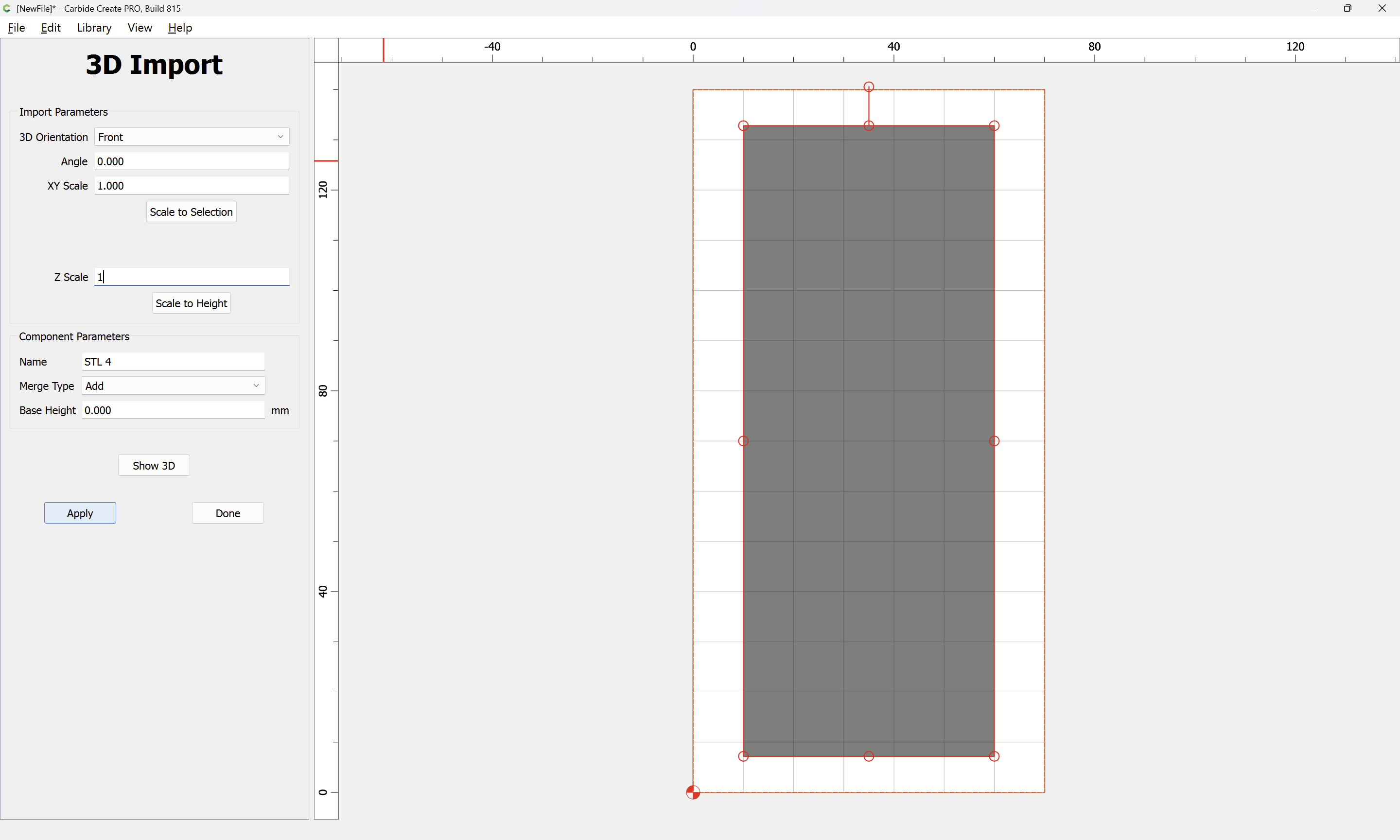

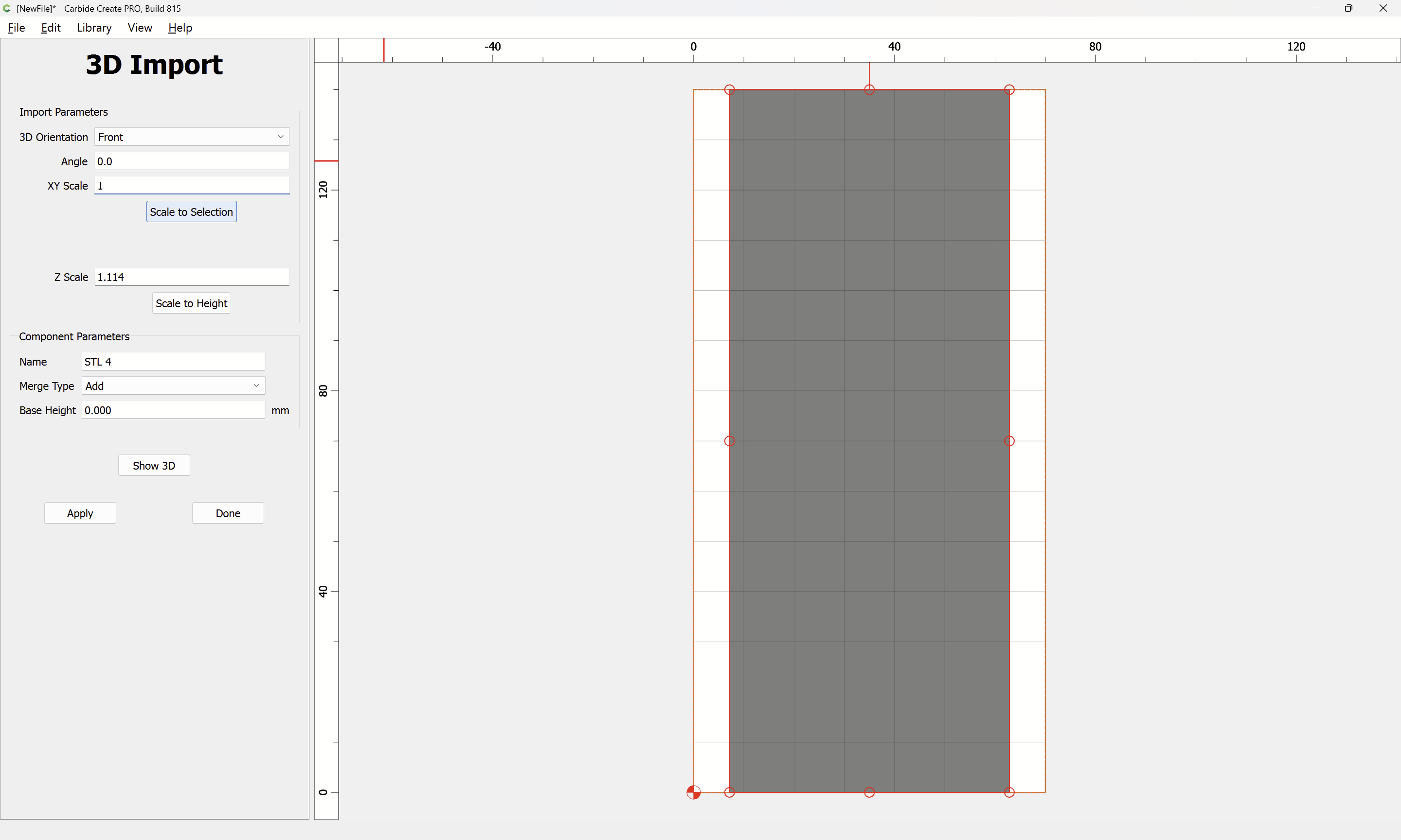

then imports the STL, adjusting rotation as need be:

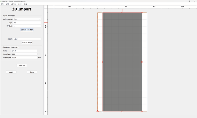

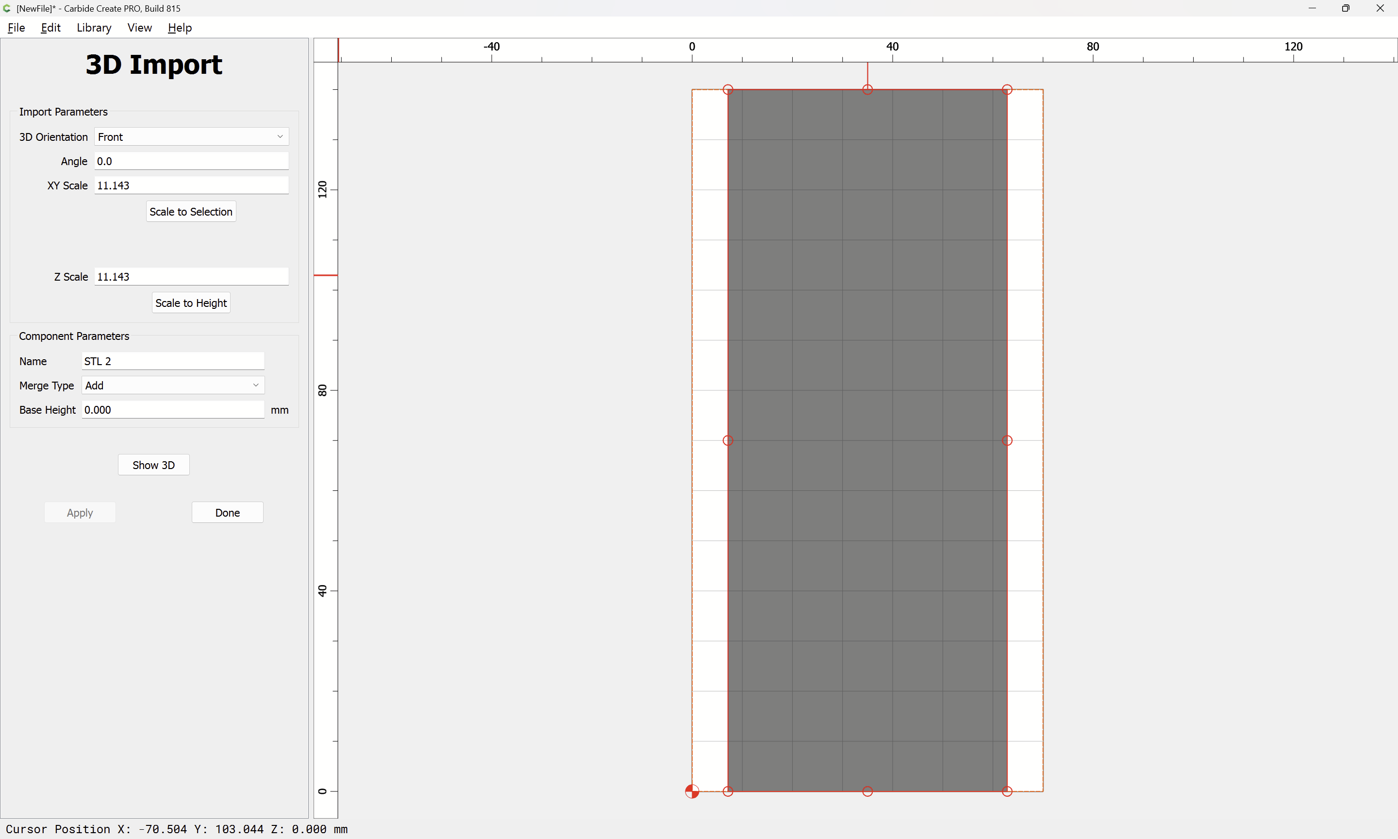

It is then possible to adjust the scaling for XY:
click “Apply”

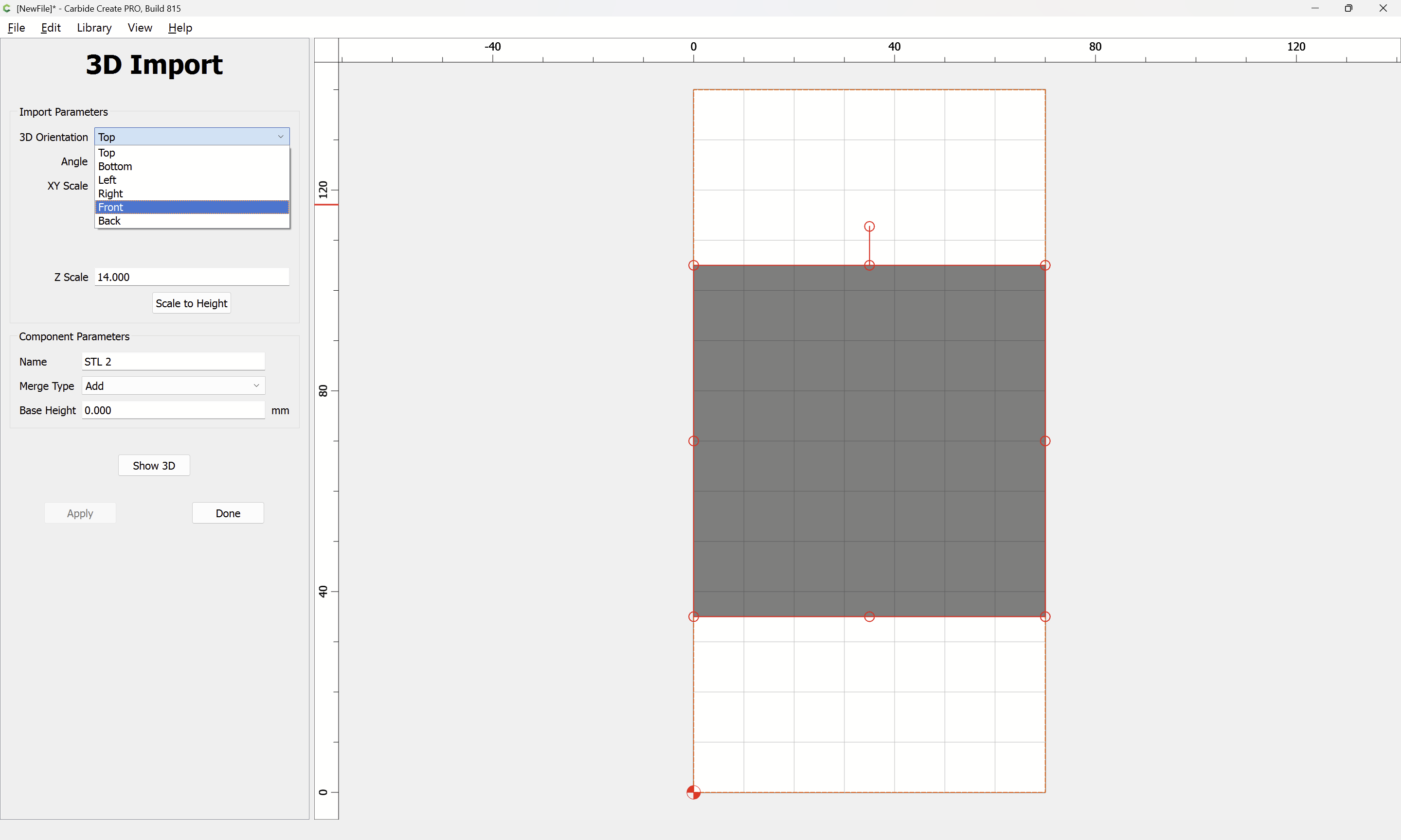

and separately adjust Z:
“Apply”
“Show 3D”
to see the rotated rectangle.
