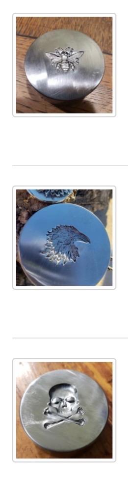

So i have a customer who’s a jewlery maker that i do alot of work for. She was asking me if i would be able to make impression dies for her, basically a concave 3d image cut into a steel block or something similar. The idea is you take the die and a thin peice of metal to a hydraulic press and press the sheet into the die to form a 3d image in the metal. My question is is how difficult would something like that be to CNC? I haven’t done much work in 3d with my pro 4 but I’ve been wanting to learn.

My apologies if my terminology wasn’t correct, im not looking go make an impression die to produce a fully three dimensional shape, just one side for ear rings, pendants etc.
What Tex was describing is in order to press a thin sheet of metal into that shape you need something to push down the top side. Whether it’s another die with clearance for the metal thickness, or a liquid under pressure, something has to push it down into that die.
You can definitely make these on your CNC. On a “jewelry” scale you’re probably talking about some pretty small tools, an ‘micro-machining’ using high speed machining strategies with very small depths & stepovers. Steel might be out of the question for these machines. But aluminum, brass, bronze, kirksite, or even some very hard plastics for short production runs are feasible.

The jewelry maker is probably doing “Impression Forming” using urethane as a backer instead of a second machined die for small pieces. You can get a decent amount of detail with thin copper or silver sheet with that and a hydraulic press.
Here’s a video that is more about the size of the urethane backer than the entire process, but it pretty much covers the whole process in a short time.
Ok, so definitely a subtractive process for the OP and making a steel die with high pressure durability … just like he said in the original post :smiley: .
There’ll be some work involved in getting those 3D details in steel.
