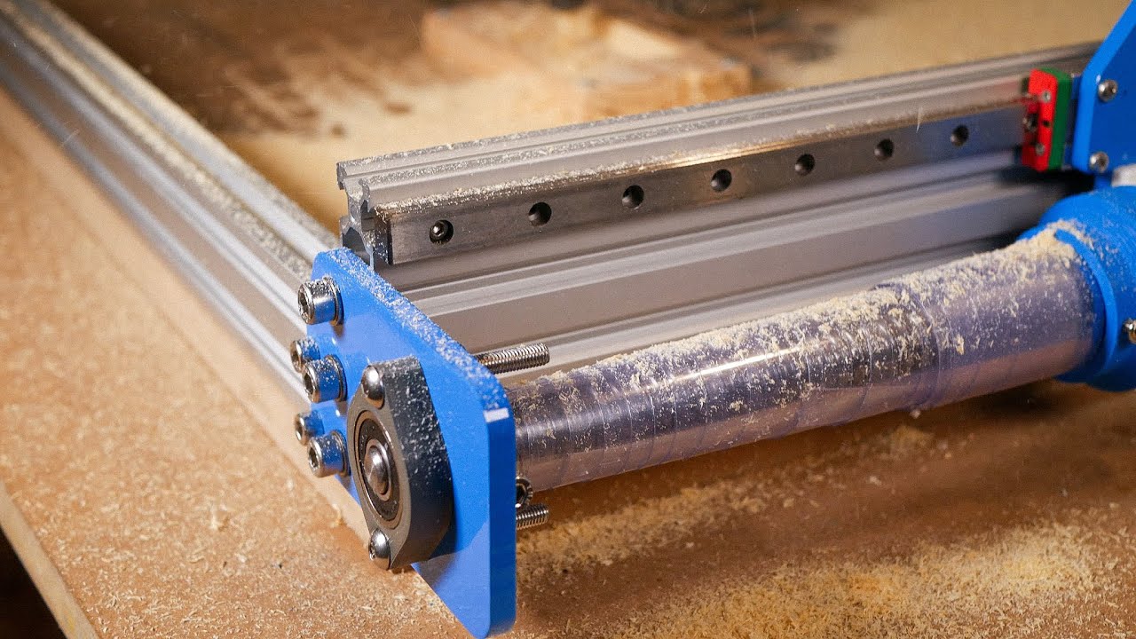

Side note: How are you combating all of the chips on your ball screws? I can’t imagine running the machine with the ball screws covered in oil and aluminum shavings is going to bode well over time.
I saw this vid a long time ago. Maybe it would work for CC machines.
