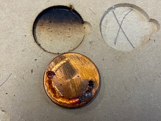

OK, here we go.
Here is my first attempt to cut a coin. Not quite what I’d hoped for but at least I have something to work from now.
As you can see, the coin got VERY hot and even scorched the mdf pocket. And, at that, even though I had slowed the plunge to .3 and the speed reduced to 40% override, the coin still moved in the pocket and the router sounded really bad trying to cut.
Do I need to use oil for cooling on this? Go slower? faster?
BTW, don’t try to pick the coin up very soon after…ouch!
What was holding the coin in the pocket? I don’t see anything to hold down the coin.
The design is to hold the coin in place via friction on the size of the mdf pocket. The “scribe” you see around the circumference of the coin is my very first attempt when the mdf pocket was to large an allowed the coin to turn.
This pic is the second attempt after reduction the size of the hole and making the coin very tight in the mdf pocket. I used the same blank as the first time since I’m still working out the details…obviously. ![]()
I’m working on reducing to a 1/16 from the 1/8 bit along with slowing down the plunge rate and reducing the DOC/pass.
I just wasn’t sure if I needed to have oil on the blank to hold down the heat, but may not if these changes work.

I’m using brass coin blanks, 1 1/4 dia. and 1/8" thick. Was using a 1/8 end mill for the chain hole, but just changed to a 1/8" drill and cut the hole out fine.

Things are never supposed to get (really) hot when cutting, so when they do it’s usually a sign that the tool is rubbing rather than cutting. This can happen if you are feeding too slow (the endmill spins fast and does not move much “into” the stock, so it can’t bite into it to cut a nice chip, and instead rubs the flute against the stock, which generate tons of heat). So chances are you should go (much) faster in terms of feedrate, and/or slow down the RPM

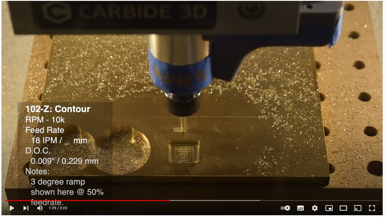

For recommended feeds and speeds for cutting brass with a 1/8" tool, check out this video from @wmoy:
(It’s Nomad related, but applies equally to a Shapeoko)
At 01:29 he shows recommended settings for a 1/8" endmill:
Using a ZrN-coated endmill does help.
