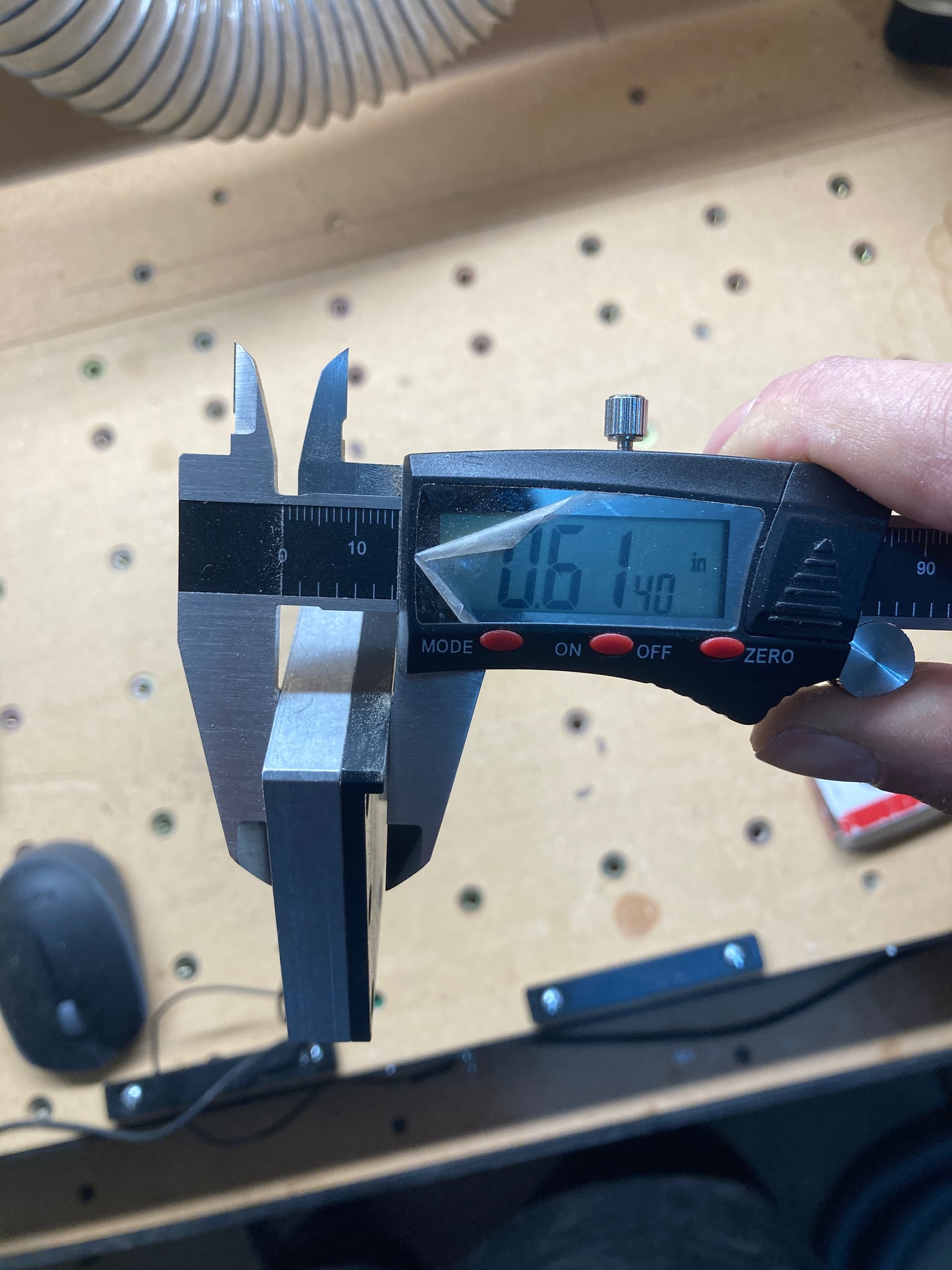

Can you measure the thickness of you bitzero v2 (with and without including the corner), for the sake of covering that ground ?

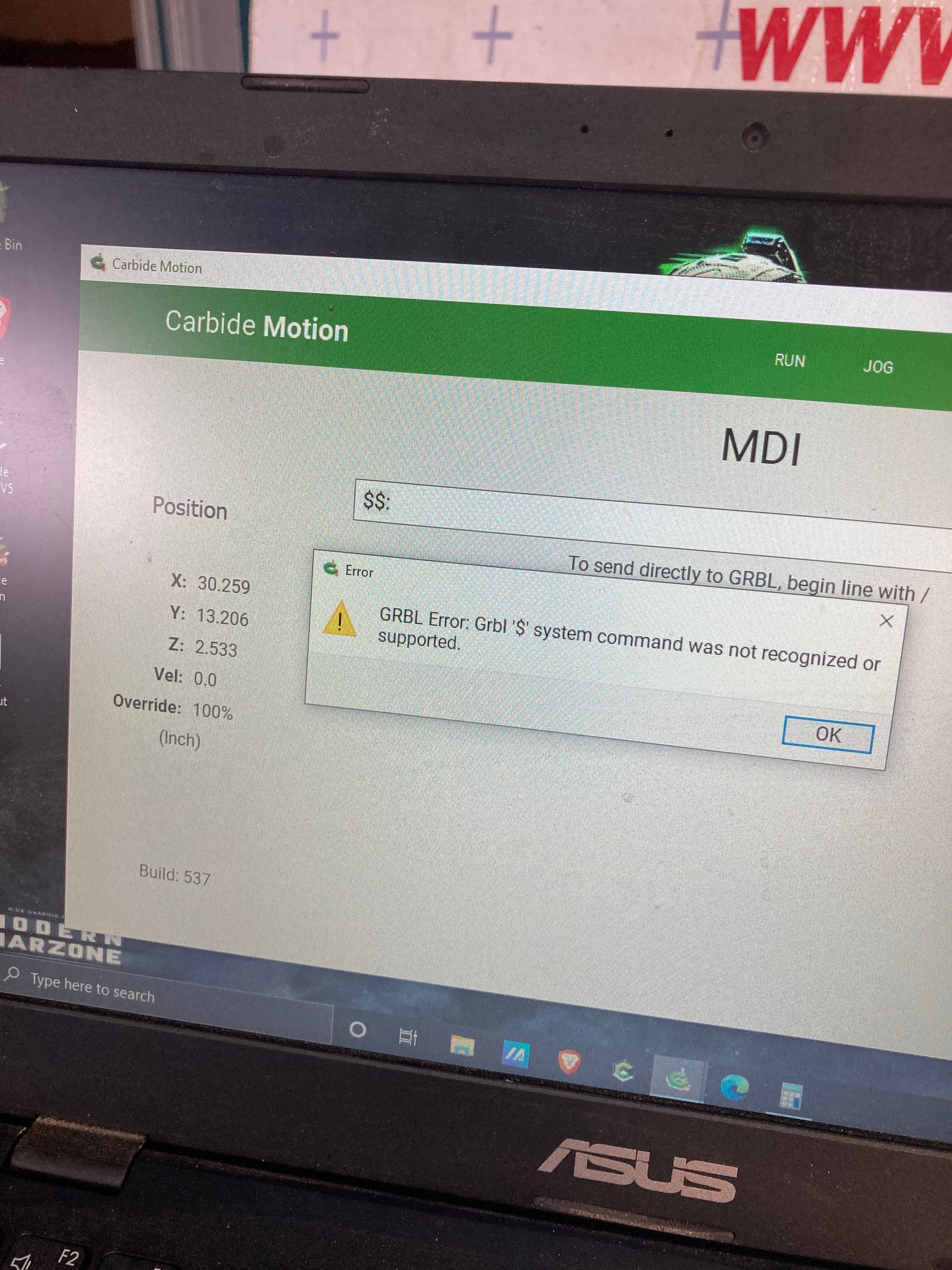

Let’s also double check your Z calibration value just in case. In CM, Settings section, click the log window button at the bottom, then go to MDI tab and send $$: what value does $102 have ?
After that I’m out of ideas, it’s worth asking support@carbide3d.com maybe they can puzzle it out for you.
Here are the bitzero measurements. I followed your instructions for the $102 but this is what i get.
Sorry, I meant sending $$
( the colon was just part of the sentence)
No problem the $102 value is: 200.000. I’ve opened a support case with Carbide and they think they may have an idea what it is. I’ll probably hear back tomorrow from the.
