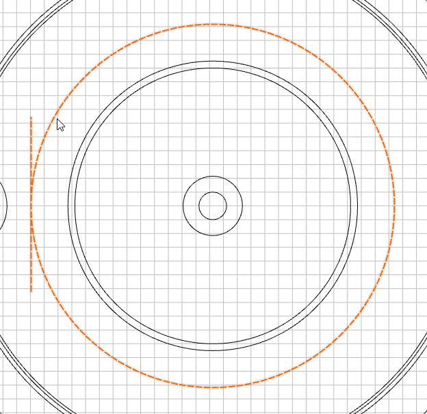

Not sure how to fix this problem - we are cutting knobs (happens with other round things too…) and where the bit enters the wood it leaves a vertical mark that we have to sand out. The rest of the circle is perfect, but the place where the bit enters always has a mark. Any suggestions?
The plunge can cause some bit deflection, so you get the mark. The usual approach would be to first cut slightly away from where you want to be, then do a finishing pass right up to the line.
Post your file if you can, it’s easier to make suggestions if we can see how things are set up.
Thank you for your reply. It’s set up for a finishing cut 0.5mm from the rough cut line. (circle #4 & #6 counted from the outside)

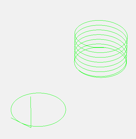

A couple of ways to eliminate the plunge mark…
Create a 13.175 R circle & cut it & add lead ins. Use a contour no offset
Hole Milling. On the tool set the depth per cut equal or greater than the max depth. Change the plunge feedrate to the same as the cut feedrate. Set ramping to 2-3°
