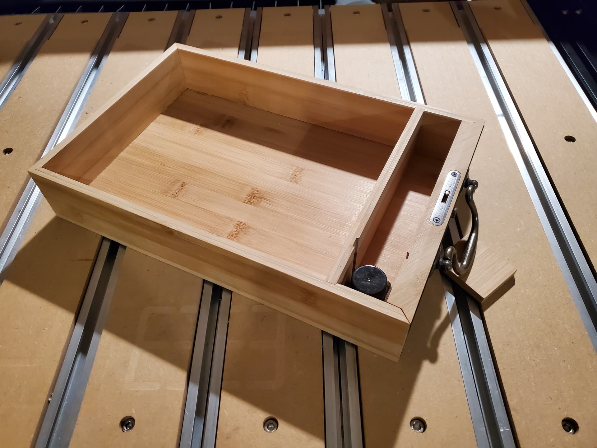

Started by drawing up/modeling the hardware:
(choice of finishes)
I selected the antiqued option to match:
but it has since more than doubled in price since I started, so picked up:
For hinges, intially chose:
but not wild about them.
Have been considering:
(and the manufacturer when contacted was kind enough to share a drawing showing the modification needed to allow opening to 180 degrees)
and there is also:
which looks far more reasonable price-wise since the price-hike of the afore-mentioned lock.
Another option of course, is to just make the hardware — that may happen for a future implementation.
Modeled the hardware:

I’ve got the drawer pretty much cut and assembled (aside from a small issue with a sub-divider) so will be working through those issues and putting up files as I re-cut things, and re-work for the various options of hardware.
Carbide Create files will be uploaded as parts are re-cut and fit is verified — using Bamboo and Richlite, but any suitable materials may be used.

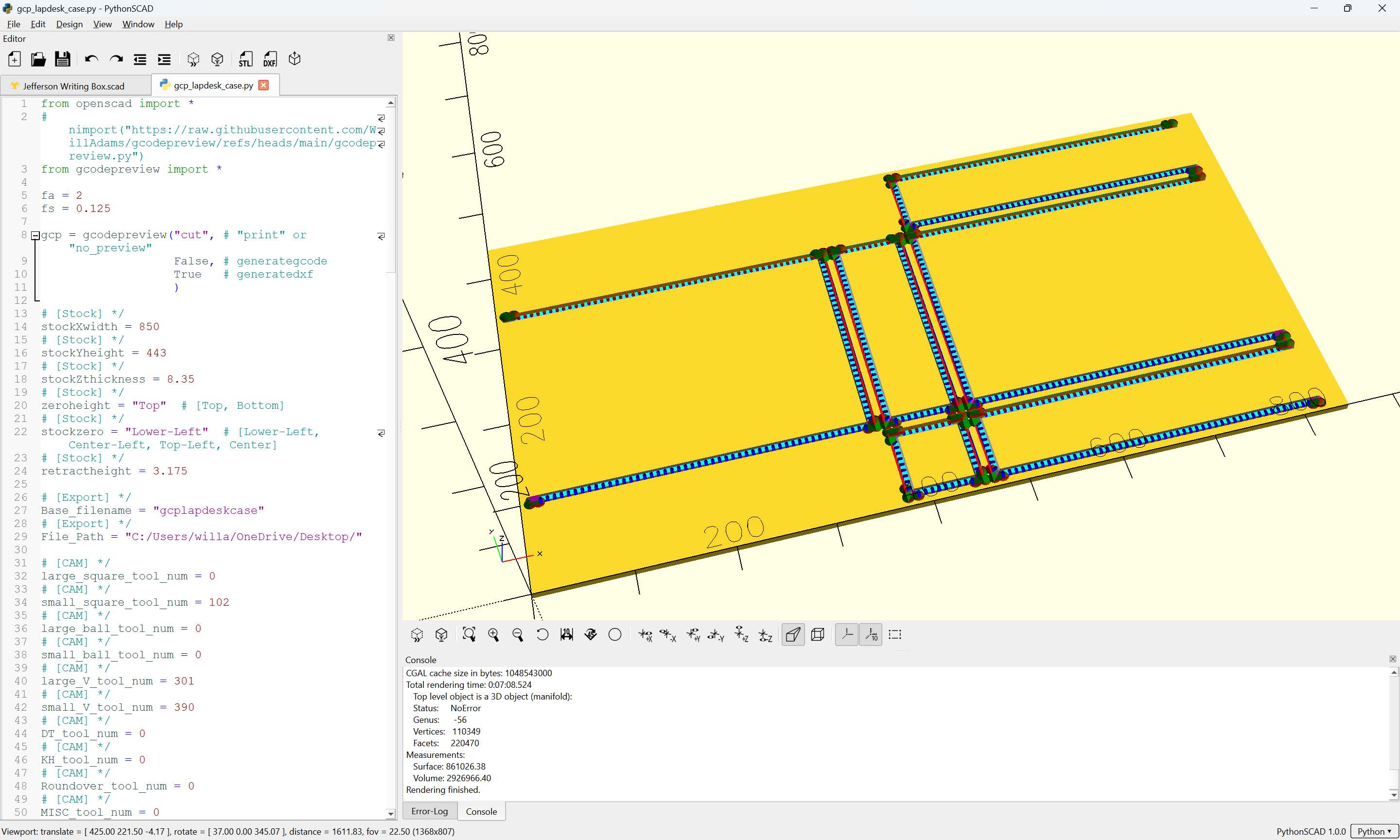

(I will spare folks the detour into lualatex not writing out .py files and PythonSCAD changing where files are written to…)

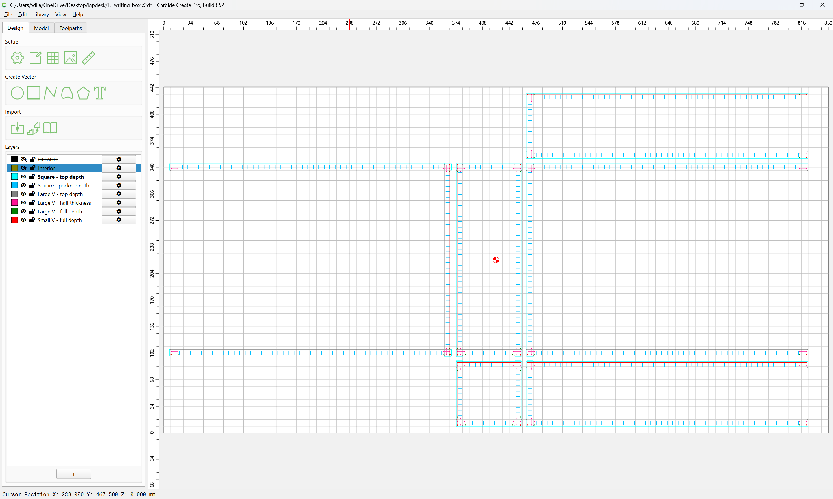

The next concern is my having gotten the naming of parameters/programming absolutely backwards from how I am thinking about things now… (cue bit from the Trevanian novel), but with a bit of mental gymnastics, the file is rendering:
and exports a DXF somewhere that I was able to find it and import it mapping elements to Layers:

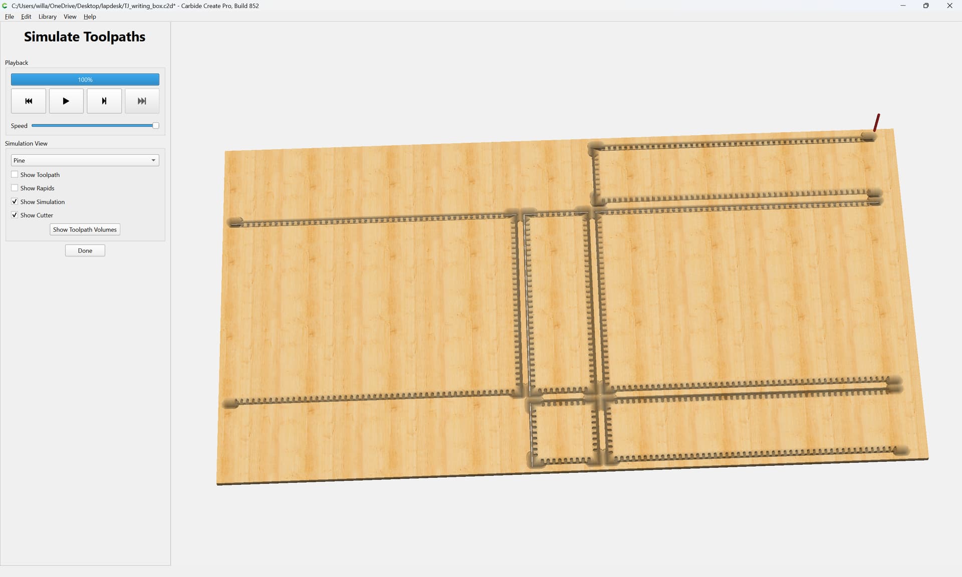

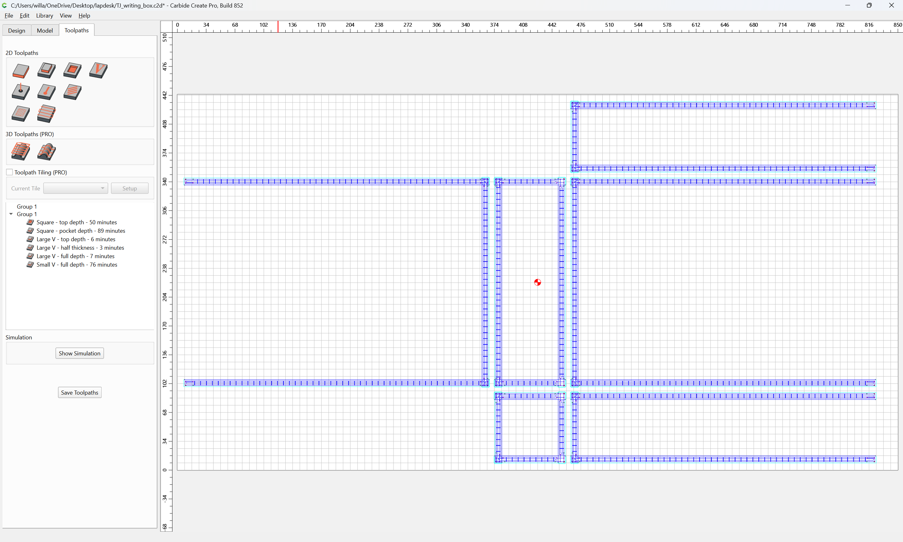

which have matching toolpaths:
and previews to match the original 3D Model:
Next up is verifying that the joinery all lines up, separating the elements, and setting up the files, then cutting…

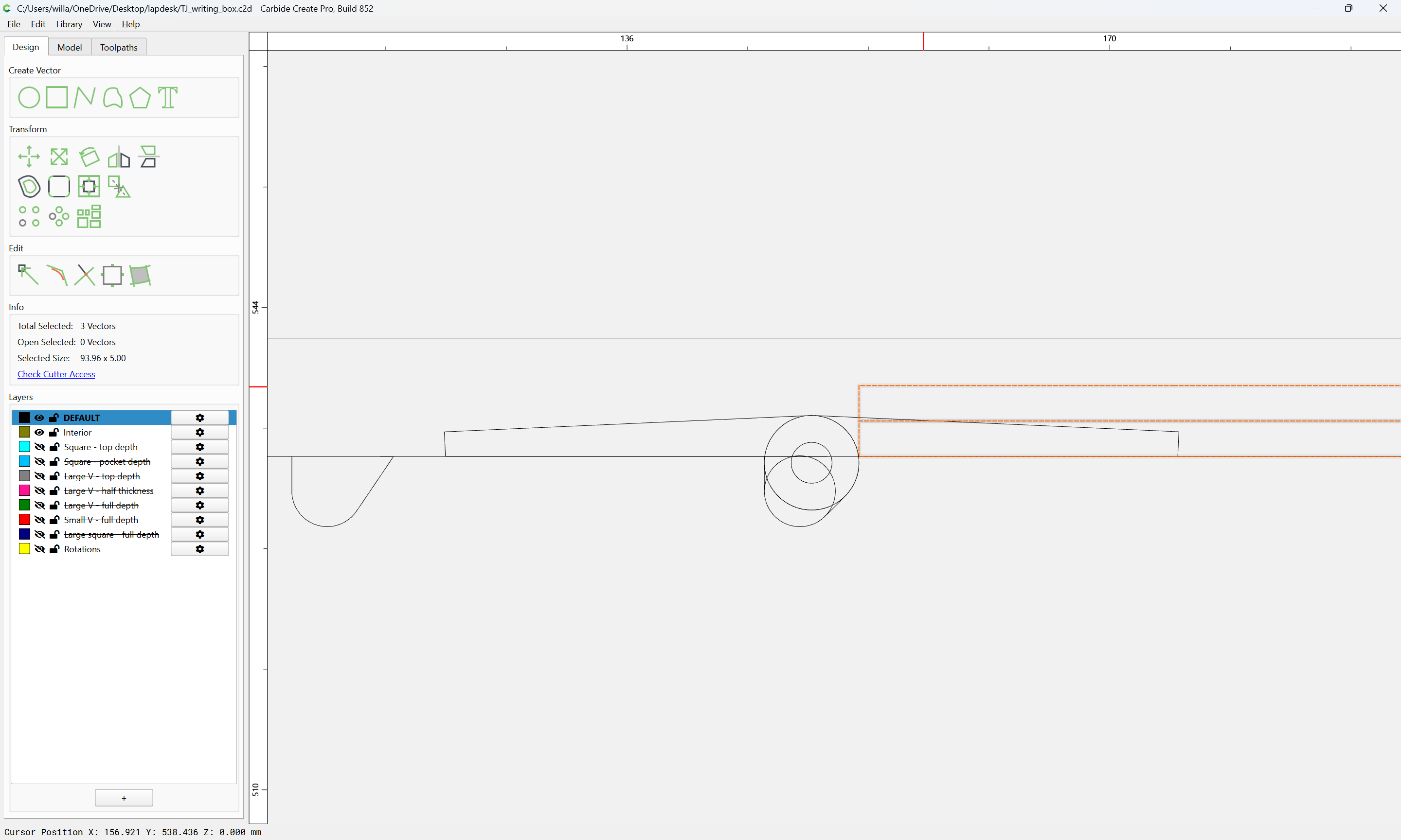

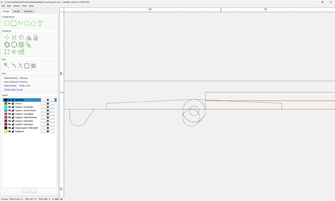

and I instead sourced:
(the 2" x 1 1/4" option)
but the more detailed drawings in Ed Zappen’s text seem to indicate that the hinges are rolled, or at least made of quite thin castings, and drawing things up, that becomes something of a problem due to its interaction with the quite thin stock:
I really don’t like rolled hinges, but I’m thinking I will have to use them for the support bracket — unless I make it out of brass instead? It might work to drill and tap holes, and if a brass machine screw was then cut off flush it shouldn’t look too bad…
