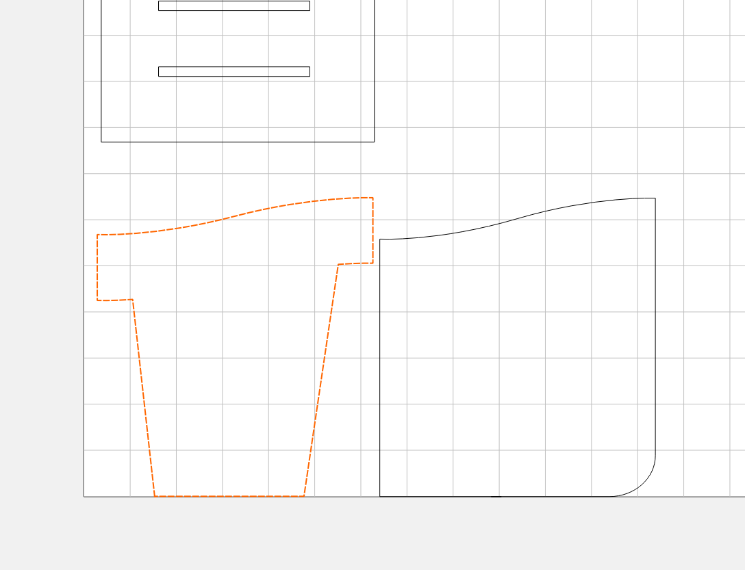

I have vcarve pro, from a previous machine, and haven’t received my Nomad yet but have been working with CC & VC in just design. I find VC to be more robust etc, but I’d really like to use CC. I’m wondering if it’s feasible and if any of you are using something like Inkscape for all your design and then CC for tool paths only? Are any of you doing this? Are there any disadvantages? Thank you all.
for sure you can use inkscape for design, cc has an import function where you can load in .svg files.
This is a quick example where I loaded in a random svg into CC
once it’s loaded in cc each individual piece is selectable, movable, editable etc.
did I answer your question or is there something more specific you’d like to know?

To expand on the answers above ---- yes, we have many folks who use Inkscape as the main front-end for Carbide Create — there are certain requirements for the SVG files:
  • only vectors will be imported
  • text must be converted to geometry (save a copy first) using Path | Object to Path
  • depending on the design, it may be helpful to expand strokes
Please note that you can export SVG files from CC and open them in Inkscape, so if you get stuck in CC, you can switch gears (albeit, losing any Toolpath associations.
