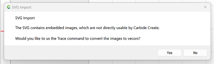

For years I have used Inkscape to convert images to svg and import into CC. Lately my svg images are not showing up in CC and prompt me to trace them.
I open Inkscape. Open the image, in this case a pdf page 1, and highlight the image. Go to Path and Trace Bitmap Image. I then go and “Save As” Plain SVG image. The image saves as an svg on my desktop and if I open it in Microsoft Edge (Browser) the image appears and is normal. Then I open CC and import the svg image in and get a message there is embeded images and a trace image dialog box comes up. I can trace the imported image but the svg from Inkscape used to just open.
Any advise about why Inkscape svg images are not importing.
I can trace the image but for some reason the Inkscape svg images are not what CC wants.

As was noted on Support, the SVG is a doubly-grouped pixel image.
The solution is to extract the pixel image and trace it, as was done in the support ticket.
