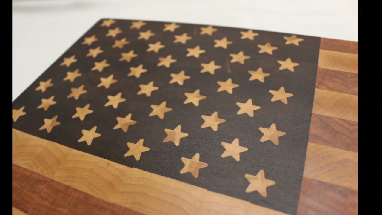

Inlaid US Flag End Grain Cutting Board
Wanted to do this for awhile so I thought I’d document the process for a little video. All in all I think the inlays turned out very well. The stars were cut on my 2016 standard SO3 with Z-plus and a 1/16 endmill.

The flag looks great. I’m looking to do some end grain inlay myself. Was wondering how you exactly inlaid those stars? I noticed the points on the starts are rounded. I assume your star image was like that so you could pocket out the points on the stars in your cutting board. You used a 1/8" end mill to cut both the pocket and the inlay material. Did you just cut the pocket out on the inside of the star image and then cut the inlay material on the outside of the star image or did you have to reduce the size of the start slightly when you cut them out of your inlay material to get them to fit? How thick is your inlay? I planned on trying to inlay some lettering.
