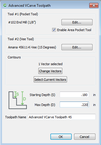

Let’s say the female carve was .200" deep.(the number everyone seems to like but does not matter) In my mind, the male sketch (the peanut jar lid) is now .200" below the top of my material. The thing is, I really don’t want the male to bottom out in the female so I lift the image up by .020" and now it resides at .180" below the top of my material. The Sketch Plane. This is my Start Depth. What this just did was create the .020" glue gap between the floor of the female and the bottom of the male insert. Now I need the cutter to slide down below the sketch to give clearance between female block and the male plug. This is where I tell the cutter to go to a Max Depth of .220" creating the .020" gap between the two. The thing to remember here is, your plug, insert, inlay, what ever you want to call it, resides above the sketch plane and is what is inserted into the female. Anything you cut past the sketch plane is clearance and part of the material you will mill off after you insert the male plug into the female Vcarve.
I know what your thinking now, what about the material that resides above the sketch plane? My tools can’t take that much material at one time. Let’s create some rough cuts. You may have to make several roughing cuts and that’s fine. The first Vcarve may have a Start Depth of zero with a Max Depth of .085". The next will Start at .085" with a Max Depth of .180" and the final will Start at .180" with a Max Depth of .220". This could potentially create a lot of tool changes. Depending on your skill and comfort level, there are ways around so many tool changes but require editing the G code and go beyond the scope of what I am trying to convey.
