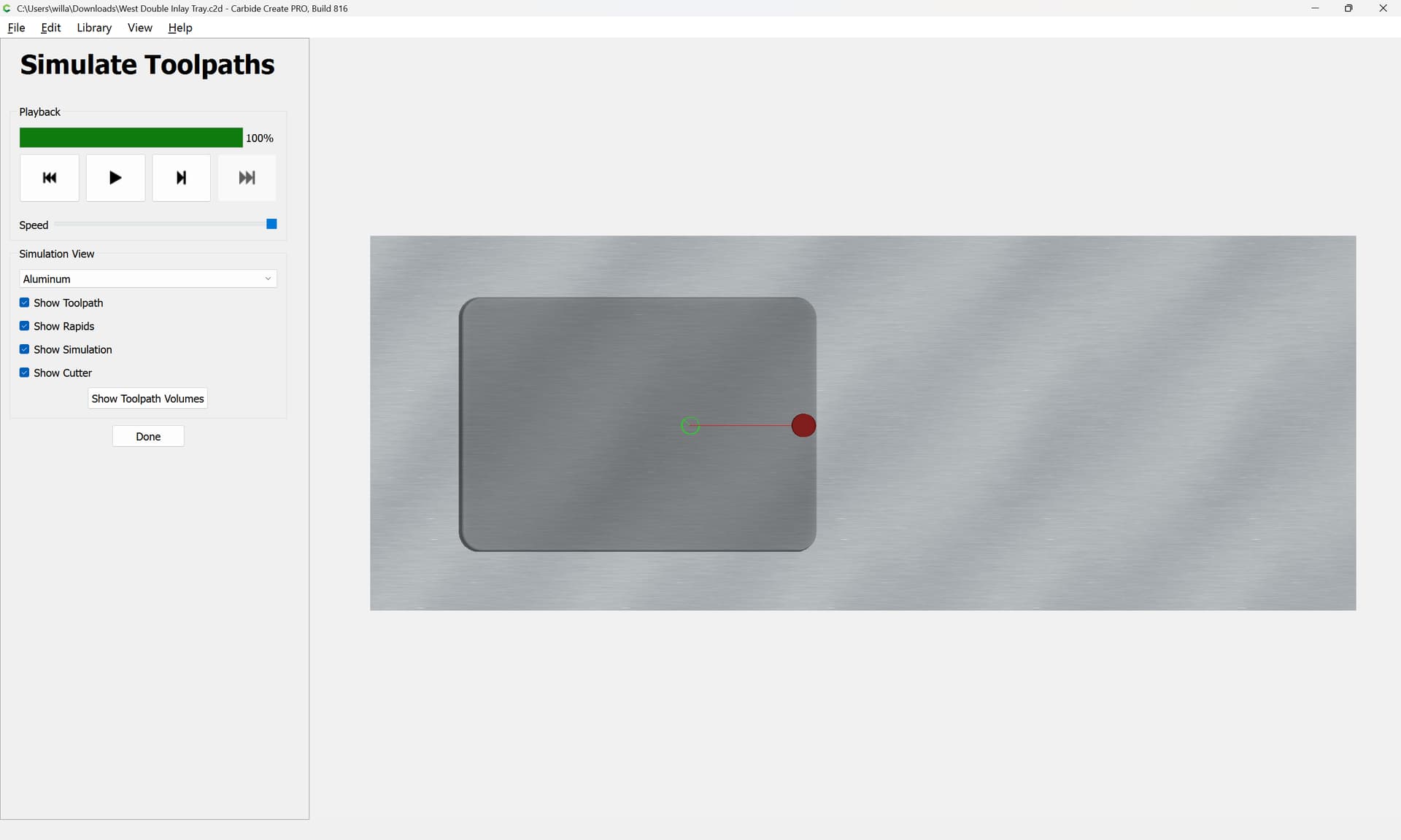

Post photos showing in what way the inlay is loose?
Which toolpath is enabled to cut the recess for the inlay?
How is the 7/16" bowl bit defined? Is the geometry of it suited to cutting a 13mm deep pocket?

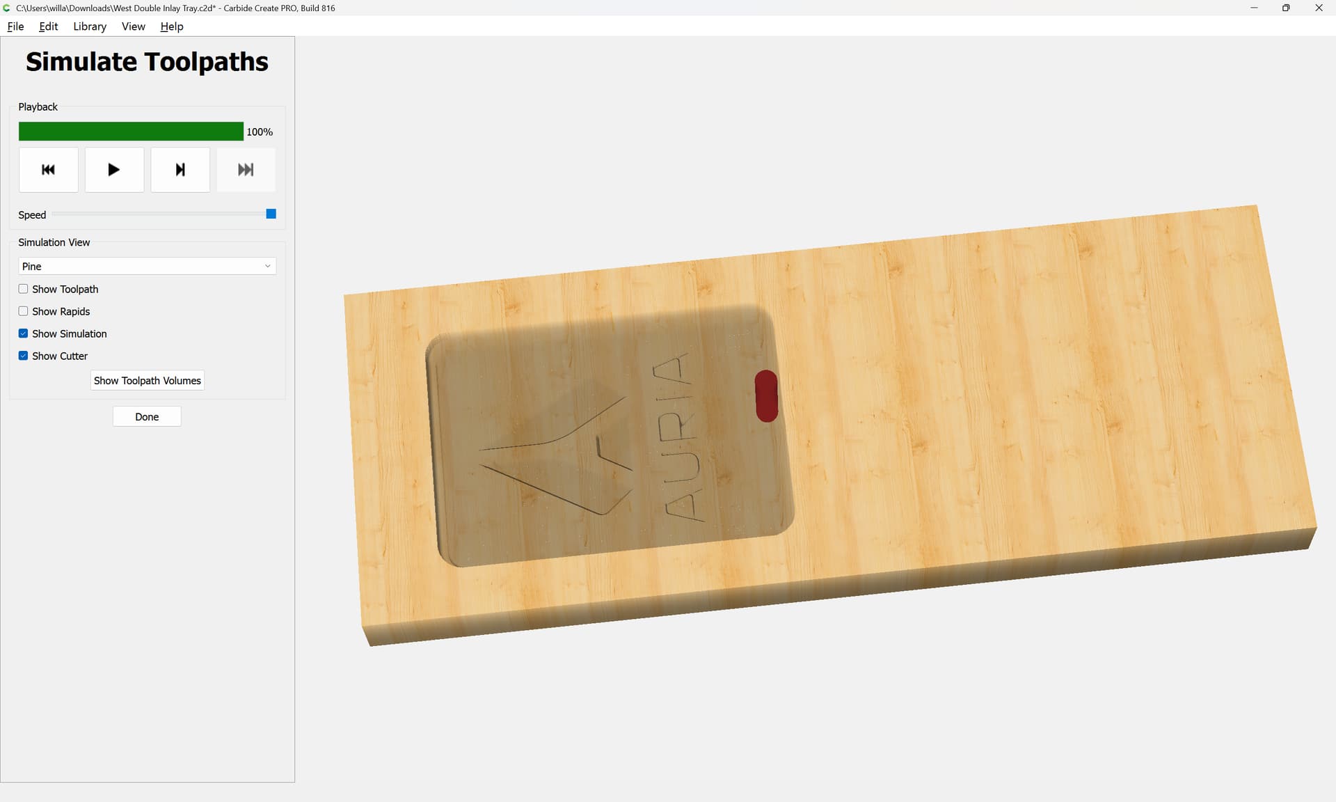

The preview seems okay:
Last night I tried cutting two new plugs from some hard maple. One of the plugs was with the same exact file I cut the Yellowheart from and the other was a copy and past of the design from the main pocket file. Both file cut an identical plug and both plugs seemed as loose fitting as the Yellowheart plug. So, I just went full send and glued in the Yellowheart plug.
It came out just fine with no noticeable gap in the inlay. I’m not sure why these plugs felt like they had more play then other plugs I’ve made for past projects.
