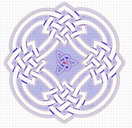

I have been having an issue for 2days and I have exhausted my brain trying to figure this out.
I am making an inlay in my shapeoko 4 and designing it in carbide create v7. My cutout works perfectly but my inlay plug is giving me trouble.
as you can see in my image. The center trinity is being completely milled. I have them locked together on the same layer but it continues to do this as if the center trinity is not even there.
I have copied from the first layer and reversed the image. The first layer cutout is perfect. But the second layer plug will not cut out the trinity.
Any ideas?

I tried a whole bunch of combinations. If you select just the outside vector and the center design, it works. Any combination of the larger design & the smaller design fails. ???
I don’t see any overlapping or self-intersecting vectors, so no idea.
Best I can suggest is to do them separately. I create 2 small offsets around the center design so I could overlap the 2 cuts & it worked fine.
FYI, it also works fine in V815 :wink:

V8 combines V-carve & Advanced V-carve into the same operation. However, it outputs 2 toolpaths, so you can order them. You can keep the clearing bit & Vee bit together for fewer toolchanges.
Got it… the setup did work

your solution worked great! Thank you so much
I have both cut out, they fit nice but I will have to wait until I am home from vacation to cut out and glue
