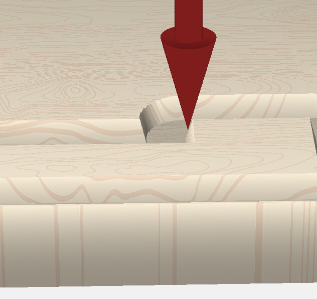

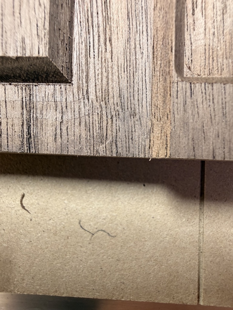

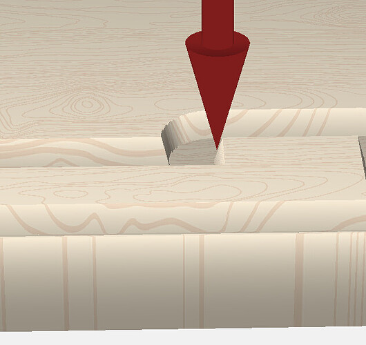

Hi,
When I inlay I’m getting round corners when it a 90 degree corner. And I can’t get it to fit correctly either. I have done a few inlays and they were all correct previously. I’ve included an image and the file.

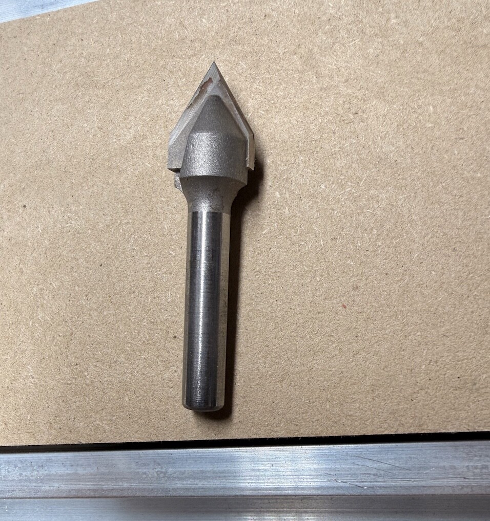

That doesn’t look like a 60° V-bit ???
This is what bit I am using… #302

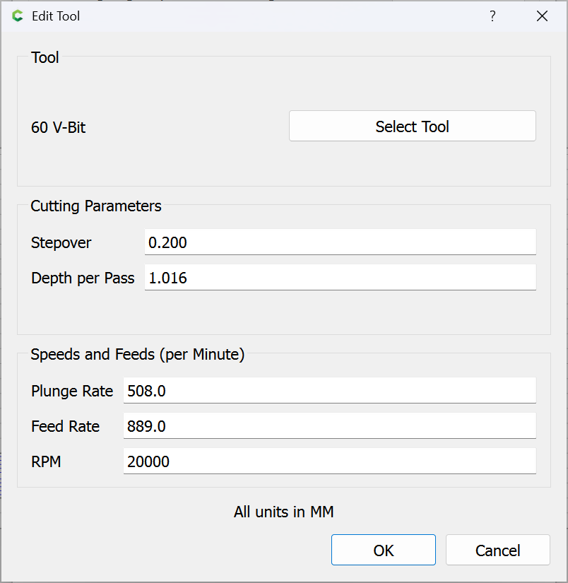

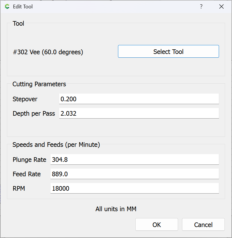

You aren’t using the provided tooling definition for a #302:
Why not use:
I’ll try that. Thanks.
