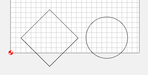

Do a test, something like this…
The shapes hang off the edge so you can see & measure the gaps.
0.004" is way too small for a Top Gap.
Start with
Female: Depth: 0.250,
Male: Plug Depth: 0.150 Top Gap: 0.150
Leave the male on the machine & press fit the female to the male & measure the actual gaps.
Now adjust the plug depth & top gap to get the numbers you really want.
Make a note of your “fudge factor” for that material/cutter combination.
