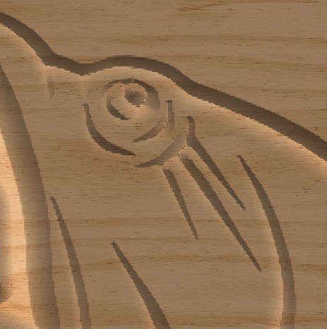

Hi group,
I am working on an Inlay with a fish drawing and it is not working. I tried to produce it with a V30 and also a V45 and the plug do not fit in the Female.

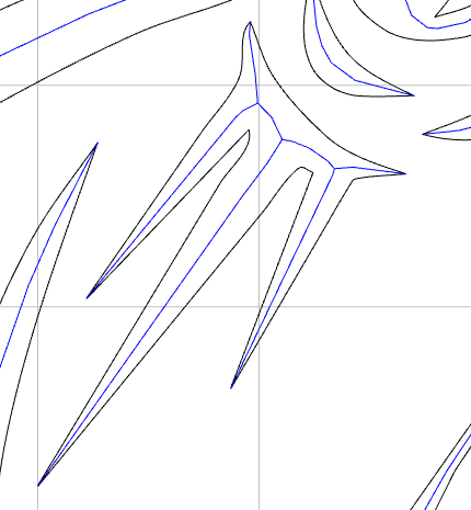

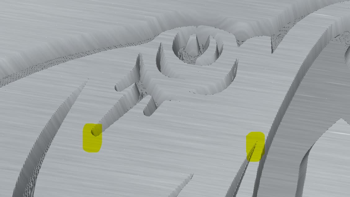

I just tried it in CC with the CC 302 60 degree bit. And just by looking at the simulation, I see it will not fit. Look at the 3 lines next to the eye. The male is bigger than the female.
Here are the 2 files. Can somebody help figure what is wrong?

I am getting the same thing on the Female side.
To get that kind of detail, you’ll need to use a 15-degree bit or less.
Even with the 15, it’s acting weird right there.

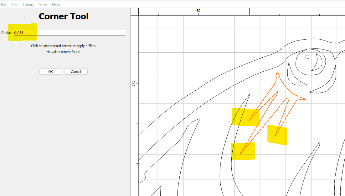

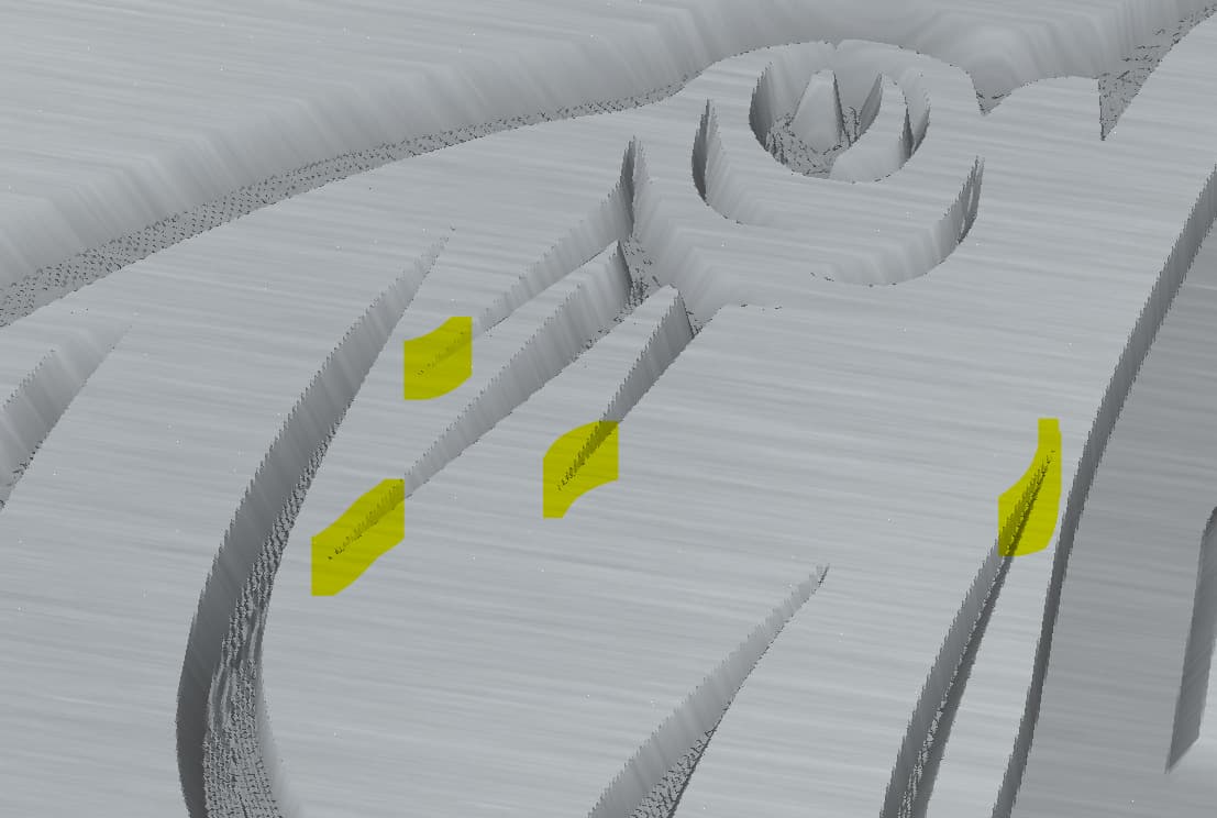

I fixed it.
Something weird was going on there.
fish for forum fixed
I used the Corner tool to add a more rounded curve instead of such a sharp point. That did the trick.
V60 Poisson F-sdguy fixed.c2d (204 KB)
I suggest you go with a narrower bit. Minimum would be a 30-degree angle. Preferably narrower.

Yep, sometimes V-carve gets confused with very narrow sharp corners.
Either ad a radius, or even just another node & make a square or rounded end…
