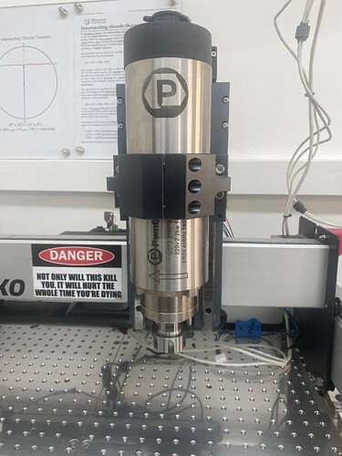

Image to show… no lines to see so went for lining bottom edge of black casing with top edge of HDZ… this provides 130mm height from baseboard to bottom of clamping nut. Spindle held in 80mm spindle mount by bolts tightened to 15 Nm.
I am happy with the spindle now… just to set up the VFD and all should be well :crossed_fingers:

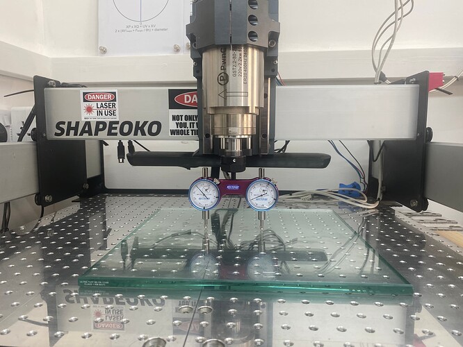

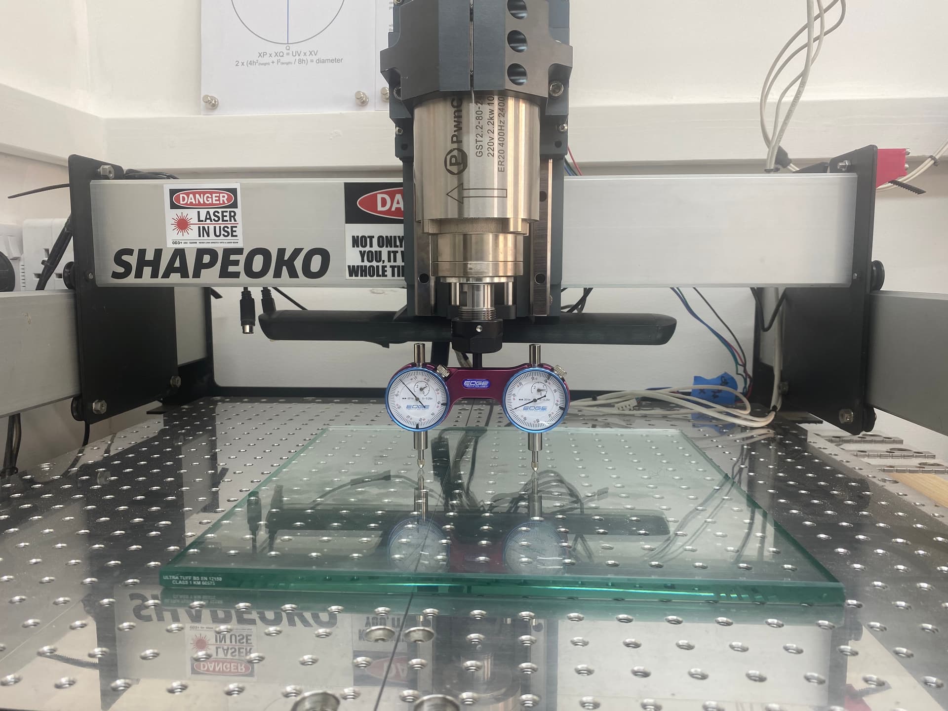

Make sure your tram is as good as you can get it.
Yep… just done that and achieved 0.002" in X & Y directions
