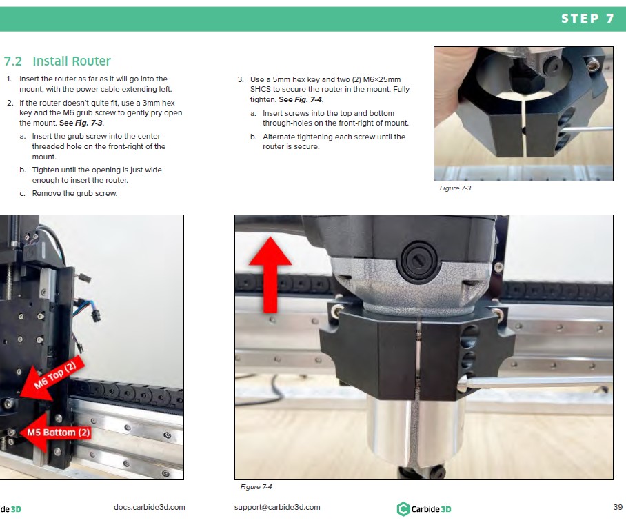

Unless they changed up the mount, you shouldn’t have to pry on the mount, unless you lost the set screw,
Apparently they eliminated that handy feature on the Pro 5.
