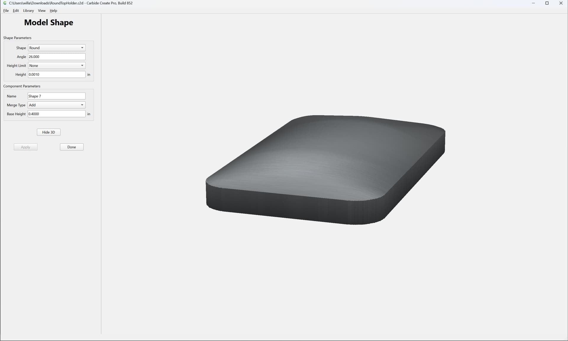

I need the round to be inverted
where the file in question has a 3D model of:

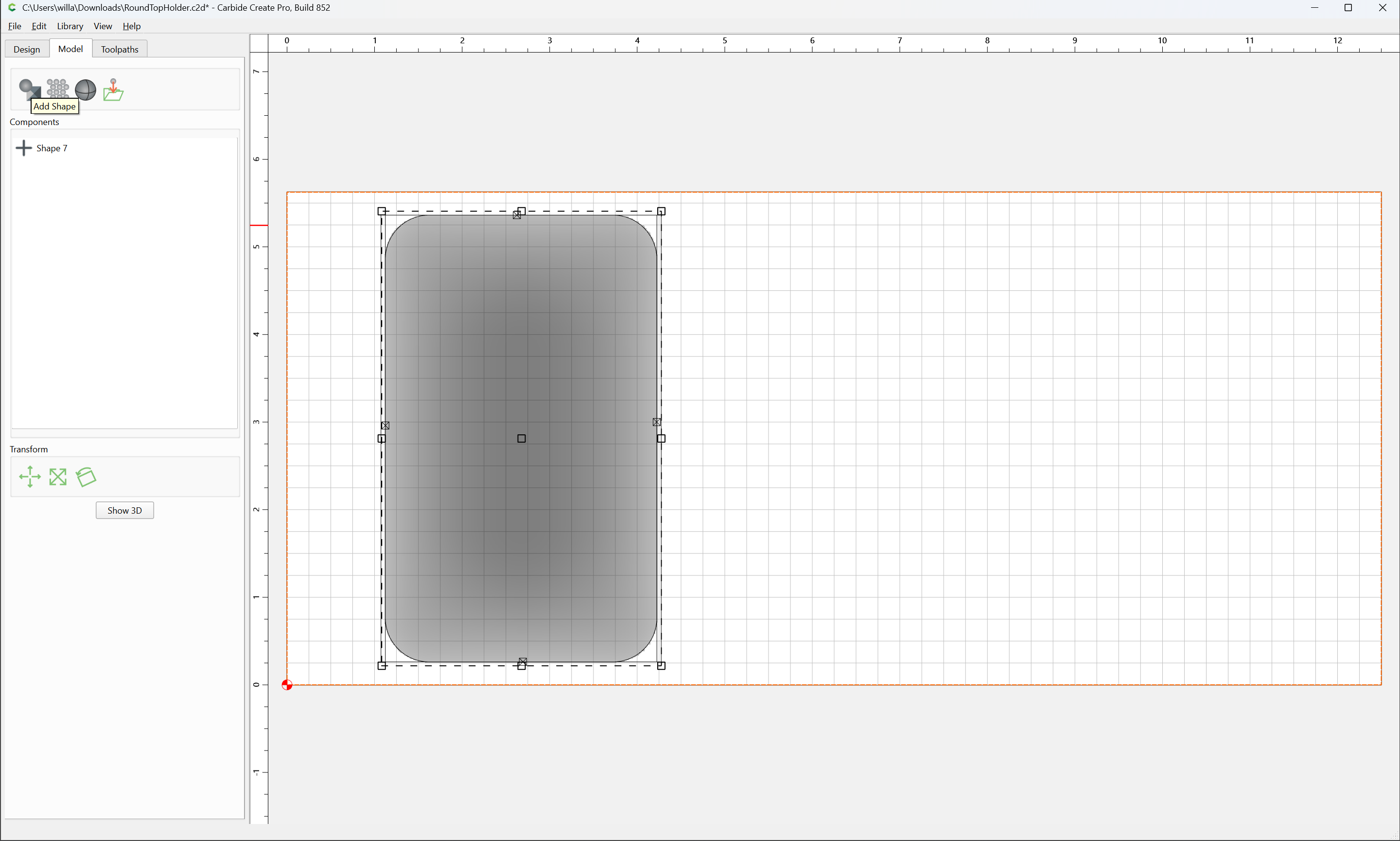

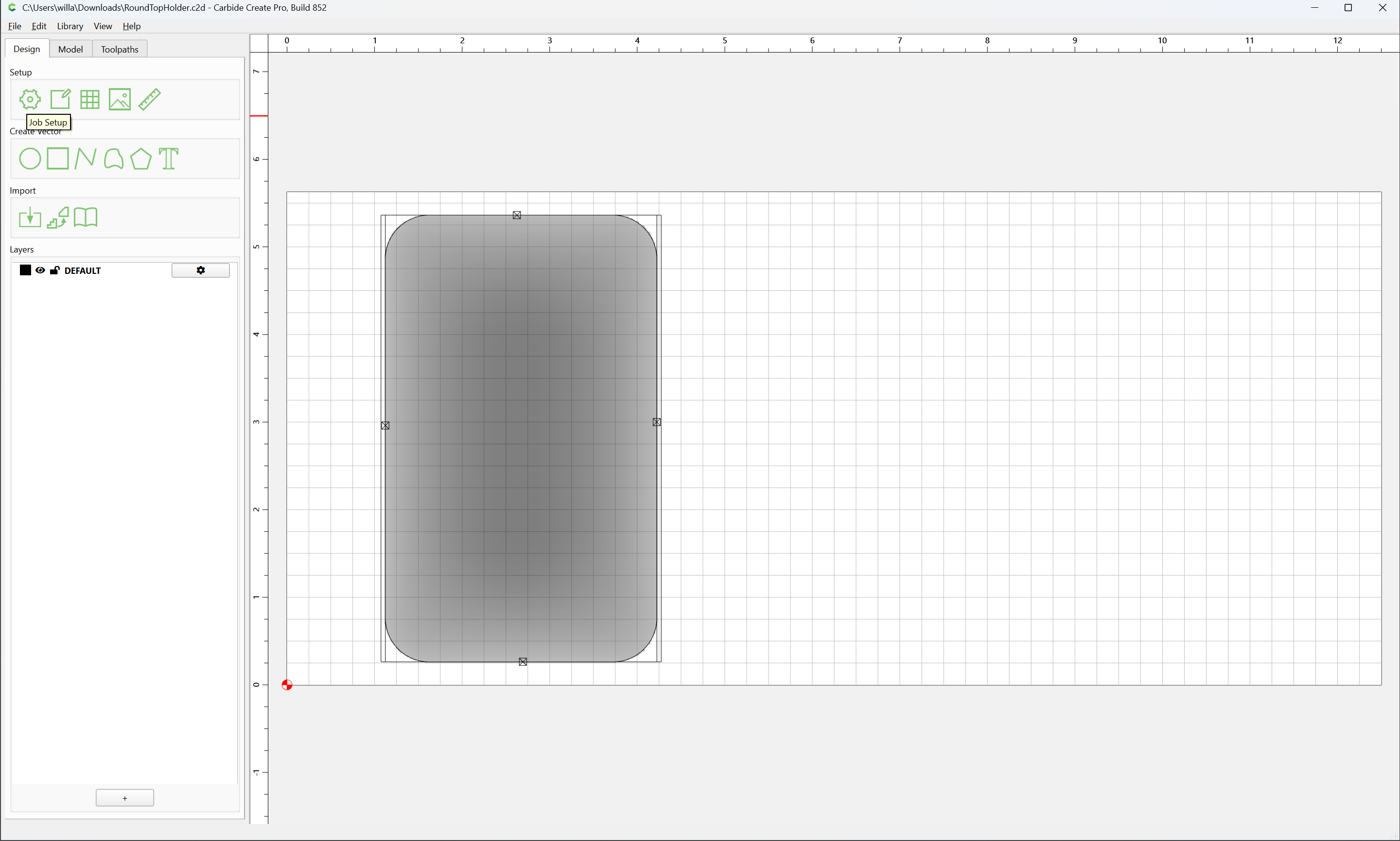

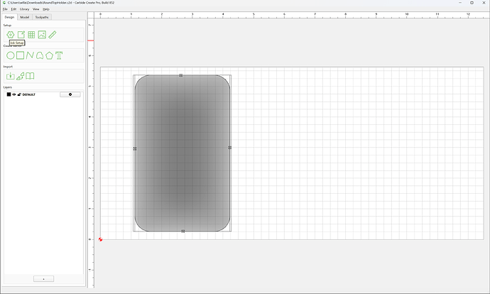

If we go back to the Design tab:

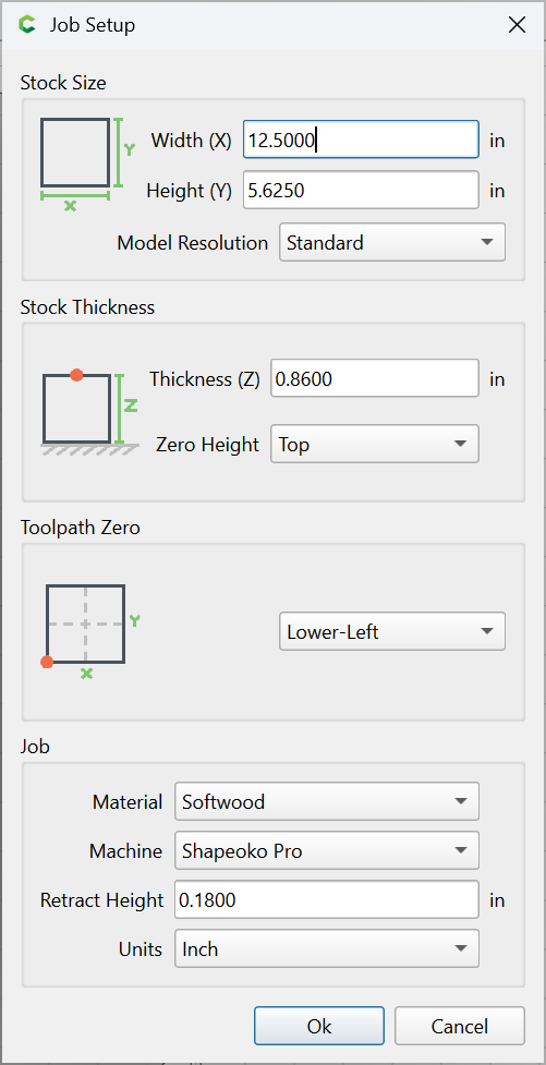

and check in Job Setup:

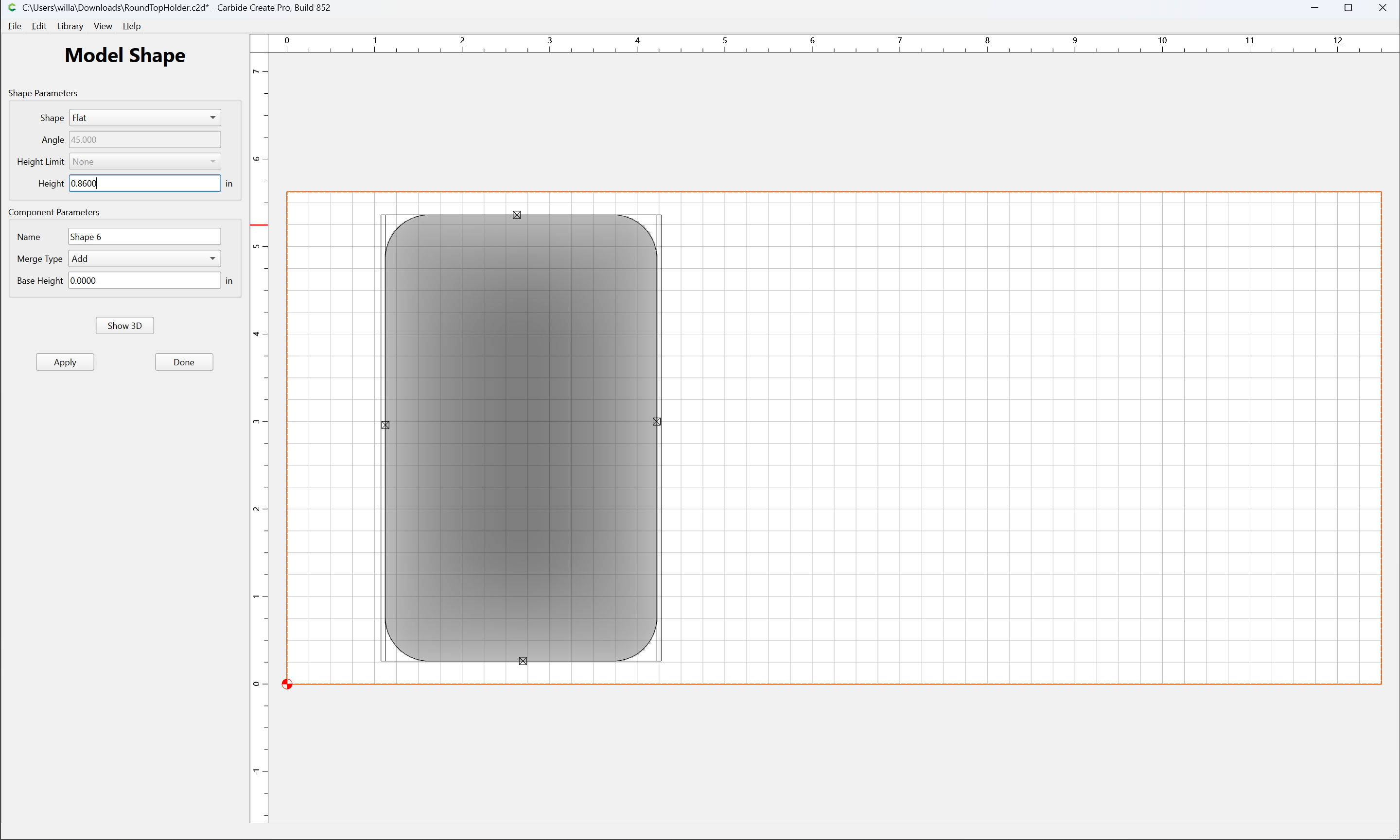

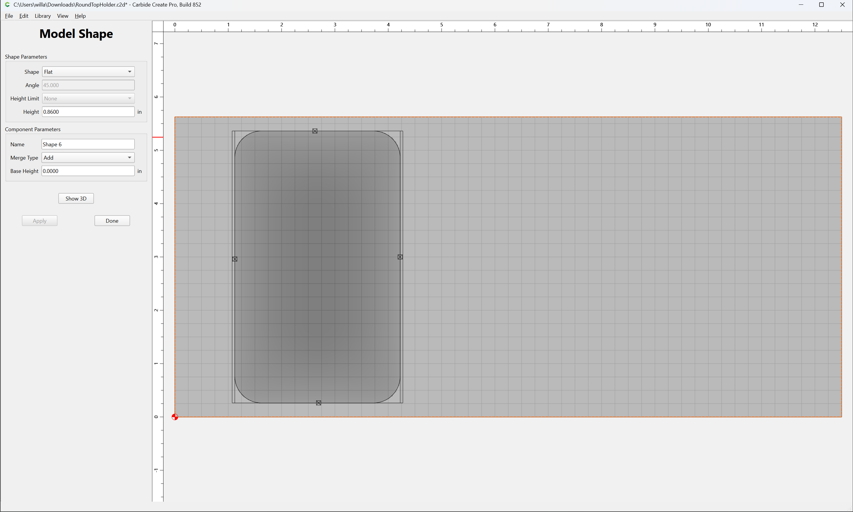

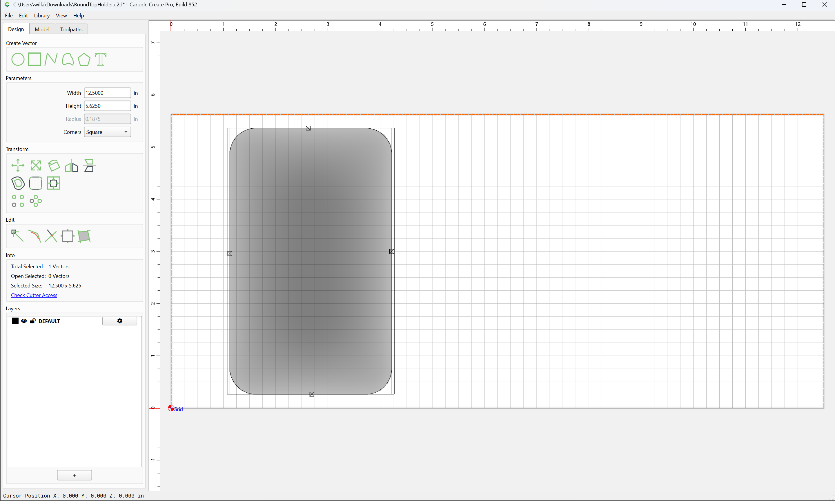

We are then able to model the Stock:
Apply

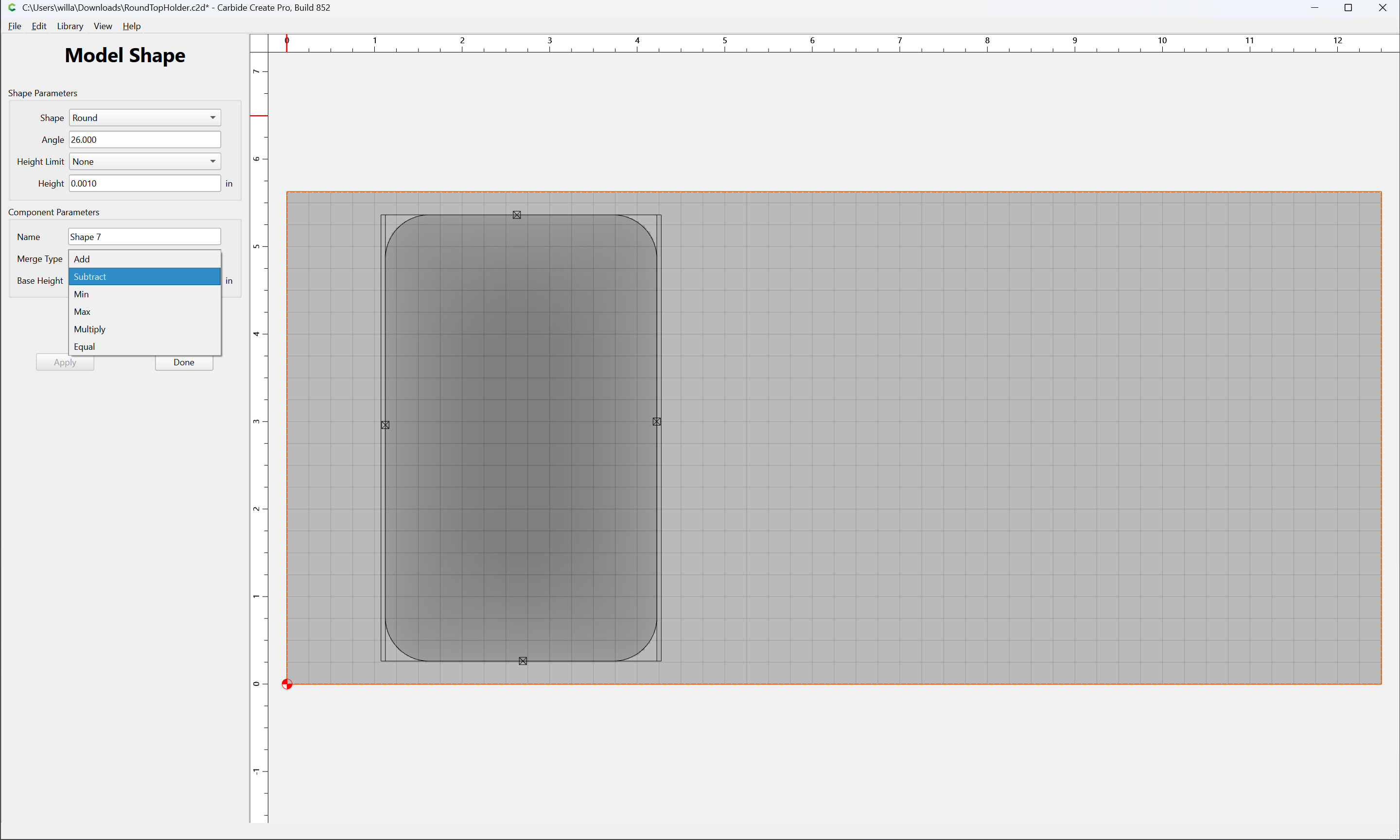

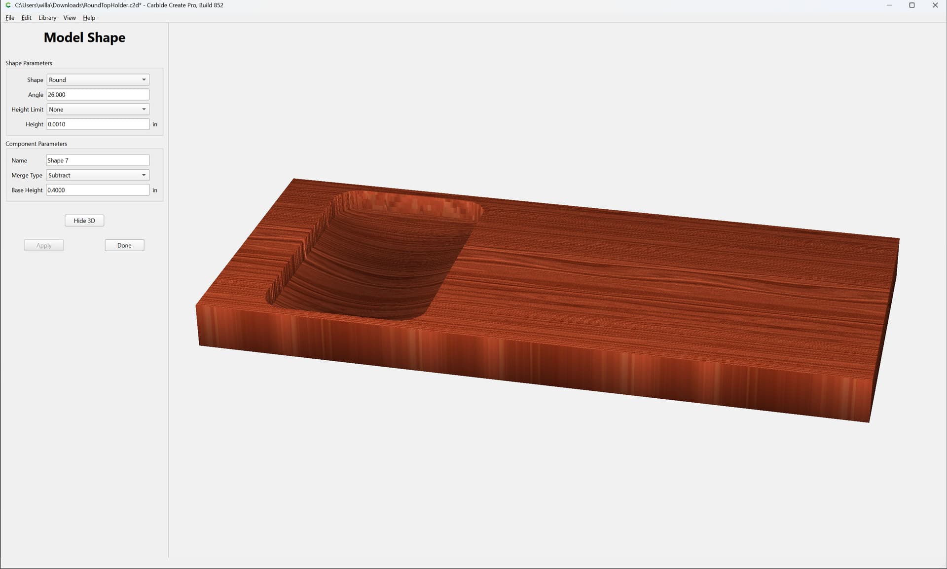

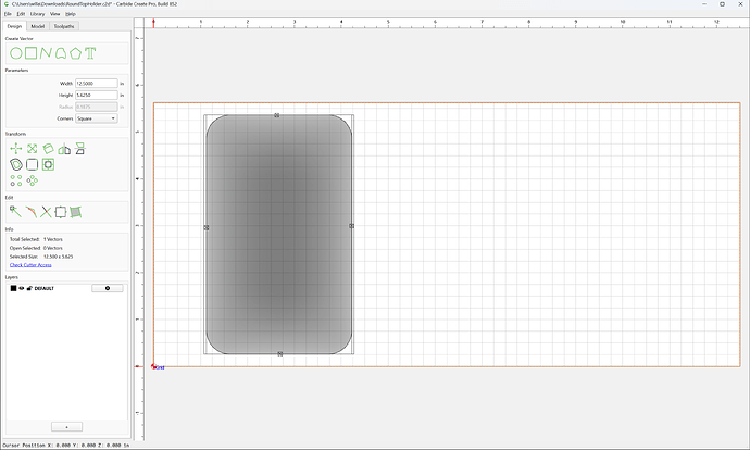

and then edit the round element:
setting it to Subtract:
