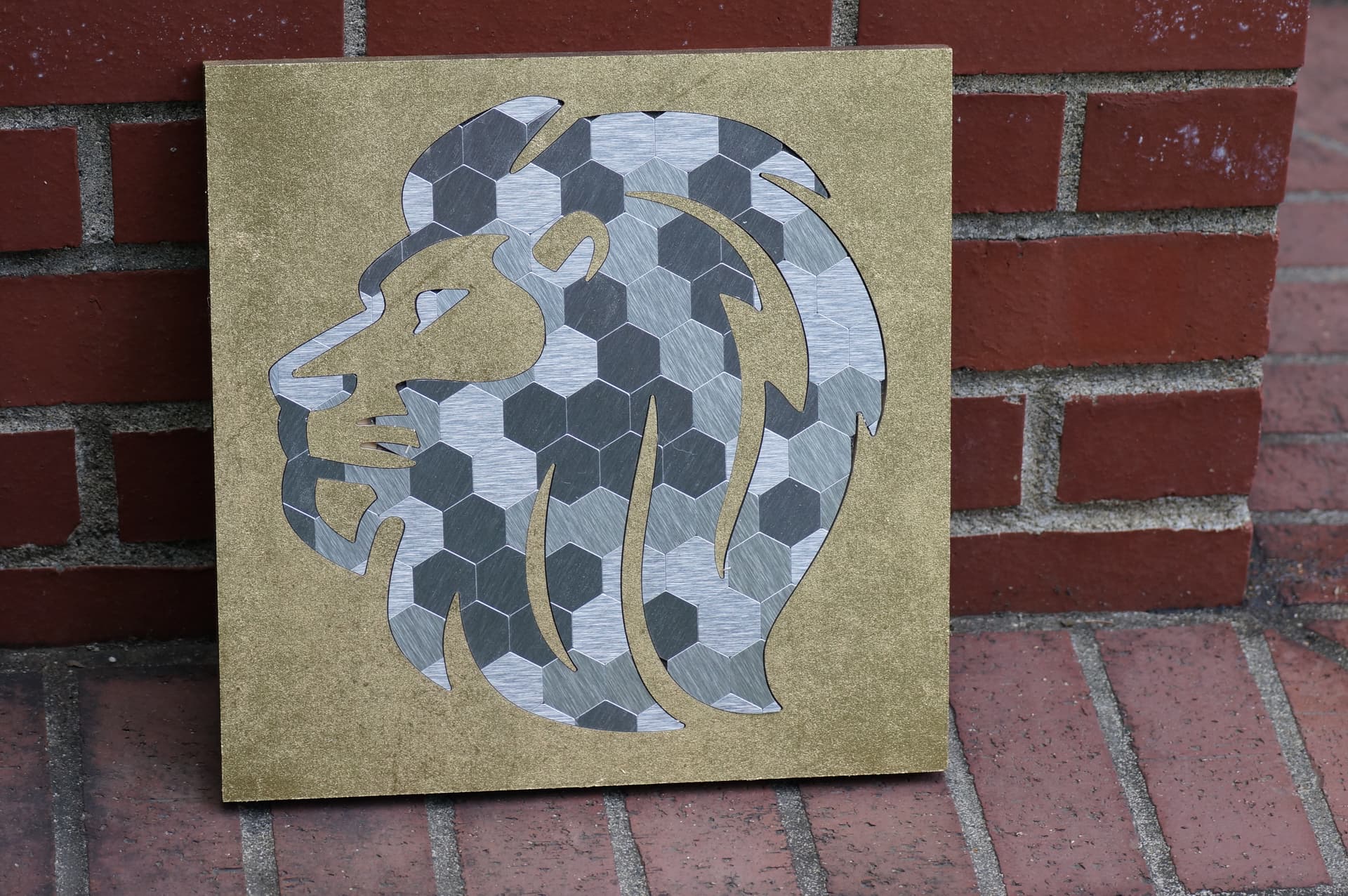

so while cutting ceramic tile is likely a problem…
… you can cut certain type of kitchen backplash and then inlay it :wink:
Looks great. What is that certain type?
this was metal-on-foam-on-glue type
Hmm. Probably can’t sell the boss on that.
