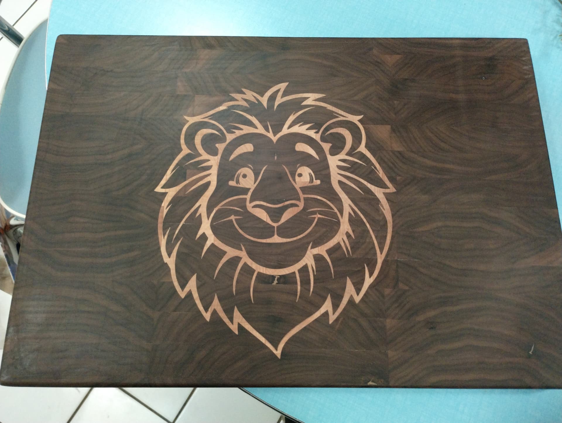

I am new so by no means an expert, but I use a 60 deg bit and the free version of CC with success.Here is one example:

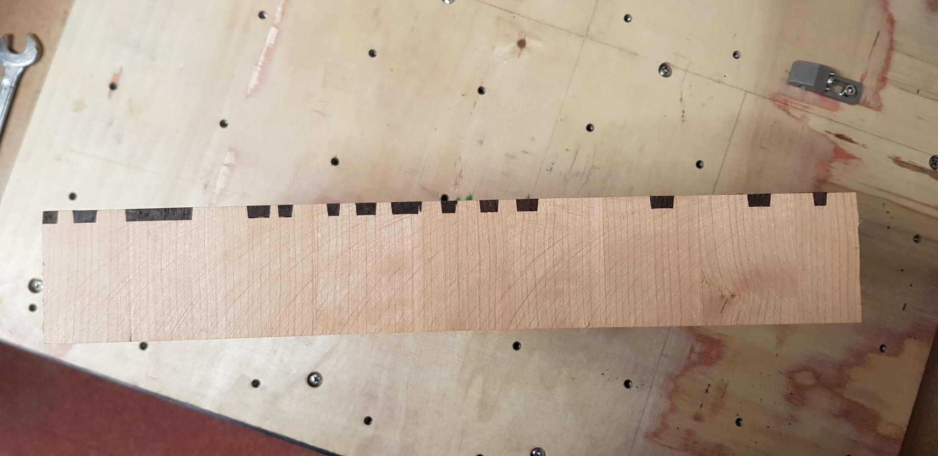

I have done lots of inlays, all 6mm deep, using a 9.7 degree TBN.
Here is an example:
This is an edge before I attached the Wenge border:
The only problem is that I can’t advise how to do it in CC, as I use Vectric v-carve.
It still took a lot of figuring out and many practices before I got the perfect fits. All I can say is keep practicing (I used MDF to practice).

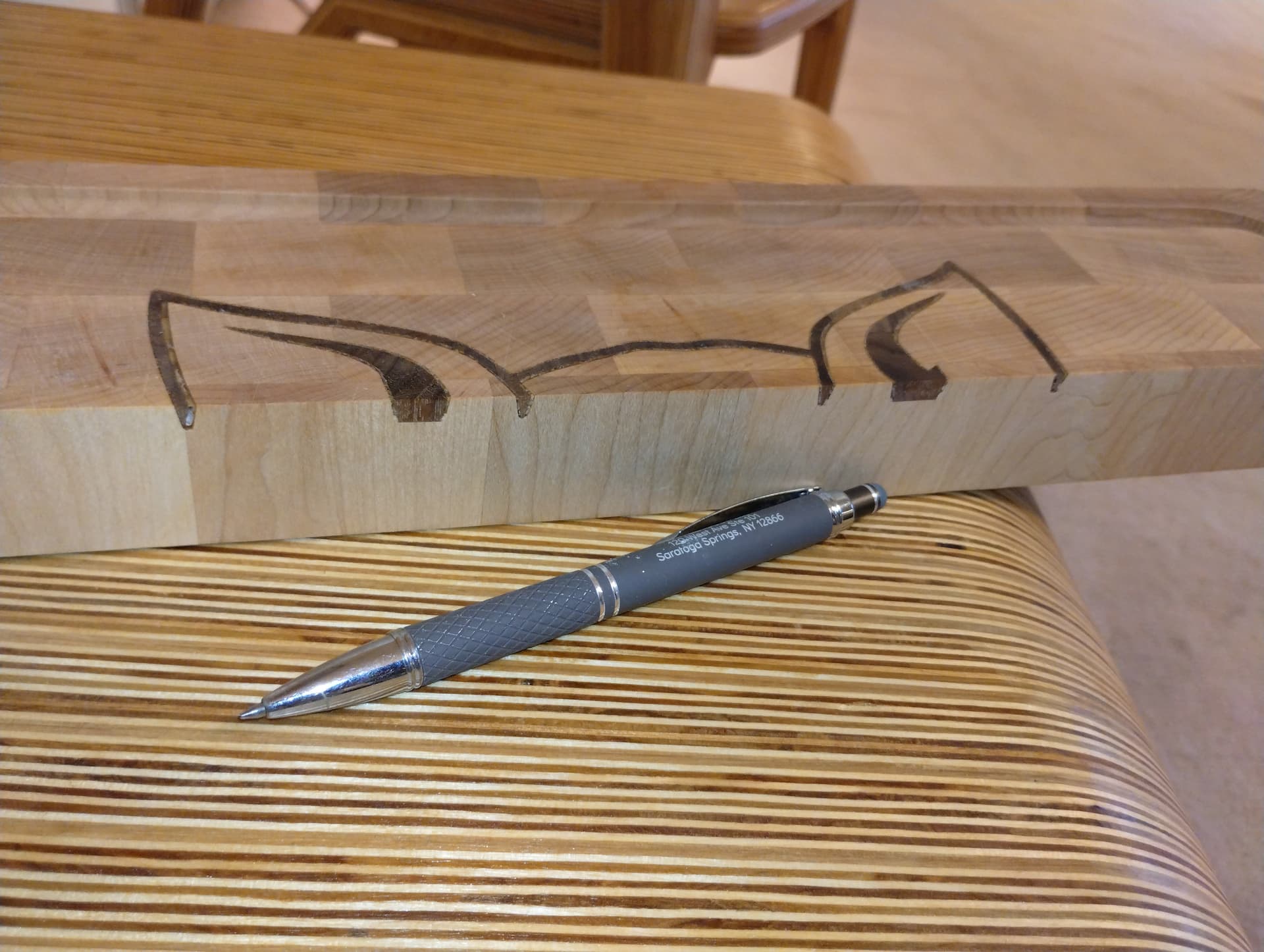

20 deg is what I use.
(the cut board is not a good example how the inlay fits thats why I just use it for demonstration of the depth)
And yes, functionally for a cutting board that is supposed to be used a deeper inlay also for narrow structures is preferrabe IMO because it can be almost endlessly sanded if the surface is worn.
I have no experience with bits with lower angle.

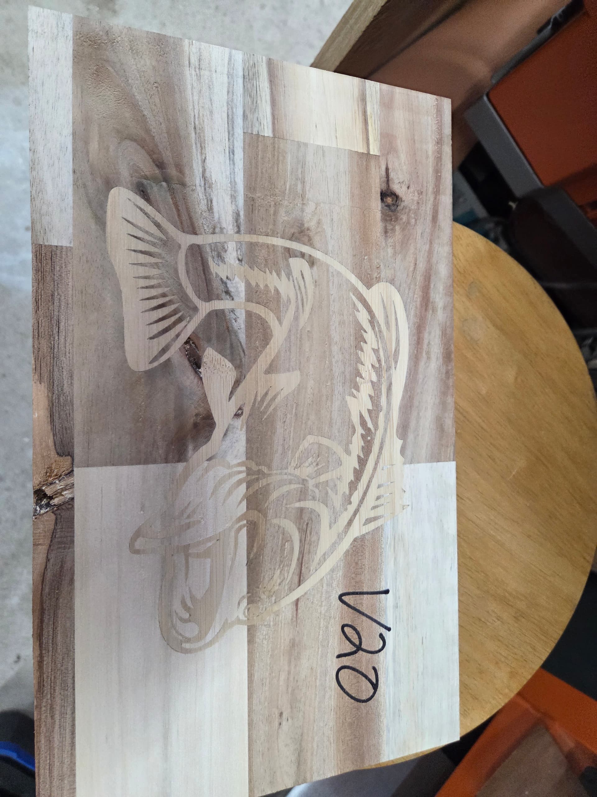

Finally got something good with all your tips, thank you all.
I will now work only with 20 or 30 degree v-bits. Here is the result I got with a V20. :slight_smile:
This is a test with scrap wood, acacia and bamboo
