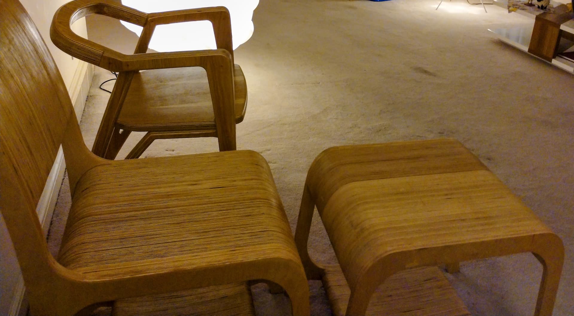

Guy, can you give recommendations where to get plywood completely made -I mean all plies- from one wood? I used some so called baltic plywood what indeed is russian made, and this is only available as A/B, and there are a lot of holes and black plies in the middle: visible edges are a vabanque game. Apple Ply has AA surfaces, but IMO they use baltic birch and apply surfaces on it. The hardware store plywood is all good for cabinets with nicely glued on surfaces, but with thick plies cannot be used for visible edges.
Since plywood became rather pricey the last years I did not try Europly since I can get that only as custom order from Home Depot.
Do you have experience with Europly? Is this AA and same wood throughout the whole sheet, with minimal holes and black parts?
Or can you recommend some sources for good plywood?
Made some of those from plywood, the edges are ok but far from excellent:
Sorry my only sources for “baltic birch” are local to East Texas in Nacogdoches Tx at Harry’s Building Supply. I have never used any of the appleply or other newer types of plywood. As you said if I go to Lowes and buy plywood it is to make cabinets. I have a bad habit of keeping bits and pieces of plywood and frankly they are in the way. However sometimes I go to the bins and get some scraps to make something utilitarian.
From your pictures you need high quality plywood and that is as rare as hens teeth.
