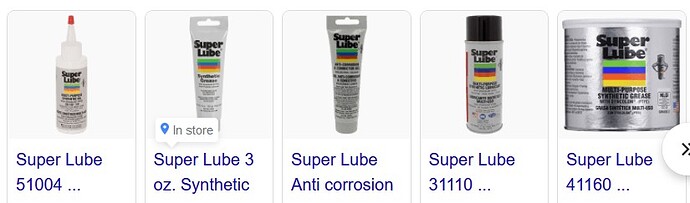

The Super Lube products are many products. They make oil to grease all under the Super Lube name.
