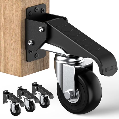

@wmoy is an expert on C3D machines so I will defer to his judgement. However for future viewers of this thread try to buy wheels that lock in both directions. Some people like to get those bench wheels that completely retract up. The older wheels that just lock will move if you push them hard enough because the lever is just a friction fit and not much friction. So if you have not already bought wheels buy the type that lock in both directions, that is around the wheel itself and the position the wheel is locked in. The bench type ones work but they stick out and can be trip hazard.
Dont get these type:
Get these type that lock in two directions.
If you look at the upper left picture you will see little teeth that lock the wheel and keep it from rotating. The black (wheel) part is also locked in position. So you get two way locking.
Here are the bench type of wheels. They lift completely off the ground and let your bench/stand sit flat on the floor.
My only reservation with these is the lever sticks out and you can run into it easily. If you like this type try to put it out of your regular path like on the sides. They also make these type with brackets that are on multiple cabinets and you move the wheel around so you only need one set of wheels but can move multiple pieces of machinery.
These wheels are better if you are dealing with smaller spaces and need the wheels to be out of the way. If you are also wanting your machine table not to move, then they lift up off the floor and act as regular leg pins.

Amazing explanations Guy! The Bench type would have to stick out, so although I love that functionality, I hesitate to get those.

Here is pic of them in white. There are a few different types in Amazon. You could find ones with reduced weight availability, and at a little cheaper rate possibly, but don’t skimp and sacrifice quality over pricing. I like these because they give me the option to be able to move my table if I want to, but make the table solid while I am not using them. I don’t plan on having to move my machine much, if at all, but these style of casters give me that option if I desire.
The nice thing about the ratcheting style like you see here, you can use a rod to adjust these pretty quickly, instead of having to put wrenches on them and tightening or loosening nuts, to make adjustments, and they are a bit beefer then many simple swivel casters.
The wheels in my post are available on Amazon and other online retailers. The lever types with the brackets are also available all over the place but Rockler sells them.
