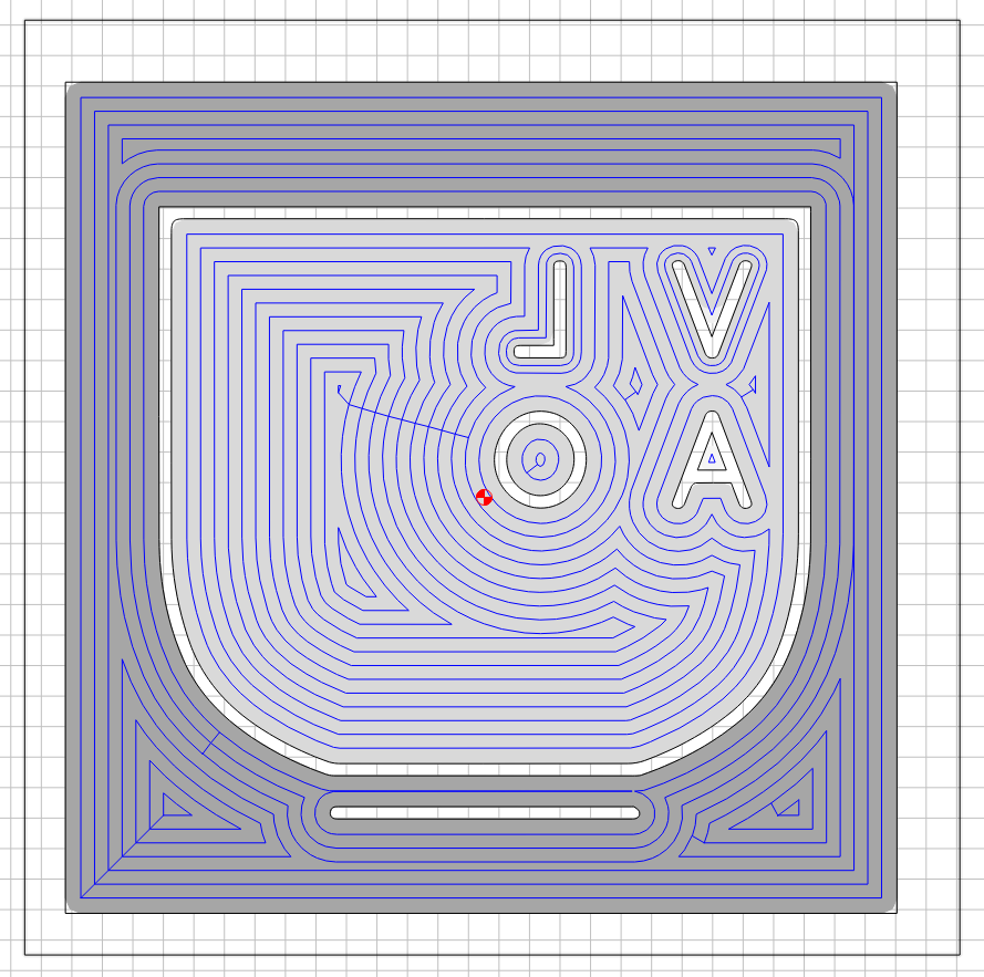

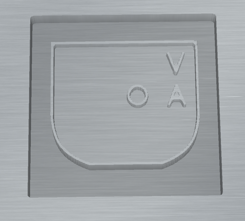

I just created a project in Carbide Create. It includes text. Everything looks good in the TOOLPATH mode but when I look at the simulation, there is a part of an arc missing in one of the letters. Which should I trust, TOOLPATH or SIMULATION?
In my experience you can trust the Toolpath View.

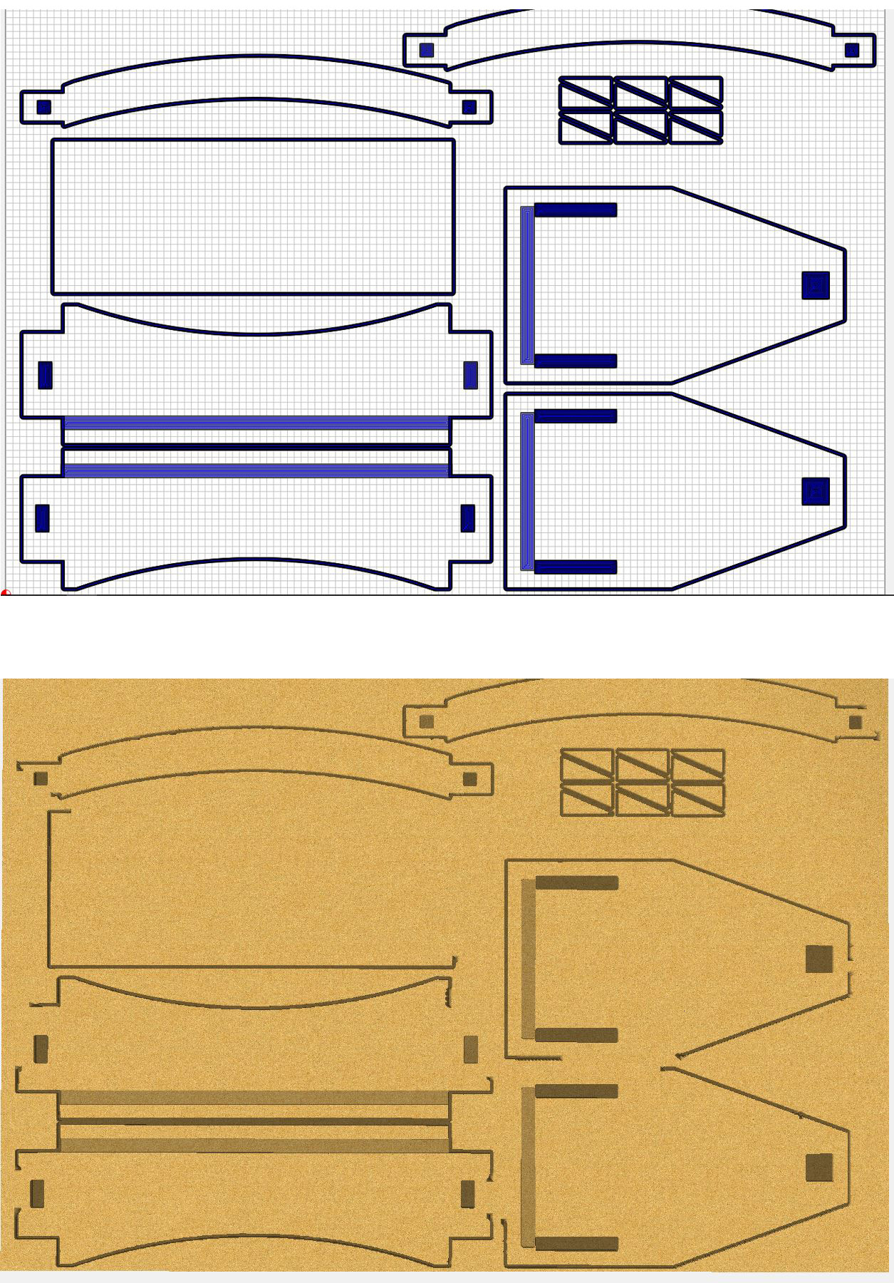

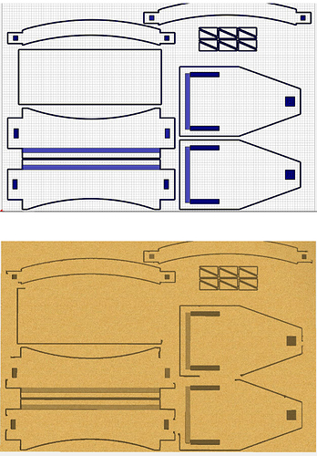

The Simulation will occasionally drop some geometry:
As you can see, the Toolpath View was accurate.

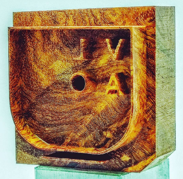

This is a Burl Makers Mark for Ceramic embossing.
Designed By V Lao

Would this be the same for entire Lines Missing? Sorry for my ignorance this will be my first project.
@JAcieG
Yes, it appears the simulation is not showing 2 edges, but the toolpath lines are visible and correct. It’s a bug.
