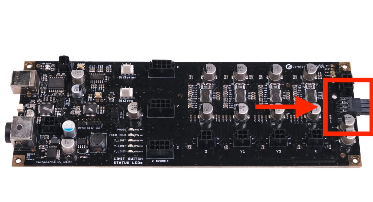

I have a Shapeoko 3 with an added extended Z HDZ.
Will the connector of the 65mm VFD be compatible with my early control board?
It is the Carbide Motion v2.4d control board.

If you see a 6-pin connector sticking out of your controller on the opposite side as where the USB plug goes in, then yes.
Winston,
There is a 6 pin connector near the USB plug marked P27.
It is located between the USB and the Power connector inboard by ~1/2 inch.
It is the Carbide Motion v2.4d PCB
Thank You, Jim

Winston,
Darn, I have an earlier version.

Can your controller be upgraded to accept the spindle?
Thanks for asking. Unfortunately as an earlier adopter my controller board doesn’t have the required connector for the spindle power controller.
I assume that the old controller board isn’t needed if I control the spindle manually but then I would loose all the functionality that Carbide3D engineered into the system.
An upgraded Shapeoko controller board would add another $150.00 but is not available at this time. Now I need to consider other options.
Thanks for asking, Jim
If you have the holes in the board, it may be possible to solder on a connector and save a few bucks. But you would still need a new housing that has the hole needed. Your best bet is to email into sales, and they can point you in the best direction.

There are indeed holes in my board and I have an electronics shop with connectors in the basement.
My next thought is that there may be a BIOS or software change needed to access that port.
I am going to sit on this one and think about the implications for a bit.
