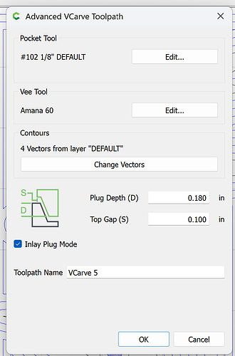

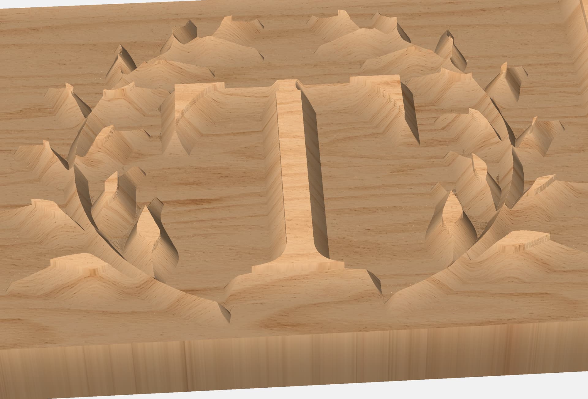

Trying to do an inlay plug for the first time, having an issue with getting these “flats” at the top of the features that prevent it from seating into the cavity. I’m sure there’s something simple I’m missing?
Post the file so we can check it out.
T Serving Board Plug.c2d (212 KB)
Your plug depth/height is greater than the V tool which you have chosen can cut — you can either do the trigonometry to determine the greatest possible angle which it can cut and stay below that dimension, or switch to a larger/more acute V tool.
Ok, makes perfect sense, thanks so much for the help!
